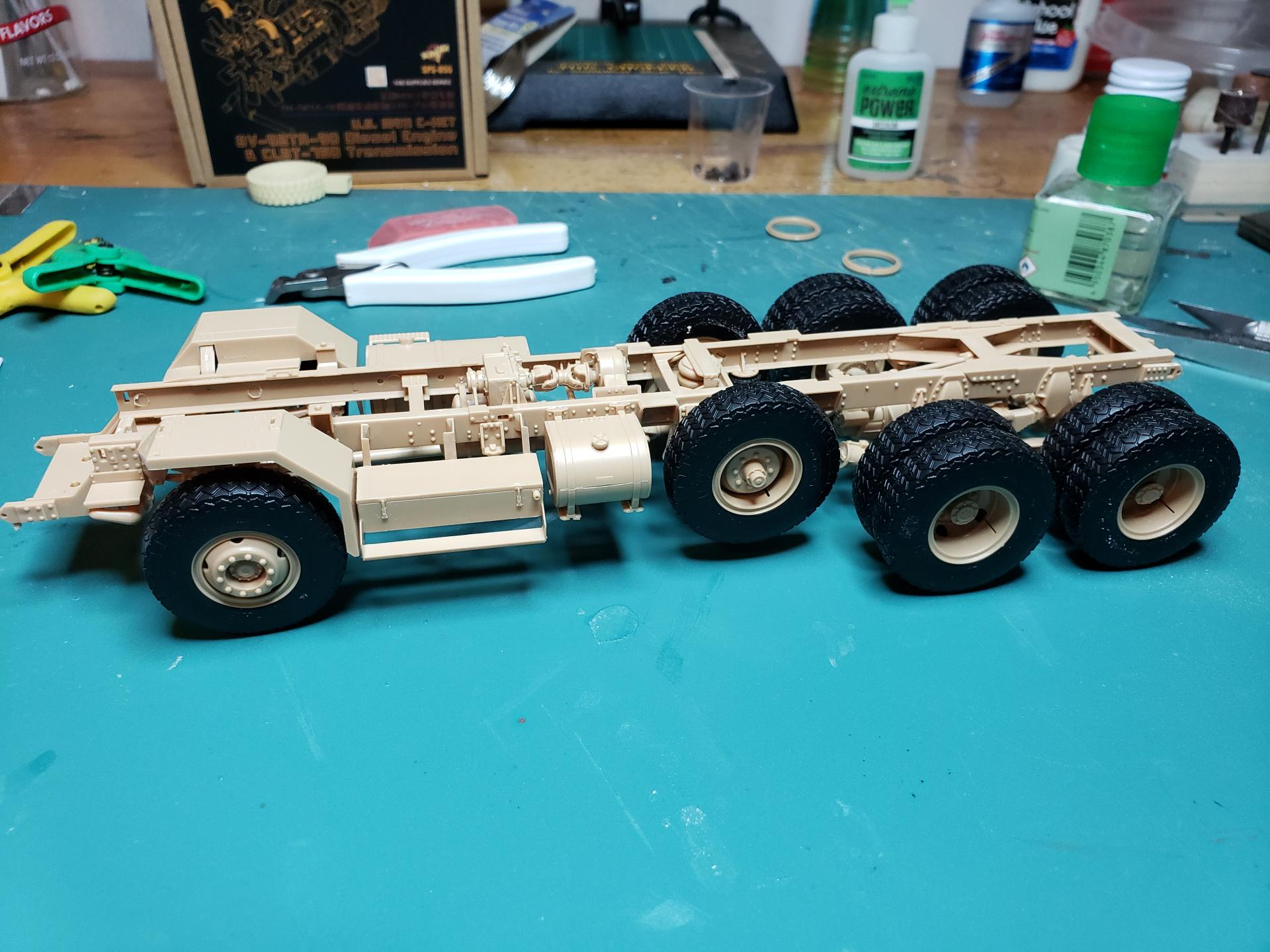

Update time !!! Its officially a rolling chassis!! The tire issue was resolved by taking time and fitting tire around the rim almost like real one on tire machine.  They'll be removed for paint .20180709_212323.thumb.jpg.9330f0e5bfa97885154e28962e98a464.jpg

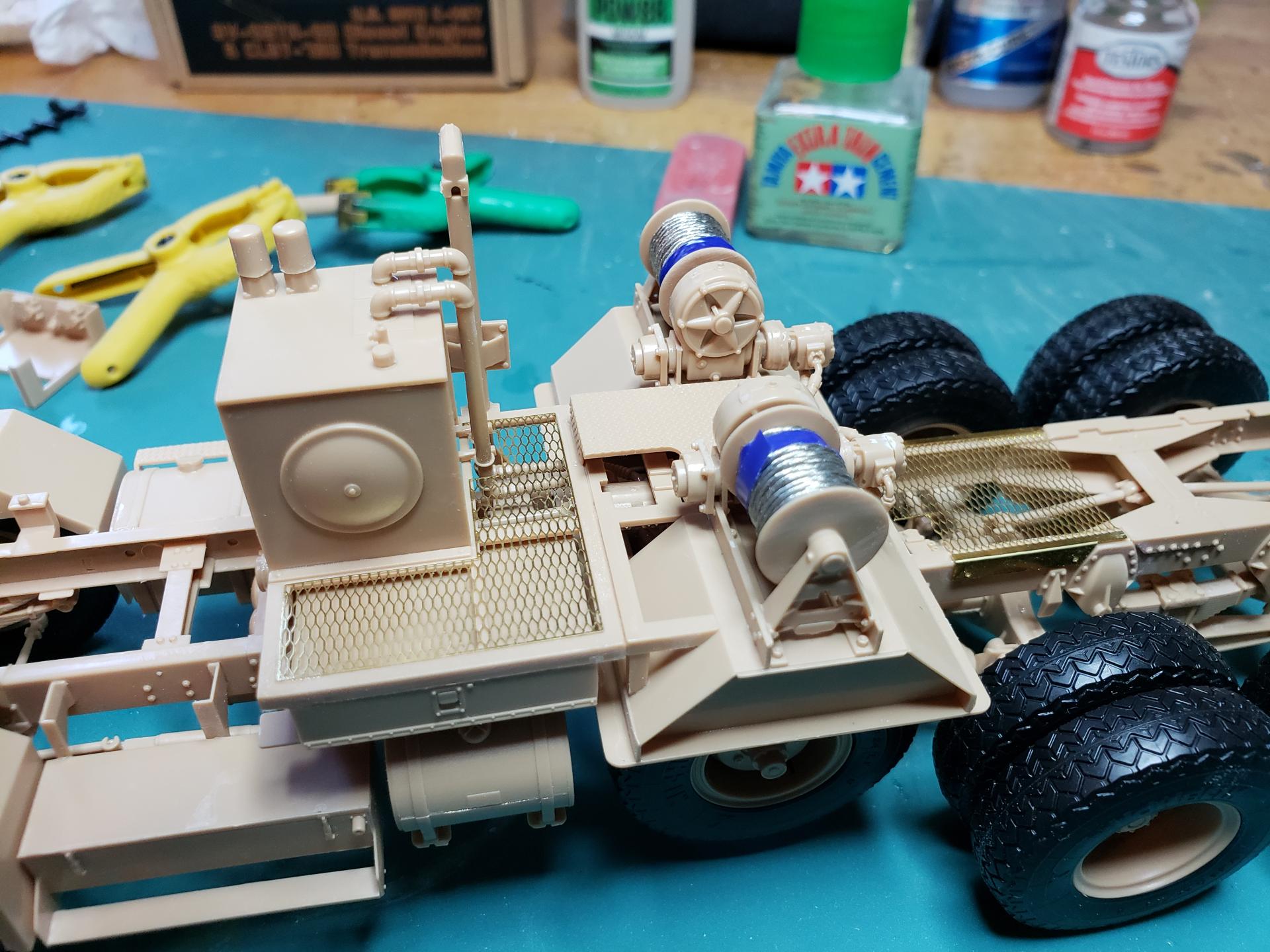

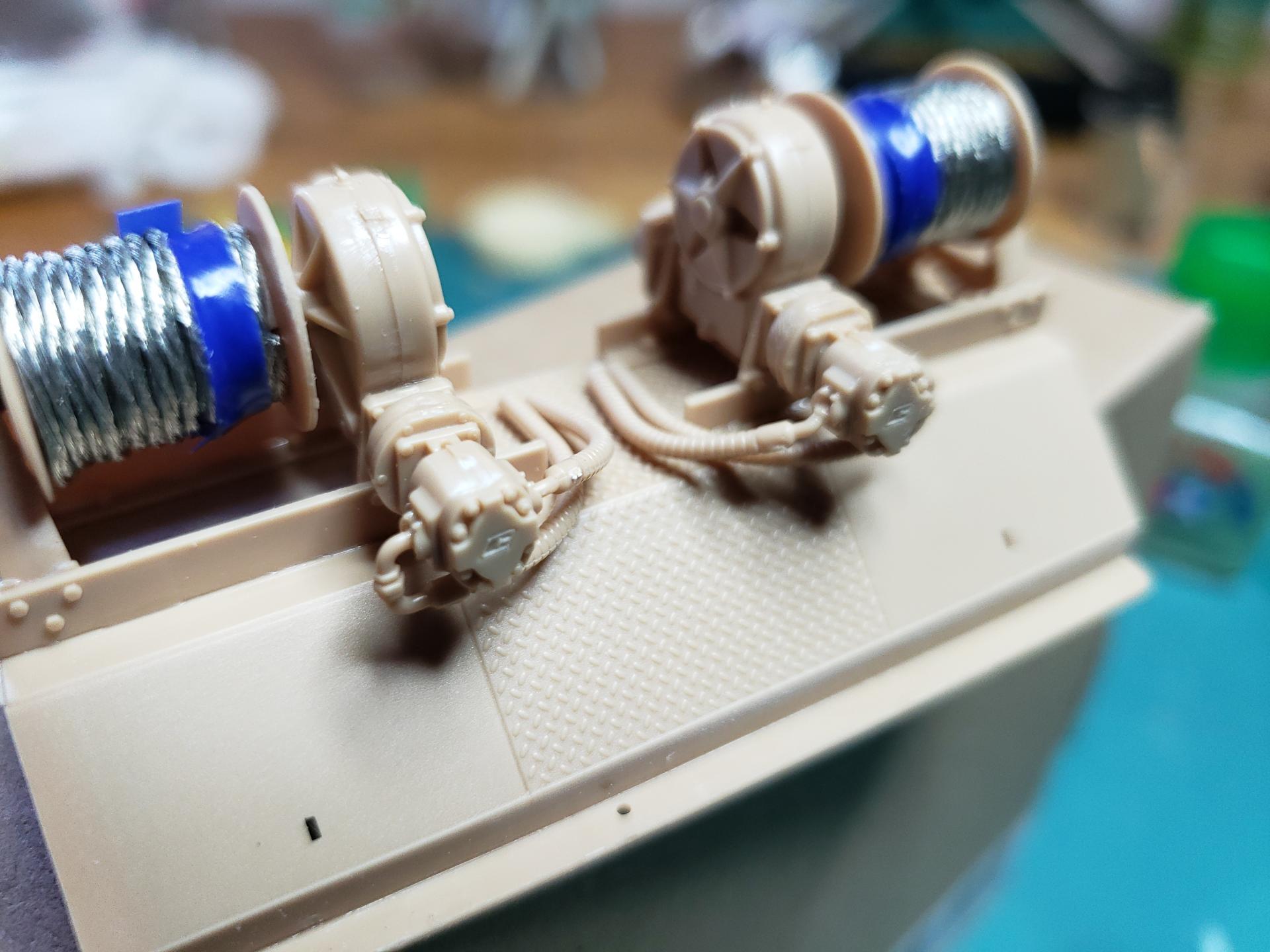

This truck uses a twin "tulsa "drag winch to pull equipment onto the trailer, included was fine steel wire for the wire rope.

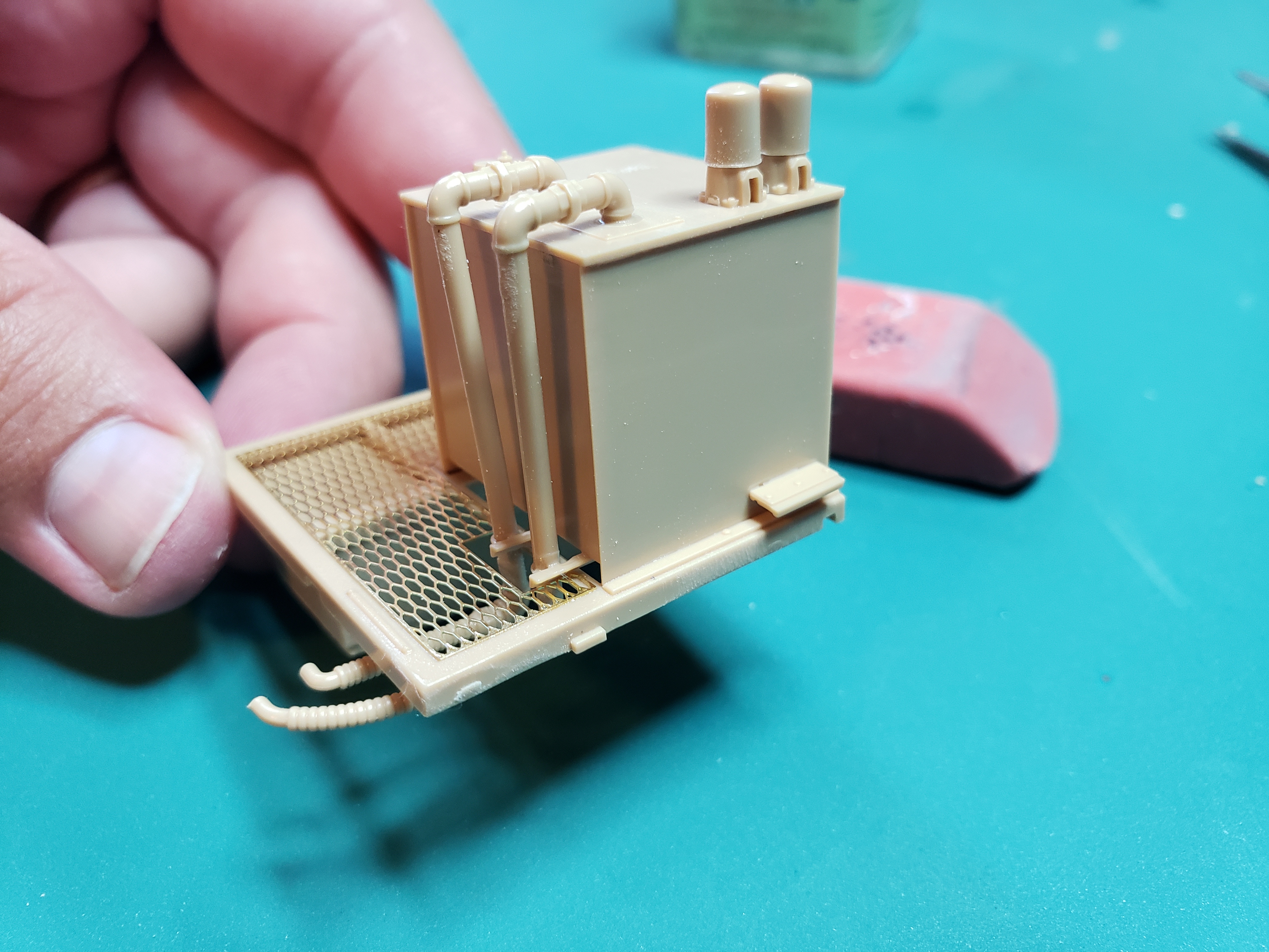

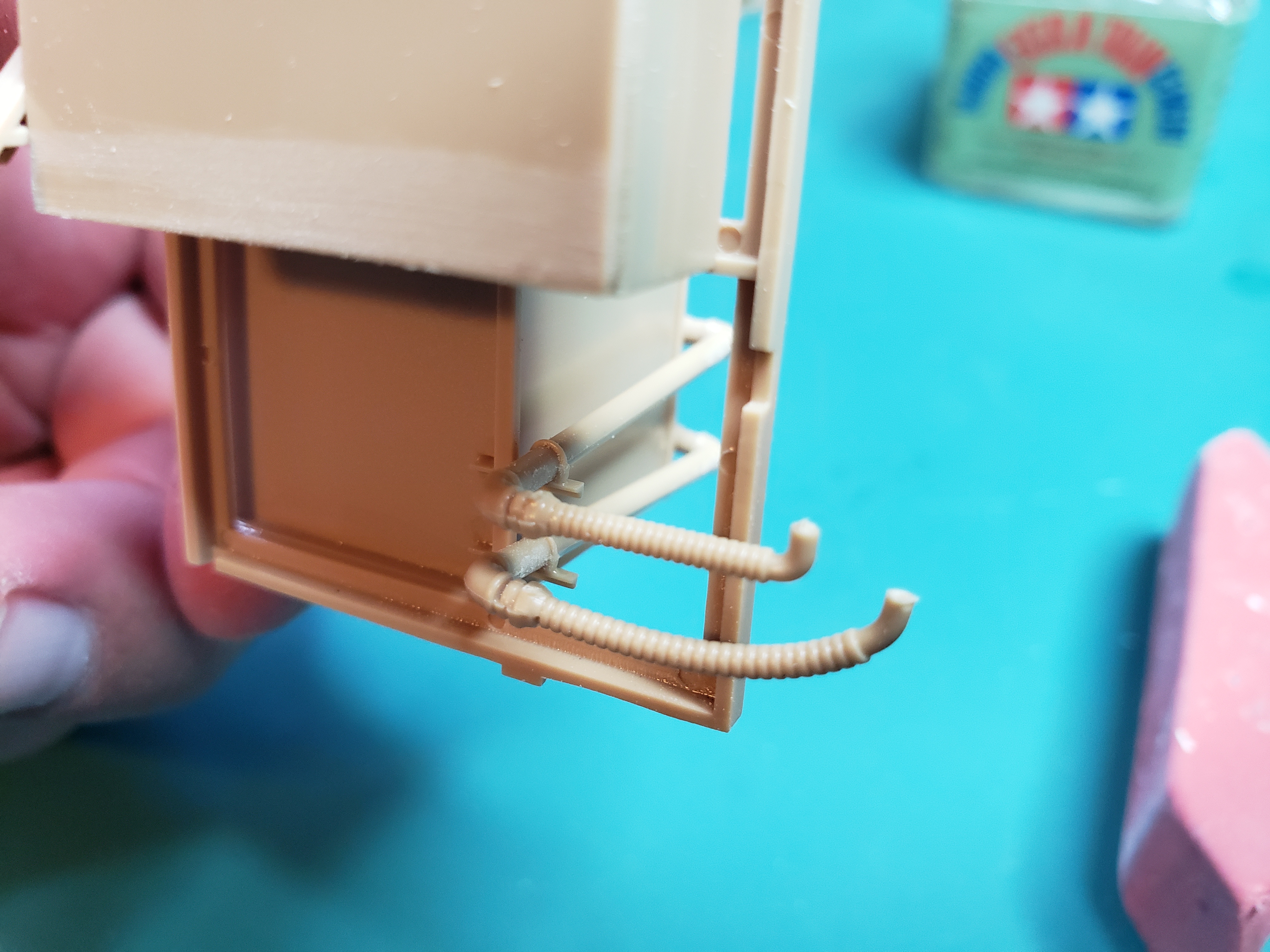

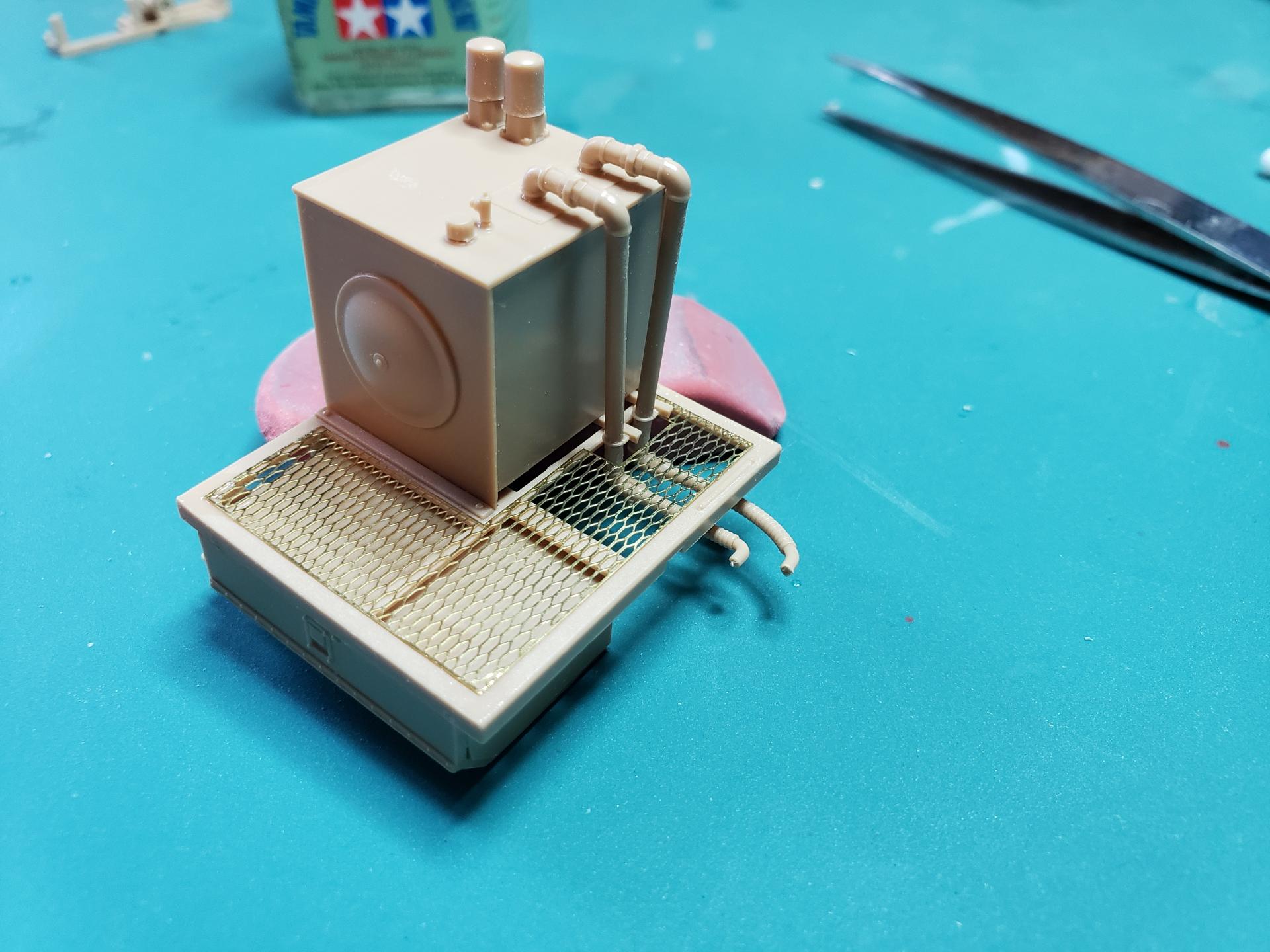

Next up was the hydraulic tank and plumbing..I'm very impressed with the detail here..the hoses even have coiled look

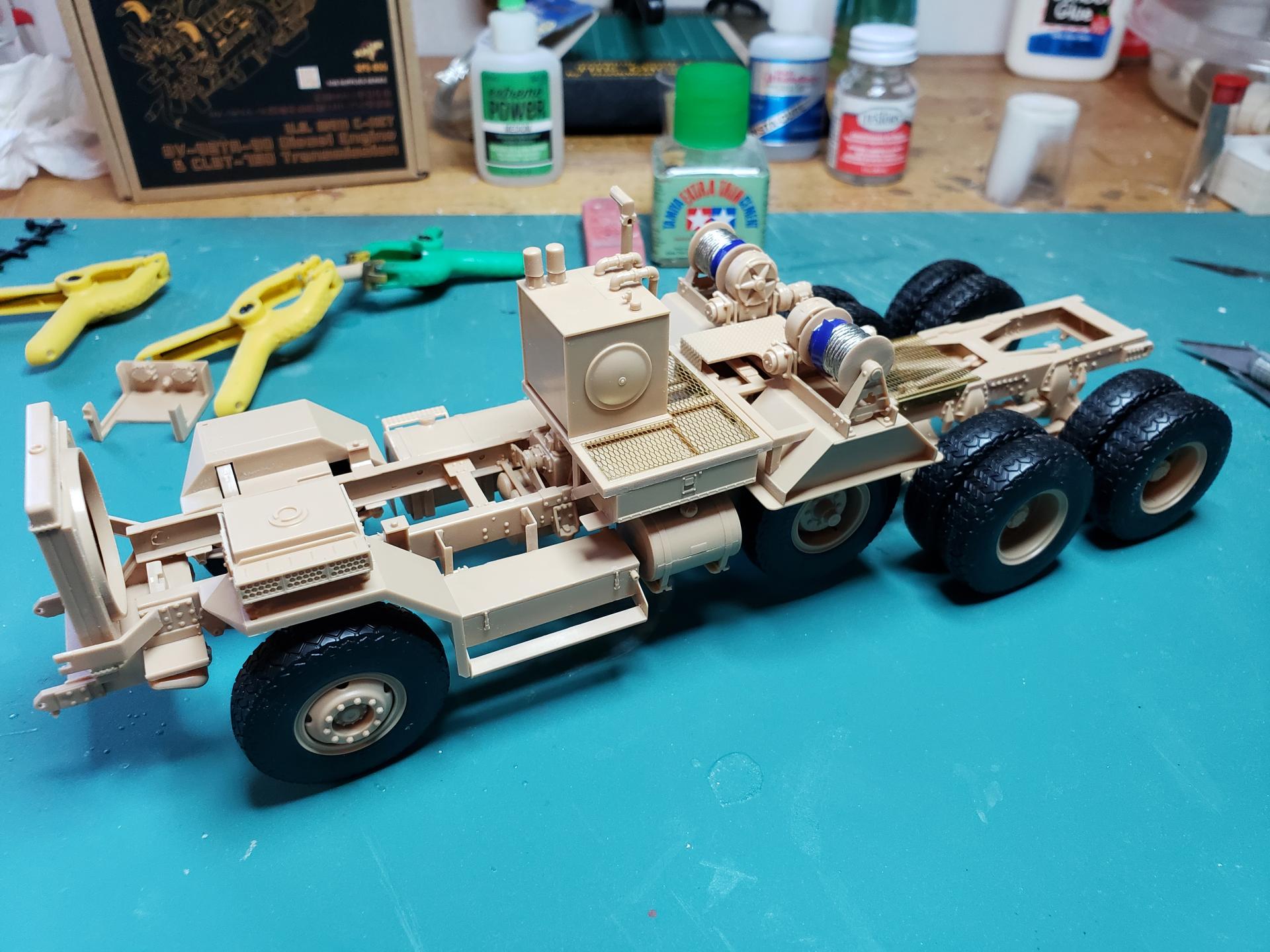

I favorite part..mock up !!!  Small spots of ca glue holds it together..

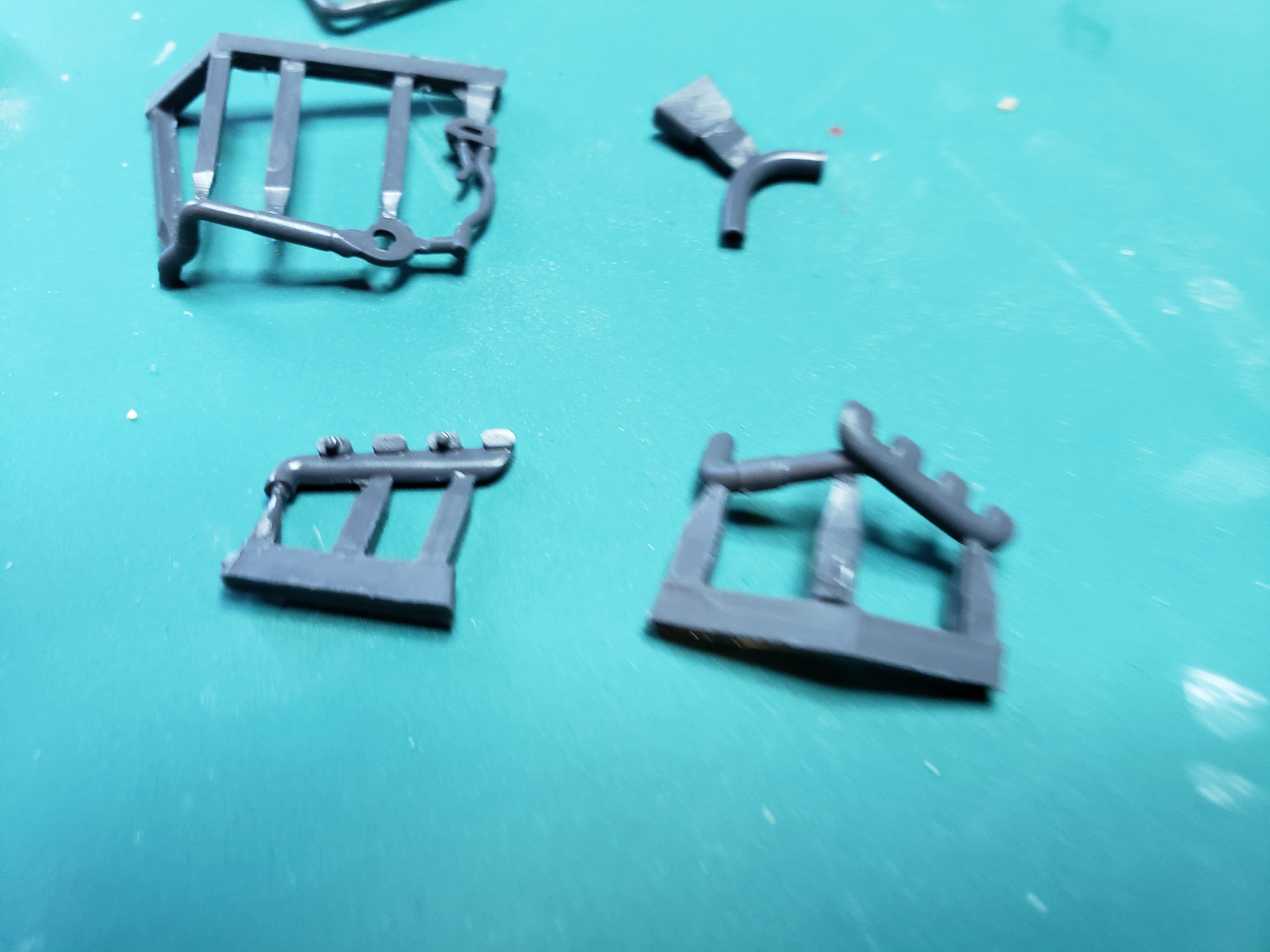

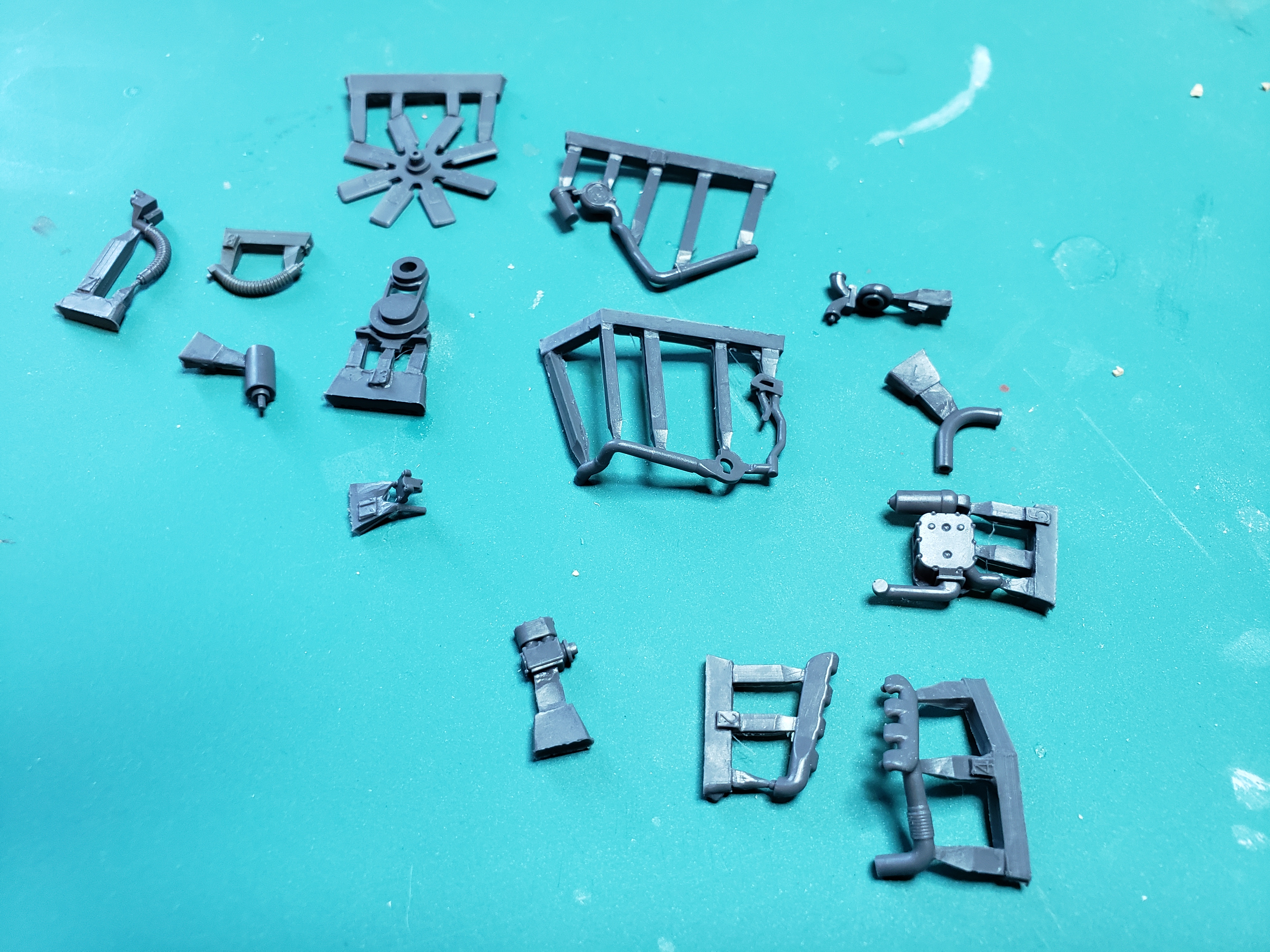

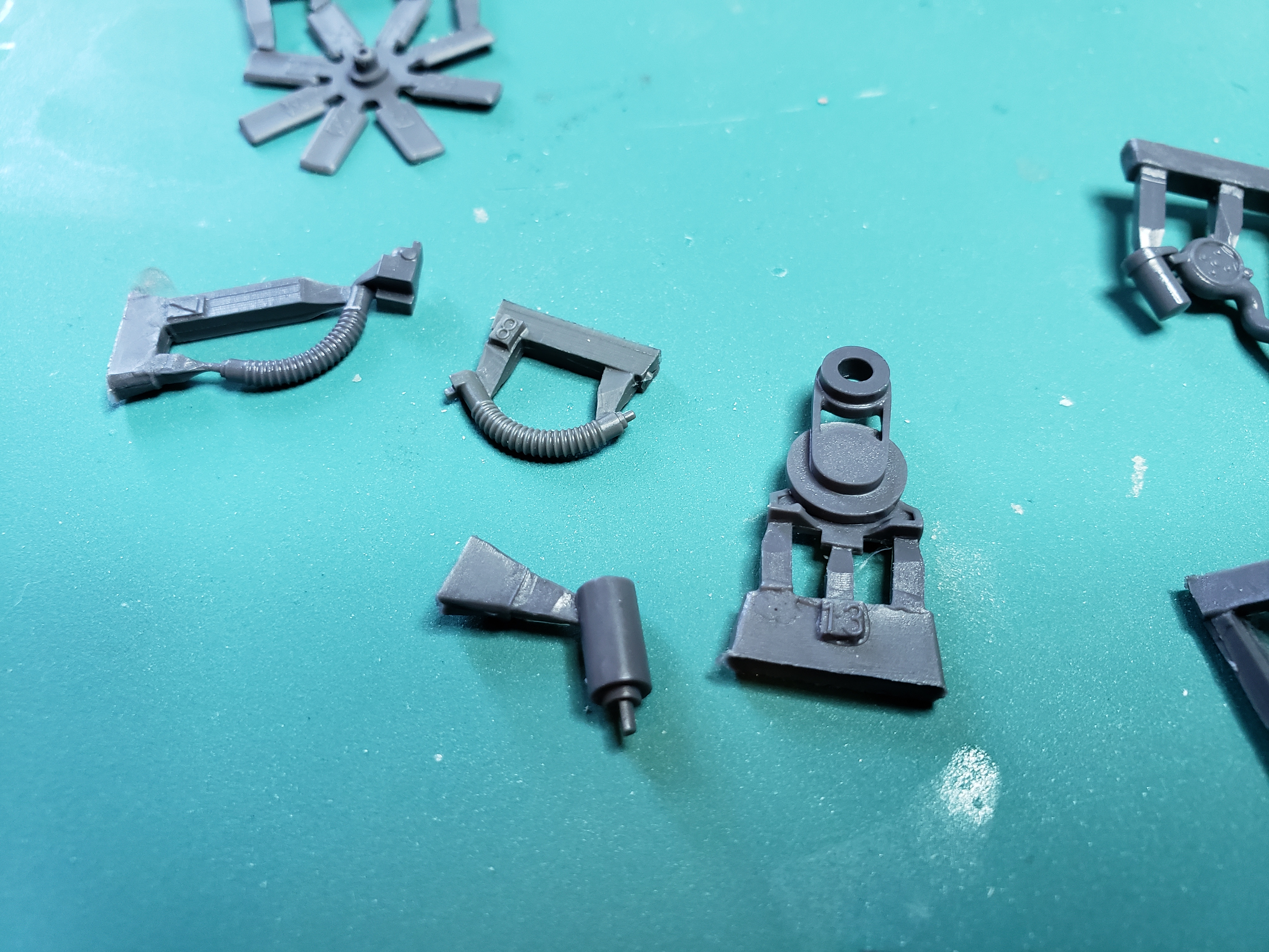

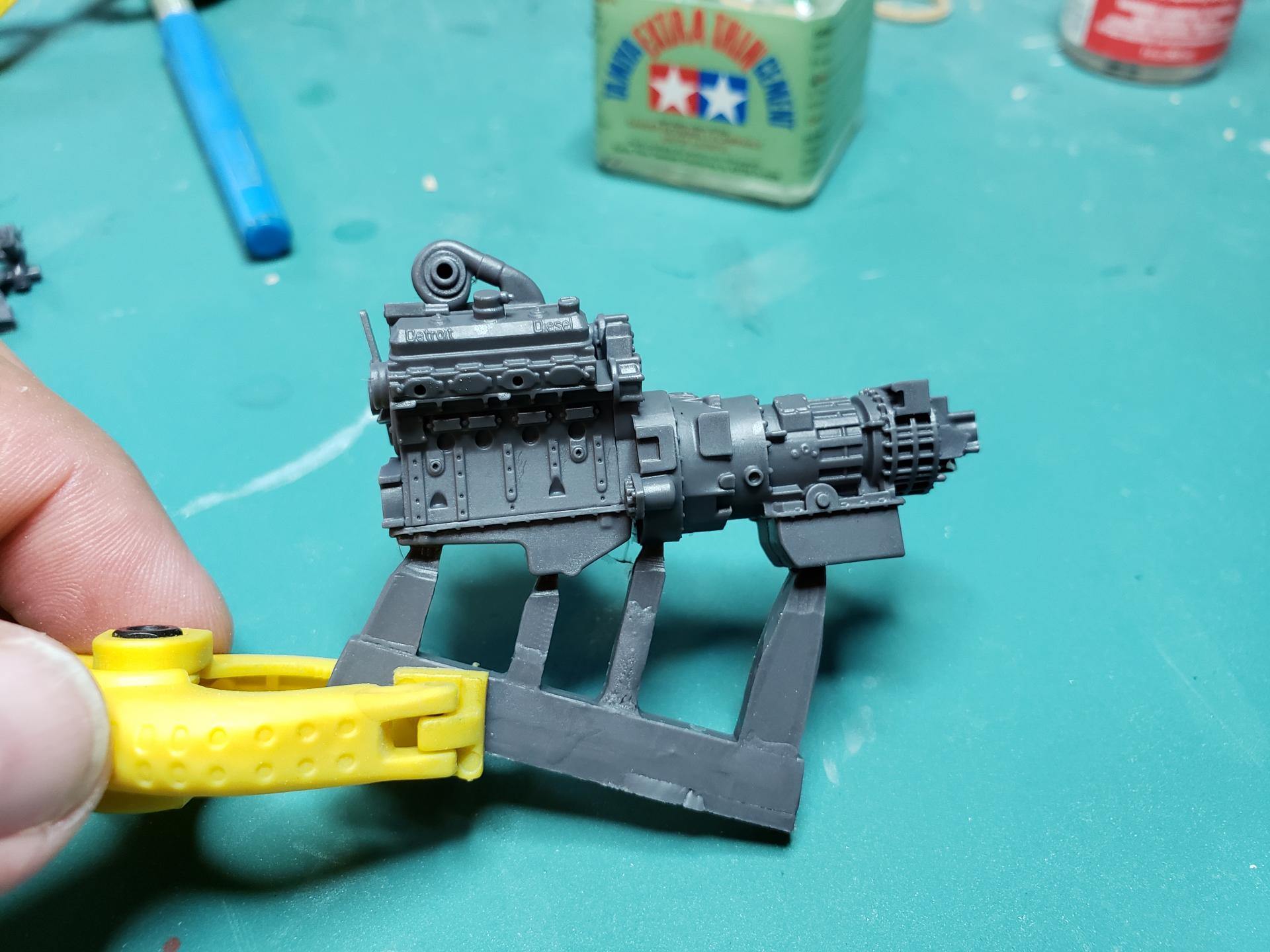

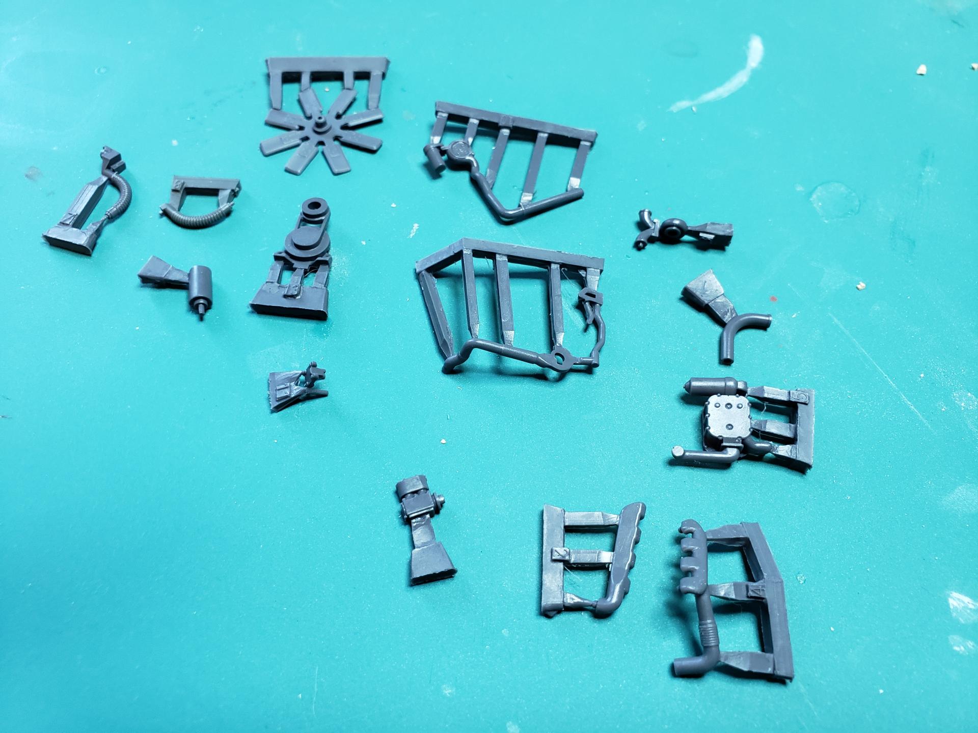

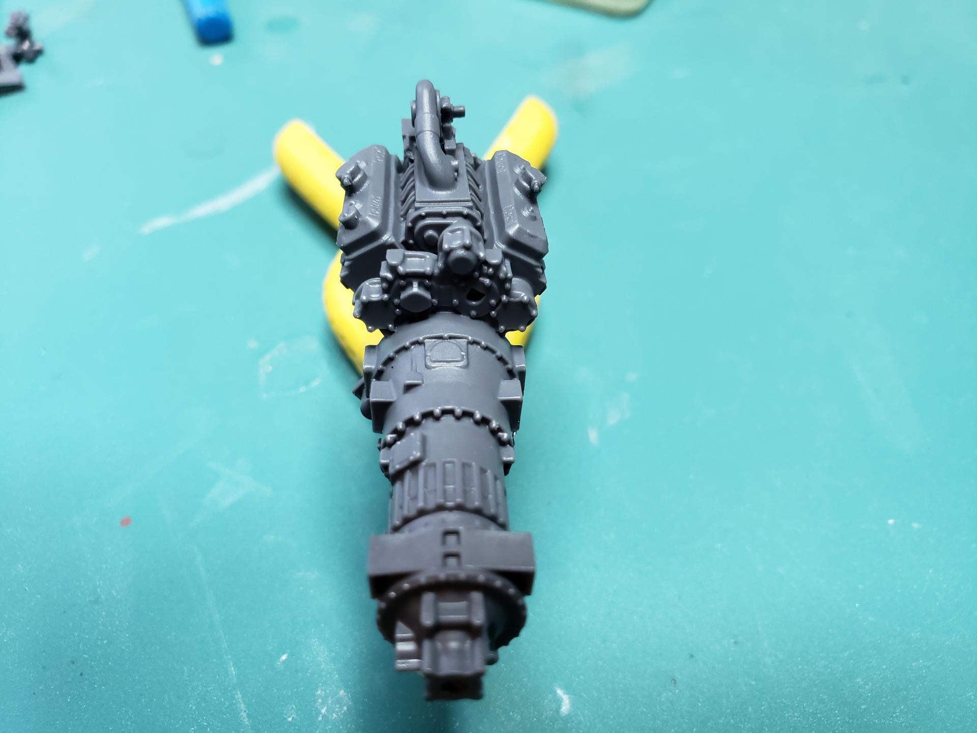

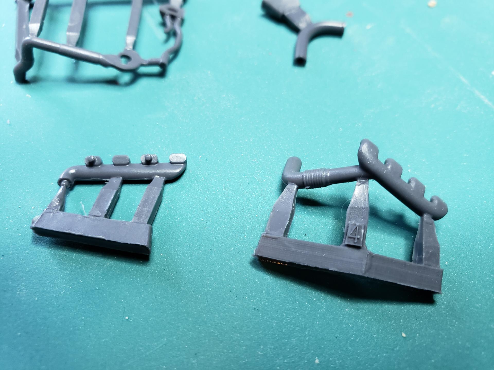

Sharp eyed builders will spot the air cleaner riding on the fender and radiator....which means there must be a Detroit nearby...these pics show the excellent detail included.  I literally pulled each part from package and snapped pic..still can't believe it's one piece molding...enjoy !!

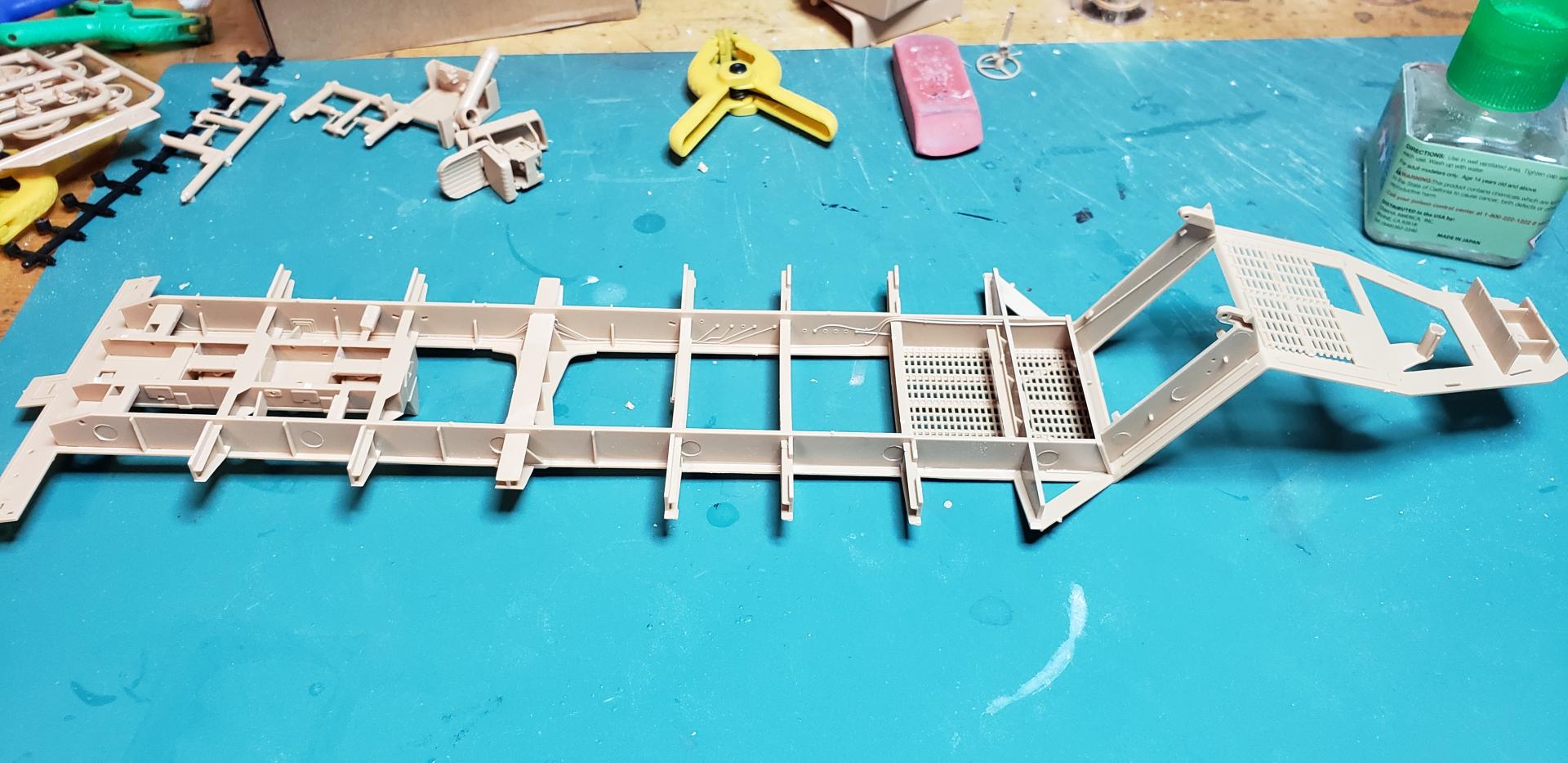

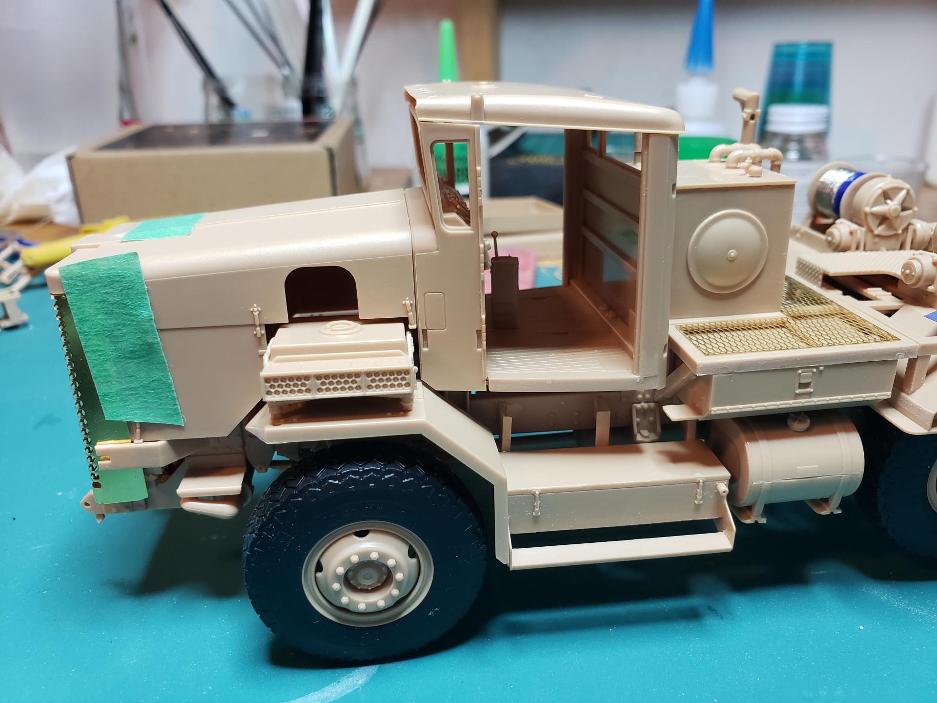

Quick mock up of progress 20180713_220019.thumb.jpg.44c98bfeae56e5bfd24e1e1d3fe05684.jpg20180713_220031.thumb.jpg.73e6944f26a52ee6040bbd7d98d5be86.jpg
planning to open the bottom side panel showing off the engine,  still working out how to support the etch grill after removing the panel.most pics of ODS trucks have these sides removed...whether for cooling or easier access.

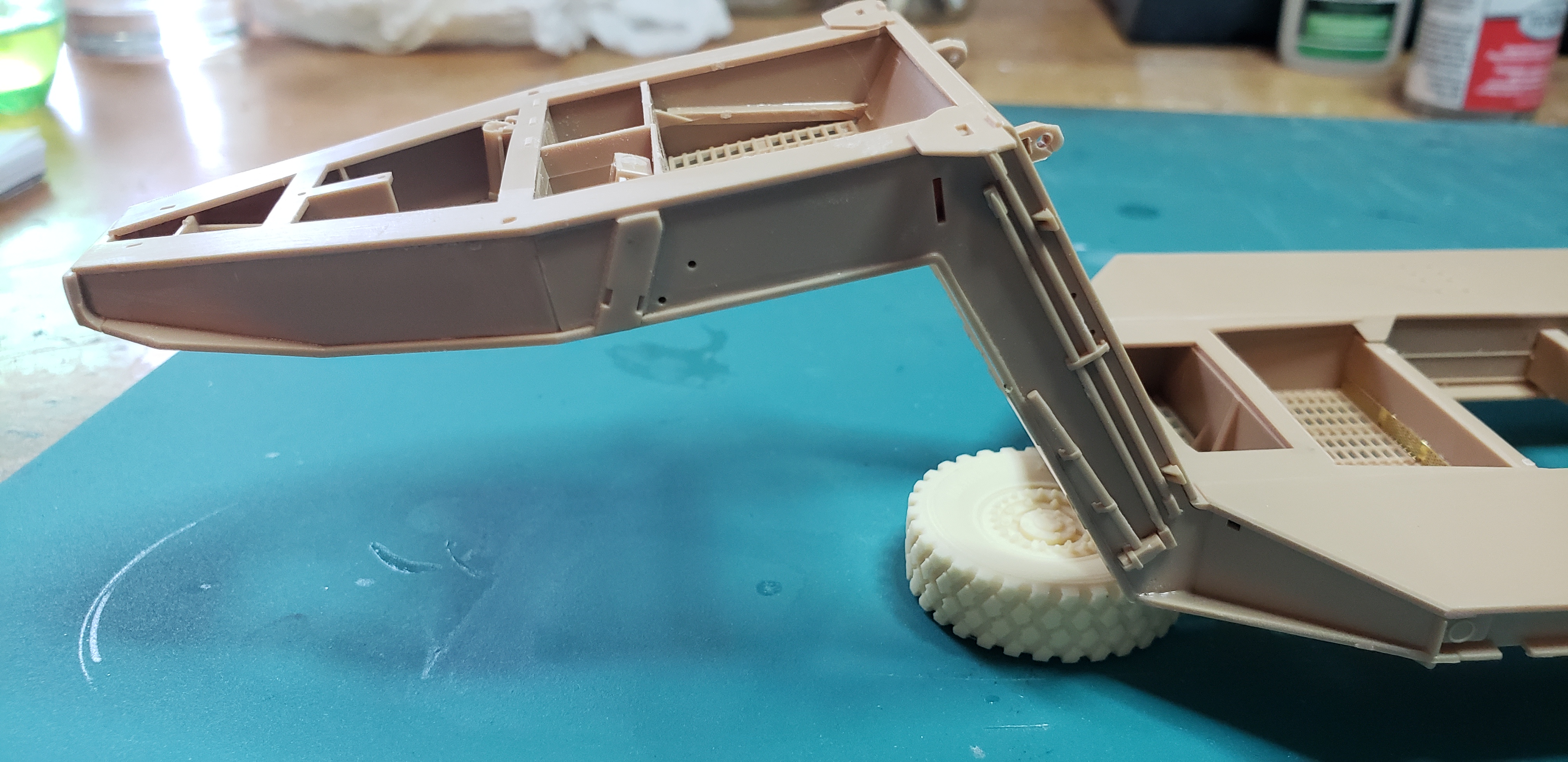

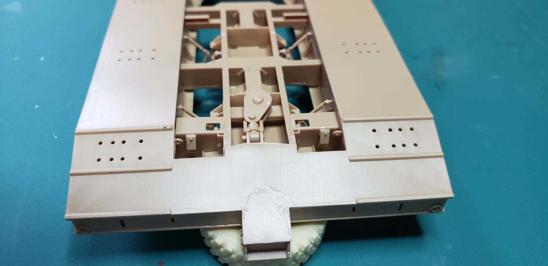

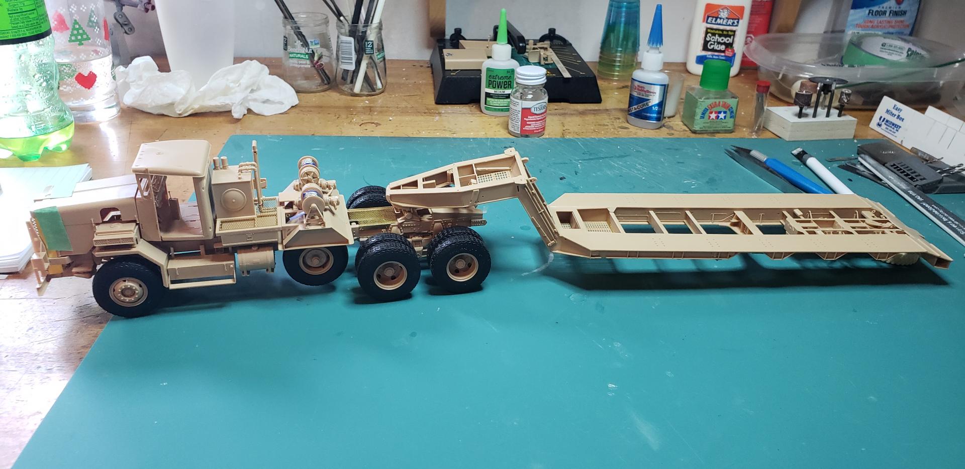

Jumping ahead...I started the M747 heavy trailer...a few hrs of work and we have this...20180714_113121.thumb.jpg.1bd803bd781d61fc209c57a962baf4fc.jpg
Cool huh !!!!

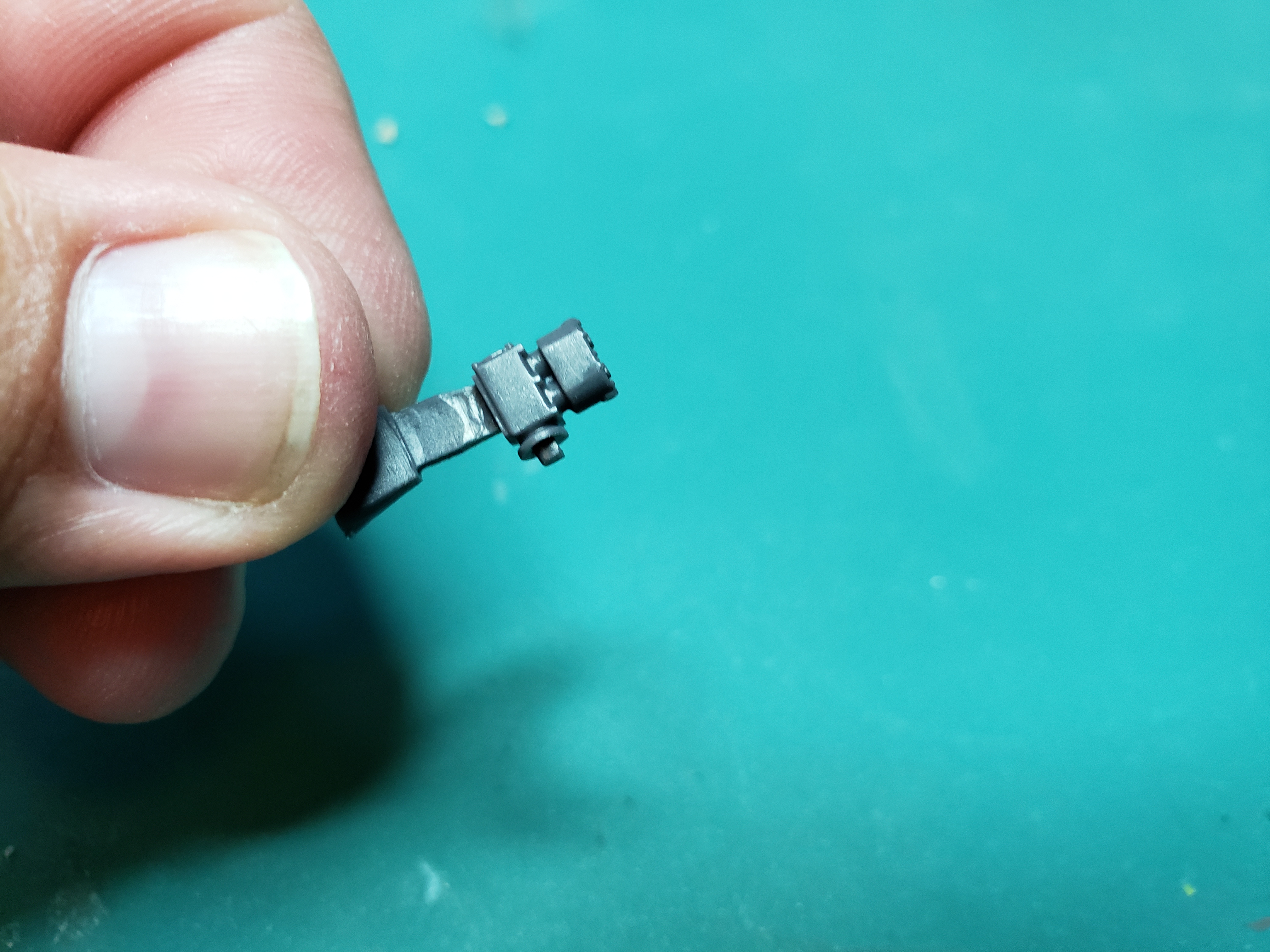

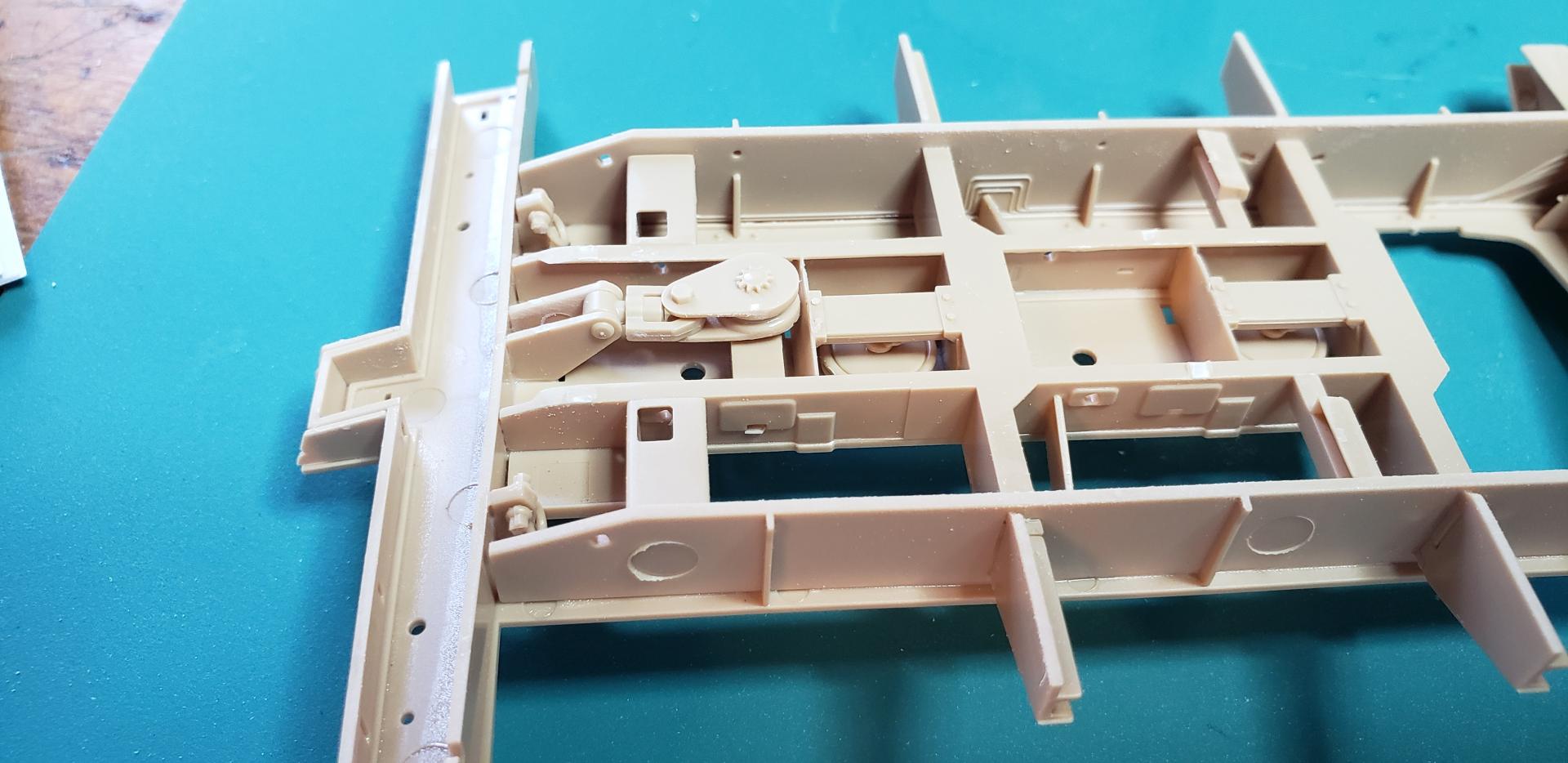

A few close up shots of the itty bitty details lurking
20180713_233120.thumb.jpg.2024ea762efcd7f4ce8bf27d8351dcb2.jpg20180714_113027.thumb.jpg.dd59f7546e182d3fc2b0d2cf0bd4af9b.jpg20180714_101718.thumb.jpg.38e3215263e8f927f1a98ac064920f7d.jpg20180714_112928.thumb.jpg.c1d9e1bb0dc9b7f26afff7040923a586.jpg
they included the precision hammer on the gooseneck and plumbing lines. I tried to snap a close up of the tie down cleats inside the trailer hopefully they show.i lost a few to carpet monster ...his name is Fred..lucky Meng included spares ...lots of spares lol.
I'm really bummed those knock out spots are so visable now...
The deck will receive a heavily worn finish using the "hairspray " method  leaving a multi layered finish.
More to come !!

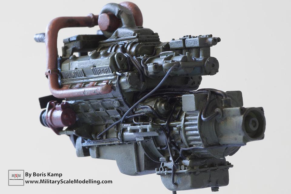

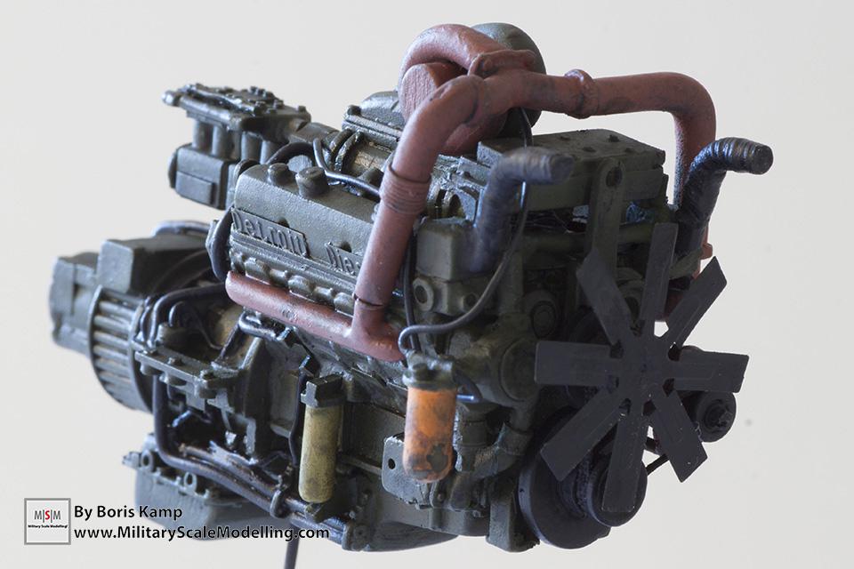

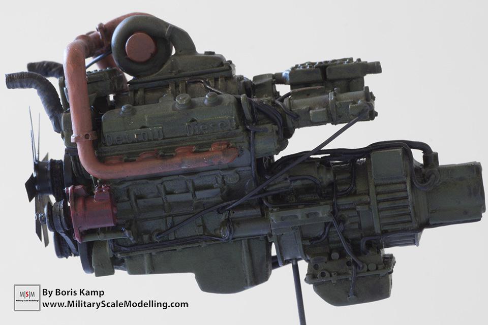

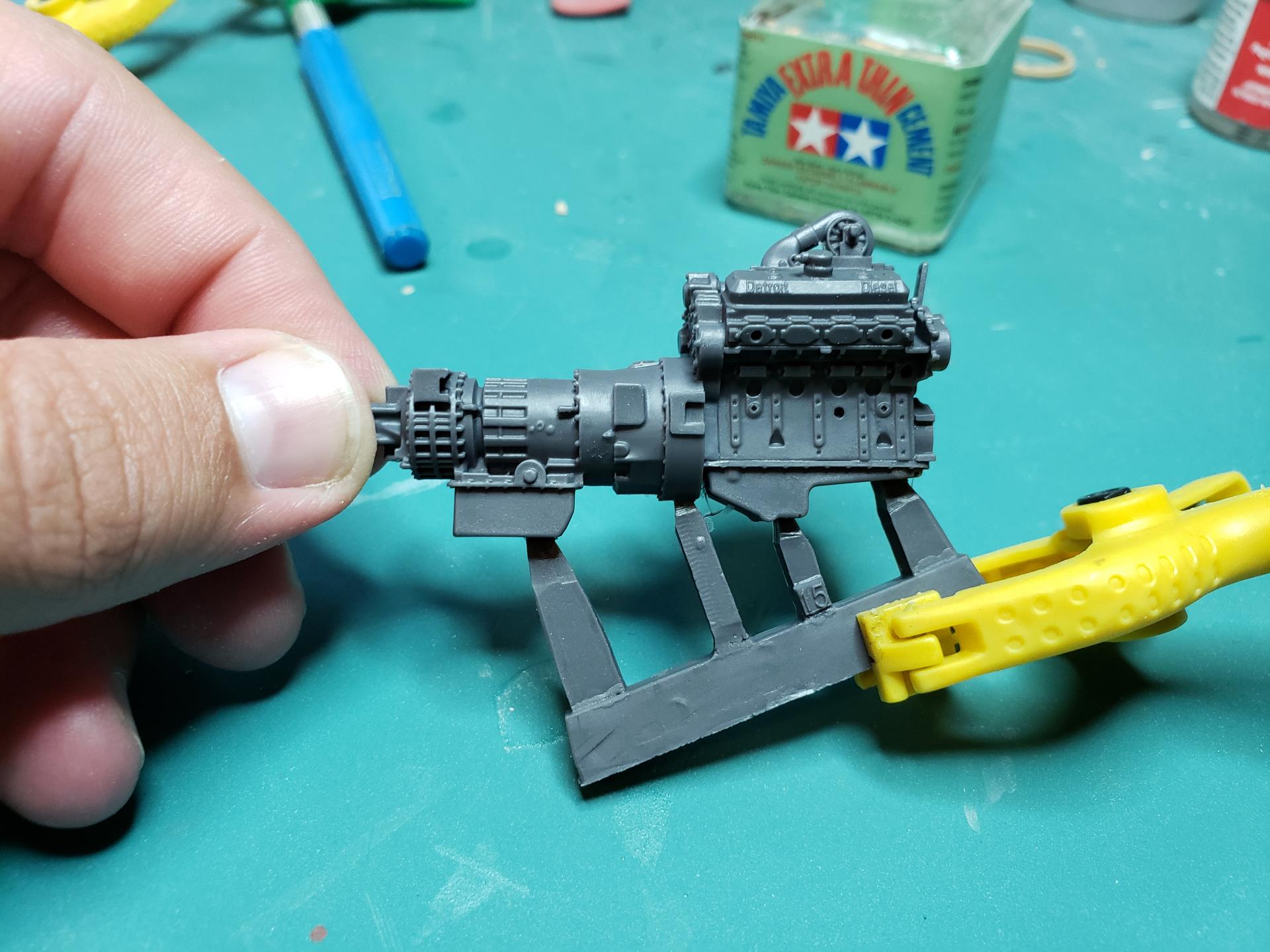

I bought two of these 1/35 Real Model Detroit Diesel kits a few years ago. (They come with a new floor and firewall for the M1070 cab for clearance). One for my M1070/M1000 kit and one for my Hobbyboss M911 kit when I get it. You think that Meng Detroit is detailed, look at this! It comes detailed with the hoses and everything molded in! Makes me wonder how they even molded it!?

Very cool Ben !!! Miroslav from Real models makes outstanding products for certain.  I used his 5 ton wrecker conversion for a 800 series wrecker I drove on Ft Hood . The details were fantastic.
Edited by gotnitro?
At half the price of the Meng engine, it's just as good.
Did you build the engine yet? If you followed the instructions, you and Boris aren't going to like this.
F8BEA0B3-FF45-4742-AA77-EE43A73B9528.jpeg.db55f889bed80caa89ca60ab9a69d428.jpg.6104866b187ed125c4c6a6b2d4bea93c.jpg
I pointed this out to Miroslav, the owner of Real Model when  it was first released. You always gotta have references handy just in case. ;)

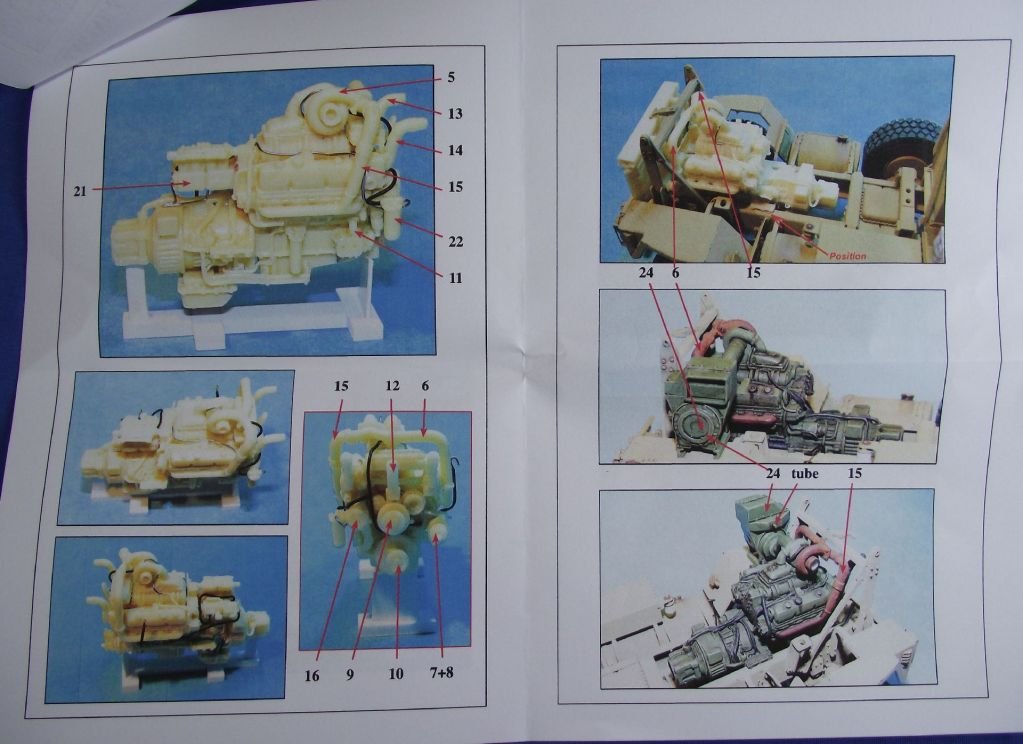

So, on the parts that are wrong, part 20 goes where part 21 is located and then part 21 goes where part 20 was? And part 20 is reinstalled at a 60 degree angle?

Roger. This is how the parts are supposed to be attached:
Additionally, an accessory pulley is supposed to be mounted where Part 21 is shown to be attached. It powers a secondary  alternator which I had to scratchbuild, along with the associated brackets. The angle and length of the dipstick tube, as shown in the instructions, is wrong. First, the engine wouldn't fit on the kit frame if the tube was installed as in the instructions. Second, it has to be installed at the angle you see on my engine.
Please excuse the quality of my engine. It's not because I don't know how to build resin kits. I originally bought and photographed this in 2013. Miroslav sent me a real piece of garbage casting. As you can see, in addition to broken or missing parts, the details, when compared to Boris's and yours,  are either extremely soft or not included on mine. What you see isn't a lousy paint job. That's the rough casting surface under a single airbrushed coat of Detroit Diesel Green. To say I was pissed about the substandard quality of this particular engine would be an understatement. Yours, and others I later bought,were made with a new mold.
