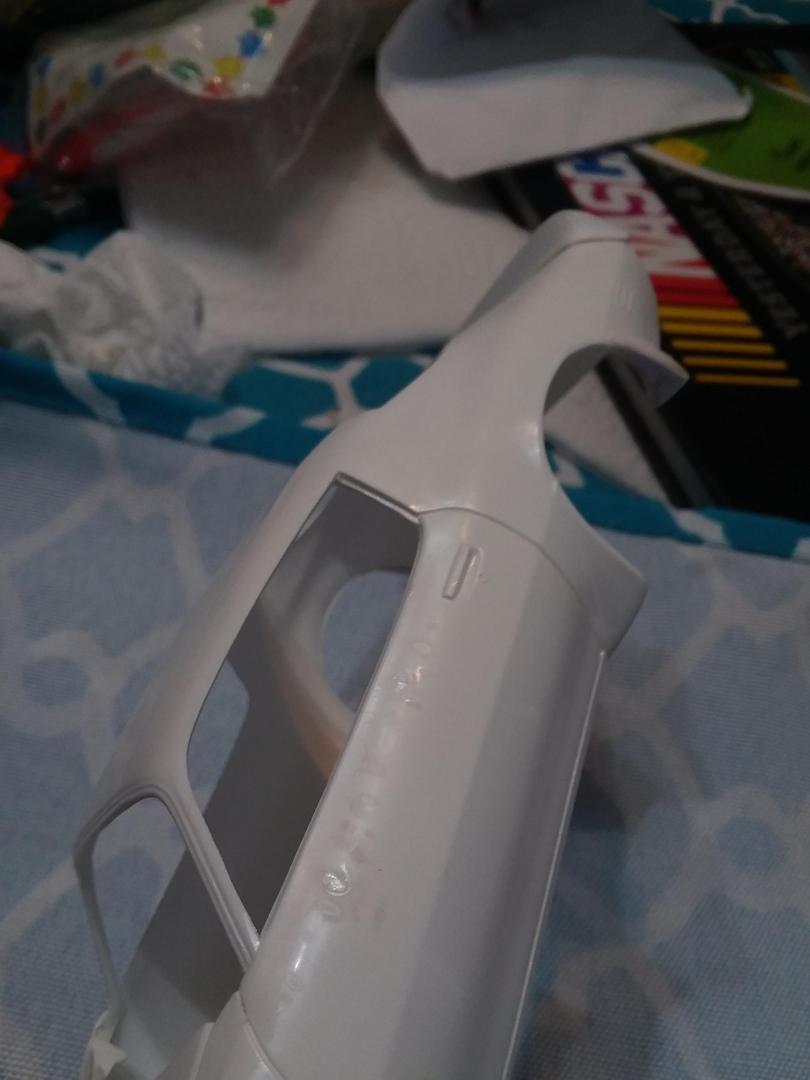

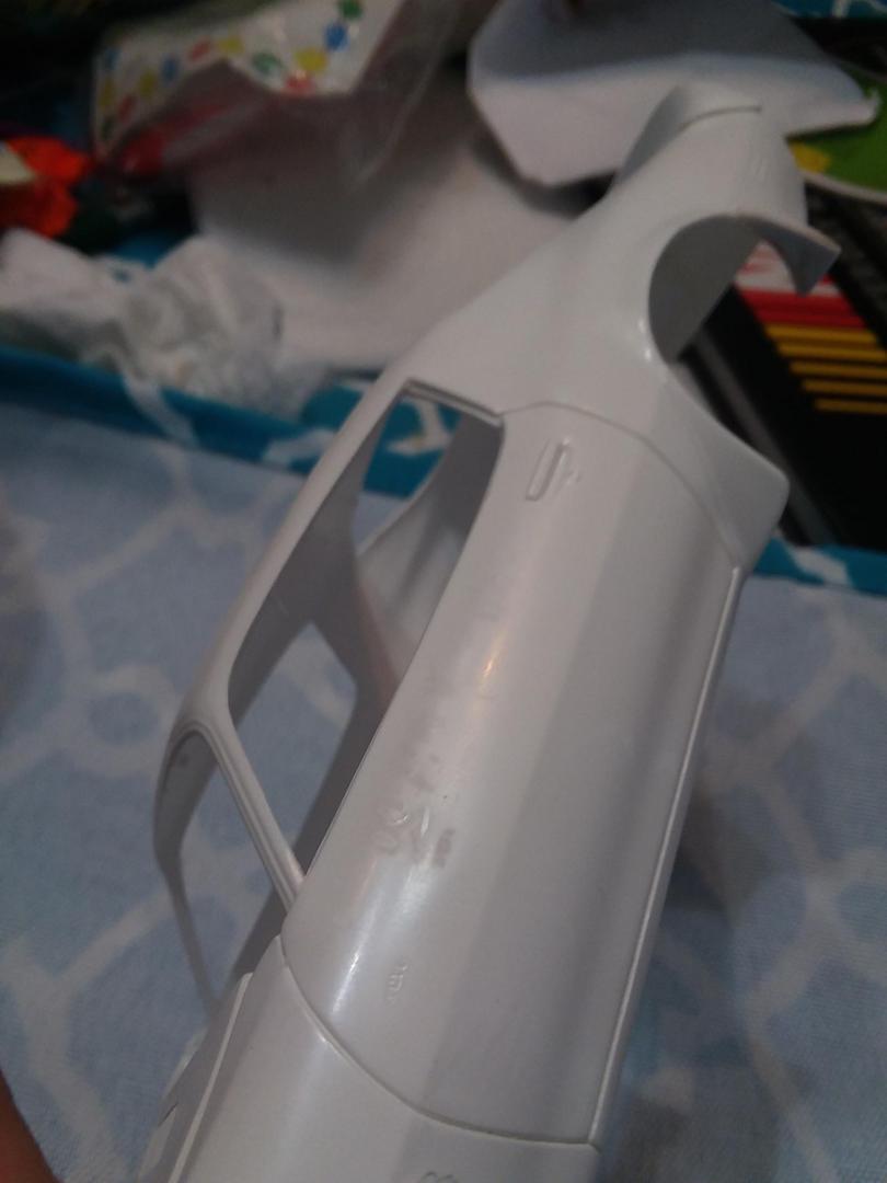

Oldcarfan27 Posted July 6, 2018 Posted July 6, 2018 I just recently opened this older (90's issue) Monogram '70 Trans Am kit to build. The inner bags were still sealed and I purchased the kit new way back when, so I know how it was stored - Indoors in my spare room. However, when I opened it all up, I found small burn marks on the drivers door. Right where it was resting against the inner bag. It's not major, I can sand it out, but it does raise the concern - We used to have to isolate the vinyl tires from the plastic to avoid "Tire Burn". Now I have to wonder if the BAGS they came packaged in can also do the same damage! Has anyone else had this issue happen to them? If so what did you do to resolve it? Is anyone else concerned about this problem? How are we going to know what plastics have what effects on other plastics while in storage?

espo Posted July 6, 2018 Posted July 6, 2018 This looks to me as if this model has been exposed to a high heat situation at some point in time. From what you're saying the storage since you have had it would not cause this to happen. So it just may be that from the time it was created, packaged, shipped to the warehouse, and then the retail point it may have been stored in such a way that the wrapping melted to the body. At least you can correct it with little effort and that's a good thing.
Oldcarfan27 Posted July 6, 2018 Author Posted July 6, 2018 5 hours ago, Roncla said: Thats opening a can of worms and something else to worry about when storing our stash. I wouldn't be surprised if the plastic bags varied in composition as much as the kits do. Yep, that's my point. What if the BAGS contain the same chemicals as the tires! Now we're going to have to check our stashes for the very thing we thought was protecting them!

SfanGoch Posted July 6, 2018 Posted July 6, 2018 3 hours ago, Oldcarfan27 said: Yep, that's my point. What if the BAGS contain the same chemicals as the tires! Now we're going to have to check our stashes for the very thing we thought was protecting them! The plastic bags are made from polypropylene, which is stable and doesn't leach any chemicals. That's why it's used for ziploc food bags, food containers, etc. The chemicals used to make the tires cause an exothermic reaction when they leach out of these molded tires, generating heat. This is what "tire melt/burn" is. Even if bagged separately, the heat generated is strong enough to melt any polystyrene it come in contact with without damaging the polypropylene packing bag.
