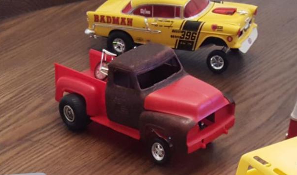

Lordmodelbuilder Posted July 10, 2018 Posted July 10, 2018 Here is an MPC 53 f100 that I chopped without adding any material to the roof. I just cut the A-pillars at the bottom and leaned them back. Still needs some work,but you can get an idea how it was done.

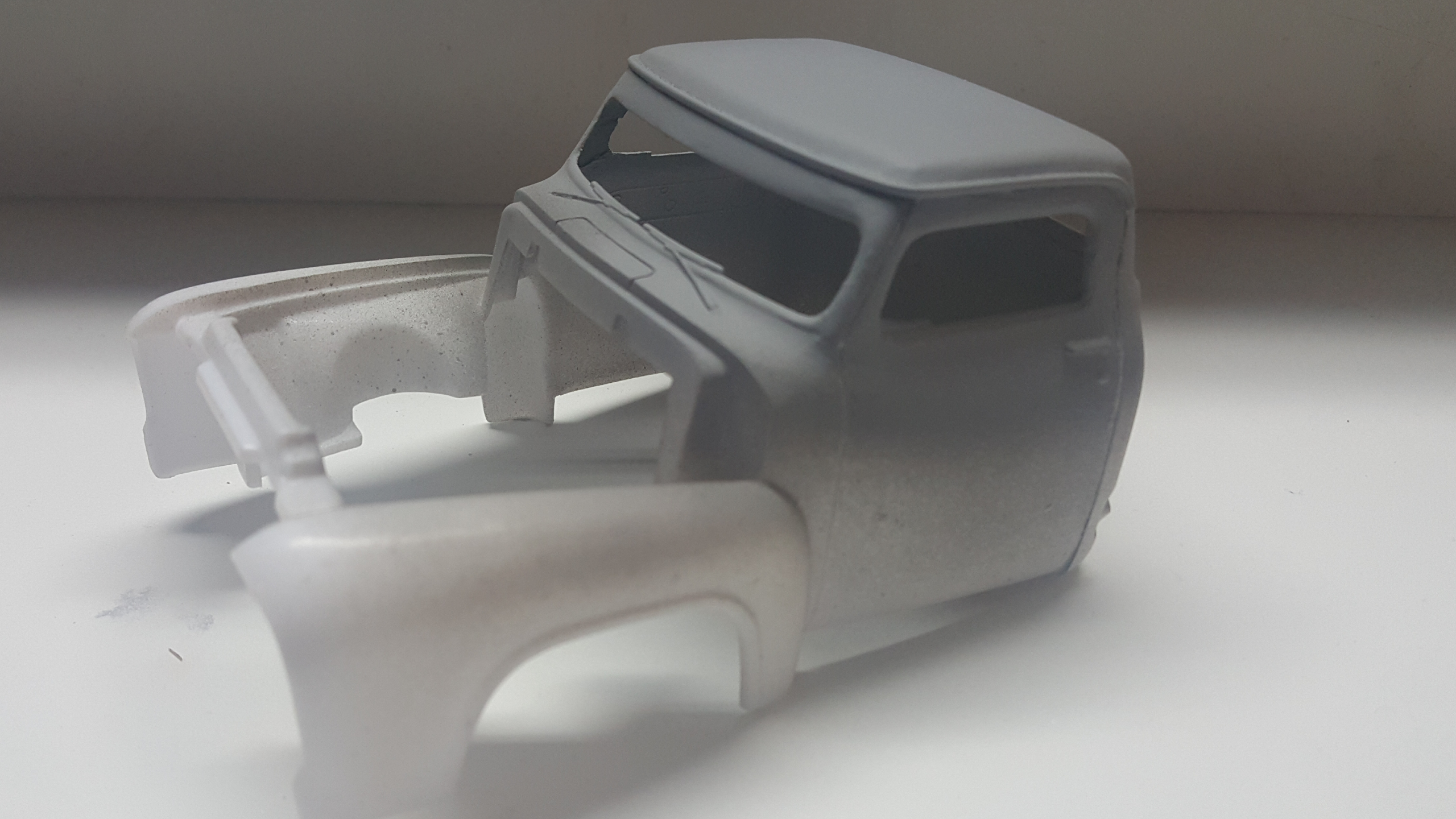

disconovaman Posted July 12, 2018 Author Posted July 12, 2018 Choppin, cuttin, and grindin on this turd... l filed off all the mold lines, driprails, rubber moldings, and bodylines. I have to say I am satisfied on the height of the top and windows overall it's not too bad, if I can get the bodylines and details re-shaped I think I can save this cab...
disconovaman Posted July 12, 2018 Author Posted July 12, 2018 Oh wow! It looks terrible in the picture... freakin hi def camera phones! Lol! I didn't look at the photo until after I posted it... It really doesn't look that bad...

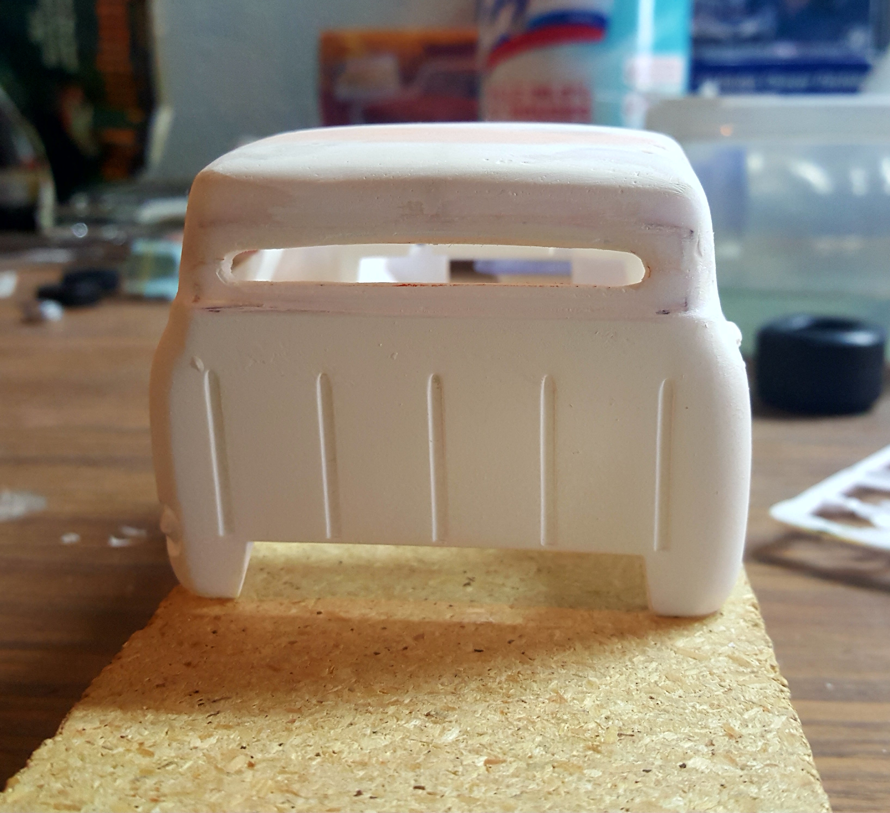

disconovaman Posted July 19, 2018 Author Posted July 19, 2018 I wanted the "mail-slot" back window on it so what I did was cut the back window out... then I sectioned it seperate from the cab then I made the chop on the cab to fit the back window...well kinda. It's rough... I hope I can salvage it... my regret is I wished I would've googled how to chop the cab before. Thanks for the encouragement guys. More later...

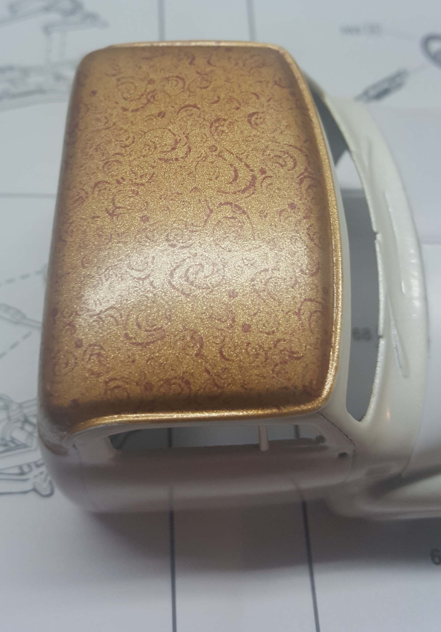

disconovaman Posted August 28, 2018 Author Posted August 28, 2018 I completed the bodywork and laid down a pearl white, gold top, and purple lace paint job. Things will start to come together quicker now. Thanks for looking, more to come...

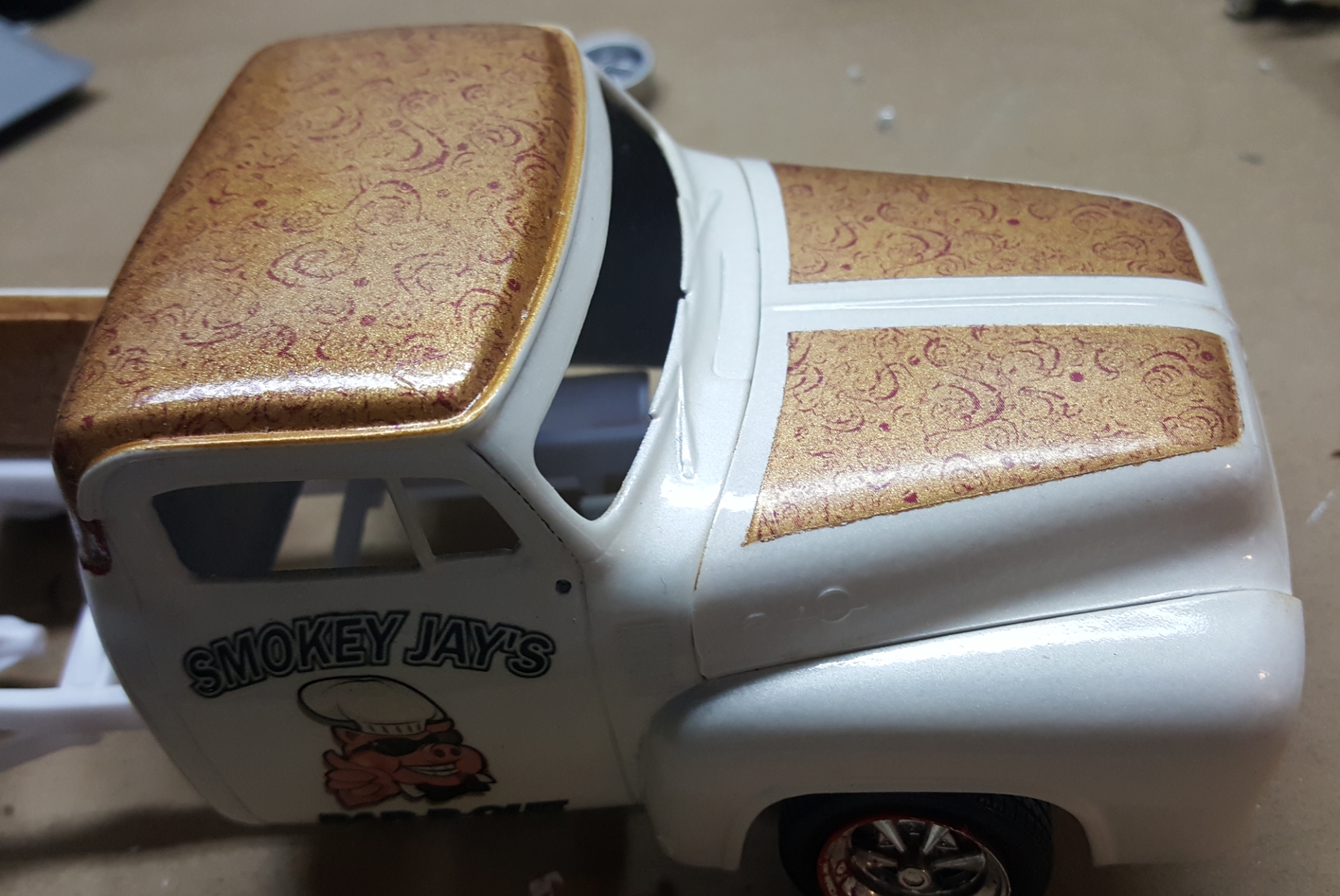

TarheelRick Posted September 30, 2018 Posted September 30, 2018 Good looking chop job and I like your overall vision of this build. One thing I may suggest is to open up the top of the windshield area, it appears to be too wide below the drip rails (just my thoughts).

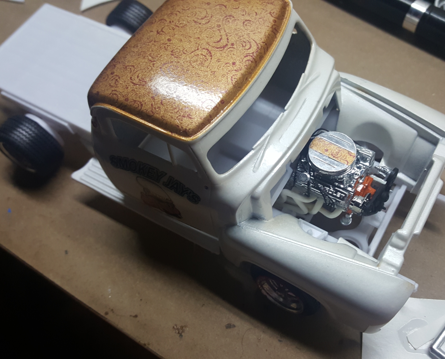

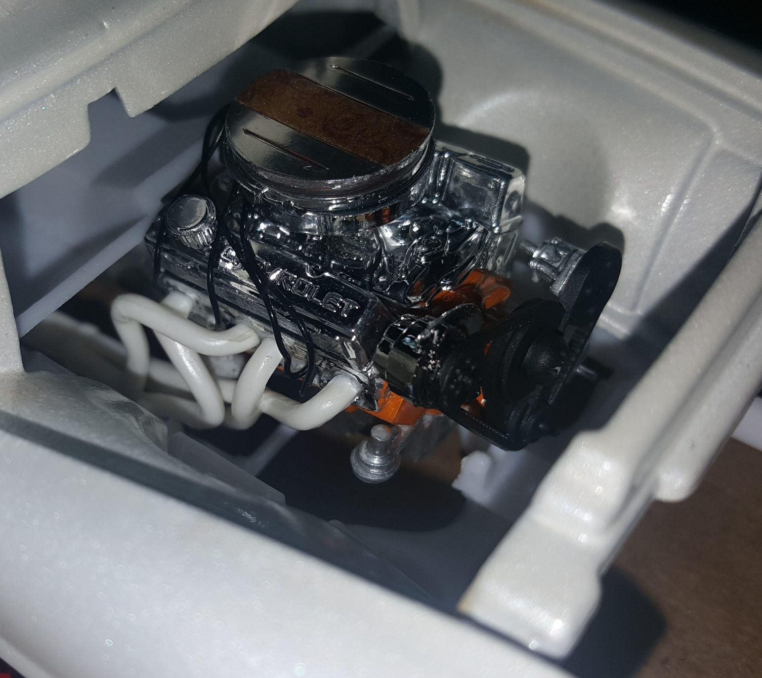

disconovaman Posted February 6, 2019 Author Posted February 6, 2019 Hey folks! I randomly got this thing out over the weekend and built a Chevy small block for it. And I desided it needed some matching panels on the hood too... I'm updating this thread so maybe it will inspire me to finish it. ?
