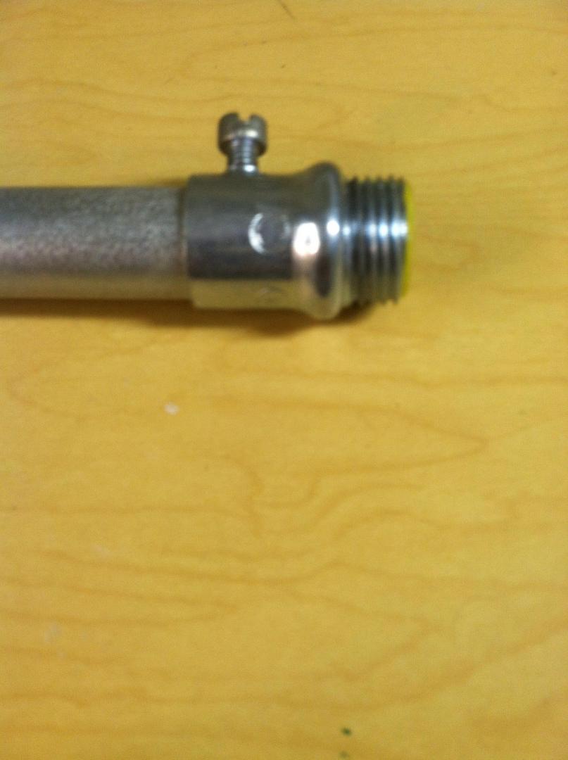

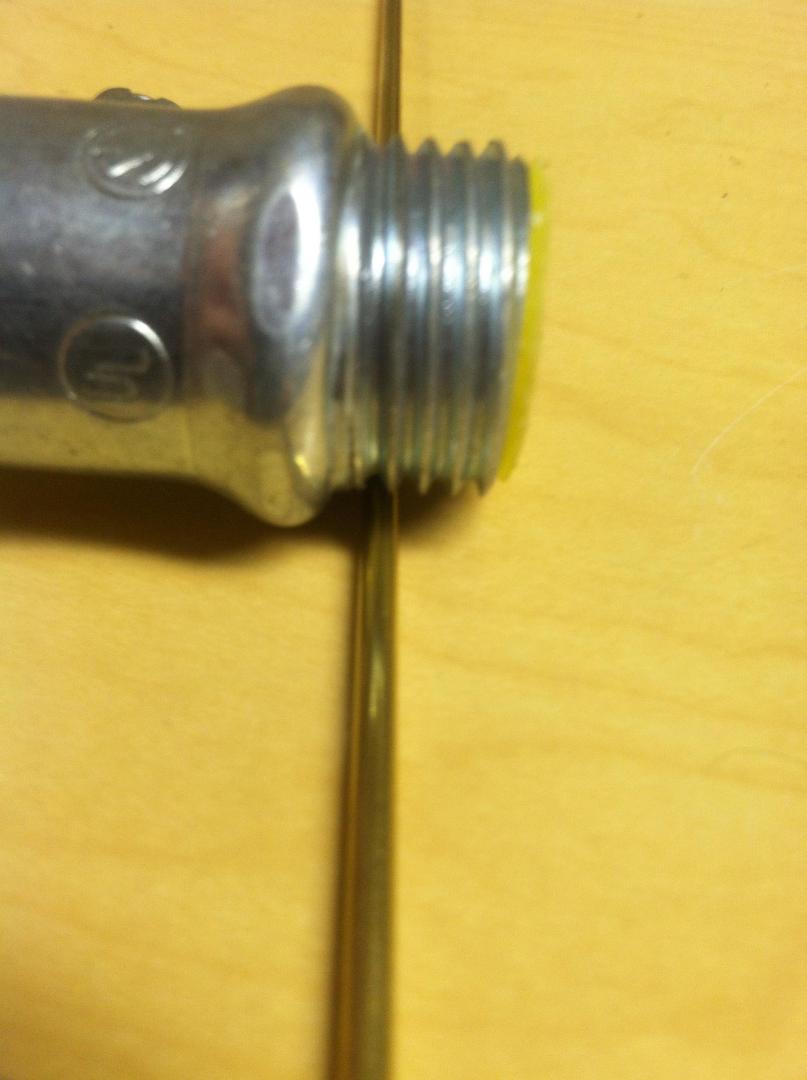

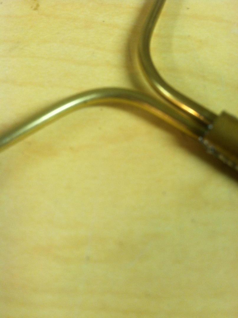

bill lanfear Posted July 18, 2018 Posted July 18, 2018 I recently bent some 1/8 brass tubing using a metal threaded piece of conduit. You can use about anything with threads that the tubing fits into. I placed the brass into the threads and bent the tube around to the degree I needed...worked great for me and no kinks.
