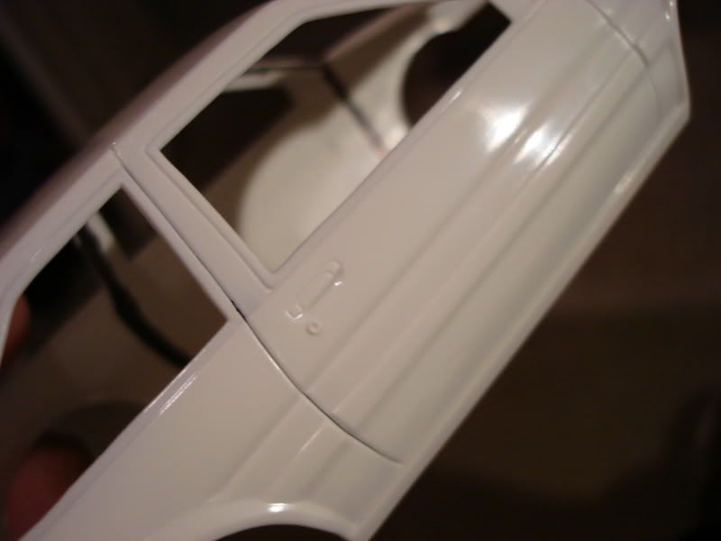

ttdriver Posted September 11, 2007 Posted September 11, 2007 Hey all, Jut wondering about the best way to deepen panel lines and what technical pens to use on them once the body is painted? Dave
crispy Posted September 11, 2007 Posted September 11, 2007 Hey all, Jut wondering about the best way to deepen panel lines and what technical pens to use on them once the body is painted? Dave Dave, this was talked about last week. Here is the link: http://www.modelcarsmag.com/forums/index.p...ic=6797&hl= I hope it helps! Chris
crispy Posted September 11, 2007 Posted September 11, 2007 I'd also like to add that after I wash the body, I start with the panel lines using those pens. I primer the body and do panel lines again. After each coat of primer and maybe the first few light coats of color and then stop. Let the last wet coat cover and that should deepen them and makes the line just a tad darker than the paint on the car. Chris
ttdriver Posted September 12, 2007 Posted September 12, 2007 I'd also like to add that after I wash the body, I start with the panel lines using those pens. I primer the body and do panel lines again. After each coat of primer and maybe the first few light coats of color and then stop. Let the last wet coat cover and that should deepen them and makes the line just a tad darker than the paint on the car. Chris Thanks Chris, maybe I should have looked around the forum a bit first There is an Art store in my local town that sell those so I have that covered I am still curious as to how you deepen the panel lines as the ones on the model I am working on are quite shallow. Dave
cruz Posted September 12, 2007 Posted September 12, 2007 Hey my friend, I like doing my panel lines this way, of course with all due respect to how the other guys have posted and given their recommendations. First I always deepen and scribe my lines on any model I start with. One thing to remember is that this is a very slow process because if you put too much pressure on the knife at the beginning of the process it will definetly run away from the line so you have to start applying very light pressure because later on you will be using the back part of the blade to finally scribe the amount of plastic you need to cut away. I like to go pretty deep to the point where you can start seeing the blade marks on the other side and then I even use a sharpie on the back side to be able to see the finished product, try it and as you can see by the photos it really works very good but again, you have to be patient with this process. You see, once you have a pretty deep scribed line on the model you will be able to put more pressure as you go for the simple fact that you have made a nice deep channel to follow. After this, I grab one of my Testors Metalizer paints and with a brush I start flowing paint into the scribed line. The Metalizers are perfect for this because they are very thin and watery paints and the capillary action will help you with the process. After this, I prime my body, I will add more paint into the lines and then I will start sanding my primer to get ready for painting. Sometimes I repeat this process at least 2 more times before adding my color coats. The good thing about this process is that you don't have to worry about your panel lines after you start painting, believe me, your paint will not cover them. As you can see by the pictures with the painted 57 Chevy, your lines will still look to scale after you are done. I have had people telling me that when they try it sometimes their lines come out a little too big but when I ask them why the usual response is that they hurried a little through the process. It is not for everyone but to me personally, panel lines are a must for any model because it is just the correct way of making that model look much more realistic. I have seen a lot of great paint jobs out there but to tell you the truth, I would rather be an amateur painter if I knew my panel lines looked good.
Zoom Zoom Posted September 12, 2007 Posted September 12, 2007 I only use the pen one time during the process; between color coats. Generally I prime, add color coat #1, wetsand, add panel lines w/.005 Pigma Micron, apply a few more light coats of color, then clear, then polish. If the lines are too faint to begin with, I have a couple of pointed scribing tools in my arsenal and a triangular-section riffler file. I'll open them up prior to, and during, the priming process.
crispy Posted September 12, 2007 Posted September 12, 2007 I misinterpreted the question. Just as Marcos has lined out for you above, that is the way to deepen the panel lines. Bob, only one use on the lines? I take it you must scribe them out a bit then? Might be why I go through so many pens! LOL Chris
Zoom Zoom Posted September 12, 2007 Posted September 12, 2007 I misinterpreted the question. Just as Marcos has lined out for you above, that is the way to deepen the panel lines. Bob, only one use on the lines? I take it you must scribe them out a bit then? Might be why I go through so many pens! LOL Chris That is correct, if they're too narrow/shallow before/after priming I'll scribe them enough that when I do my one pass between color coats the pen will do the job smoothly.
