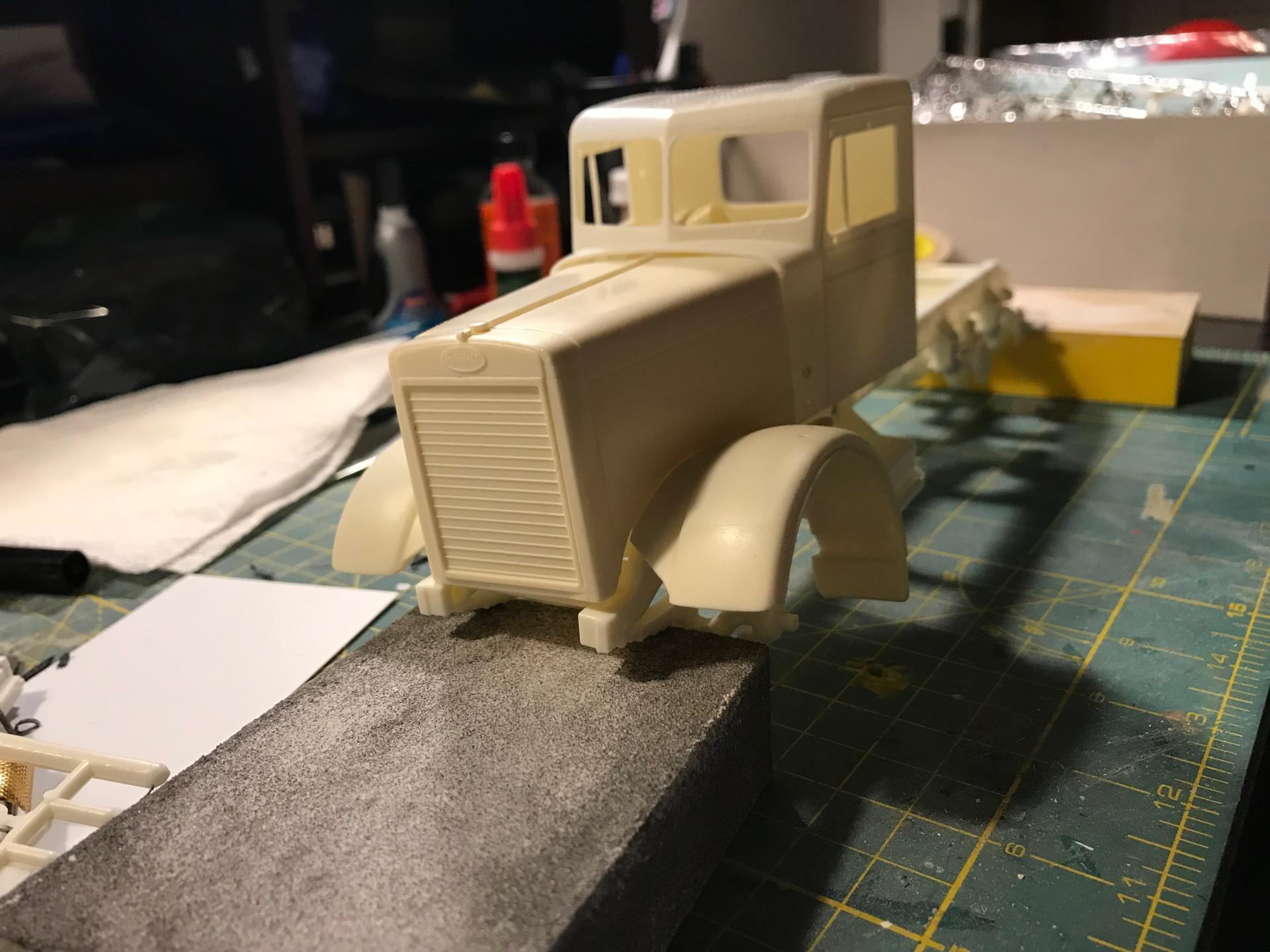

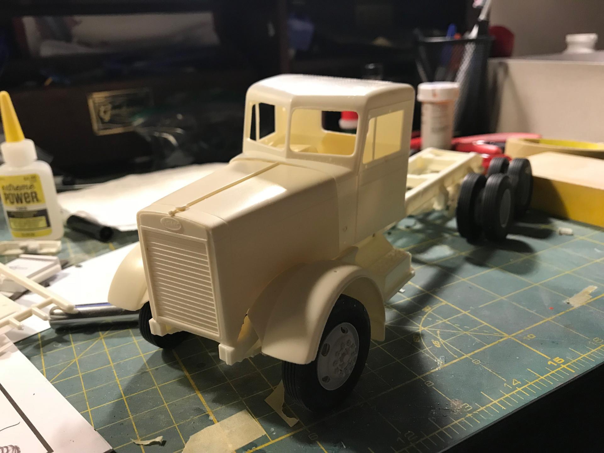

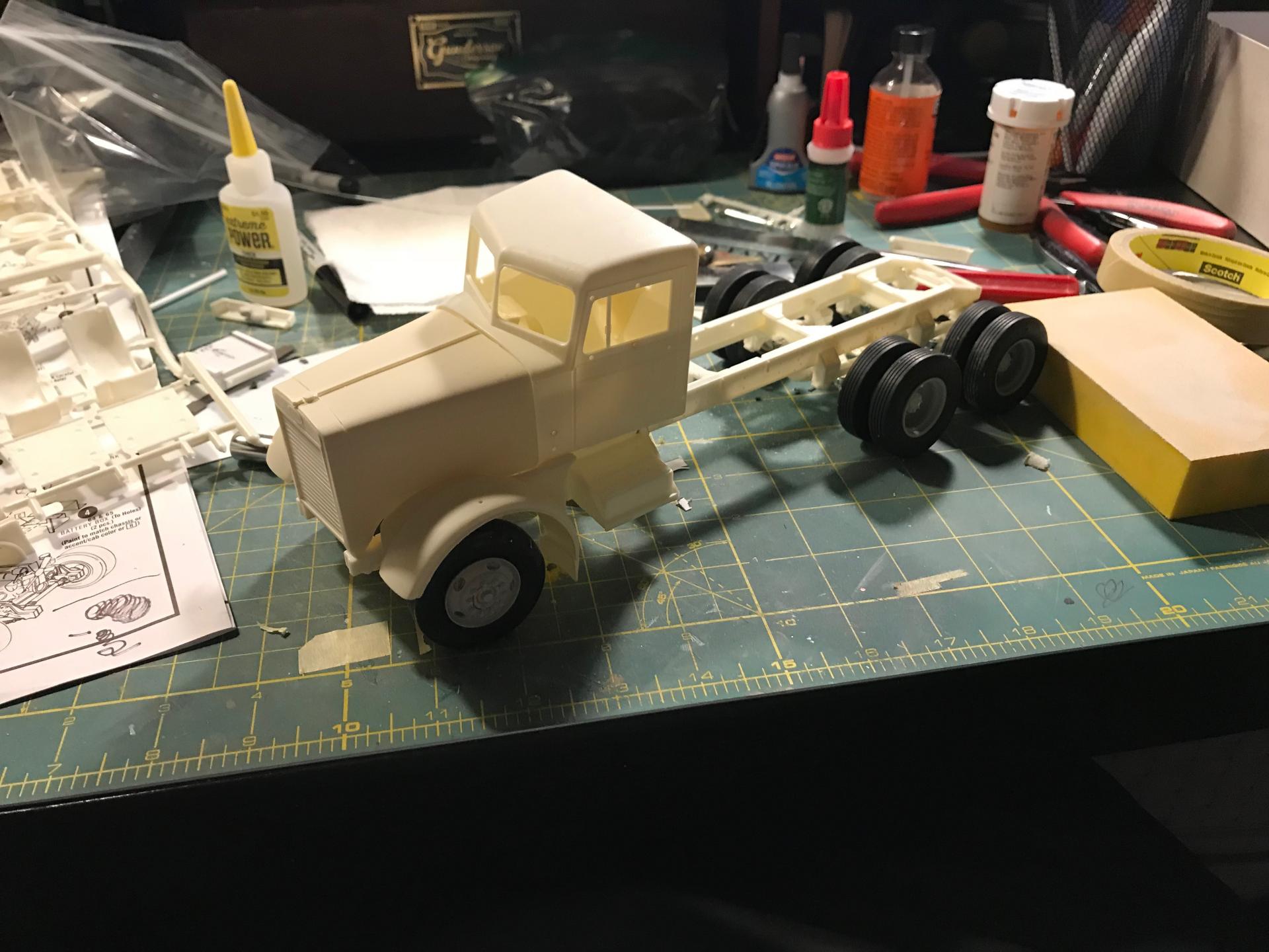

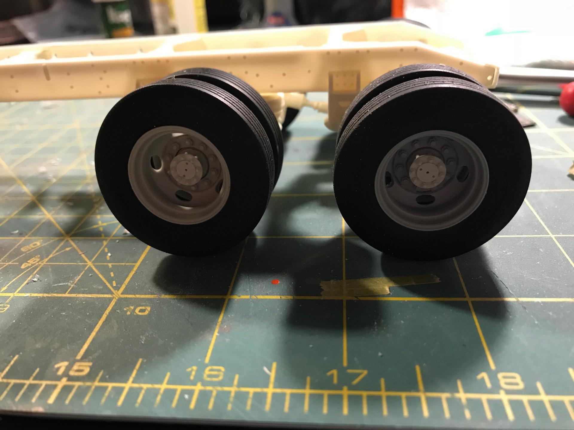

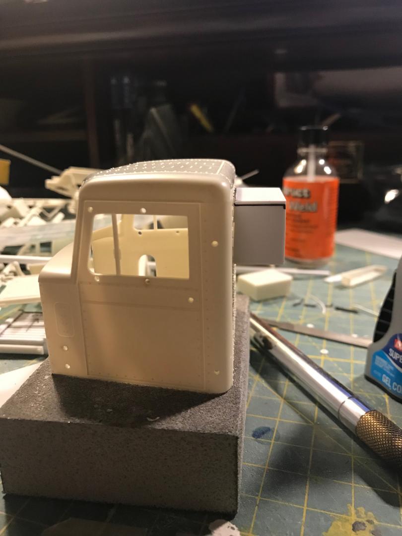

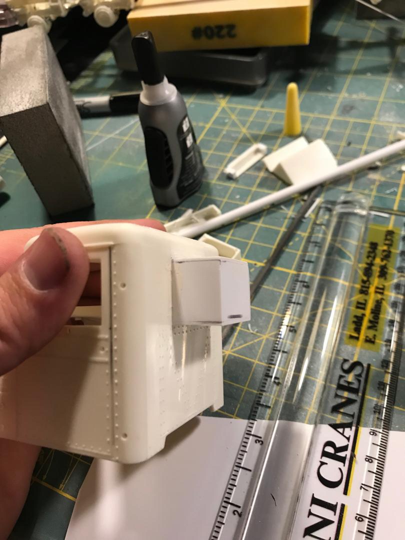

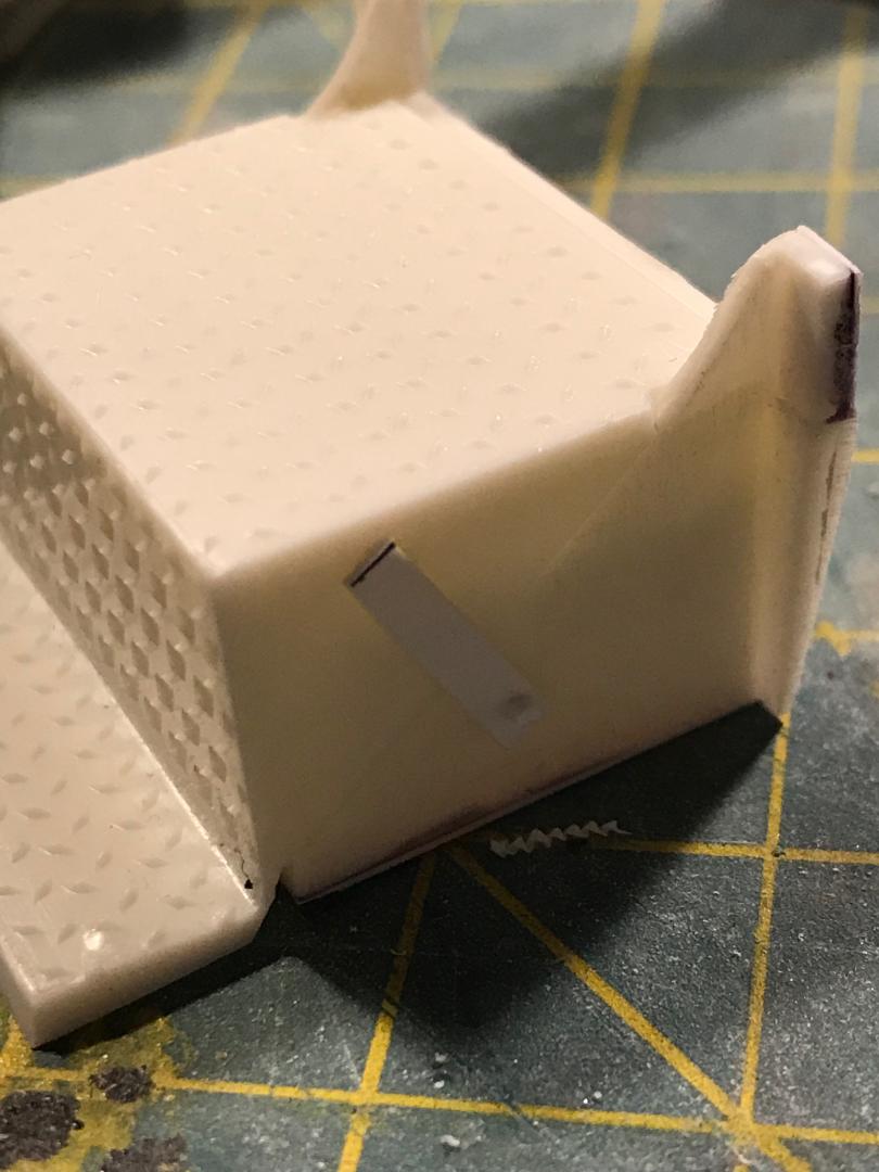

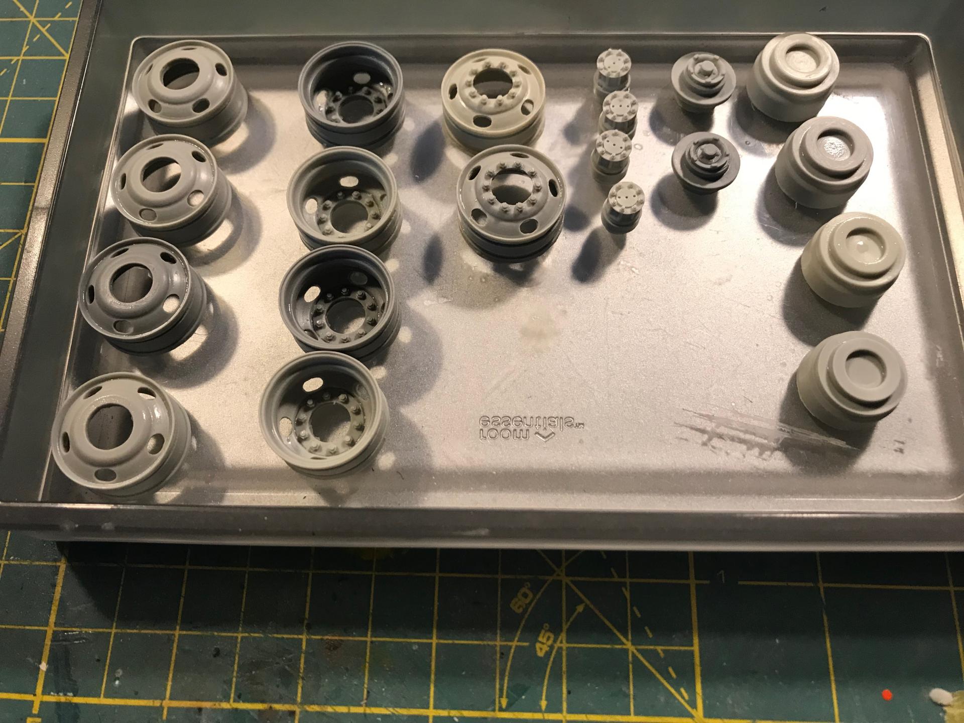

Rusty92 Posted July 21, 2018 Posted July 21, 2018 Hi all, this is my first post here in the "on the workbench" section, but I wanted to give some update on my Duel semi. I usually only build car and light duty truck models, but I cannot resist the challenge of a replica of the Duel semi. Since I do not build a lot of semis, I am sure I have made some errors on things. Please feel free to let me know. I am always looking to better myself. Wheels and tires are from Jamie at Moluminum. I love the quality! The resin conversion pieces are from AITM, I also am blown away by the quality. So far I have a little done after spending what feels like a long time on it. I am just trying to get this replica correct. I had to scratch build a radiator to fit in the confines of the smaller hood, the box on the back of the cab was used for hiding a camera while filming. It needs some touching up here and there, but I am happy with the results so far.The battery box is funny, the diamond plate step part just sits on there and I did not like that, and it was open underneath and the back. I filled in the open parts so it looked closed and added straps to the step part so it could come on and off. I think it looks good for what it is. Fuel tanks are a little rough, I sanded most of the straps down and I had to add more. I'm really taking my time on this one, since I enjoy the process so much. The tractor kit is the recent AMT California Hauler, a good kit. Too much chrome if you ask me. For the tanker I will be using the Dodge L700/tanker kit Thanks for looking, everyone. Jacob

leafsprings Posted July 21, 2018 Posted July 21, 2018 (edited) As you probably already know, there were a 2 or 3 different Peterbilts used in the full movie. Your dual drive Pete with mid 60's cab and one piece rims is correct for the add on scenes ( railroad track push scene and bus push scene - see link below ) I believe it was a '64, the rest of the trucks were mid 50's, with older style cab, 2 piece rims and single drive with tag axle. I agree the mollenium wheels are great, the AMT steel wheel discs used on the ALF pumper were a disappointment, not enough offset. Looks like you got the right pieces for a fantastic Duel truck. IMO, the best thing that ever happened to the California Hauler is the availability of 281 front end in resin. http://moparblog.com/movie-mopar-of-the-week-the-1971-plymouth-valiant-from-duel/ Edited July 21, 2018 by leafsprings

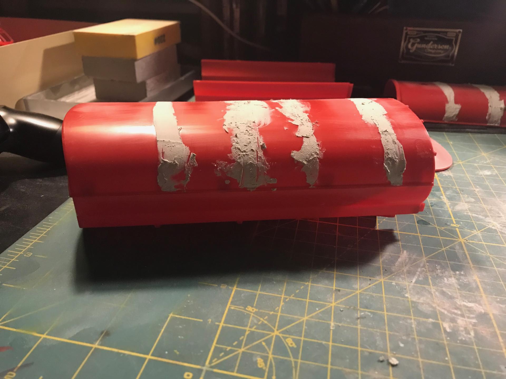

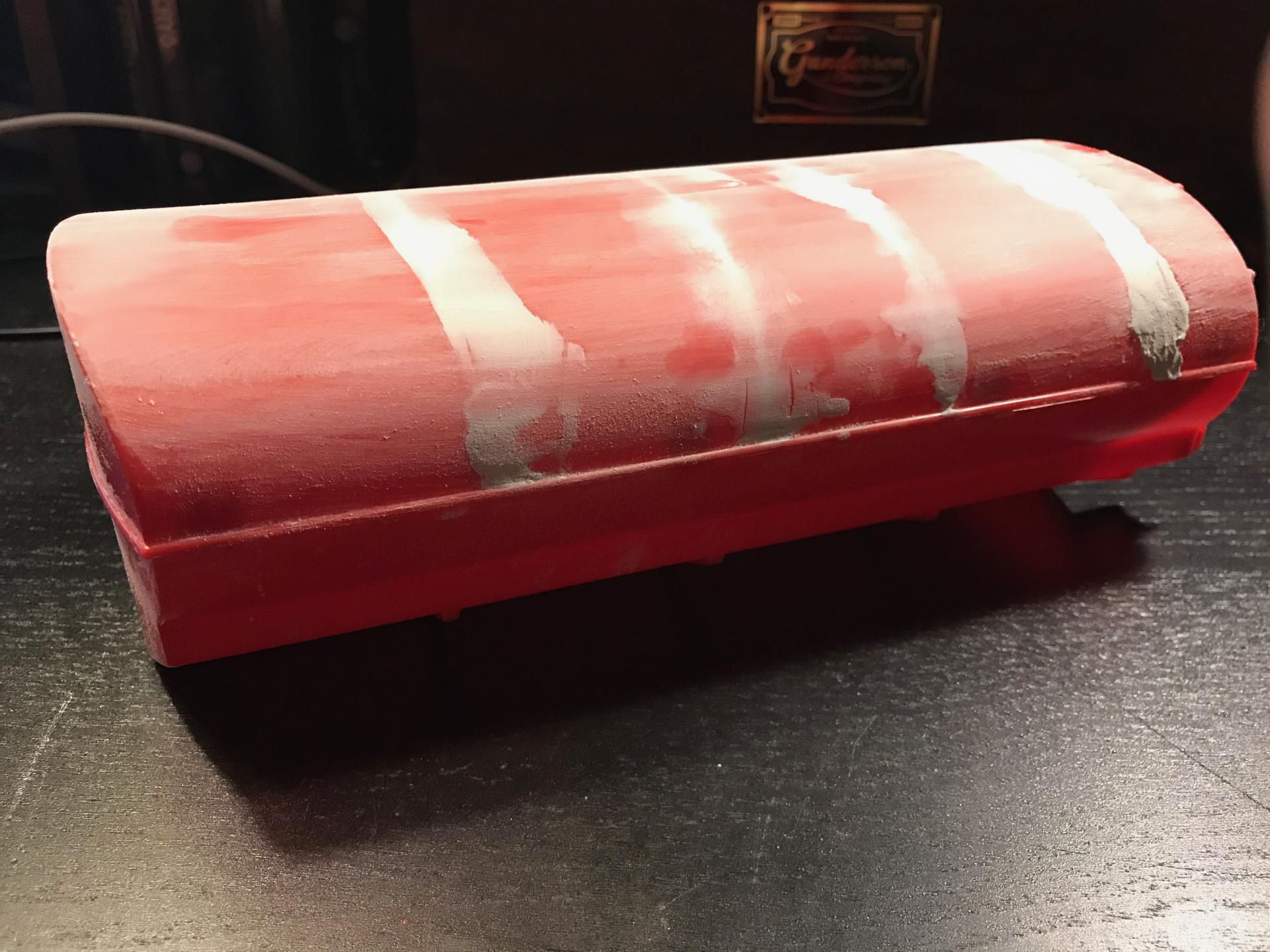

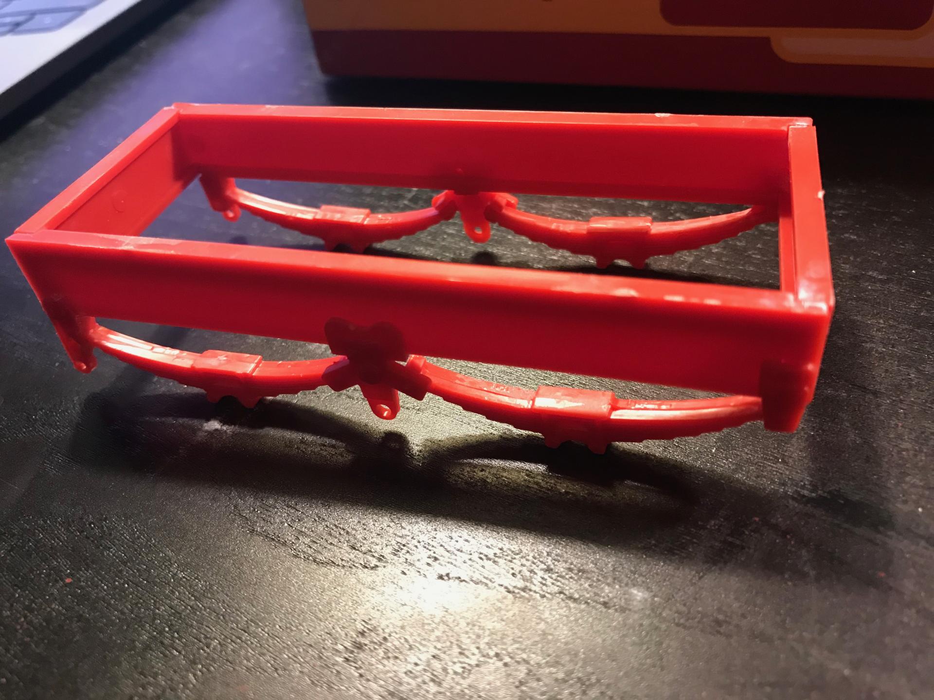

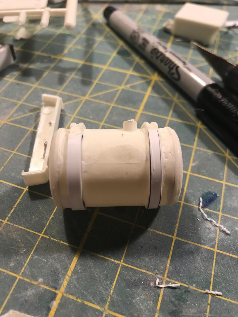

Rusty92 Posted July 22, 2018 Author Posted July 22, 2018 @Bugatti Fan Thank you for the info on the article. I will look it up here soon! @gotnitro? Thank you for the kind words! You definitely need to watch the movie soon! @leafsprings I appreciate the link to that website, it was a good read. And also thank you for the information regarding the truck itself. I hope the scale version turns out well. @DRIPTROIT 71 Very cool background information on the truck. I'll check out your Flickr soon to see some more photos. The one you shared is great. I decided to begin work on the tanker itself. I had never had any experience with a Lindberg kit before. It is interesting to say the least. Here is what I have so far. The suspension is really simple, I'll need to add something to it to make it look more realistic. I'm not up to making my own leafs yet, but I would like to someday. The tanker itself has a lot of mold lines and sinks in it. I used a lot of putty. This is just the front half of the tanker, I will have to section out a hearty portion and lower the suspension some for it to sit correctly. Small steps, one at a time.

PettyKW43 Posted September 6, 2018 Posted September 6, 2018 The Lindberg tanker dates back to the late 60’s when IMC ( Industro Motive Corp) released the first of modern commercial truck kits so yes the kits are somewhat different in execution but they do build up well with a little effort. To get the look of the movie trucks sand flush the molded on rubber gasket around the perimeter of the windshield and replace with a slightly larger gasket easily made using evergreen 1/2 round styrene strip. The drip rail on the roof also extends all the way around the rear of the cab instead of stopping at the door tops. Looking forward to seeing your progress Rick
Rusty92 Posted October 25, 2018 Author Posted October 25, 2018 On 9/3/2018 at 9:44 AM, DrKerry said: LOoking good so far!!!! Thank you! On 9/6/2018 at 11:33 AM, PettyKW43 said: The Lindberg tanker dates back to the late 60’s when IMC ( Industro Motive Corp) released the first of modern commercial truck kits so yes the kits are somewhat different in execution but they do build up well with a little effort. To get the look of the movie trucks sand flush the molded on rubber gasket around the perimeter of the windshield and replace with a slightly larger gasket easily made using evergreen 1/2 round styrene strip. The drip rail on the roof also extends all the way around the rear of the cab instead of stopping at the door tops. Looking forward to seeing your progress Rick Thank you for the background on the IMC, now Lindberg kit. I've been fiddling with it some and it will do the job fine with some work like you said. No fun in a kit that puts itself together. I also appreciate the tips for the build, with the windshield and drip rail. I'll add that to my list of notes. As for everyone else who has been watching the thread and build, I have been really busy with my Master's program so not much time to build. This weekend should allow me some time, even if it is just doing more sanding on the tanker itself. I appreciate everyones support here.

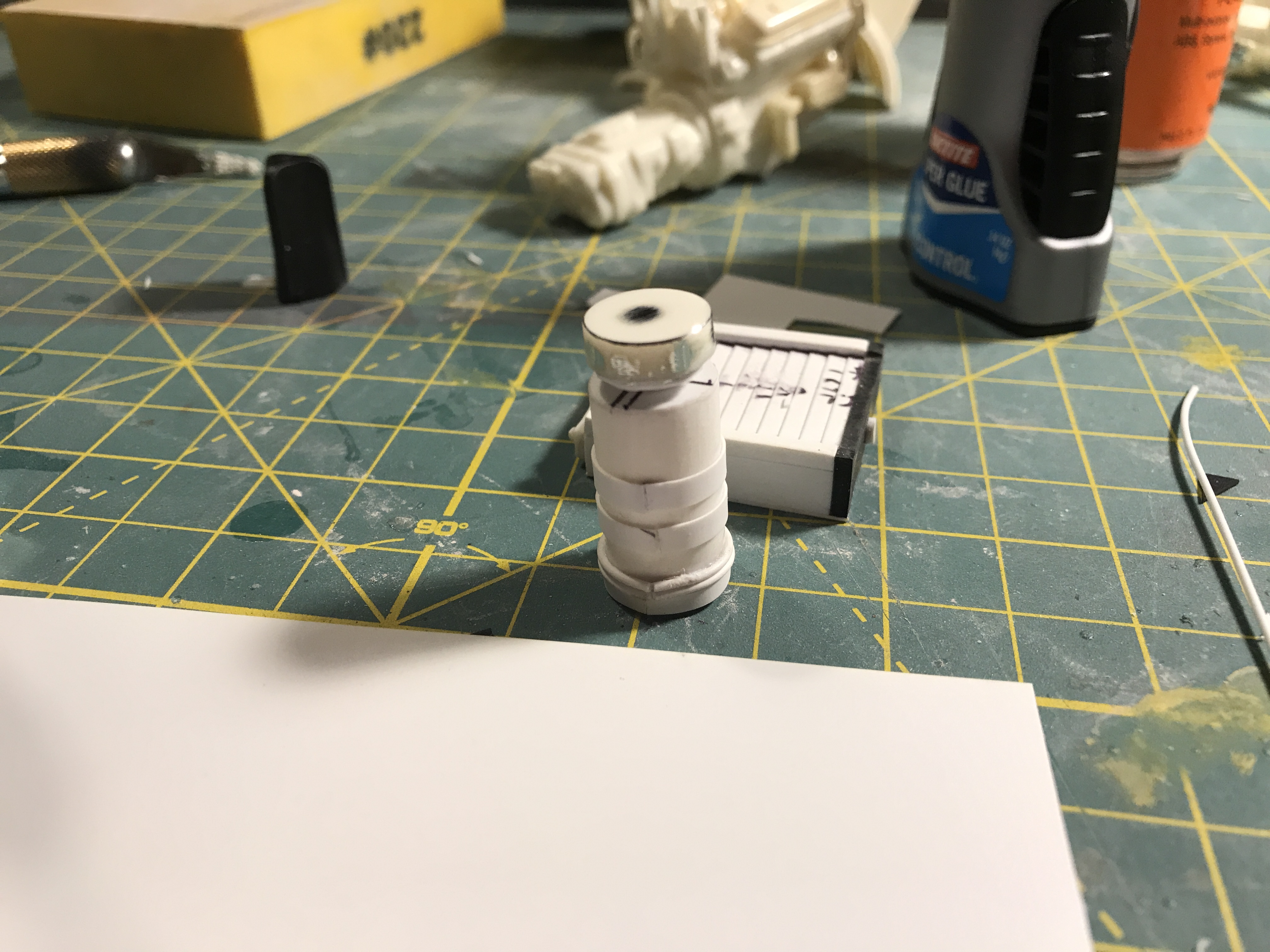

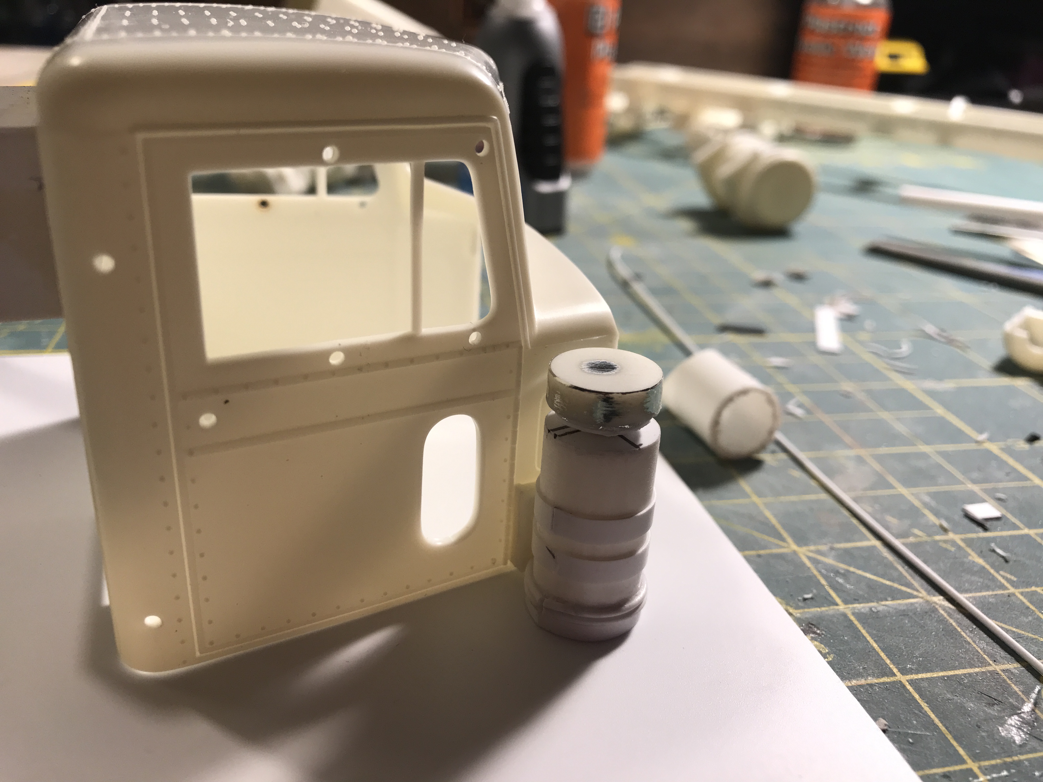

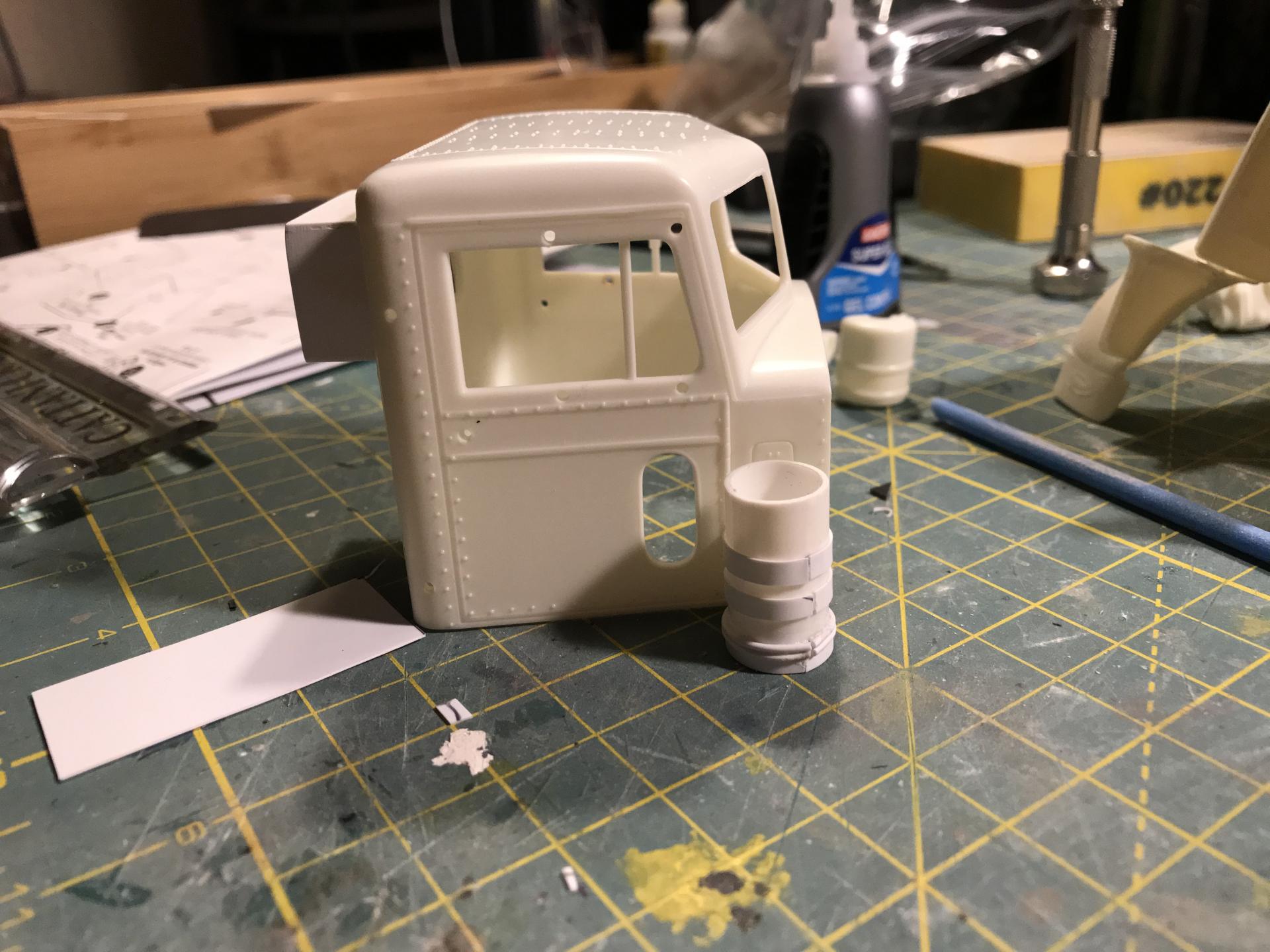

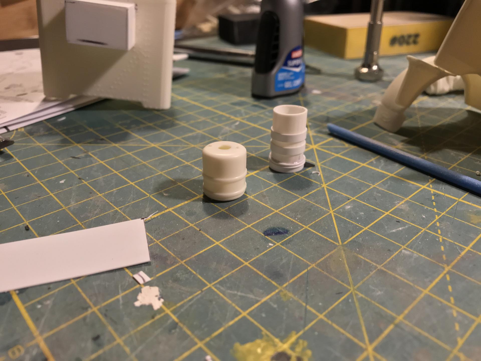

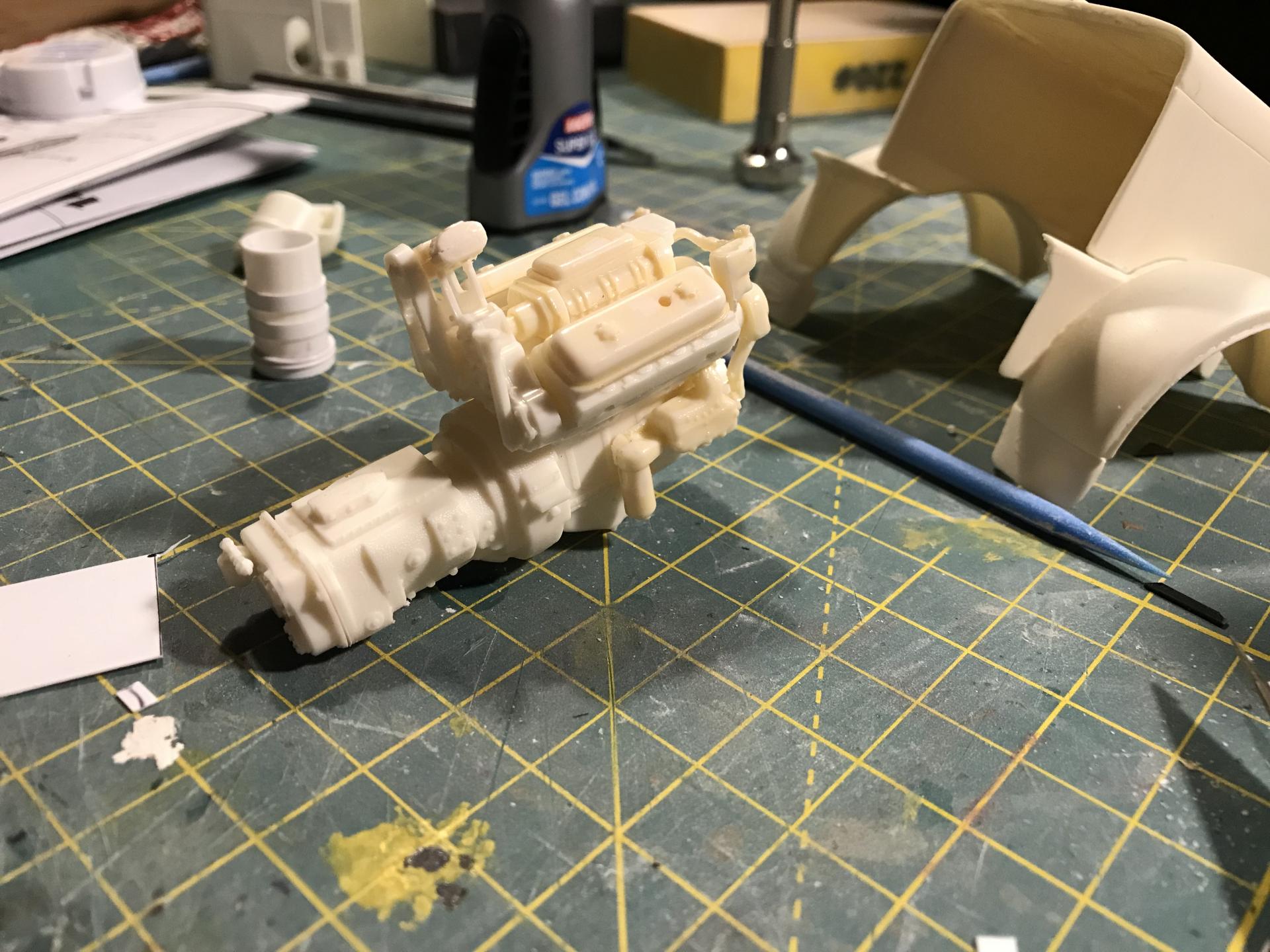

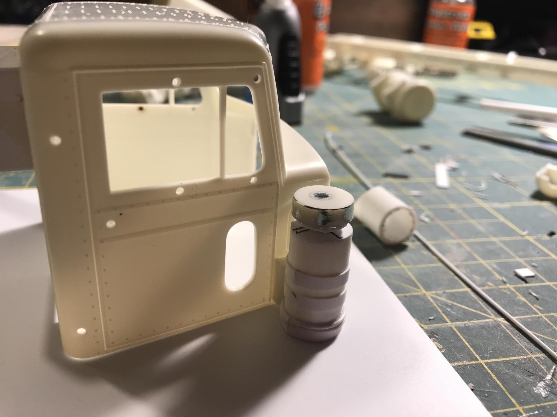

Rusty92 Posted December 14, 2018 Author Posted December 14, 2018 I know many of you have been waiting for some progress. I finally got some bench time tonight after dealing with a crazy semester at college. Feels good to be on break. I assembled some more of the engine after stripping all that chrome off. I then began working on the air cleaner for the semi, as the kit one seems kind of cartoony to me. Still new to scratch building and it isn't done yet, but i think it looks more accurate (a lot more) than the kit one. What do you all think? The old Detroit. From what I can tell, this should be Detroit green right? I saw a lot that were white, but a lot that were their signature green also. Here is the Duel truck and air cleaner. Here is the kit one compared to mine: I think mine looks pretty good! And here it is sitting next to the cab. I'll have it sitting a little lower. The seems will be facing the cab so they are not visible. Comments are always appreciated!
Force Posted December 14, 2018 Posted December 14, 2018 (edited) At that time Peterbilt should have had white engines as most of them did, but the Duel trucks had either Cat or Cummins I 6 engines depending on wich one of the trucks it was. The real truck in your picture is of the surviving Duel truck as it is today and that truck has a Cummins NTC 350 now but originally had a Cummins 262, the one used for most of the outside scenes was destroyed in the final crash scene and it had been repowered with a Cat 1674 sometime before it's movie appearence and had a yellow Cat 966 wheel loader style horizontal air cleaner. Edited December 14, 2018 by Force
Rusty92 Posted December 15, 2018 Author Posted December 15, 2018 21 hours ago, Force said: At that time Peterbilt should have had white engines as most of them did, but the Duel trucks had either Cat or Cummins I 6 engines depending on wich one of the trucks it was. The real truck in your picture is of the surviving Duel truck as it is today and that truck has a Cummins NTC 350 now but originally had a Cummins 262, the one used for most of the outside scenes was destroyed in the final crash scene and it had been repowered with a Cat 1674 sometime before it's movie appearence and had a yellow Cat 966 wheel loader style horizontal air cleaner. Wow! Thanks for that handy information. I’ll see what I can come up with for a Cummins or a Cat engine. Really appreciate the info here, sir. I topped off the air cleaner tonight, it will work well. Thanks for looking!
leafsprings Posted December 16, 2018 Posted December 16, 2018 On 12/13/2018 at 9:15 PM, Force said: but the Duel trucks had either Cat or Cummins I 6 engines depending on wich one of the trucks it was. I agree, but do we have any info on the engine in mid 60's Pete used in the add on scenes? This build is using the "unilite cab" used between '61-'72. My guess, it was Cummins 6, probably a 250, the standard engine used in the mid 60's.
Rusty92 Posted December 16, 2018 Author Posted December 16, 2018 1 hour ago, leafsprings said: I agree, but do we have any info on the engine in mid 60's Pete used in the add on scenes? This build is using the "unilite cab" used between '61-'72. My guess, it was Cummins 6, probably a 250, the standard engine used in the mid 60's. That’s the one that comes in the Freightliner COE kit, correct?
leafsprings Posted December 16, 2018 Posted December 16, 2018 Correct. There were be a few modifications to the intake and exhaust system, but I'm sure it will be no big deal for you. The NHC 250 is a non turbo, so the exhaust needs to be modified to a drop center type.
