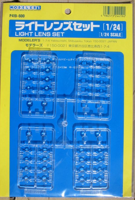

Mike999 Posted September 11, 2018 Posted September 11, 2018 Not sure if this helps, but these headlight lenses are from the Japanese company "Modeler's." Bought these long ago but I have seen them on eBay. They include striated and clear round lenses, and some square ones.

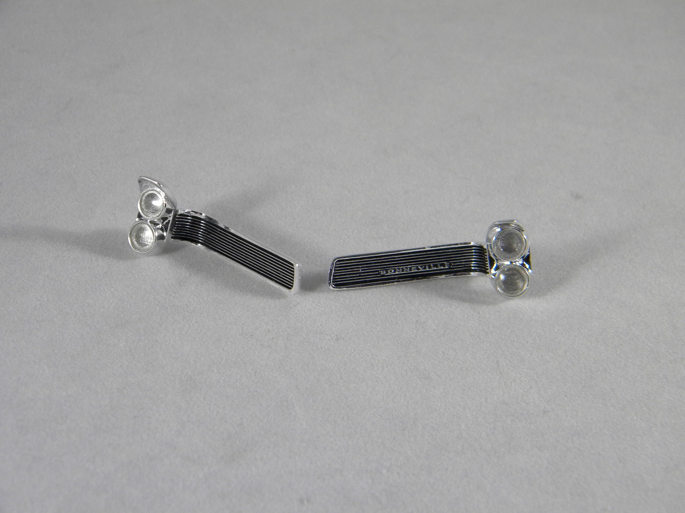

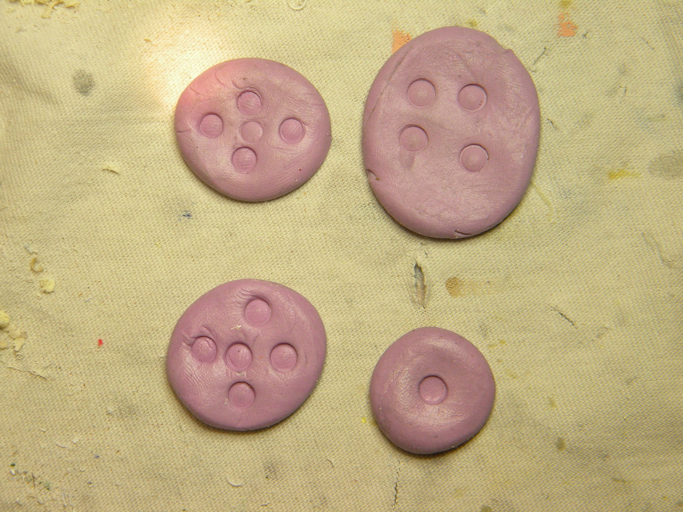

StevenGuthmiller Posted September 20, 2018 Posted September 20, 2018 You can make your own fairly easily with some mold putty & Laser Bond glue. Any size or shape that you want. Steve

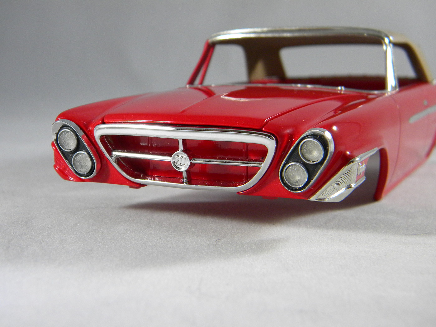

StevenGuthmiller Posted September 20, 2018 Posted September 20, 2018 4 hours ago, kurth said: Great answers in this thread. I have so many kits I would like to build but I could not figure out how to resolve the problem of the chromed headlights. StevenGuthmiller , do you have any more details or pictures of your process? I've done them in several different ways. The one I've settled on is to drill out the old chrome lenses and then make molds for the lenses & buckets from existing lenses from mold putty. You can pick up the mold putty at Hobby Lobby or online. I use a set of the old smooth custom lenses from some kits molded in reverse for the buckets. Then you can do the lenses themselves a couple of different ways. Either use lenses with the "striations" molded on the outside or the inside pressed into the putty with the striations down. If you use lenses with the striations on the outside you will wind up with lenses that are duller in appearance than you may want. I prefer to use lenses with the detail on the inside of the lens & then just pile the Laser Bond into the mold giving you a bit of a domed surface. This will give you a shinier lens. I did this '62 Chrysler a little differently using aluminum tubing for the tub/rim construction, but you can see that the lenses are not as shiny as the lenses on the '63 Bonneville, which were done in reverse. Any way, it's a simple operation of just making a mold & then filling the mold with Laser Bond, zapping it with UV light for 10 seconds & you have instant lenses. I recently used this method using 2 part epoxy for a mold for the parking light lenses for a '63 Plymouth Fury as well. Steve
Casey Posted September 21, 2018 Posted September 21, 2018 7 hours ago, StevenGuthmiller said: You can make your own fairly easily with some mold putty & Laser Bond glue. Is the Laser Bond glue going to discolor over time? That seems to be the main drawback when using non-kit lenses. I cast lenses using Alumilite's Clear Cast, and they yellowed after a few months inside a box, with no exposure to natural light, so unless there are other epoxies which are 100% UV resistant for their lifetime after curing, I would steer clear of them.
StevenGuthmiller Posted September 21, 2018 Posted September 21, 2018 1 hour ago, Casey said: Is the Laser Bond glue going to discolor over time? That seems to be the main drawback when using non-kit lenses. I cast lenses using Alumilite's Clear Cast, and they yellowed after a few months inside a box, with no exposure to natural light, so unless there are other epoxies which are 100% UV resistant for their lifetime after curing, I would steer clear of them. I don't know. But if nobody tries, we will never know. I'm willing to be the canary in the coal mine. Steve
kurth Posted September 21, 2018 Posted September 21, 2018 Thank you for the explanation. I am going to try this.
