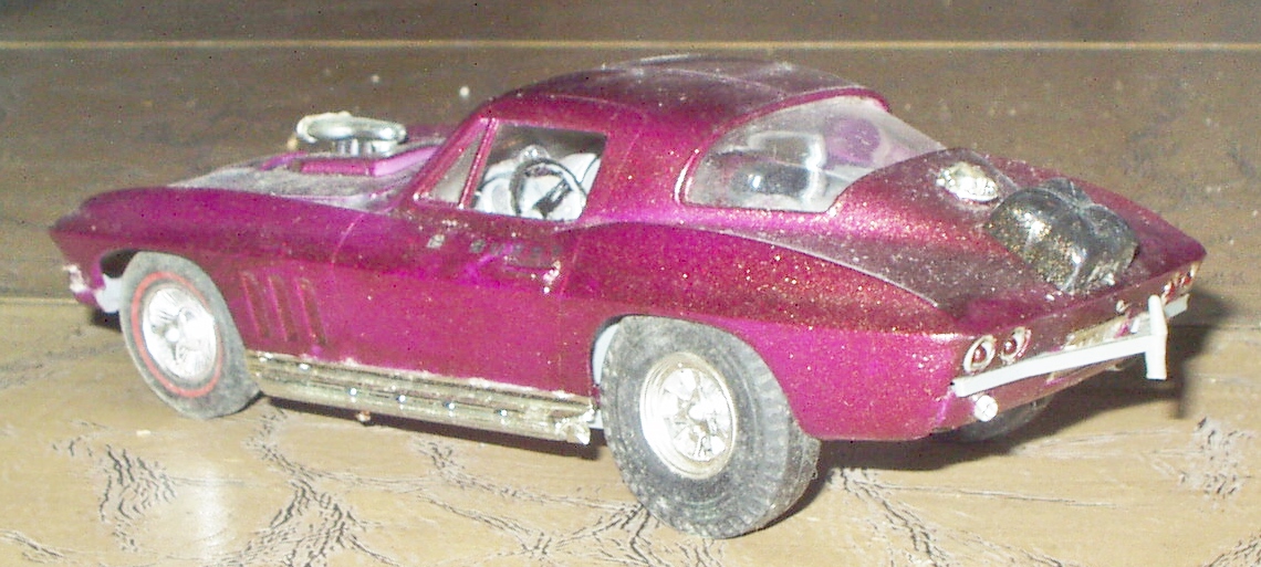

Not sure what to call this project. Not really a "restoration" because I didn't really restore it to a previous state. Not really a full rebuild, as I didn't strip and repaint it. Much more than one of my typical "glue bomb rescues," though. How about "Survivior Rehab?" Let's see how that works.

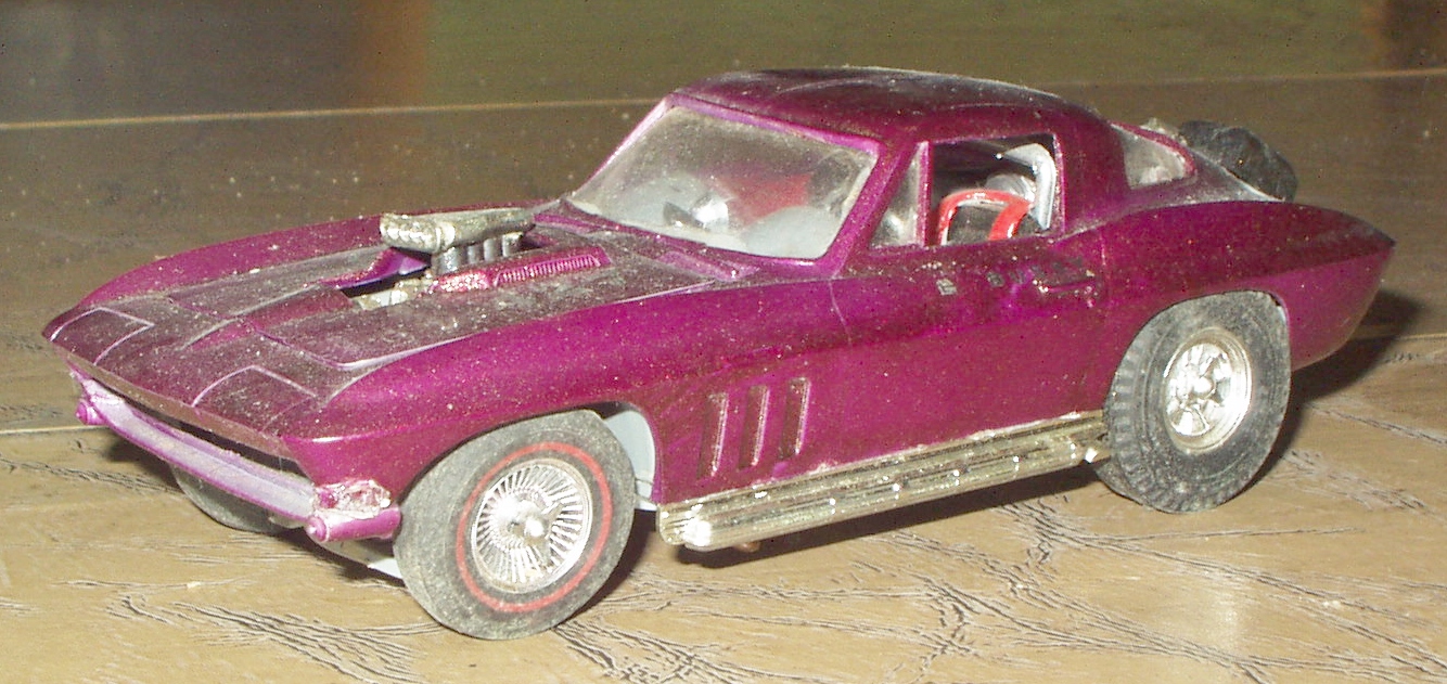

Got this one in an ebay “Corvette junkyard” about 10 years ago, along with some other stuff I really wanted. It sat unloved until about 2015, when I dug it out and took a look at it.

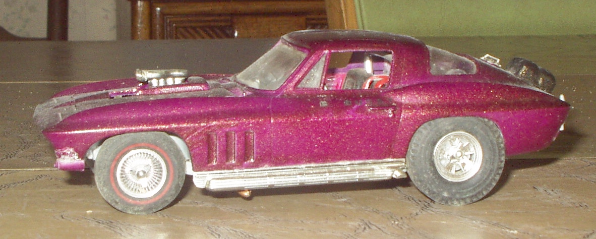

Kind of a hot mess. At first glance, it's a drag gasser, with blown engine, parachute, and push bar, but then why does it have the stock grille and front bumper and factory side pipes? Did the Original builder have a hot street freak in mind? The factory alloy knock-off wheels on the front and the slim pie-crust slicks seem out of place either way.

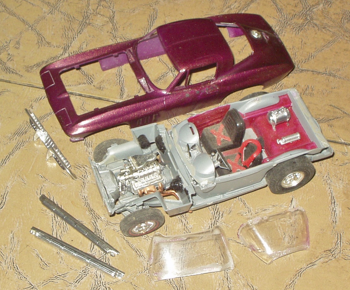

If the rare '65-'66 big block hood hadn't been cut for the blower, I'd have stripped the thing without a second thought and rebuilt it from the ground up as a stocker. But the more I looked at it, it began to grow on me. Was there anything I could do with it? I broke it down to see what I had to work with.

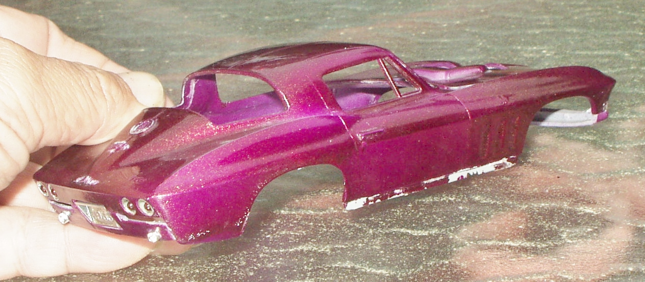

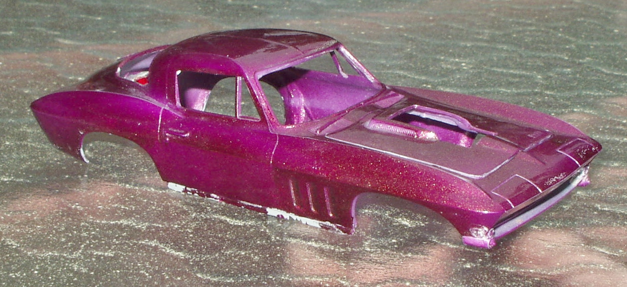

Just for grins, I tried polishing up the existing paint, which to my amazement shined up magnificently. Well, 90% of it. I think the paint was Pactra purple metalflake, overcoated with their “Diamond Flake” clearcoat with gold flakes in it . (There's some of this on the black parachute, which gave me the clue.) I polished through on a couple of sharp edges, but discovered that Testor has a purple pearl in their line (available at Hobby Lobby) that's very, very close to the original color—good enough for minor touchups.
However, the paint on the left door was very rough. By the time I'd gotten it leveled out and shiny, I'd polished off all the Diamond Flake overcoat and a bit of the color, too, leaving it the door very blotchy looking. I could have airbrushed the whole door with the Testor purple, but it still wouldn't have matched because of the missing Diamond Flake stuff.
So the body went on the Shelf of Doom until I could come up with a solution. I finally decided if I could come up with (or make) some kind of name decal for the thing, it would go a long way toward camouflaging the bad paint on the door. Didn't have anything suitable in my stash.

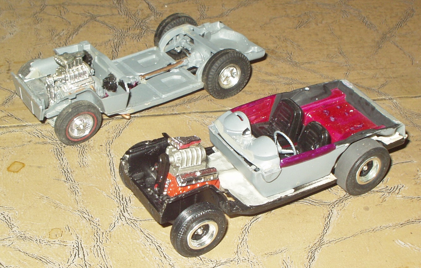

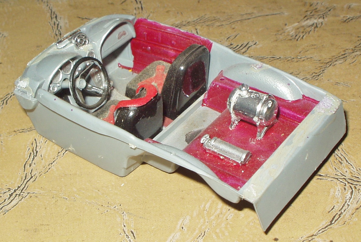

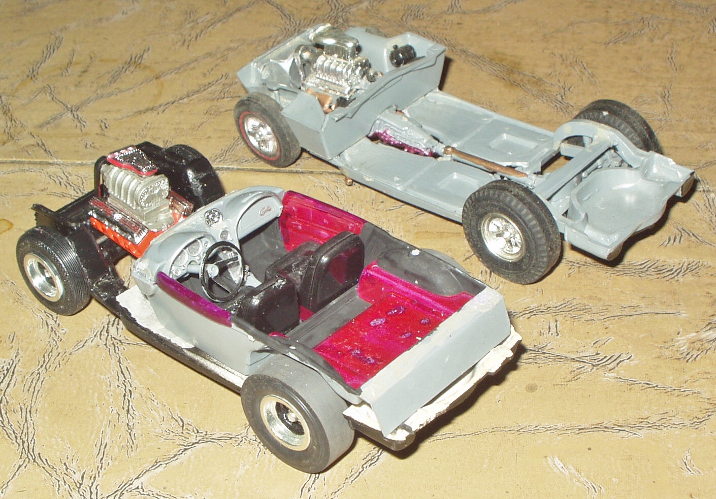

Meanwhile, I drove on with the chassis and interior. On projects like this, I usually try to use as many original parts as possible, or as many as I can stand. I'd have used the chassis and engine, but all four of those wheels and tires had to go. But this whole chassis is glued up SOLID, including the tires to the wheels. I couldn't even get the tires off without risking breaking the whole fidgety MPC chassis into several discouraging pieces. So I just left it alone and cobbled together an AMT one-piece chassis and new 427 engine from my big box of AMT Sting Ray spare parts. The wheels and tires came from there, too. Worked with the interior as best I could. Not 100% happy with how it looks, but it looks better than it did. Oh well I can always squirt it Krylon Satin Black sometime if the mood strikes me.
Okay, let's see where we are. Starting to come together a little, maybe. Need to make some rocker panels, and come up with SOME way to hide that blotchy left door. (The whole model looks blotchy in these pics due to the flash photography, but it doesn't look too bad in real life, except for the left side.)

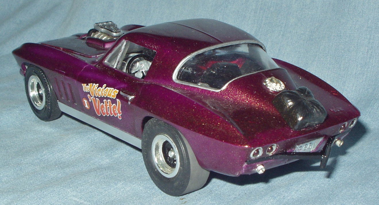

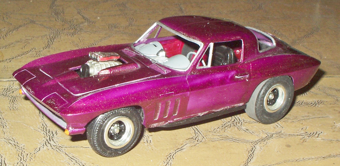

Made the rocker panels from sheet styrene and covered them with the dull side of kitchen foil and Micro Metal Foil Adhesive. Found some almost PERFECT decals in the latest reissue of the AMT '63 kit.
So it's done (for now) and we're off to Under Glass. See you there soon! B)
