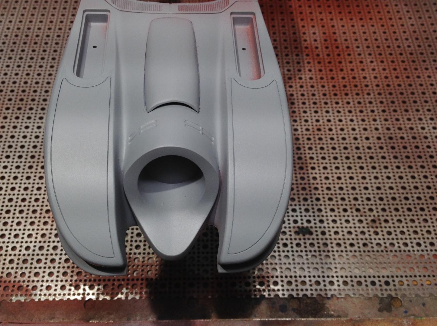

Rider Posted October 4, 2018 Posted October 4, 2018 Low pressure, many many passes. These panel lines were scribed from scratch, taking about 2 hours per side.

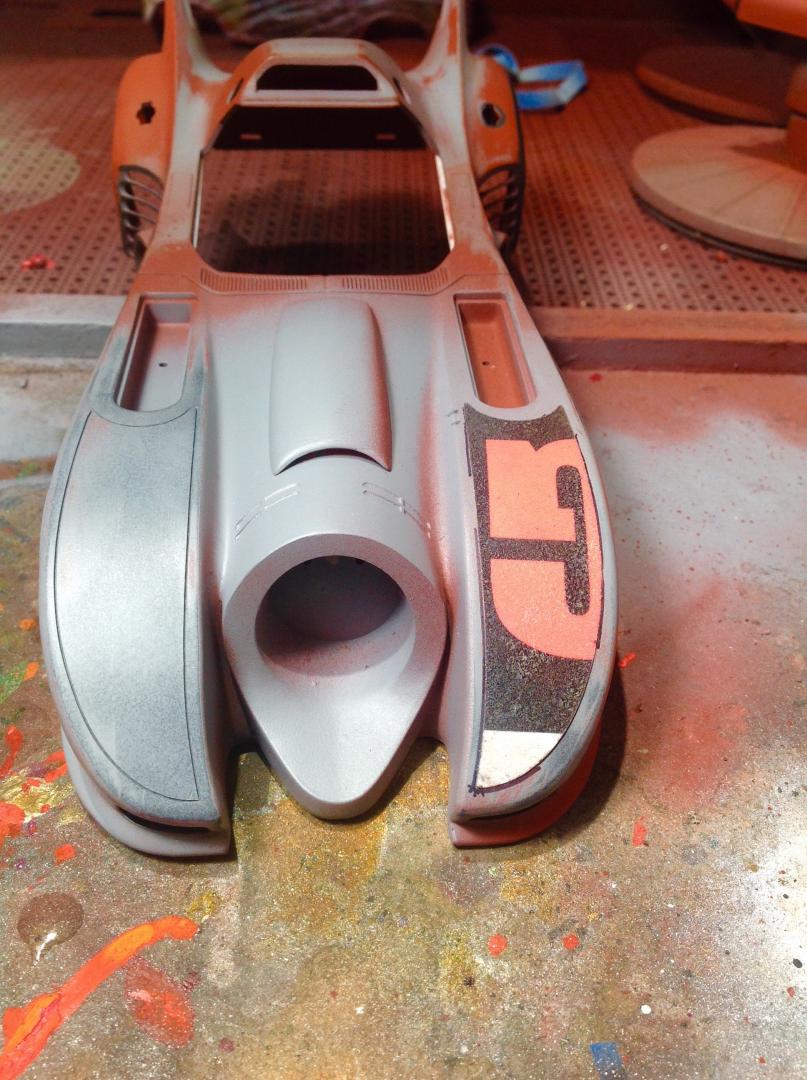

Mike Chernecki Posted October 4, 2018 Posted October 4, 2018 14 hours ago, Rider said: Low pressure, many many passes. These panel lines were scribed from scratch, taking about 2 hours per side. What are you using as a template, is that a plastic sign? How do you keep the template fixed to the body when scriibing?
Rider Posted October 4, 2018 Posted October 4, 2018 I use for sale/garage sale signs. They are made from styrene, are .020" thick and cost pennies compared to the cost of EverGreen or PlastiStruct products. I use 3M Super 77 spray adhesive, it's contact adhesive, but if only one item, in this case the template is sprayed it is not permanent, any residue left behind once the template is removed simply rubs off. If you can' rub it off it comes off with turpentine, but I have never had to go that rout.
Mike Chernecki Posted October 4, 2018 Posted October 4, 2018 57 minutes ago, Rider said: I use for sale/garage sale signs. They are made from styrene, are .020" thick and cost pennies compared to the cost of EverGreen or PlastiStruct products. I use 3M Super 77 spray adhesive, it's contact adhesive, but if only one item, in this case the template is sprayed it is not permanent, any residue left behind once the template is removed simply rubs off. If you can' rub it off it comes off with turpentine, but I have never had to go that rout. I will try this. Thanks
