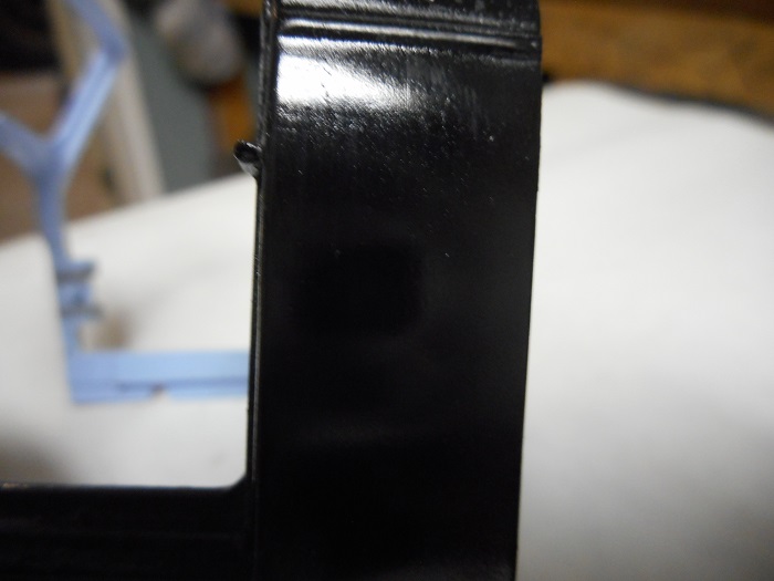

tedd60 Posted October 5, 2018 Author Posted October 5, 2018 (edited) I got curious so this is a test without any filler ... I just wire brushed off the paint, brushed a couple coats of Crazy Glue into the seam for the left side trafficator semaphore, sanded off the excess and primed it to see what's up. I left the right side untouched. The stuff at the bottom of the L/side panel is paint too tough to brush off, NOT Crazy glue. I guess over time I will see if it cracks ... but for now, I will put it in a freezer for a couple days, and then outside in the Georgia sun. FWIW, Crazy Glue seems to sand as easy as any filler I've ever used. Edited October 5, 2018 by tedd60

tedd60 Posted October 8, 2018 Author Posted October 8, 2018 (edited) My experiment continues. As seen above I took a bit of scrap 1/18 Maisto VW and filled in the slots for the directional signal trafficator semaphore with CA using a brush. then I sanded it flat and primed it. Next i put it in a freezer for 24 hours and set it in the Georgia sun to see if the filling popped out or a hair line appeared. No pop ... no hair. So I sanded it and put on one coat of gloss black from a rattle can, let it dry then back in the freezer for 24 hours and warmed it up today ... no pop no hair ... no change. So far so good. I think it looks great. I'll let it sit over night and hit it with a heat gun and see what that does. Edited October 8, 2018 by tedd60
