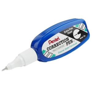

Deuces Posted October 6, 2018 Posted October 6, 2018 Just wondering if anyone here has tried it yet.... I did a little searching and I noticed that Bic also has white out pens in their arsenal besides the bottles...
Deuces Posted October 6, 2018 Author Posted October 6, 2018 I was thinking it can also be used as a "base" for a red jel pen for doing redlines... ? And I do love redline tires... ??
Ace-Garageguy Posted October 6, 2018 Posted October 6, 2018 (edited) I tried the old-style brush-in-cap Wite-Out a long time ago, and my experience was that it didn't flow enough to suit me, leaving raggedy brush marks. Since then, I've been using acrylic artist's white, or acrylic gesso, with the tire chucked up in a slow-speed drill...and a good brush, almost a pinstriping brush, that will carry enough paint to get a complete coat in one revolution without stopping. For even better results that rival factory pad-printed tires, I use a light colored spray interior dye, and masks cut from frisket film with a compass knife. And in my own experience, I've found that a white gel-pen, allowed to dry thoroughly, makes an acceptable base for blue-line stripes (sorry...I don't recall the manufacturer of the gel-pen that works best; oil-paint markers usually never dry on vinyl tires). EDIT: I'd be really interested to know if the correction pens work well for narrow whitewalls and tire lettering. Edited October 6, 2018 by Ace-Garageguy

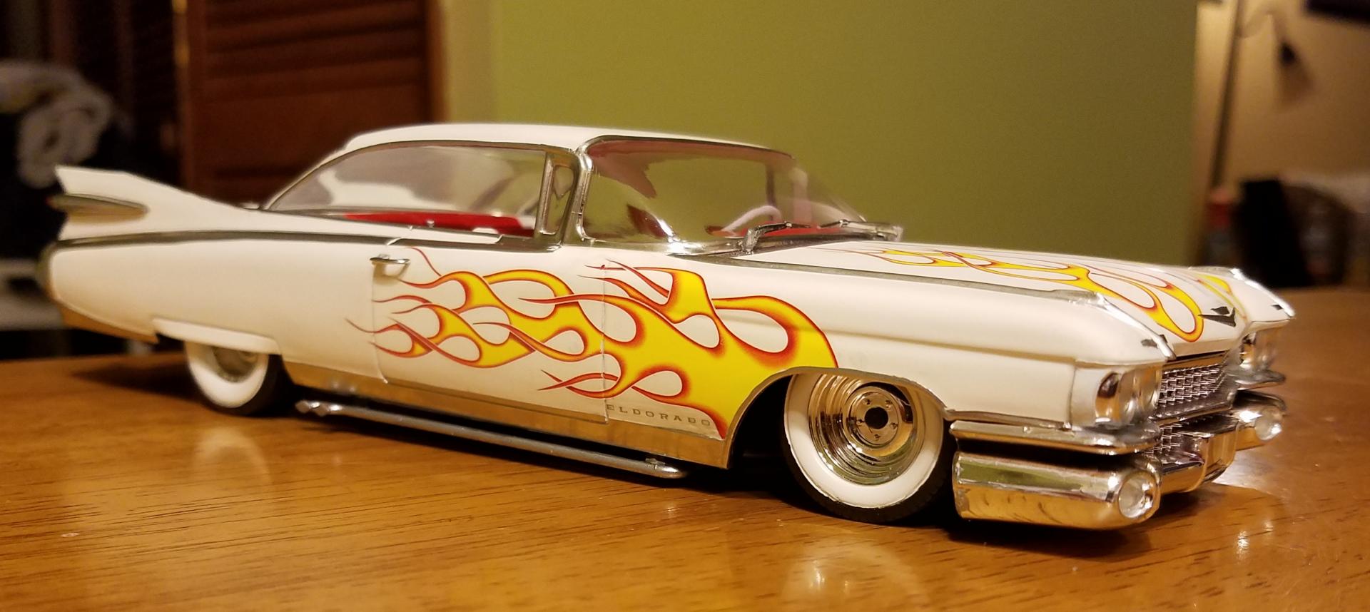

Fat Brian Posted October 9, 2018 Posted October 9, 2018 On my Eldorado the tires I used had a pretty defined ridge around them so I masked the front of the tires with bare metal foil and trimmed around the ridge. Then I shot the areas I wanted white with Mr. Super Clear flat, it's the only thing in a spray can I've found that will dry on vinyl. Once that was dry I shot them with Krylon flat white then a final coat of clear flat. I think they turned out pretty good even though this won't work for every set of tires.
