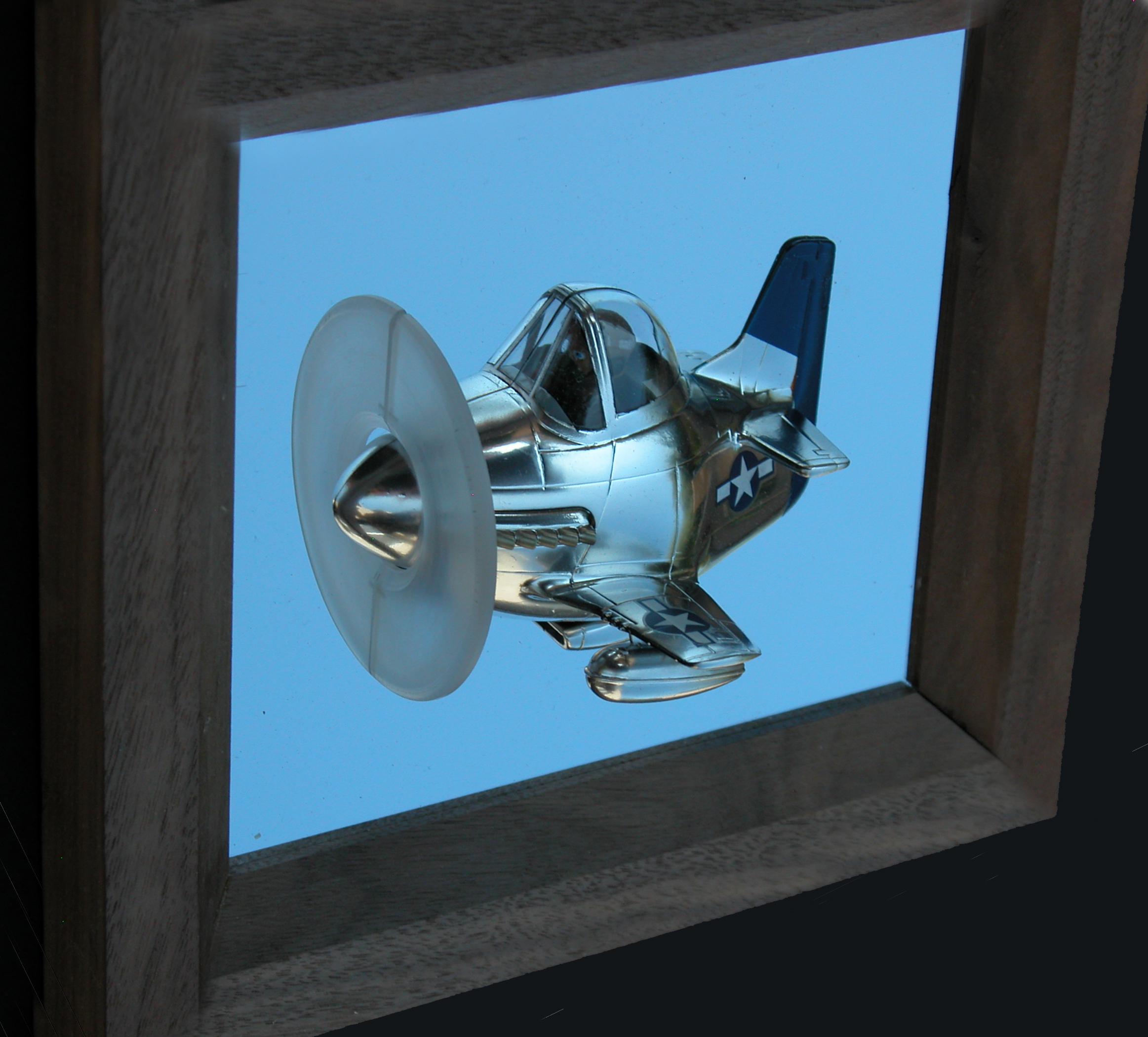

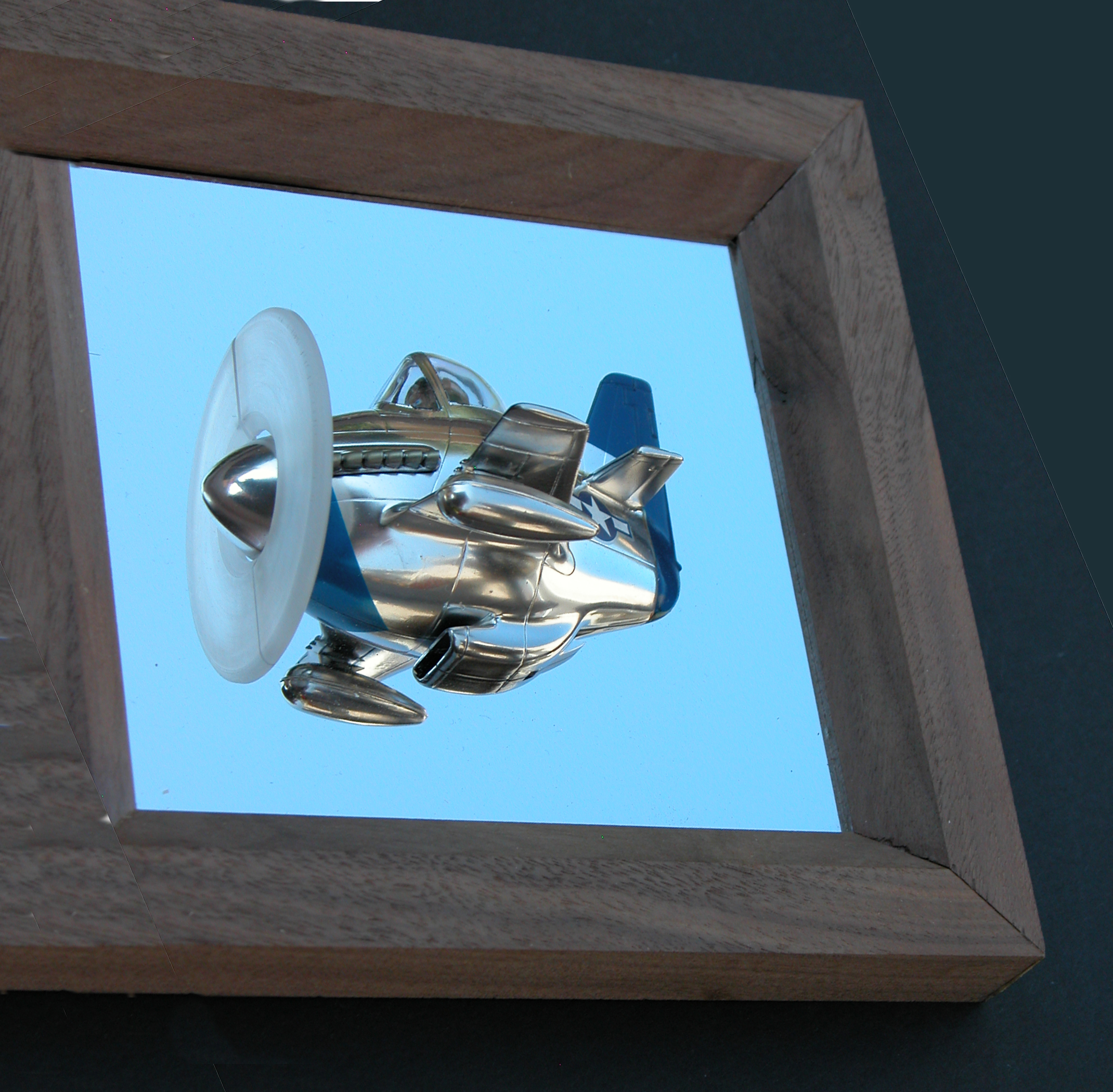

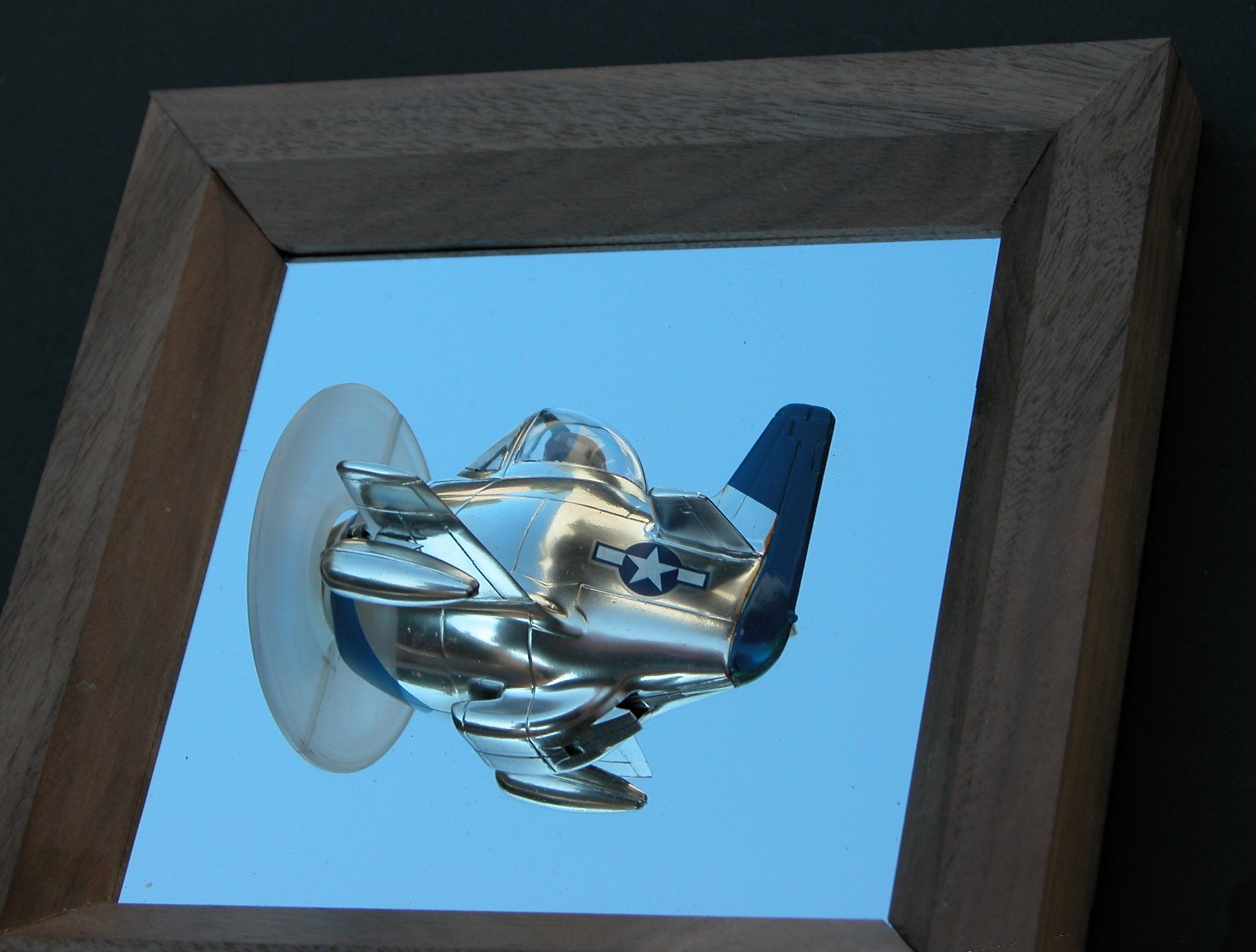

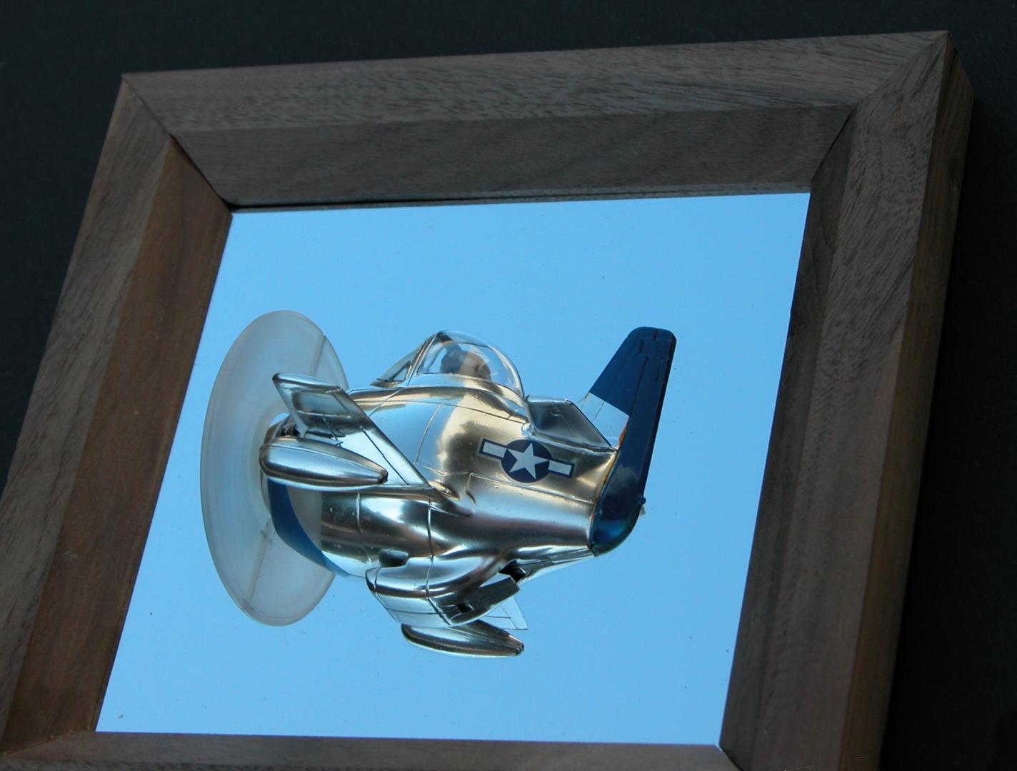

Pete J. Posted October 26, 2018 Author Posted October 26, 2018 This was my first major use of the easy chrome. This looks a little different for a reason. It's a half of an egg plane mounted on a mirror and shot outside so the reflection in the mirror is the sky. I wanted a "in Flight" look without any supports or wires. This has been clear coated with automotive urethane.
SfanGoch Posted October 26, 2018 Posted October 26, 2018 That looks awesome, Pete. Very ingenious and creative. I'm getting the bigger spray can kit so I can re-chrome the wheels and handlebars on my son's two Schwinn Grey Ghost Krate bikes. Heck, I might even Easy Chrome our cat.
