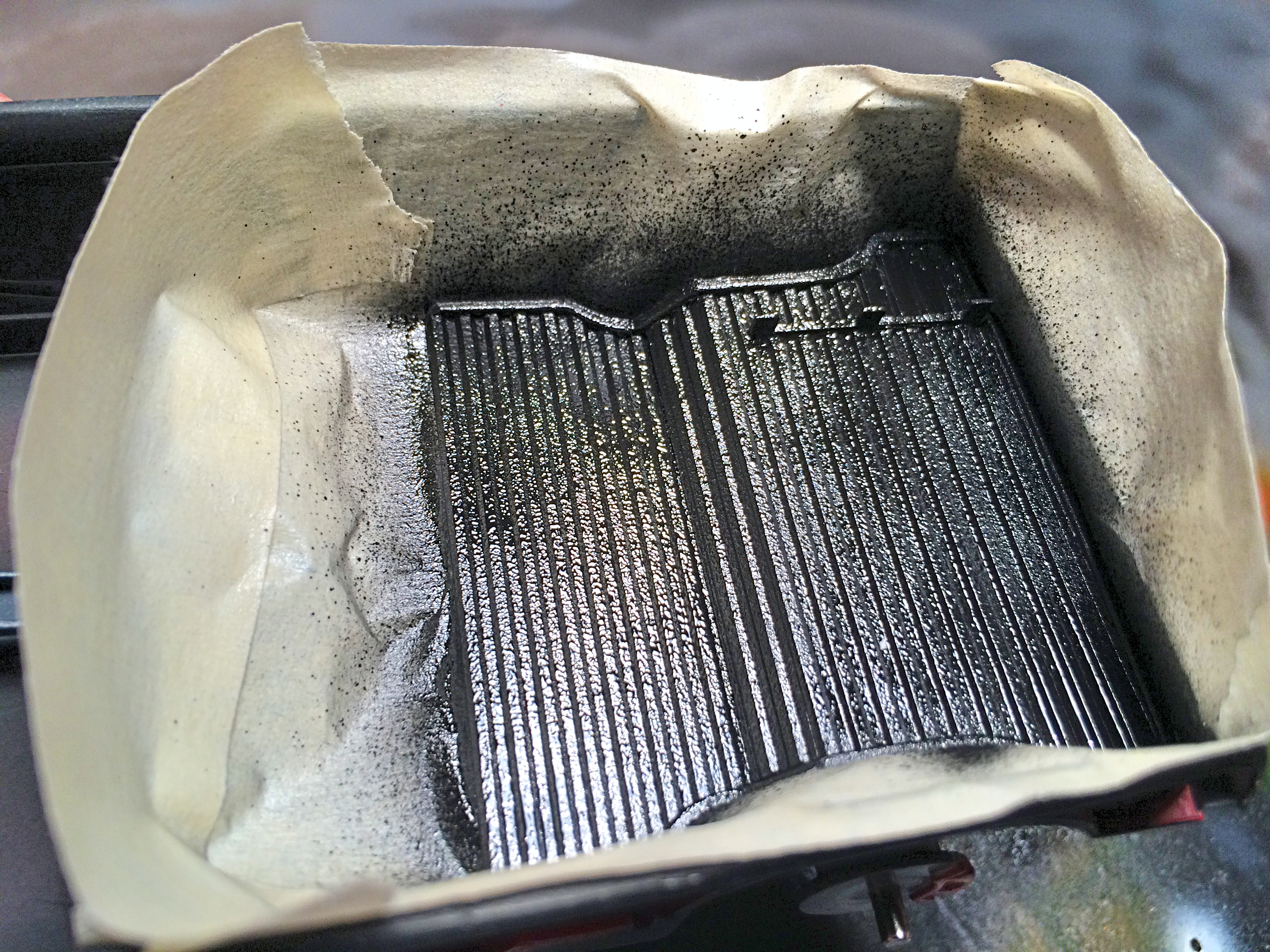

89AKurt Posted October 15, 2018 Posted October 15, 2018 I only used Testors gloss black, with the minimum of thinner, and lowest of air pressure. I tried to do the worst orange peel ever. Since you wanted to match the paint color, seems like the best bet, and save your money for something else. Be sure to fill the corners of your bed before doing any painting!
