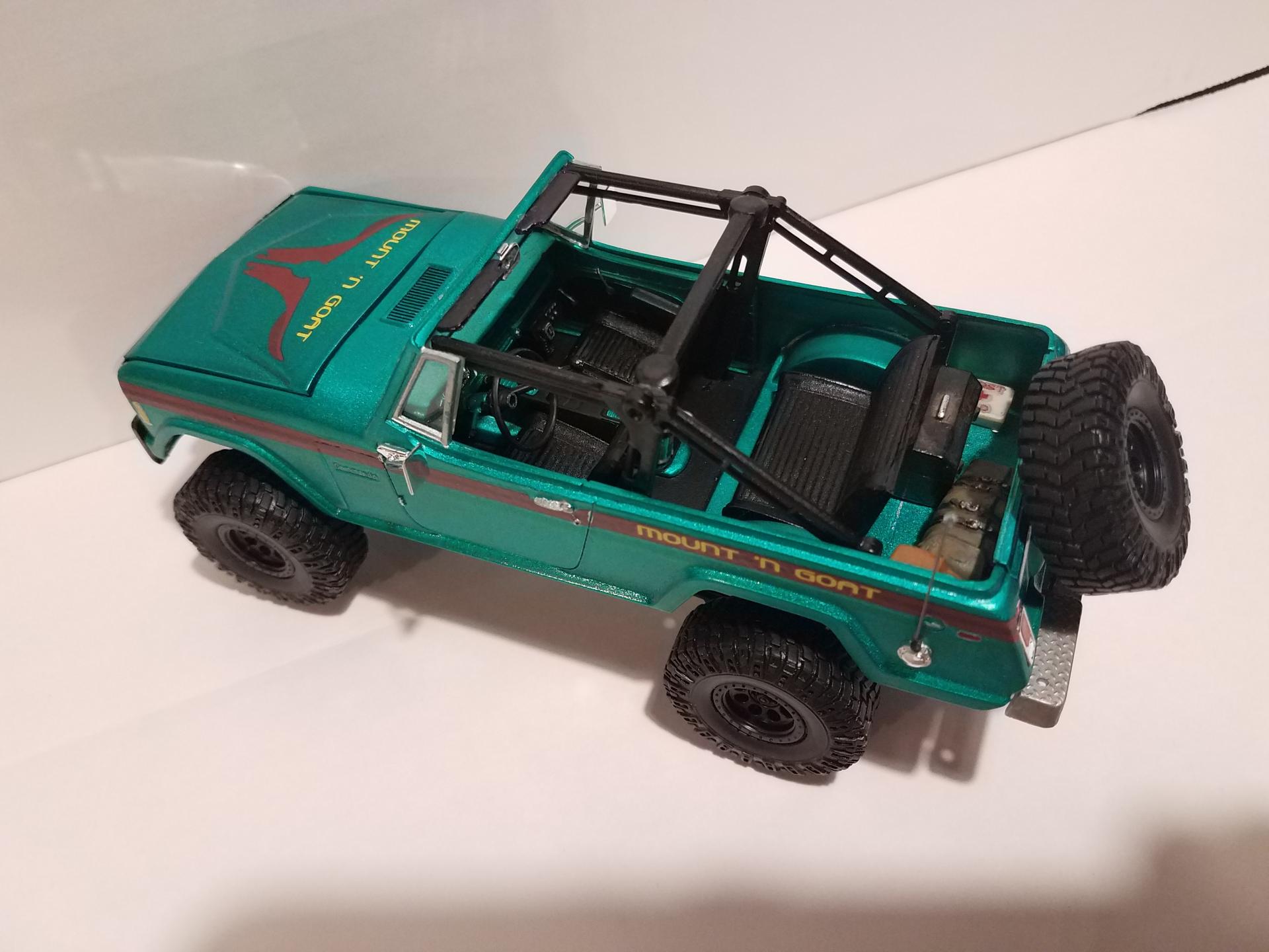

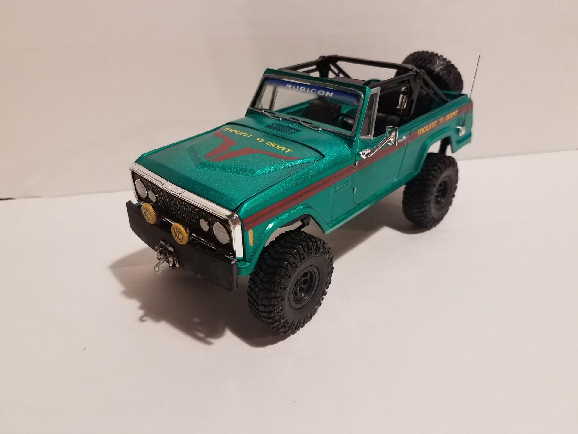

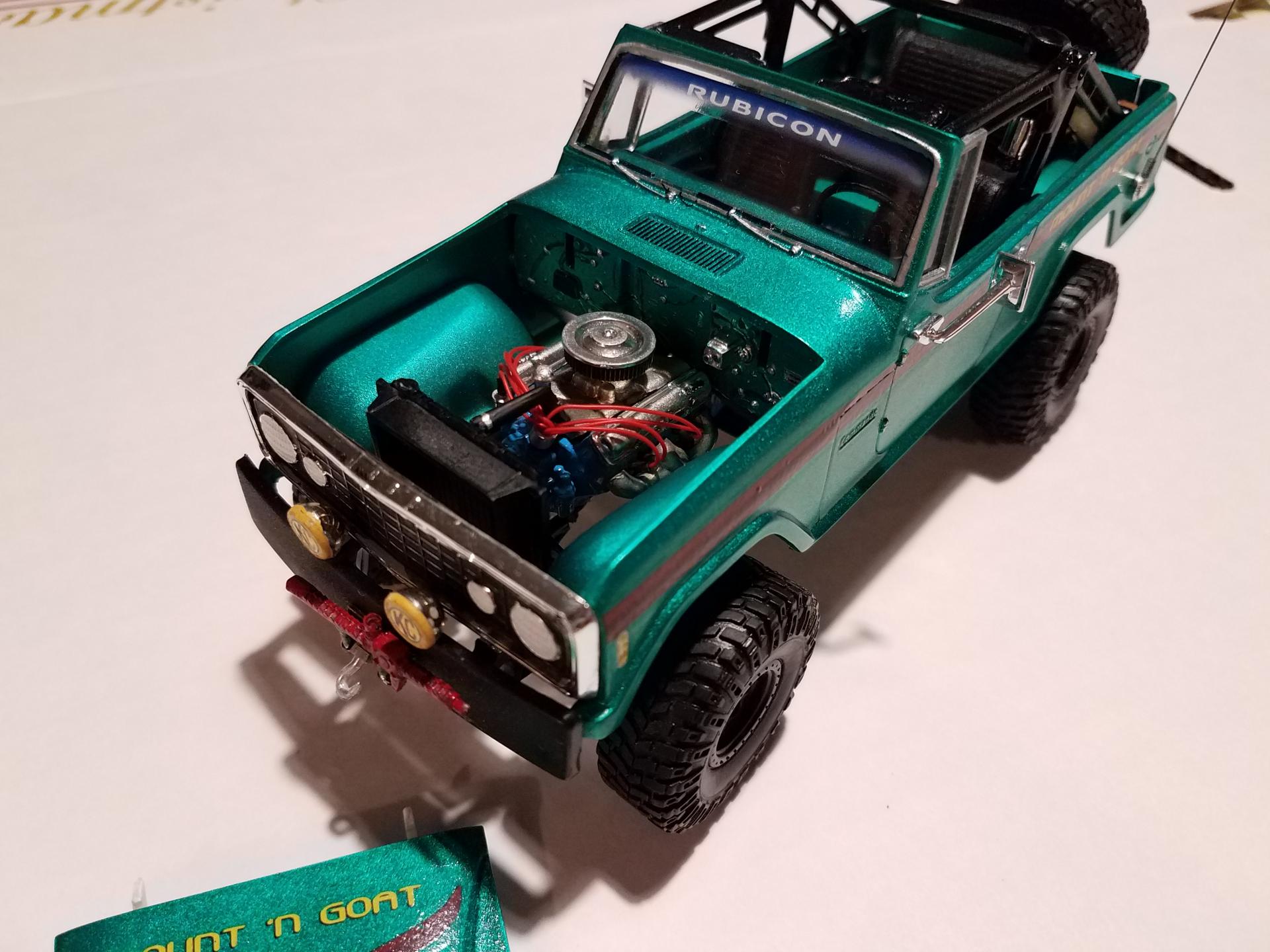

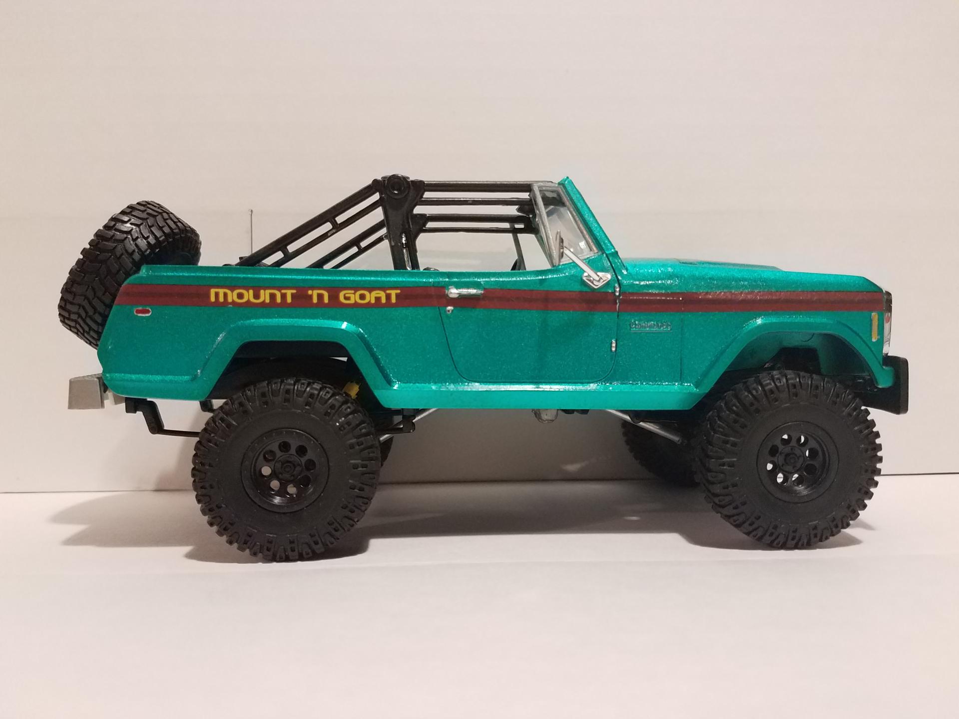

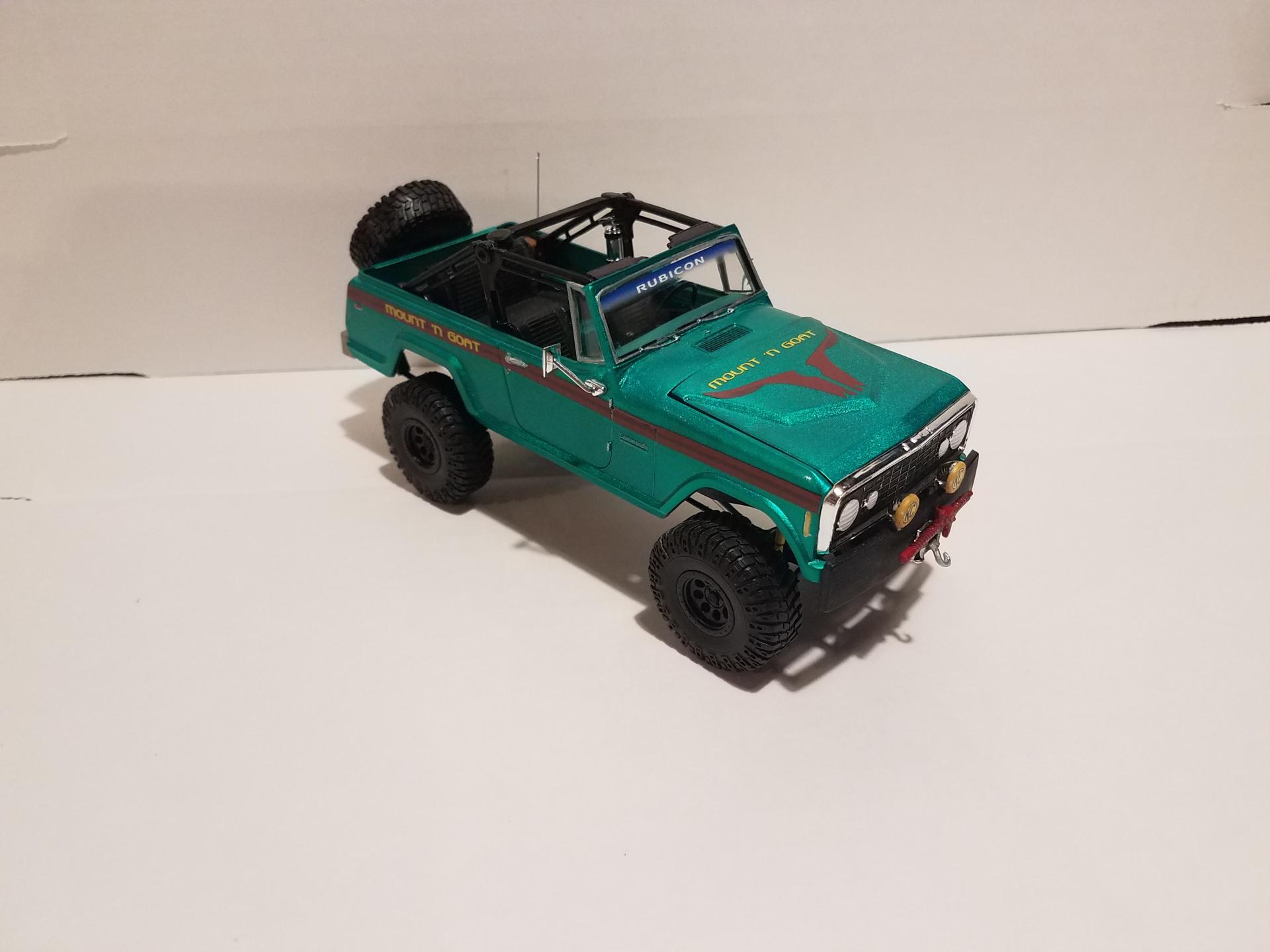

Goose1957 Posted October 19, 2018 Posted October 19, 2018 I finally finished this one. Been working on it for well over a year now, kept hitting roadblocks that would derail me and make me set it aside for a while to cool down. I'm still not happy with the paint on it but I wanted it done, and nothing's perfect anyway. I used Krylon metalizers spray that they used to make, to paint it. First put down a silver coat, followed by the translucent color coat. I've used this paint before with good results, but just couldn't get it to work this time. I think it's because I used a different silver base this time. Oh well. I can't find it in stores anymore so might as well use up whats left over. I used the kit decals (built the Stevens International Mount N Goat version) to try to hide some of the imperfections. I can live with it, after all, it is a Jeep, lol. To make it more prototypical, I shoehorned in an AMC 304 V-8 from a CJ-7 kit I had for parts. I had to move the front crossmember and radiator forward so that the transmission and transfer case would still fit in the frame with the interior tub. I had to hog out the interior tub for clearance and use the shifter console from the kit to cover it up. I then had to make custom driveshafts out of aluminum tubing front and rear so they matched up with the axles and transfer case . When I started building it, I wasn't happy with the off road wheels and tires, I thought they looked too big and toylike. I saw on other threads that some think they are 1/20 scale, which makes sense, they just look "off" to me for some reason. I liked the Jeep Rubicon wheels and tires and used them. I also wasn't sold on the kit rollbar, so out came the Rubicon box again. I had to cut the Rubicon rollbar down a little to fit in the Commando tub, but I think this one looks good on it. Using photos of a Commando I took at the PA Jeep show in York, PA this summer, I detailed the interior the best I could. I shaved off the trim piece that runs around the exterior as my research found this was on eariler Jeepster models with the CJ style front end. I couldn't find any pictures of the later Commandos with the square front ends with this trim piece. Maybe I didn't look hard enough. Somebody more knowledgeable may be able to help. I added some partsbox items in the interior, some KC Hilite offroad lights to the front, and a winch fairlead and hylift jack to the front bumper to give it that weekend warrior look. I'd like to add some more detail to the.engine bay, battery and cables, brake lines, wiring, and more. But for now, I'm done. I'm a little disappointed with the paint, but happy with the rest of the model. Ok, enough blabbering, on with the pics. Ad as always, thanks for looking and comments are welcome. Jeff
mikemodeler Posted October 19, 2018 Posted October 19, 2018 Looks good from here! Nice job on the engine swap and the wheels & tires.
Goose1957 Posted October 19, 2018 Author Posted October 19, 2018 Thanks for the nice comments. I just wish I could paint as nice as a lot of the members on here. I really need to practice wet sanding and polishing more. Jeff

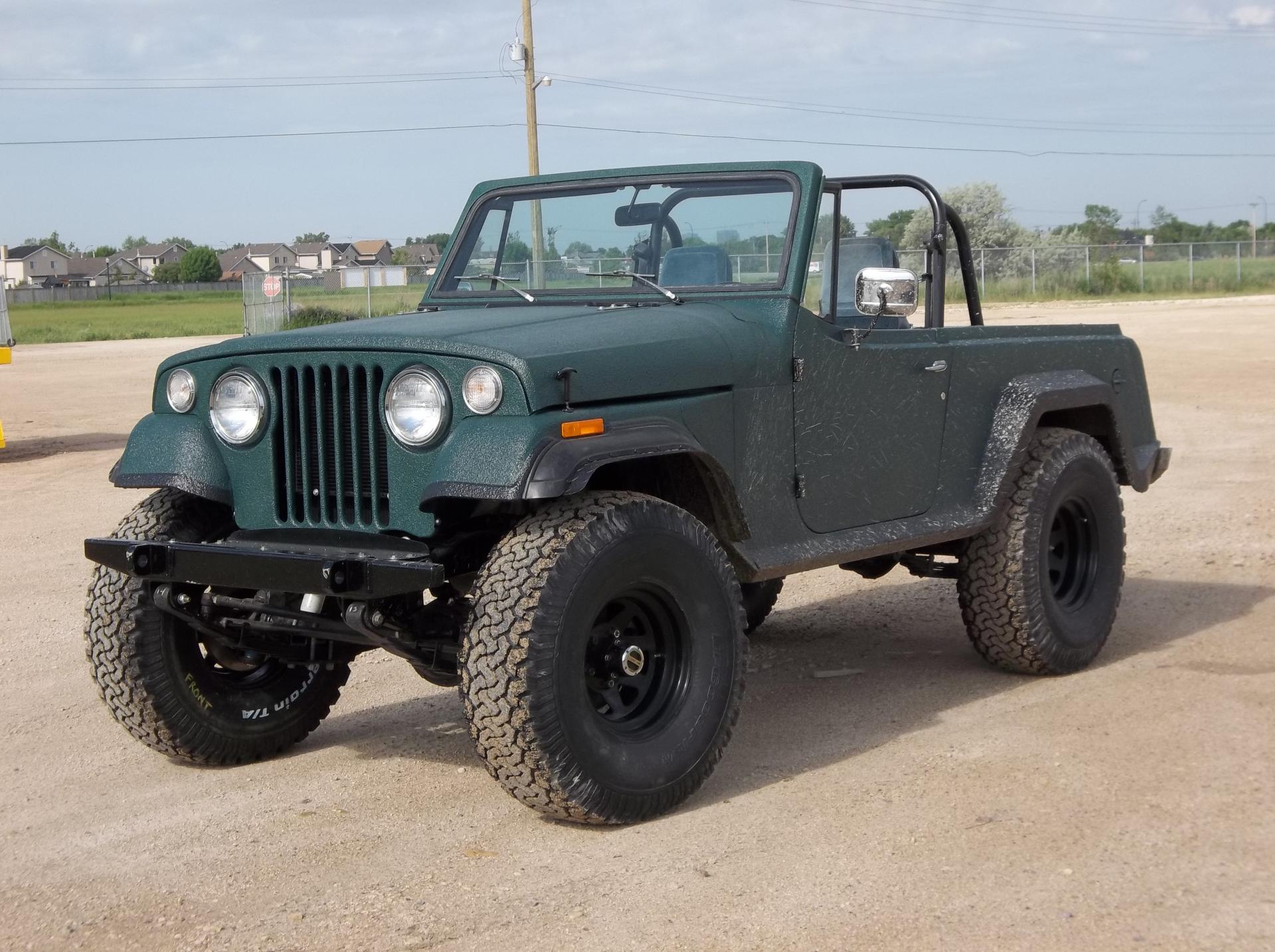

NOBLNG Posted January 30, 2019 Posted January 30, 2019 Cool. Nice job on that one! It sounds like your build went like my 1:1 build. Change one little thing and you wind up having to change 3 more things. I just bought that kit too and plan to either do the front end early style like mine or use the TJ front.
Goose1957 Posted January 30, 2019 Author Posted January 30, 2019 Nice ride! ? If it was mine, I'd half to build the model like the real one. Really nice Jeepster. Hope you wheel it. Jeff
