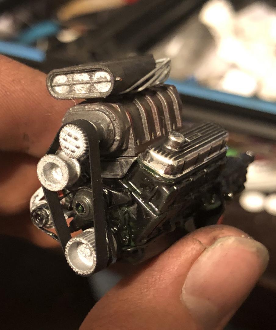

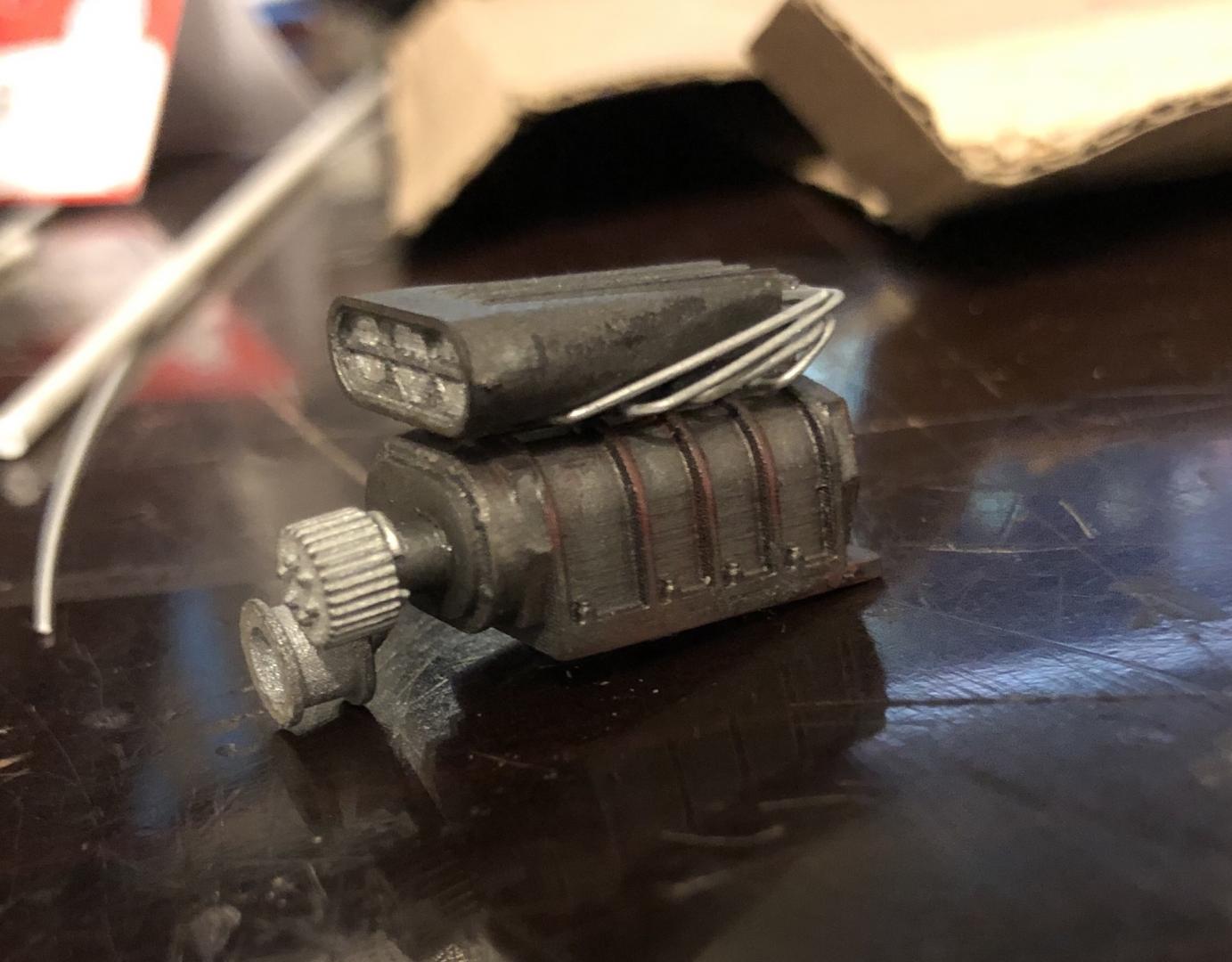

THORDOOR220 Posted December 16, 2018 Author Posted December 16, 2018 (edited) On 12/11/2018 at 11:43 AM, Jantrix said: Very impressive so far. Looking forward to more. Thanks Got the fuel lines on the injector hat done. Not much, but it’s something. Edit: found a little more time and got some more motor work done. Looking good I think. Need to touch up the butterflies though, trying to get those looking right is tough. Edited December 16, 2018 by THORDOOR220

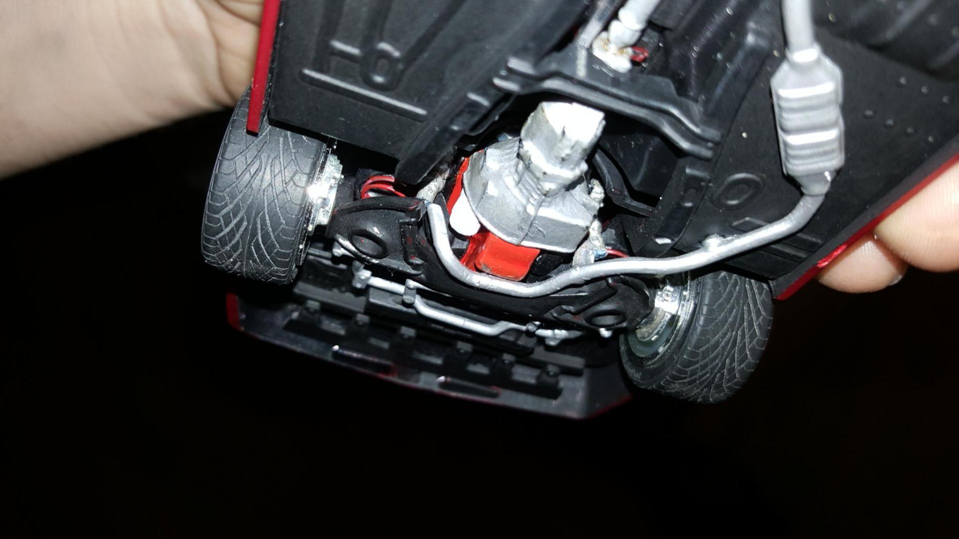

THORDOOR220 Posted December 24, 2018 Author Posted December 24, 2018 Merry Christmas guys! Finished up the front suspension this morning. Needs finishing work to look good yet, obviously enough, but it’s actually all fabricated at this point. Still needs steering...but I have an idea for that. The motor is crooked in the pictures, I have yet to make motor mounts is why. It’s just kinda chillin in there. Also made the cage (just a small 6 point, I might add a couple bars yet to make it more like the 8 point in my foxbody). Made the other door jamb last week. More progress to come
Plastic_Passion Posted December 31, 2018 Posted December 31, 2018 I did something similar to the front end you have going on here but not as dedicated. I fabbed mine up on an 85 tho. Very kitbashed. Love where this is going. I have a 70.5 that's not a Baldwin but I picked up the big spoiler for it.

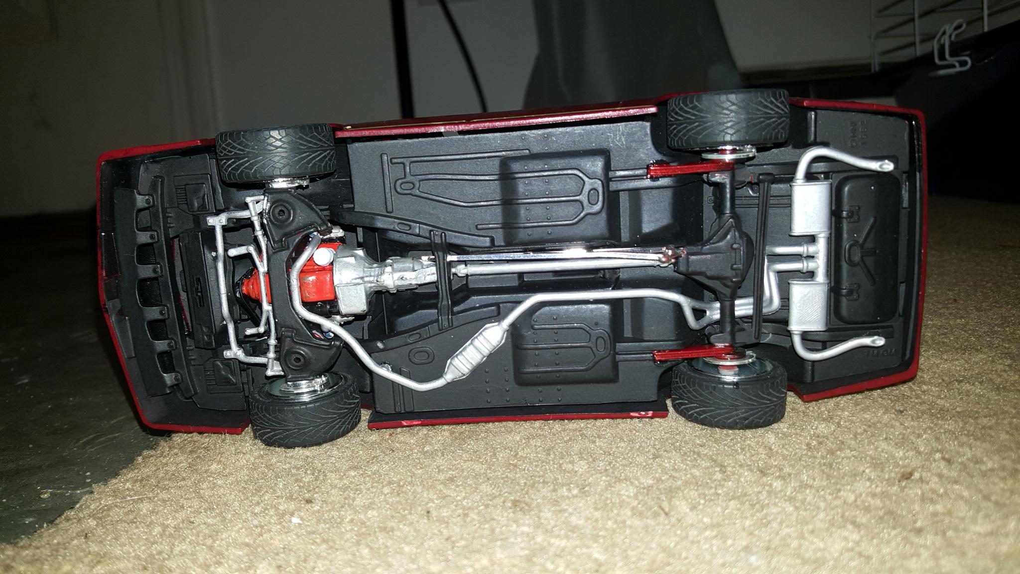

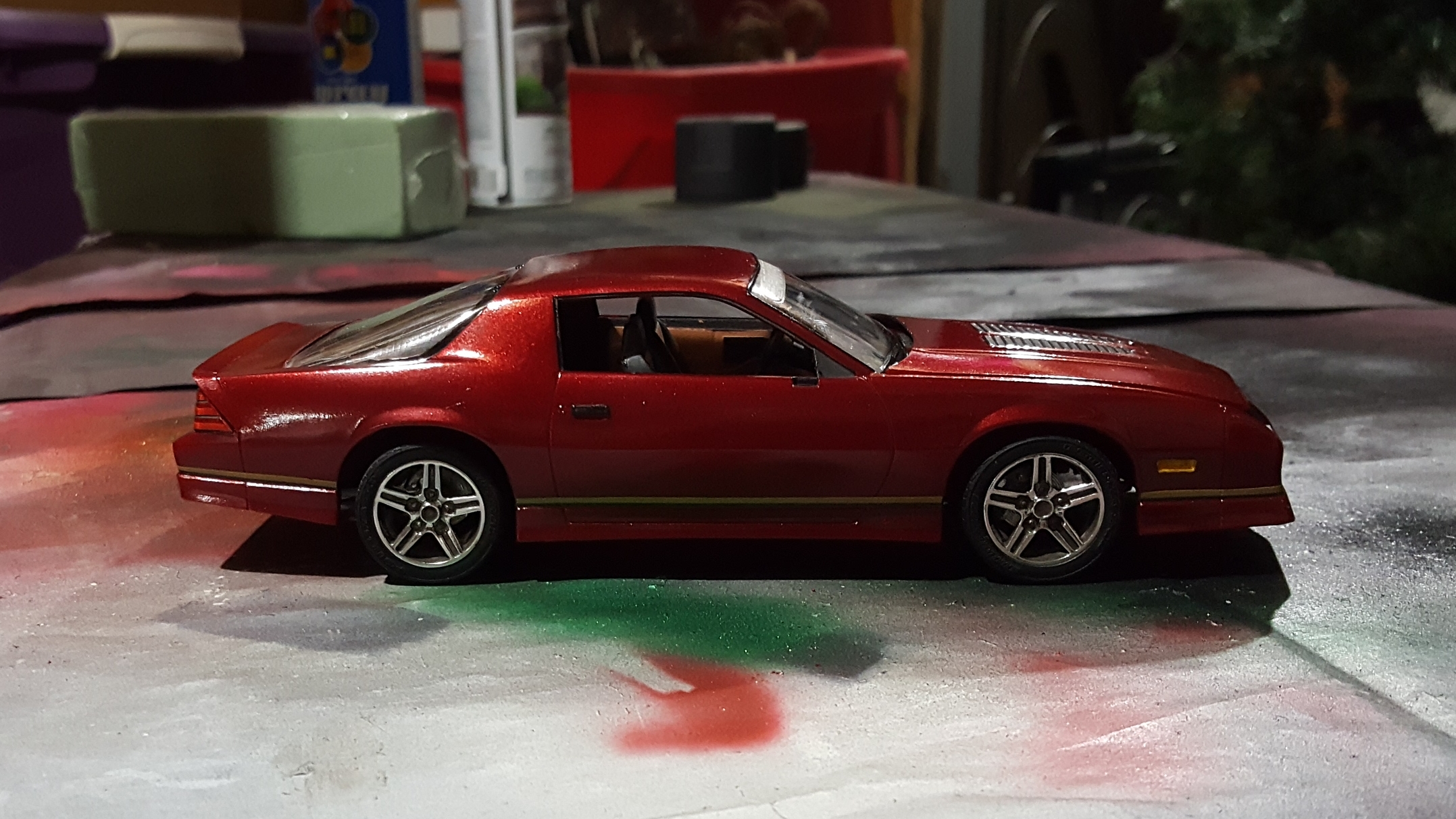

Plastic_Passion Posted December 31, 2018 Posted December 31, 2018 My camaro I did suspension in. Front and rear.
THORDOOR220 Posted January 5, 2019 Author Posted January 5, 2019 On 12/31/2018 at 4:52 PM, Plastic_Passion said: My camaro I did suspension in. Front and rear. That looks fantastic. Your suspension was working? How’d you get it? I wanted to use the factory stuff, but couldn’t make it work, hence the tubular stuff. On 12/31/2018 at 4:56 PM, Plastic_Passion said: My '70 inspiration What’s your plan for the hood, or are you going a different route? Looks like it’ll be a fun build. I’ve made a little progress, mainly just got one door hinged (almost done with the second). I’ll probably get around to that sometime this weekend, and I’ll get some pictures up of whatever I get done.
Plastic_Passion Posted January 6, 2019 Posted January 6, 2019 @THORDOOR220 it actually took me a bit of planning and a lot of trial and error. This kit is revell's motor works 85 z28 kit. And to be honest it's kinda a garbage kit out of the box. This is one of my adolescents survivors. I love the kit for the body and interior however it's like a step above a snap tire. The suspension however was pretty ok to work with. I didnt pin mine like you have. I really wanted to because this is so kitbashed that it would've been perfect however the rear control arms are too thin to pin. So to remedy this I used transmission governor springs that I cut to size. This kit has posts in the front that connect the front a arms to the engine bay(which is a seperate part from the body) so I cut the posts out and figured out my ride height and how much travel I wanted and super glued the springs in. Then for the rear, it was basically the same business as usual. However instead of shocks in the rear there were 2 posts that contacted the inside of the chassis. So I cut those off and glued my springs in and the axle to the springs. Then used a kind of rubber cement but not really. It has great hold but will allow flex. Since I only have stress up and down and in low motion its held up great so far.

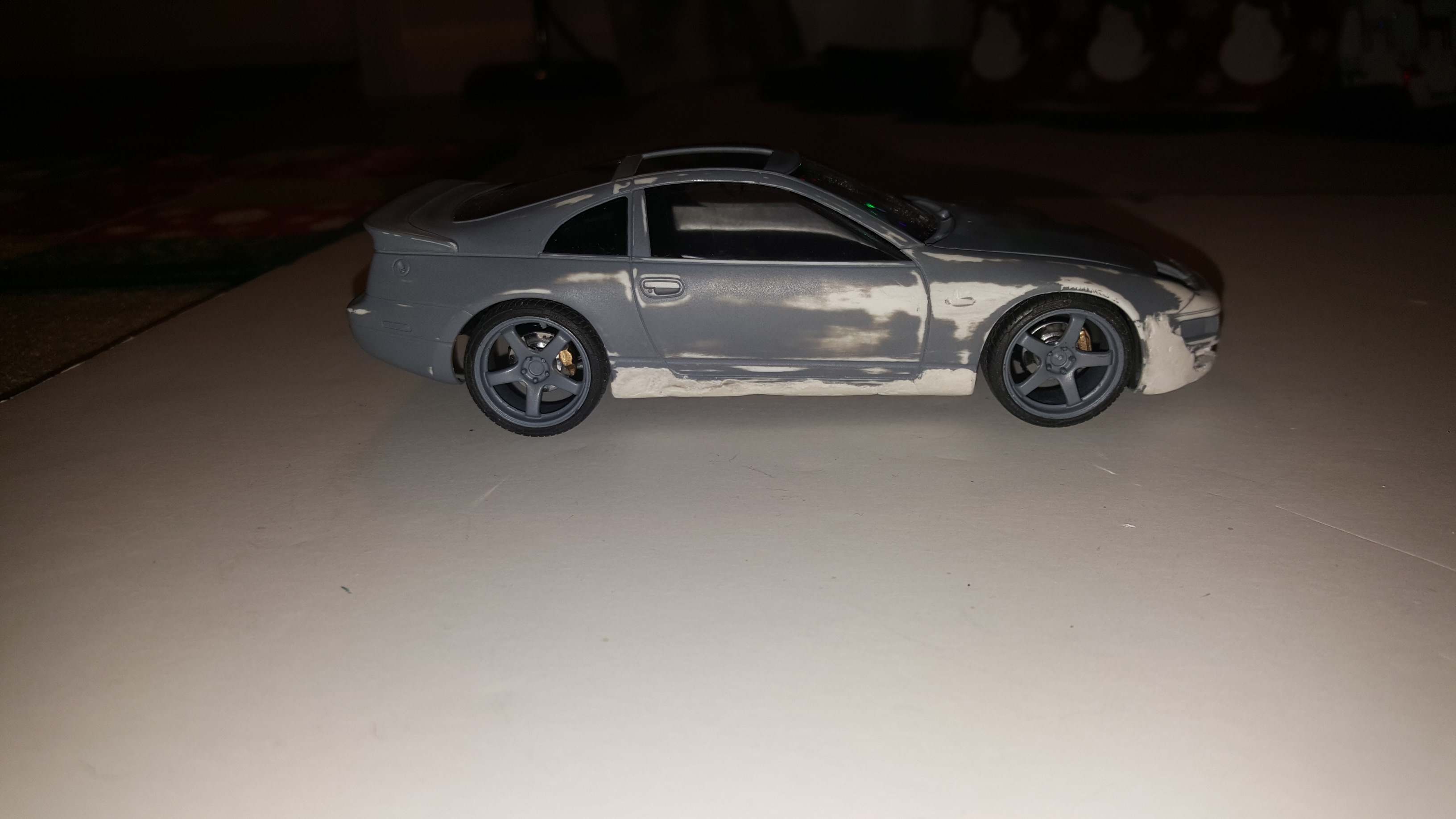

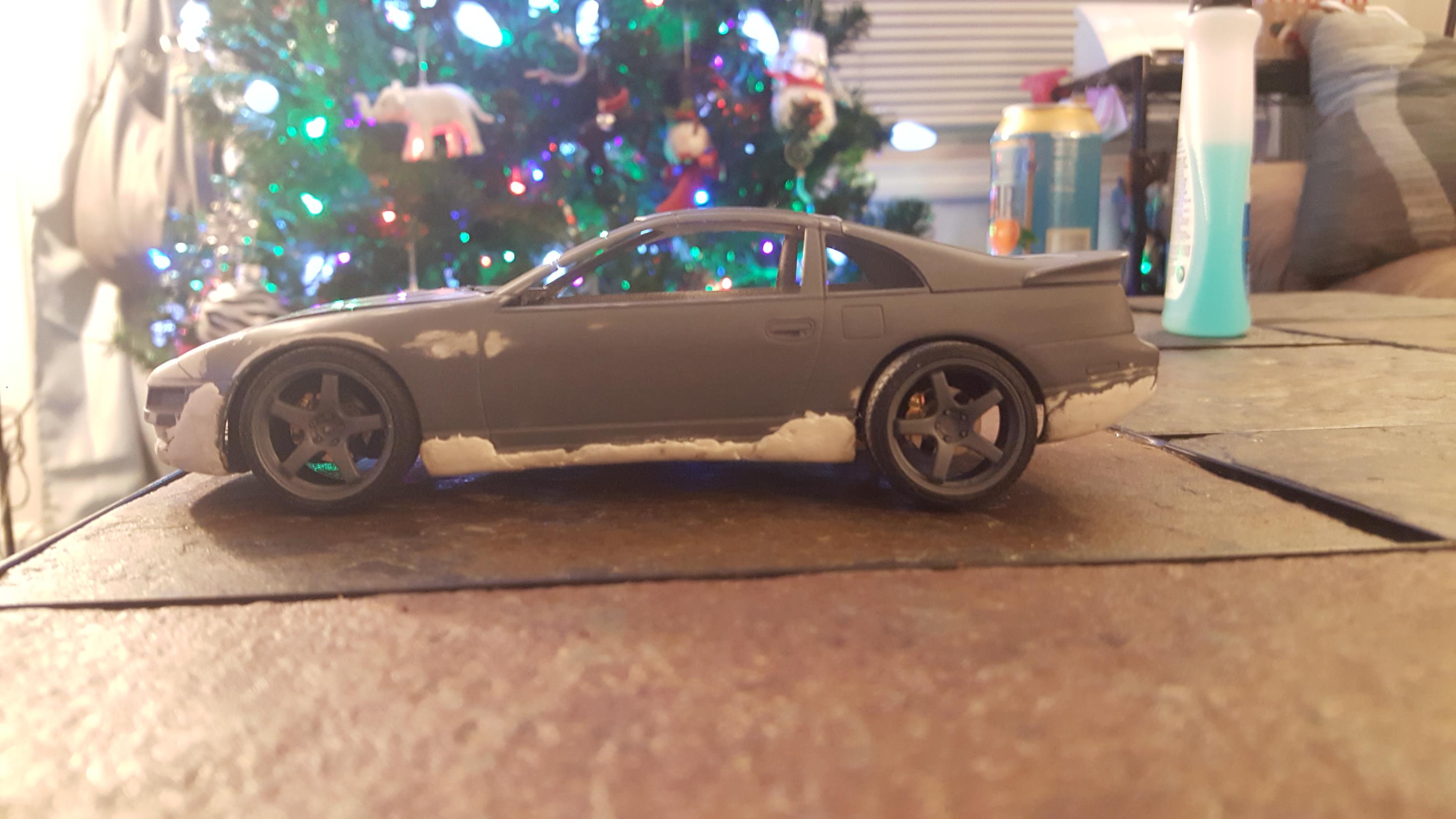

Plastic_Passion Posted January 9, 2019 Posted January 9, 2019 I've relearned a thing or 2 about testors contour putty that I didnt know when I was younger. My girlfriend accidentally turned my 300zx into a convertible that a 18 y/o would drive. So I had to make a body kit for it and bring it back to life. Since nobody makes a body kit for it.... I dug out the ole putty and got to work. The first side I did although theres much more to be done... leaves something to be desired. Once I figured it out the other side came out much better. I think if you have patience it's perfect for the interior.
Plastic_Passion Posted January 9, 2019 Posted January 9, 2019 Like I said it's very much a work in progress but you can see the passengers side has much more going for it than the drivers.
