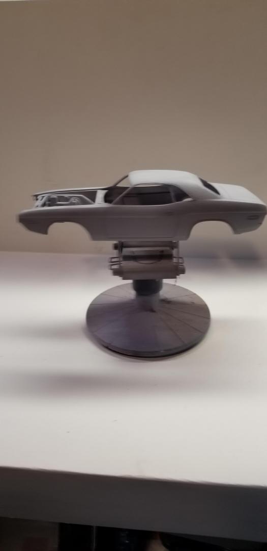

Super28 Posted October 29, 2018 Posted October 29, 2018 (edited) On the rebuild, ready for new paint job Edited October 29, 2018 by Super28 added pic

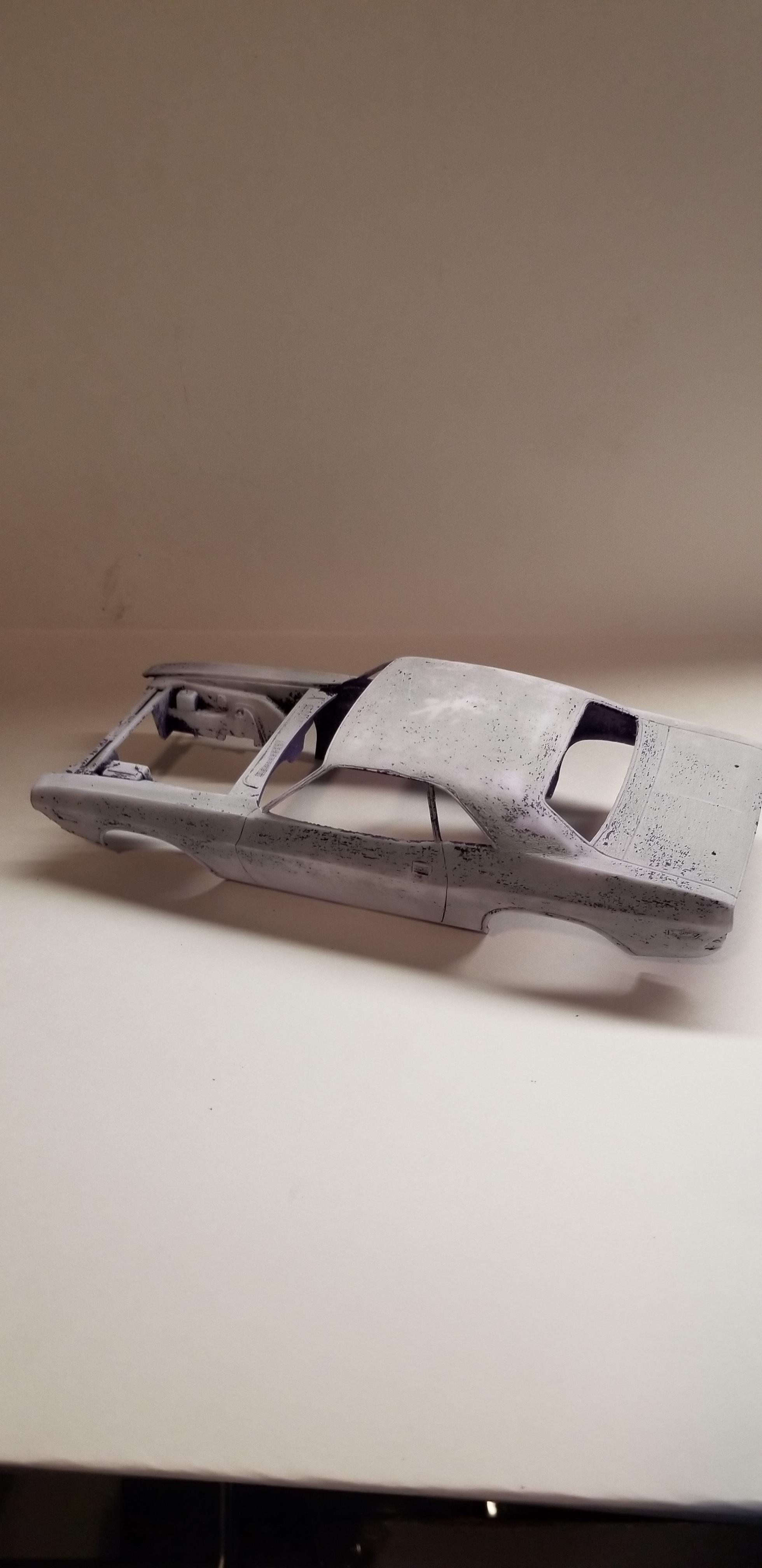

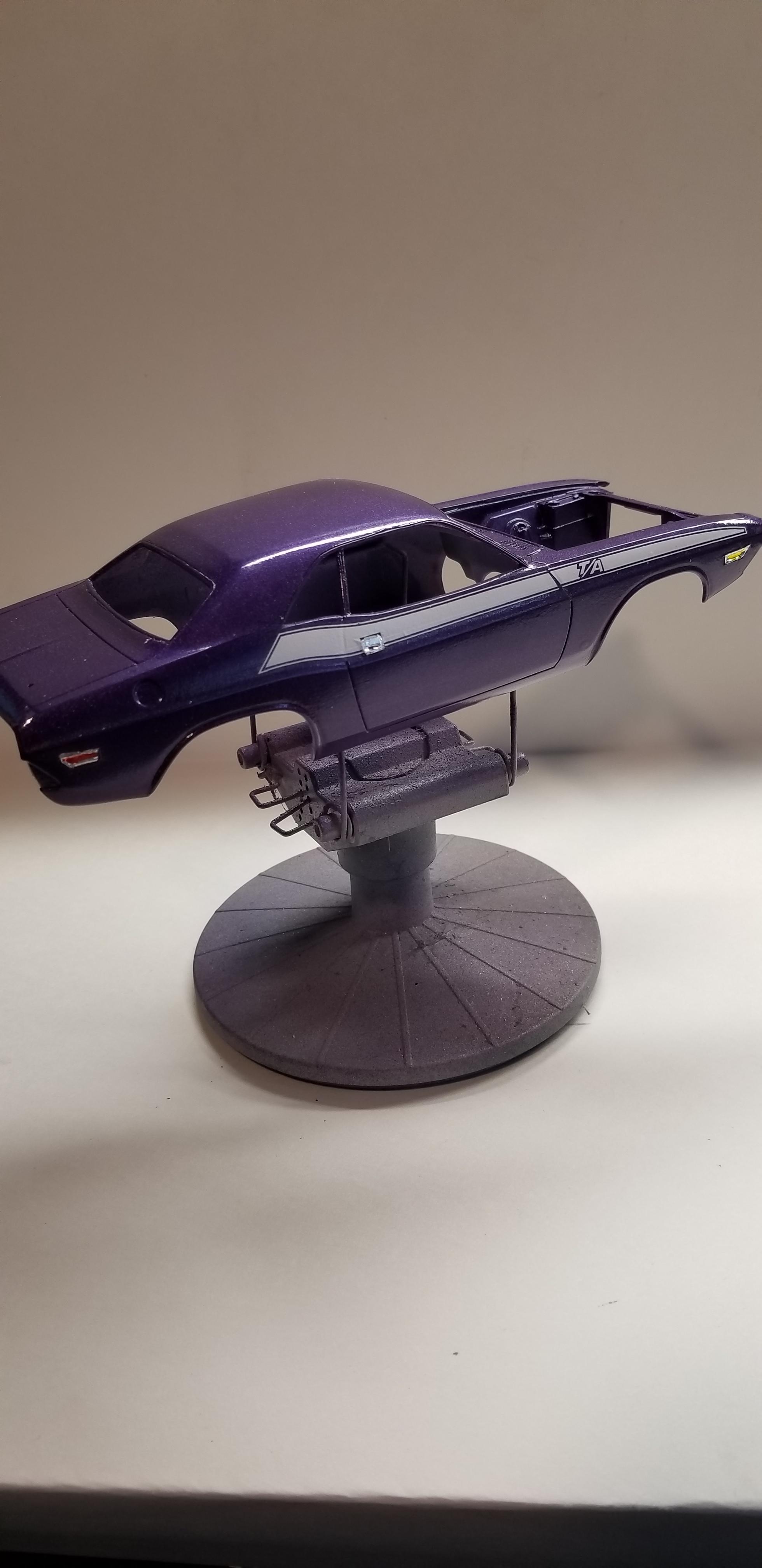

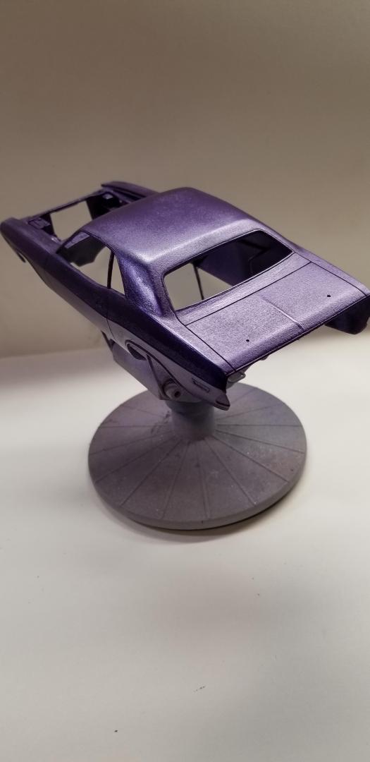

Super28 Posted January 14, 2019 Author Posted January 14, 2019 Ok, Figured out the picture problem! The Challenger I sprayed with de-canned Testor's "Plumb Crazy" purple enamel. When I put the clear, (Rustoleum) enamel to it , it "peeled" like crazy. Had to wipe it down with Acetone. (Purple Power won't touch it with clear coat on it. ). Have to figure out what went wrong. Meanwhile , put it up for now ,while it's still in one piece until later. On to #2, 1962 T-bird Picture 1, Peeled Picture 2) Won't fit in Acetone can (LOL) Picture 3) Stripped back down

bisc63 Posted April 20, 2019 Posted April 20, 2019 Some days...right? I was digging that third pic above, the stained plastic had a real "barn find" weathered appearance that you couldn't easily achieve if you actually wanted to!
Super28 Posted April 20, 2019 Author Posted April 20, 2019 13 hours ago, bisc63 said: Some days...right? I was digging that third pic above, the stained plastic had a real "barn find" weathered appearance that you couldn't easily achieve if you actually wanted to! Didn't notice, but you're right. Hard way to get that look. LOL

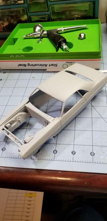

Super28 Posted April 22, 2019 Author Posted April 22, 2019 Nope! Stripped it back down and re-prime it. Gonna lightly sand, wipe off and re-paint again!. Going to get it right!

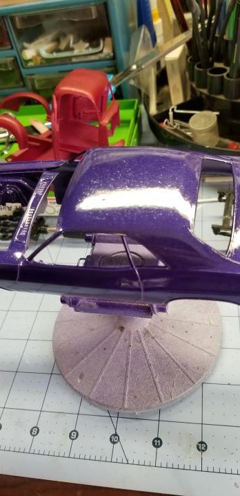

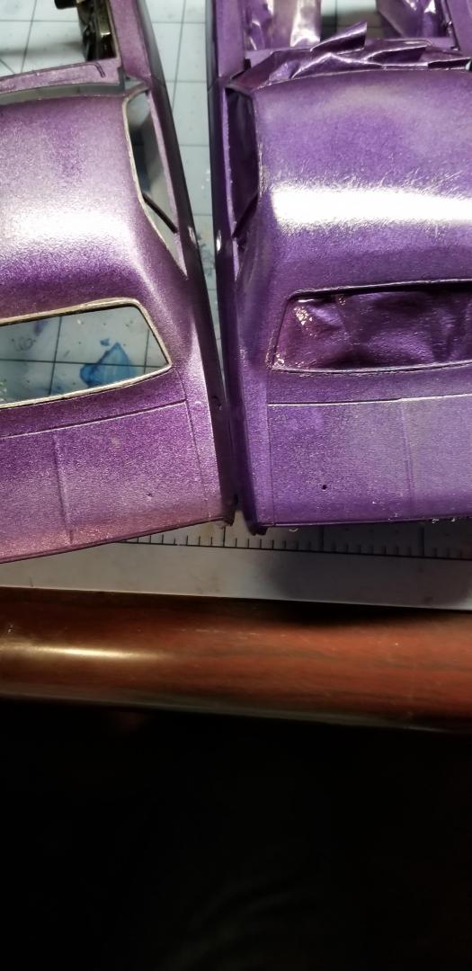

Super28 Posted July 22, 2019 Author Posted July 22, 2019 Nope, dulled out and got rough. Decided that maybe there was too much stripping and repainting so I bought a new 1970 Challenger to paint. This time instead of decanted Testor's Plum Crazy enamel I went with Gravity lacquer . Nope , same thing! What is going on??? Stripping them both down again and going to retry! One on the left is Testor's decanted enamel and one on right is Gravity lacquer . Any ideas? Oh, both had two coats of clear enamel from a rattle can. Never had this problem before.
moparfarmer Posted July 22, 2019 Posted July 22, 2019 Could be maybe something with your brand of primer not being compatable with the paints or plactic from across the sea..
Super28 Posted August 1, 2019 Author Posted August 1, 2019 On 7/22/2019 at 12:29 AM, moparfarmer said: Could be maybe something with your brand of primer not being compatable with the paints or plactic from across the sea.. I use only Tamiya rattle can primer. Regular primer is too thick for me
Super28 Posted August 1, 2019 Author Posted August 1, 2019 Ok. Dumped it in the "Purple Pond", (Purple Power cleaner), over night. Going to use a q-tip and lacquer thinner to clear it up the rest of the way. Sand it down, primer it, scuff the primer and try painting it again! Going with "Plum Crazy" from Galaxy paint. See what happens! (But not right now)
StevenGuthmiller Posted August 2, 2019 Posted August 2, 2019 (edited) You're probably going to have to rethink your material combinations. I doubt very highly that you are going to have any success spraying Rustoleum over Testors enamel. Not all enamels are created equally and if the Rustoleum is anything like most other "home improvement store" enamels, it's way too hot to go over Testors enamel. You also need to take into consideration that Testors enamel takes a month of Sundays to cure, so spraying anything over it without giving it a vast amount of time to cure will likely result in failure. Personally, I would dump the Rustoleum clear altogether. If I may make a suggestion, dump the Testors enamel and get some Testors "2 stage lacquer". They do carry Plum Crazy in lacquer form. It will cure in a fraction of the time and you can spray some Testors clear lacquer over it after a short period of time. For that matter, you will likely have much better luck spraying Testors clear lacquer over the enamel as well. Testora clear lacquers a very mild and they won't generally damage any paint that you spray them over. Just a couple more pointers. 1. Dump the Purple Power and get some Super Clean. I guarantee you it will remove this paint if you give it time to work 2. Never, and I mean NEVER soak styrene plastic in acetone! You will be left with a hand full of goo! I realize that you are joking about this, but we don't want any novices to get the impression that this is okay. Lacquer thinner?........not a good idea either! As a matter of fact, be warned that acetone is very hard on styrene plastic and it WILL make the plastic brittle and prone to basically falling apart, especially with this many applications. Steve Edited August 2, 2019 by StevenGuthmiller

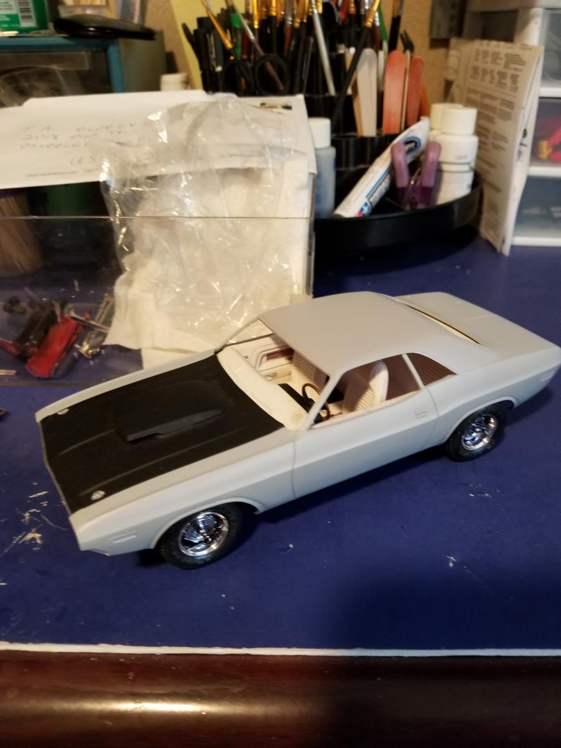

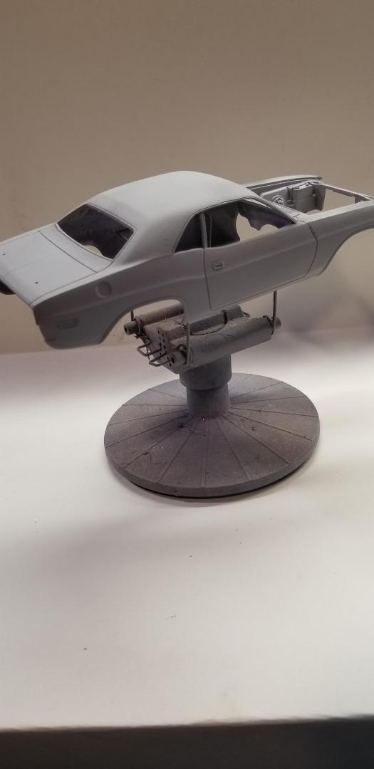

Super28 Posted August 2, 2019 Author Posted August 2, 2019 Threw some primer on the Challenger. Raining here with out clearing out anytime soon. Set aside , get back to it later

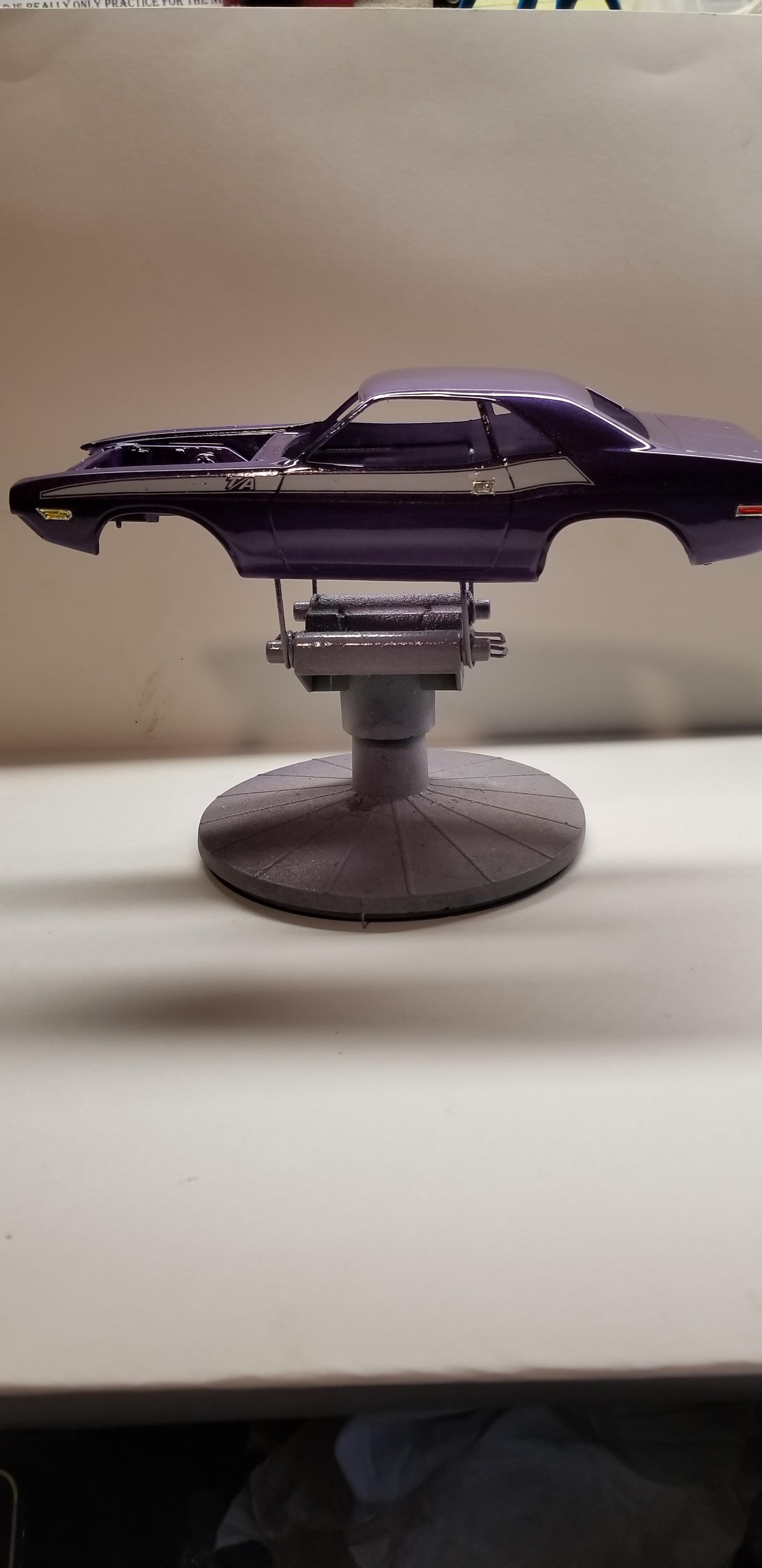

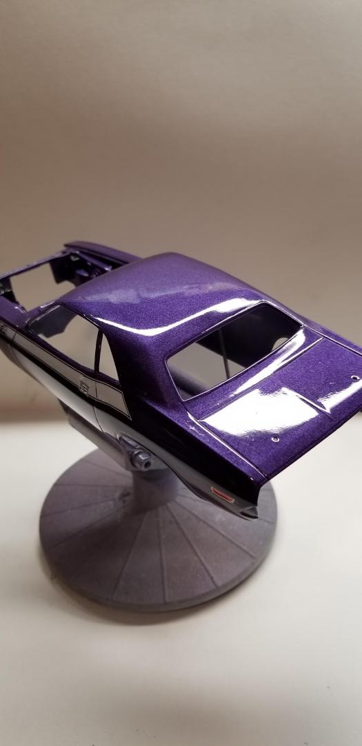

Super28 Posted August 15, 2019 Author Posted August 15, 2019 Ok, I'm going with this. Shoot a couple of clear coats and buff/polish out and see what happens.

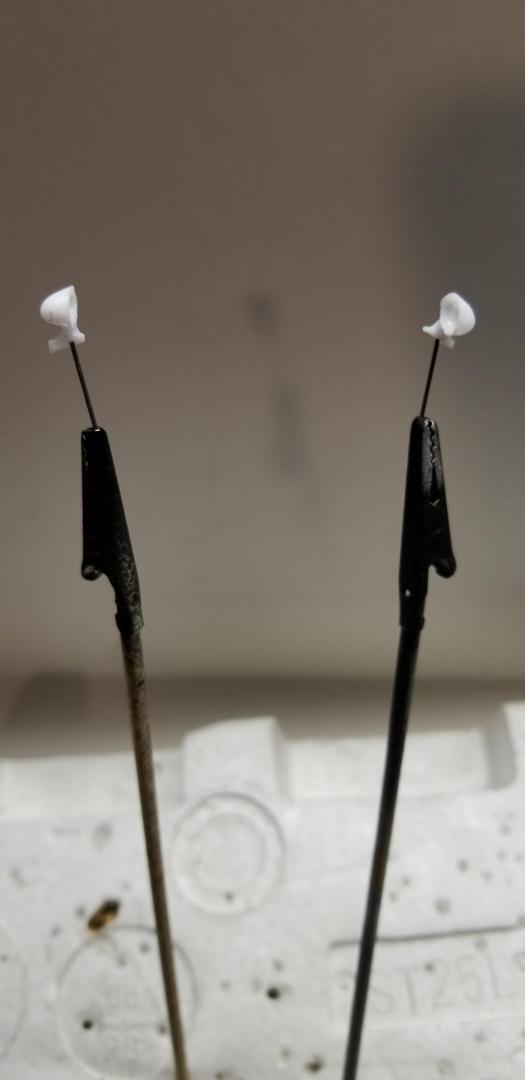

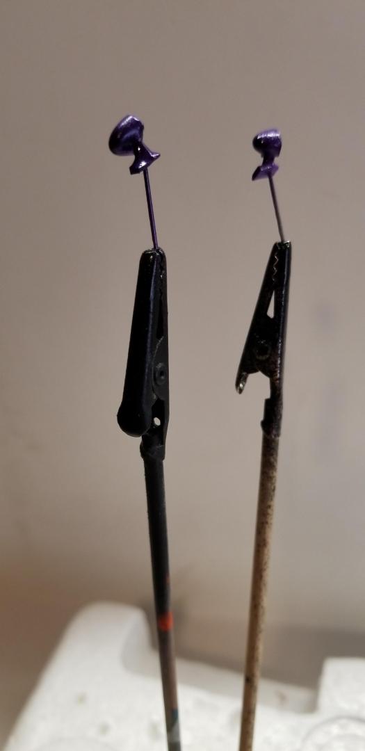

Super28 Posted August 17, 2019 Author Posted August 17, 2019 OK, it's raining here in Florida. Can't do any painting so I thought I'd work on some things. First, i realized the mirrors for the Challenger have to be painted. A tip I got somewhere, I drilled a small hole in the bottom of the mirror and glue a piece of small wire in the hole. Use my clips to hold the mirrors while I paint them . When I go to put them on the car I will cut the wires off leaving just a small piece on the bottom of the mirrors. I'll drill a small hole in the door of the Challenger , where I want the mirrors. The wire will keep them from moving, sliding or falling off!

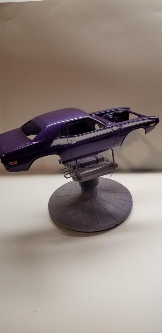

Super28 Posted September 2, 2019 Author Posted September 2, 2019 I think i figured out where my problem was. Not the best paint job in the world but I don't dare strip it down and repaint it again
