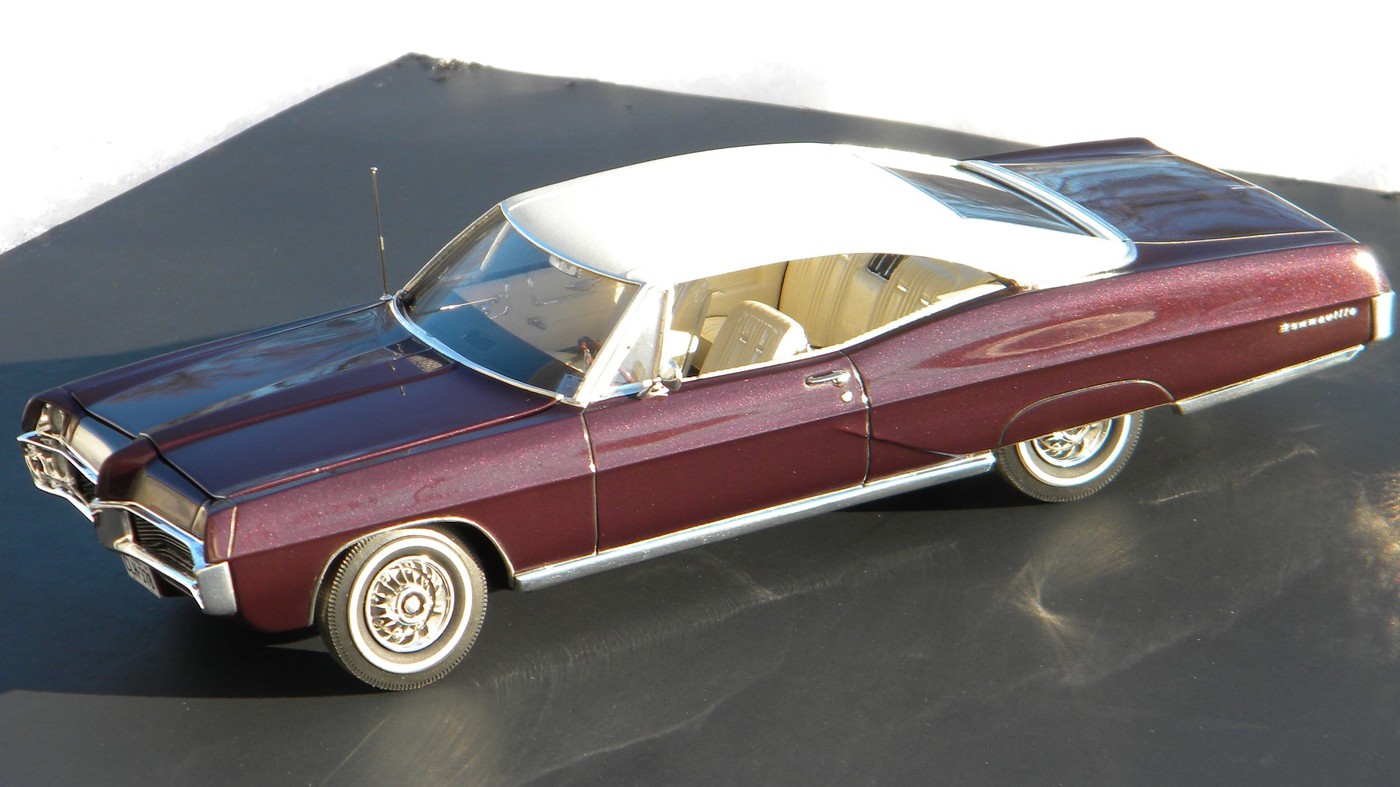

StevenGuthmiller Posted November 9, 2018 Posted November 9, 2018 24 minutes ago, Can-Con said: I always use a similar color as a base when I use pearl. This is a good technique for nearly any color. I will usually shoot as close of a base color as I can find to the finish color I'm using. I usually use a Duplicolor touch up paint for a base under MCW colors. I'm generally not impressed with the metallic particle size in Duplicolor paint, but it works great for a base & it saves on my prized MCW paint. As an example, I used a dark red Duplicolor base under the MCW "Plum Mist" on my '67 Bonneville. I use this technique whenever possible. Steve
