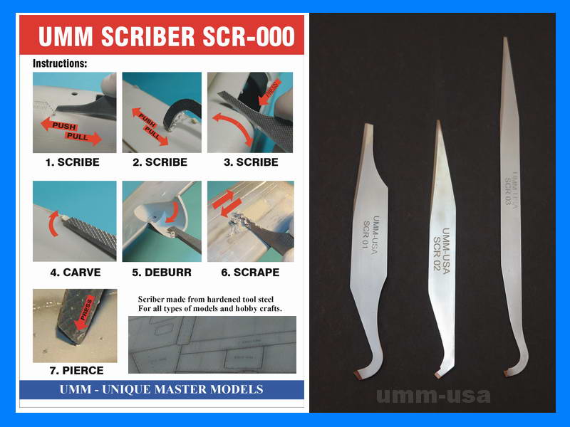

SfanGoch Posted November 27, 2018 Posted November 27, 2018 Check out scribing tools`at UMM-USA . There are stainless scribers from Hauler which I use and recommend. John Vojtech also makes his own scribing tools, which are excellent:

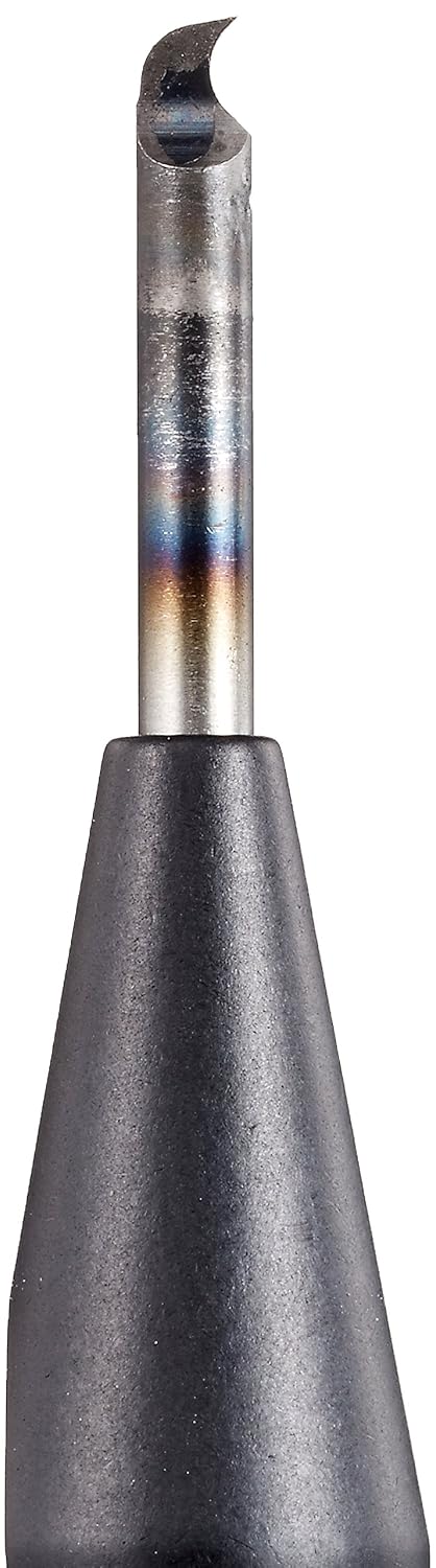

Pete J. Posted November 27, 2018 Posted November 27, 2018 Here is Tamiya's new "engraving" tool reviewed. This is a very nice tool to scribe straight lines with a square bottom. I got a full set from Hobby Link Japan and they are not for the builder without substantial resources. The blades are expensive because they are solid carbide and will hold an edge for a long time. You don't need to spend the money for a holder as a standard pin vice will hold them. I have a large pin vice which gives me a very nice grip with the knurling on the side. Like the review says, the perfect scriber is a holy grail sort of thing. Always looking for the ideal tool. I have drawer full of them. So far the Umm-usa are my favorites, but if you need to control the width of the groove and want a flat bottom, they the Tamiya may be worth the price.
porschercr Posted November 27, 2018 Posted November 27, 2018 (edited) I highly recommend the UMM-USA tools. I''ve got a drawer full of other types, and always go back to the UMM-USA scribers. Edited November 27, 2018 by porschercr

aurfalien Posted November 27, 2018 Author Posted November 27, 2018 Hi and thank you all for posting. The Tamiya seems... well... meh, especially for the price. I think the UMM seems best over all and I will probably go with the SCR-002. That with an Olfa blade should give me a nice toolset for scribing.

Pete J. Posted November 28, 2018 Posted November 28, 2018 (edited) 6 hours ago, aurfalien said: Hi and thank you all for posting. The Tamiya seems... well... meh, especially for the price. I think the UMM seems best over all and I will probably go with the SCR-002. That with an Olfa blade should give me a nice toolset for scribing. I concur with your assessment of the Tamiya on the price but...I had occasion today to use it and it was the only one of the 10 or so scribers I have that would work. I had to clear some glue out from between two white metal parts so a part could be replaced. It is too complicated to explain here, but the tiny size of the head that the fact that I could get it right on the edge of a joint and make a flat bottomed groove made it indispensable. Yes, I use UMM as the first thing I pickup to scribe but these have a special place in my tool set. Would I suggest them as the first and only tool in the box. Heck no! The UMM is too versatile, but I will guarantee you that someday you will need this or something like it if you build enough models so don't dismiss it out of hand. Remember, He who dies with the most tools wins! P.S. It would be fun after I am gone and my kids go through my tools to see them look at each other and say -"What the heck is this for??" Edited November 28, 2018 by Pete J.
aurfalien Posted November 28, 2018 Author Posted November 28, 2018 9 hours ago, Pete J. said: I concur with your assessment of the Tamiya on the price but...I had occasion today to use it and it was the only one of the 10 or so scribers I have that would work. I had to clear some glue out from between two white metal parts so a part could be replaced. It is too complicated to explain here, but the tiny size of the head that the fact that I could get it right on the edge of a joint and make a flat bottomed groove made it indispensable. Could you have used something like scriber blades like those offered by Scale Motorsports or a scribing needle like Flex-I-File scriber needles? 9 hours ago, Pete J. said: Yes, I use UMM as the first thing I pickup to scribe but these have a special place in my tool set. Would I suggest them as the first and only tool in the box. Heck no! The UMM is too versatile, but I will guarantee you that someday you will need this or something like it if you build enough models so don't dismiss it out of hand. I agree. My current situation is such that I have to start over and rebuild a solid tool set foundation. But as I progress, I'm sure to get niche/specific use products. 9 hours ago, Pete J. said: Remember, He who dies with the most tools wins! Agreed, and model kits too
Pete J. Posted November 28, 2018 Posted November 28, 2018 (edited) 1 hour ago, aurfalien said: Could you have used something like scriber blades like those offered by Scale Motorsports or a scribing needle like Flex-I-File scriber needles? No, it was the top of a block with a locating pin about 1/8" in diameter and a tab the same size with a small area between. I needed the area between them to be flat to fit the locating holes. I tried my UMM but it wouldn't get between the two pieces. The .5mm blade was just the right size. A wedge shaped scribers or pointed scribers would not have worked to make a smooth flat bottom. The flat part is important to maximize the contact area for gluing. This is holding a landing gear in place on a very heavy(all photoetched and white metal) 1:32 scale aircraft. Has to be done right. Would I have spent $150(US full retail) on this tool just to do this? Oh heck no, but I was glad I had it. It did exactly what I wanted. Like most tools, once you own it, you find uses for it. It really doesn't replace other tools, but is complements my collection of scribers nicely. Do you need it? At about $175 for the full set, it is very low on most lists of must have tools. I can see buying one or two blades and using them with your pin vise. If you have to have the full set, can be had with all five blades and the handle for about $95 from Hobbylink Japan. At that price it is still not cheap, but that is an individual choice. Edited November 28, 2018 by Pete J.

SfanGoch Posted November 28, 2018 Posted November 28, 2018 (edited) Bill, dollars to donuts it was John Vojtech, owner of UMM-USA. His instructional videos are still up on Youtube. Here's one: I also like the stainless scribers made by Hauler, HQT004 The scribers are only .18mm thick. Edited November 28, 2018 by SfanGoch
Bainford Posted November 28, 2018 Posted November 28, 2018 It is curious the individual tastes for tools of this nature. I purchased a UMM SCR-02 scriber last year on a recommendation from a forum member, but found it to be a waste of money. I tried it several times but it just wasn't the tool for me. I also found the quality of manufacture to be only fair. I used the BMF scriber for many years, and it is a good and effective tool, and holds an edge surprisingly well, but the score lines are a bit too wide for some purposes. I still use it when a wide scribe is needed. I considered grinding it narrower but instead found a couple of dental picks with a very good scribing profile, and much narrower than the BMF scriber. I few minutes with a stone and the dental pick was converted into a great scriber with good control. However, my favourite scriber is one I cut out of a discarded Exacto blade. The blade was ground narrow at the cutting tip and a cutting edge was formed that pulls a wonderful curl and leaves a nice square bottom to the groove. I turns corners well also. The blade has a 1" long piece of heat shrink tuning applied to the tang to act as a handle, keeping it short and light, like a pin-stripers paint brush, for good control. I'd love post a photo to illustrate but don't have that ability at this time.
SfanGoch Posted November 28, 2018 Posted November 28, 2018 To each, his own. I have the UMM SCR-01/02/03 set and they suit my requirements. I also use the Hauler set I posted above. UMM also makes an ultra-thin scriber which is only .15mm thick, matching the blade kerf of their universal razor saws.
