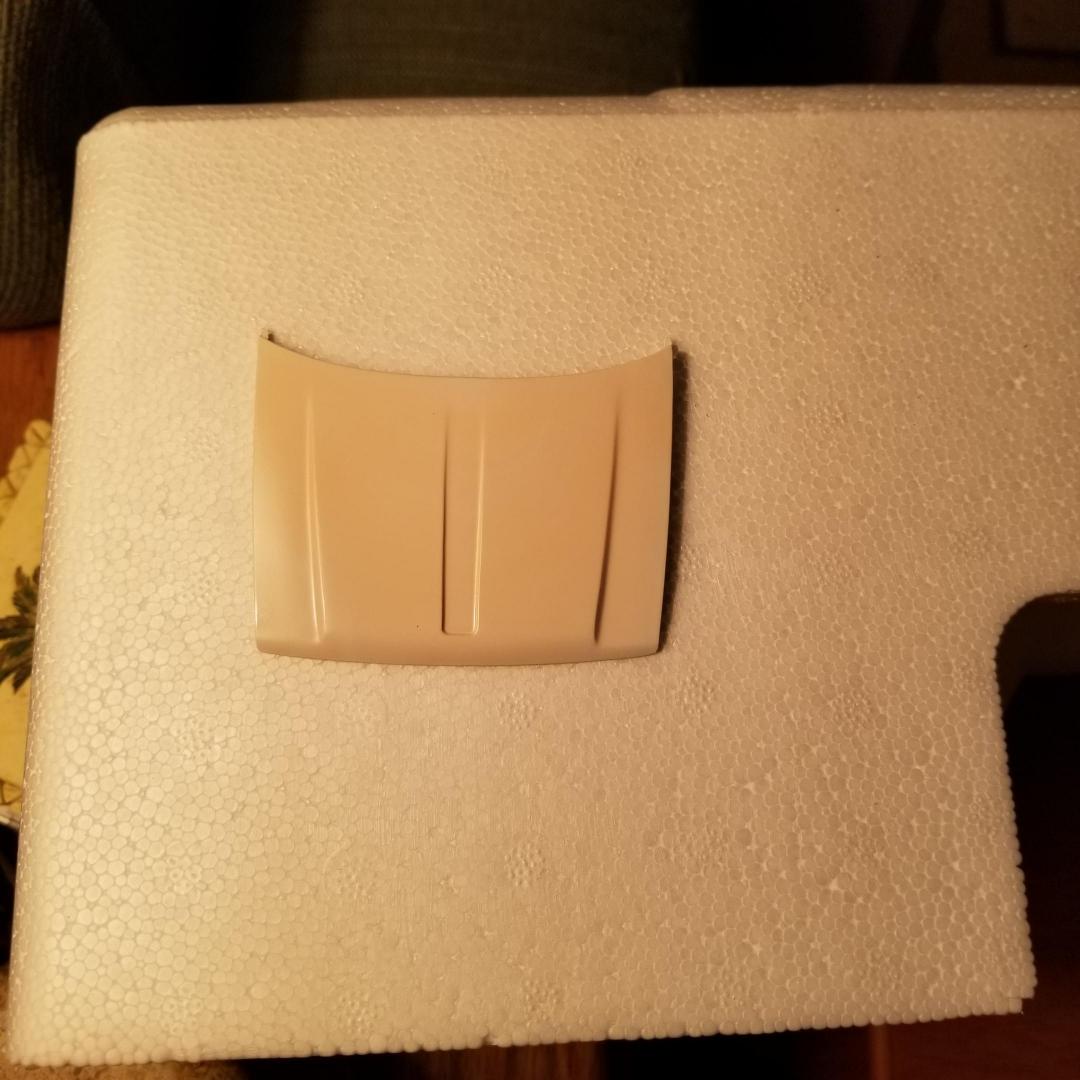

Steamboat Posted December 31, 2018 Posted December 31, 2018 I've got to give the Mr. Surfacer a thumbs-down. I wanted to paint the Lindberg Jeep Cherokee, which is molded in red. My son's 1:1 Jeep is white. Here's what the hood looks like after 2 coats of Mr. Surfacer white and 1 coat of Tamiya TS-26 white. I guess the model is going to end up being painted brown!

Snake45 Posted January 1, 2019 Posted January 1, 2019 1 hour ago, Straightliner59 said: twenty-plus years later, the car is still as yellow as the day I shot it! And why wouldn't it be? It's an absolute myth that red pigment somehow "leaches out" of the plastic and into/through paint.
peteski Posted January 1, 2019 Posted January 1, 2019 42 minutes ago, Snake45 said: And why wouldn't it be? It's an absolute myth that red pigment somehow "leaches out" of the plastic and into/through paint. Looking at the photo Steamboat posted I would have thought differently. Besides, you made a blanket statement while there are many different formulations of polystyrene and red dyes being used for model kits. Some might leach out, while others don't.

Snake45 Posted January 1, 2019 Posted January 1, 2019 29 minutes ago, peteski said: Looking at the photo Steamboat posted I would have thought differently. Besides, you made a blanket statement while there are many different formulations of polystyrene and red dyes being used for model kits. Some might leach out, while others don't. Steamboat laid the blame in his first line. For years I've asked someone to name me the chemical that will "bleach" the color out of plastic. I've also asked for pictures of a red body that's been painted and stripped and now seems to be less red. To date, no one has met either challenge.
peteski Posted January 1, 2019 Posted January 1, 2019 3 minutes ago, Snake45 said: Steamboat laid the blame in his first line. What exactly do you mean? Mr. Surfacer is not opaque enough to cover the red plastic, or some solvent in Mr. Surfacer is causing the red dye to leach out?
Snake45 Posted January 1, 2019 Posted January 1, 2019 2 minutes ago, peteski said: What exactly do you mean? Mr. Surfacer is not opaque enough to cover the red plastic, or some solvent in Mr. Surfacer is causing the red dye to leach out? The former would be my theory. I've covered red plastic just fine with cheap Walmart Gray primer, followed by Walmart White primer. No "bleed" at all, no tinting. But the stuff is getting hard to find. My store doesn't carry either color anymore, only black, and availability on the Walmart website is spotty--you just have to keep checking until they have it. I brush painted these Monkeemobile seats, molded in red, with Testor white in 1967. Last year when I restored it, I didn't strip them, but I DID go all around the glued joints with file and sandpaper to get rid of the seams. Then I hit them with just two coats of Walmart White Primer (no other primer under that). See any red bleed through around the rim of the backs? Me neither.
