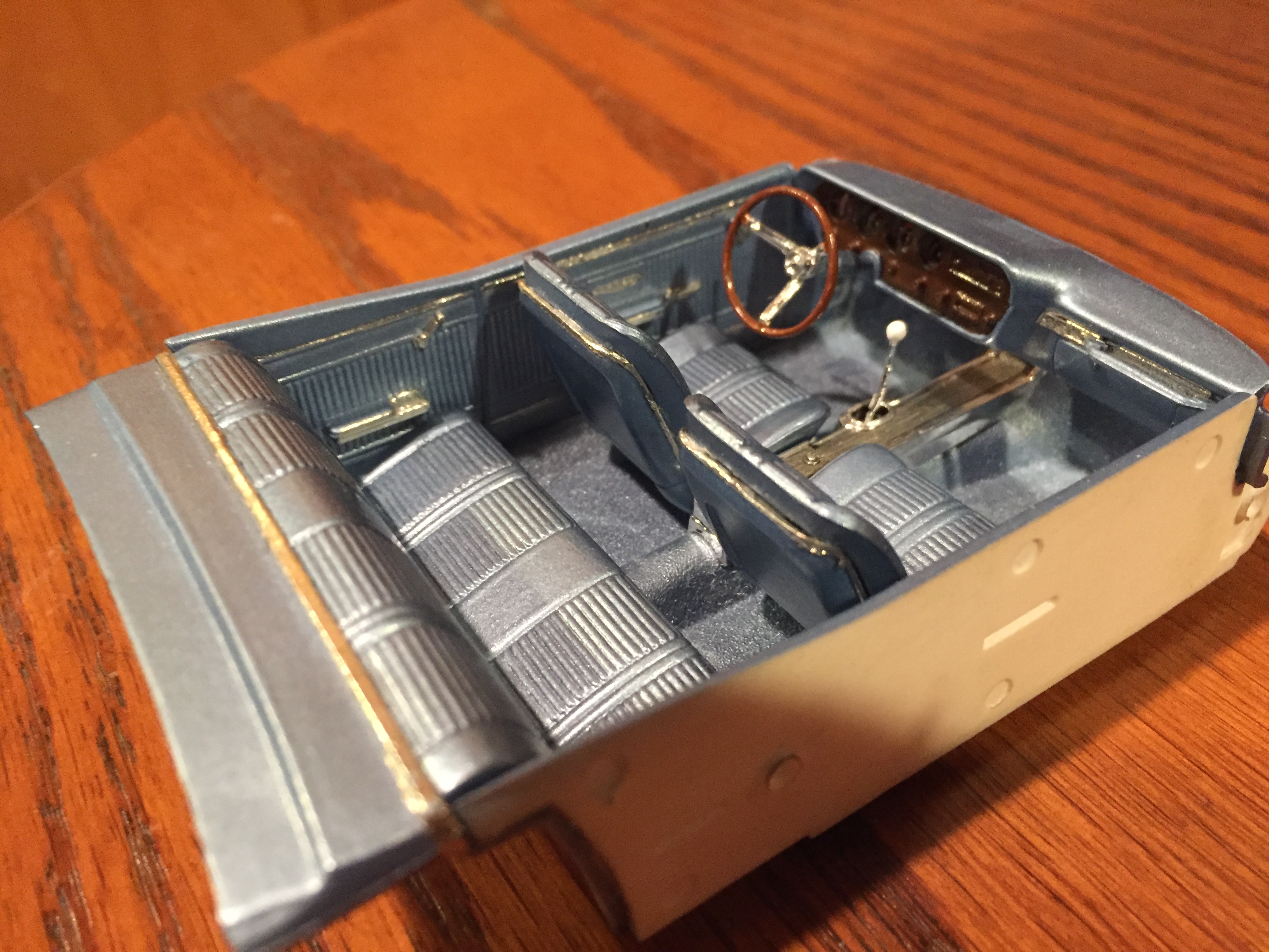

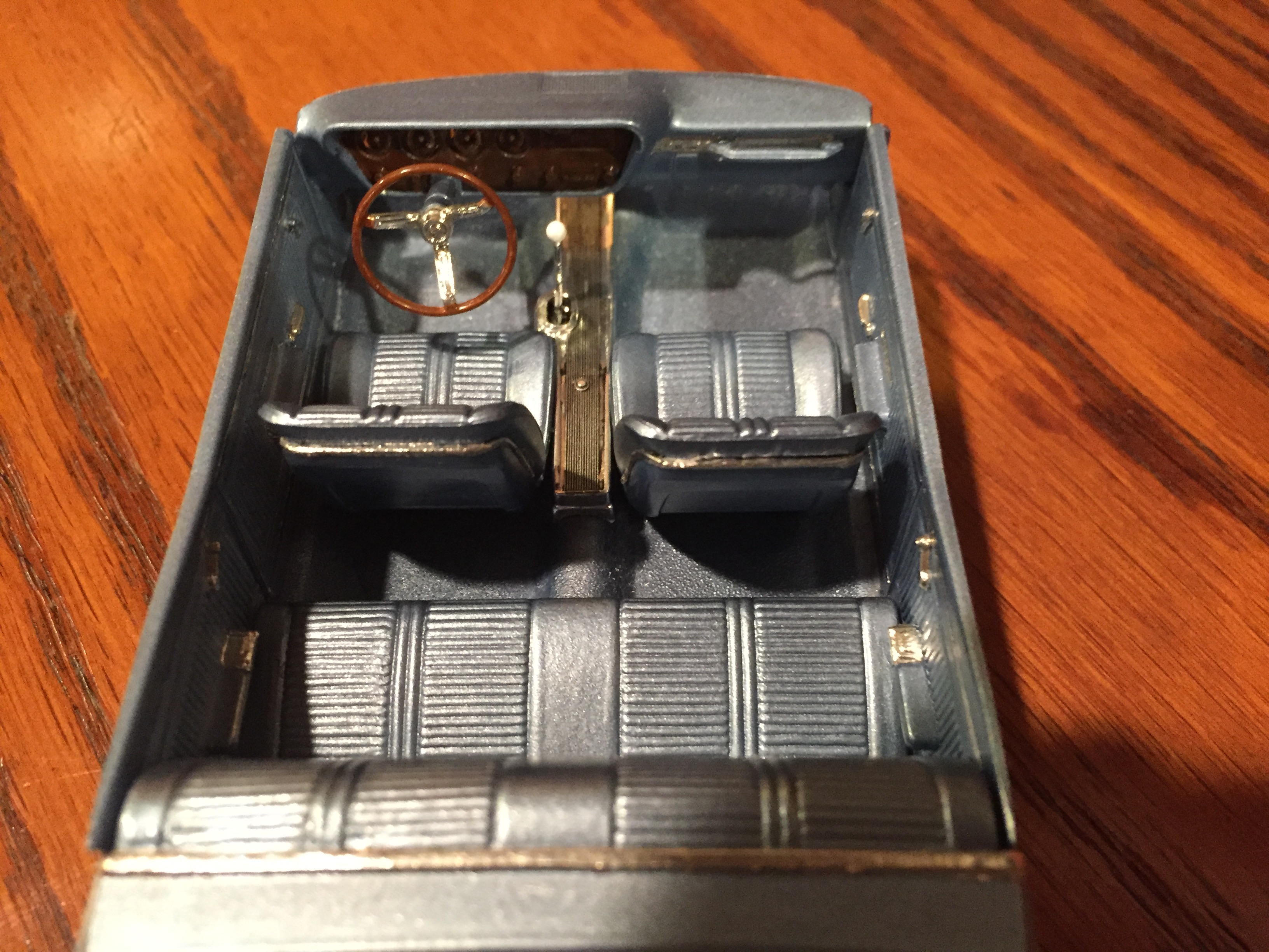

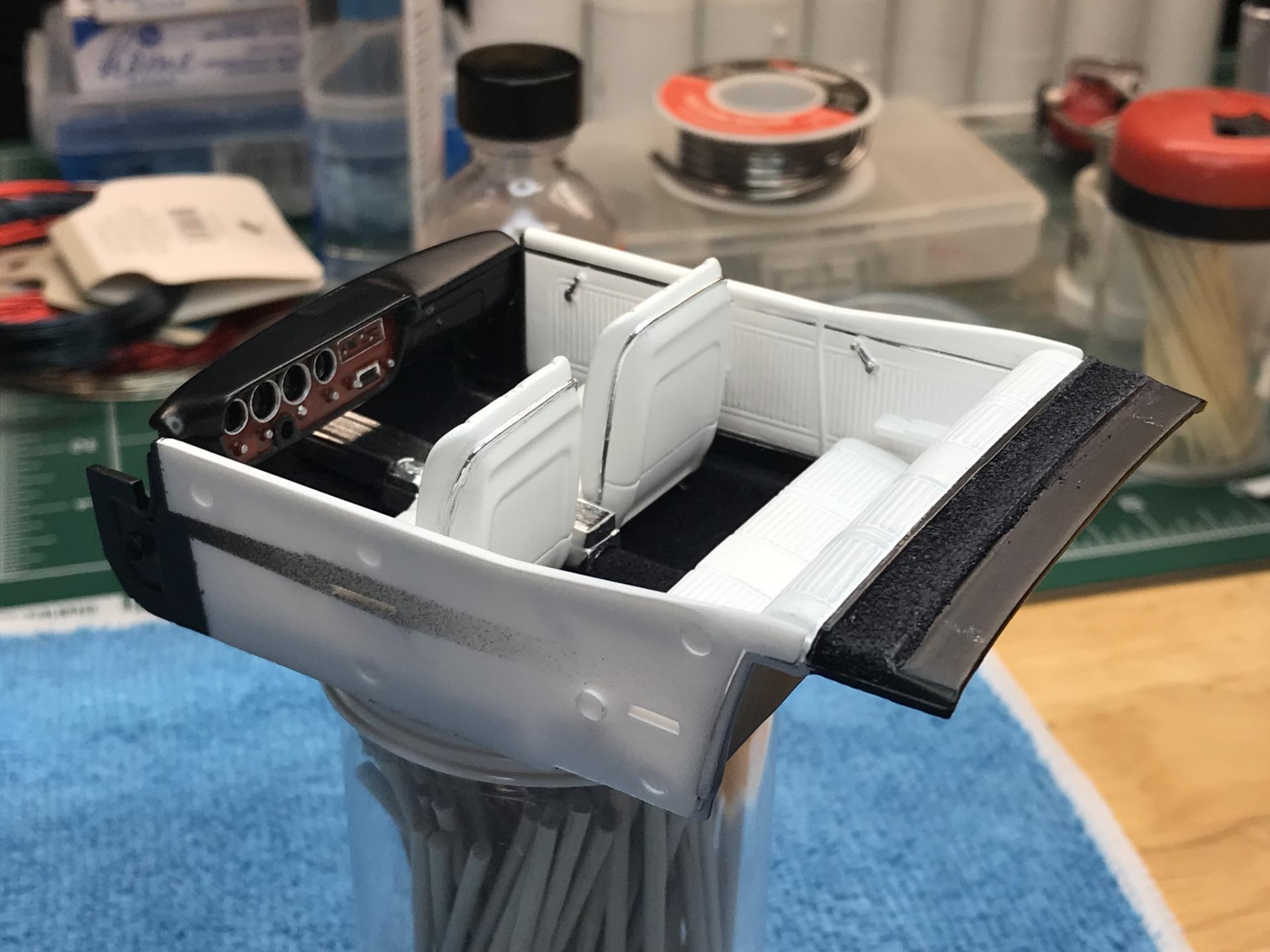

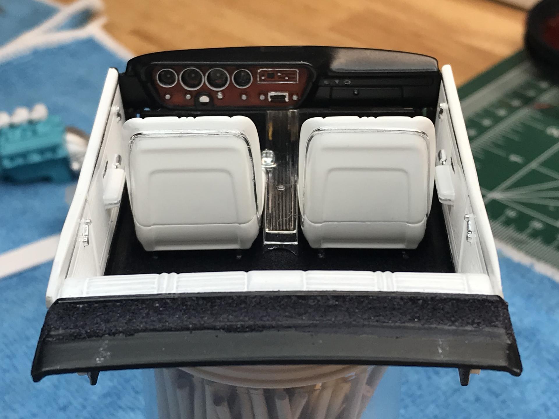

Metalmad Posted January 7, 2019 Author Posted January 7, 2019 A few more of the interior with the side panels glued in and the dash finished. Next I will be getting the steering wheel detailed and the column attached to the dash. I have also started on scratch building the rear suspension springs since the kit supplied springs just look awful.
Keesee17 Posted January 7, 2019 Posted January 7, 2019 That kit has a real nice interior... I’m still considering doing a convertible conversion to show it off...
Codi Posted January 7, 2019 Posted January 7, 2019 Great job Seth. Your work is quite spectacular. No one has asked so I thought I would. The backs of your white bucket seats show some beautiful "chrome" trim pieces. HOW did you do those? They're fantastic. cheers, tim
Metalmad Posted January 8, 2019 Author Posted January 8, 2019 (edited) Tim I actually sanded off the molded in seat back trim and then scribed where I had removed the molded in trim then I laid down and glued some round styrene to replicate the trim and then I laid down the chrome foil over the newly installed seat back trim. And Tim thank you for the kind comments it is greatly appreciated ! Edited January 9, 2019 by Metalmad

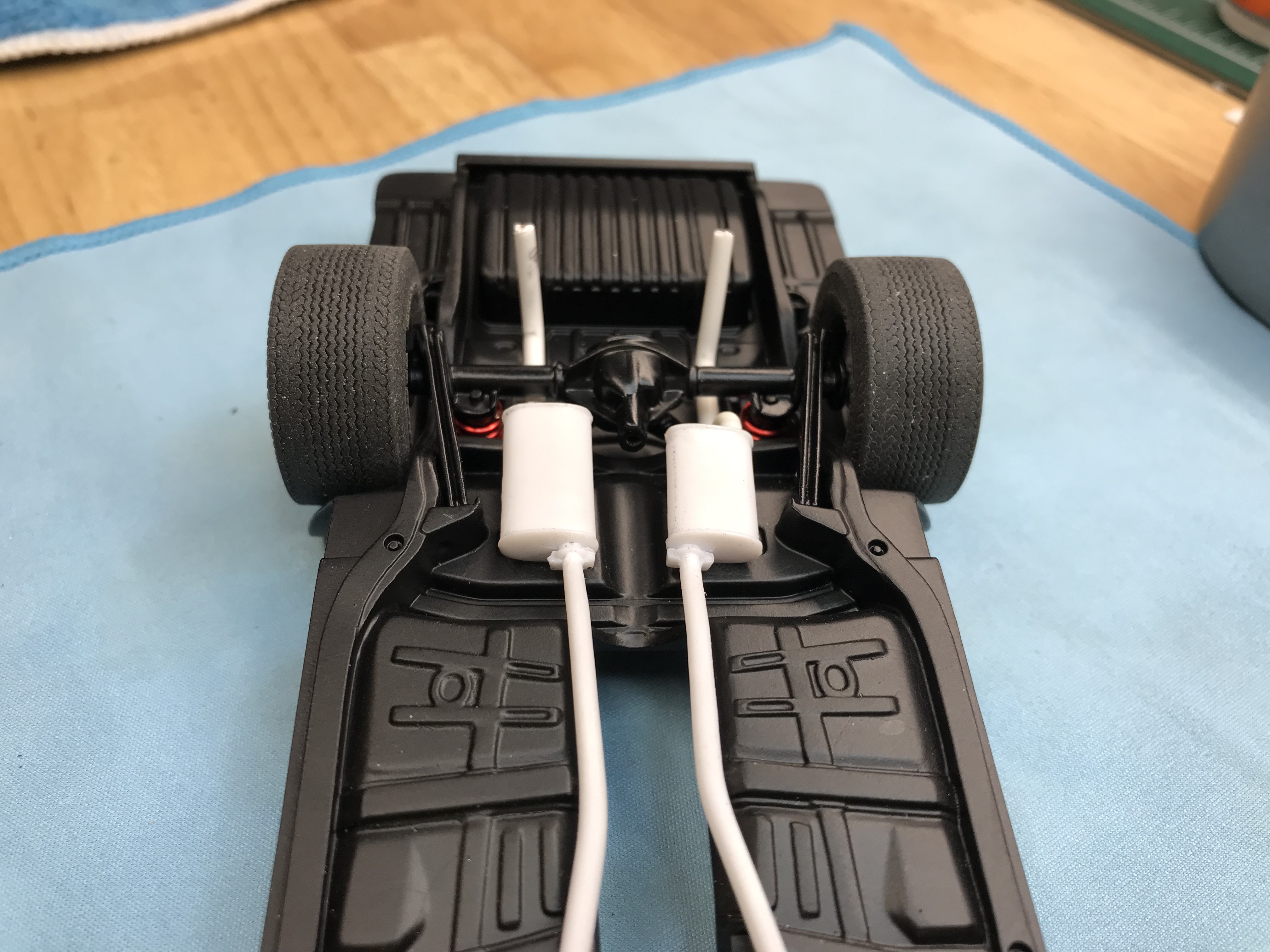

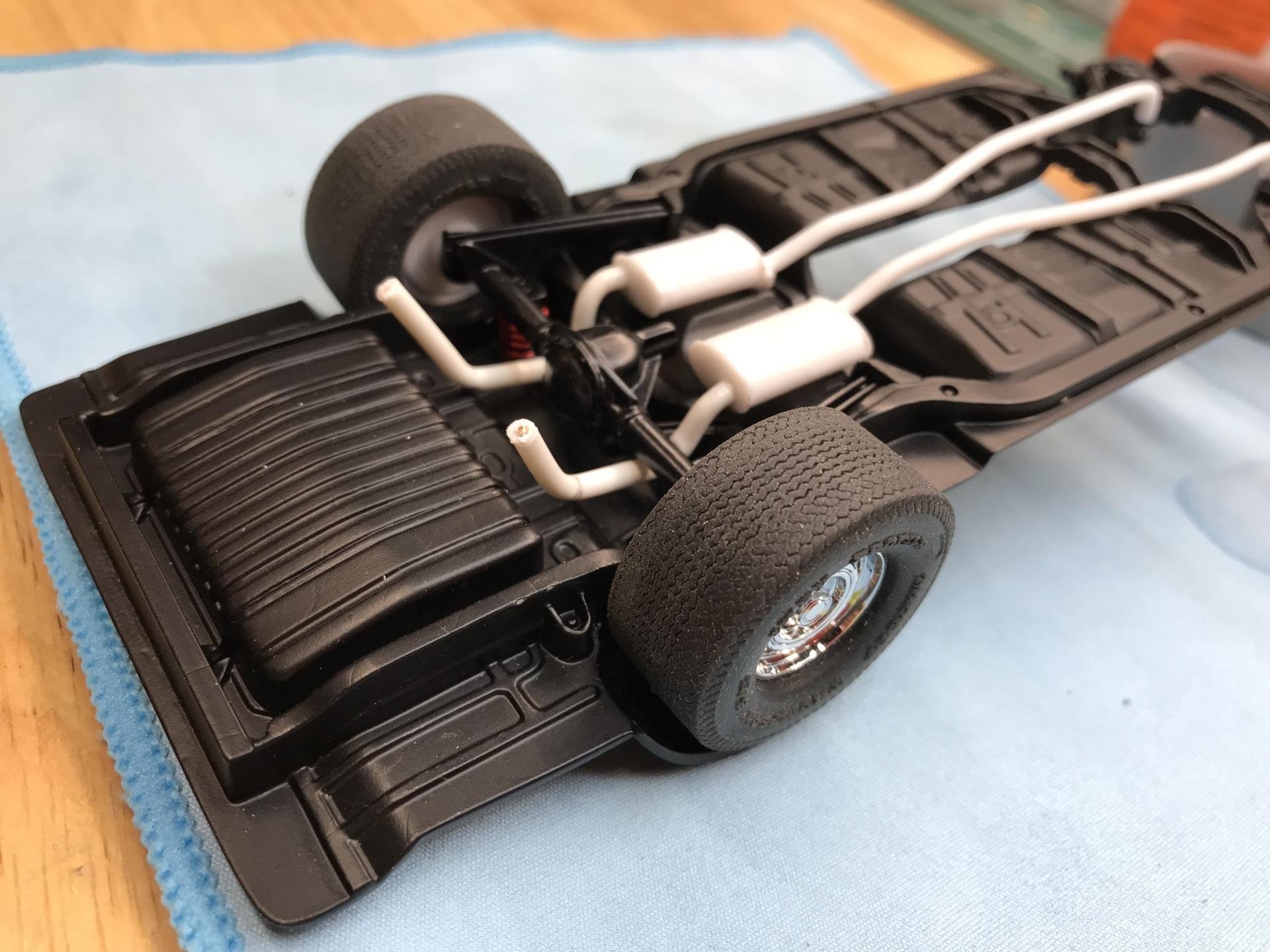

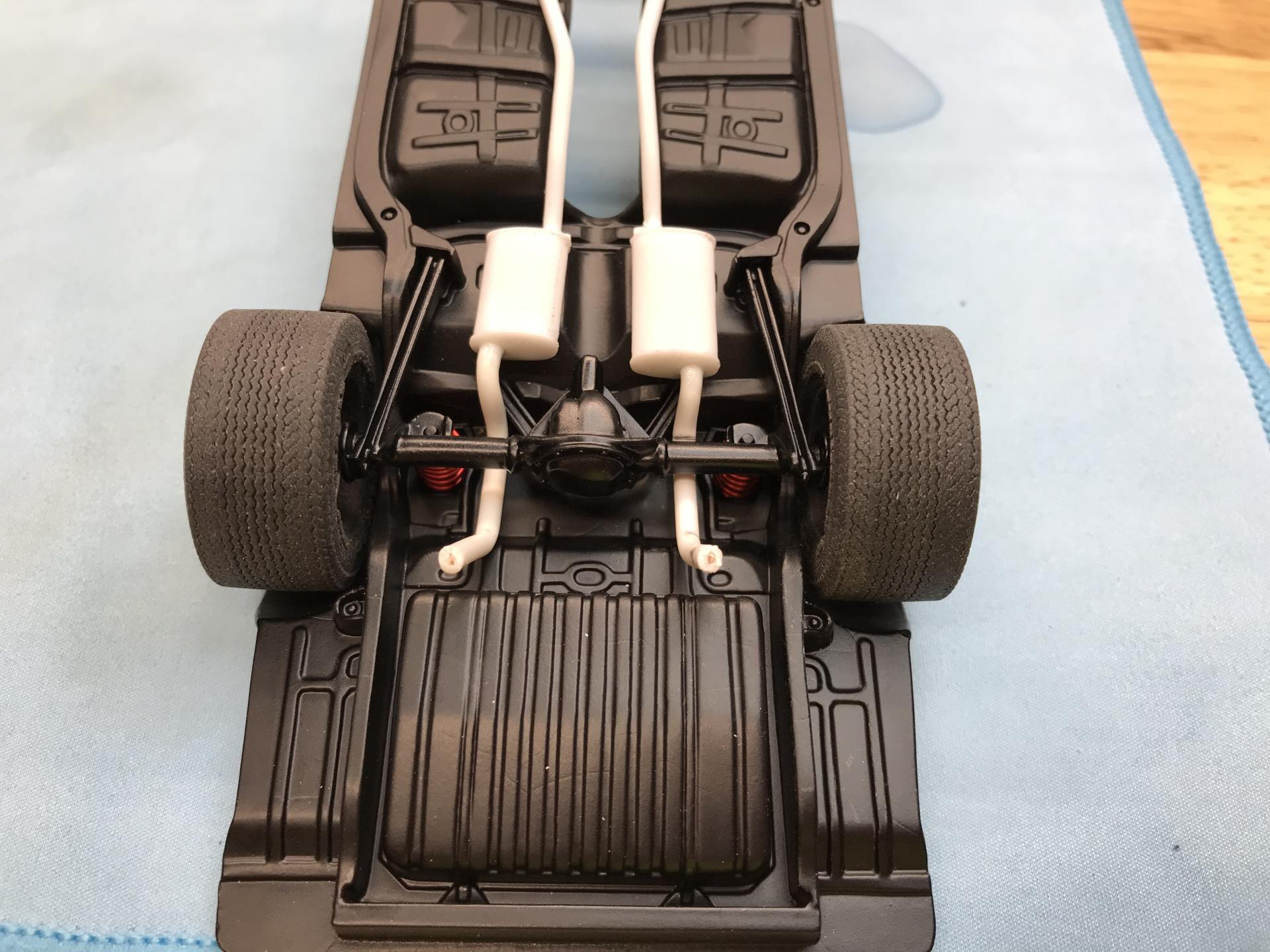

Metalmad Posted January 28, 2019 Author Posted January 28, 2019 (edited) I finally was able to get some bench time in recently so here is a small update. I really wasn't liking the way the exhaust was laid out past the mufflers so I removed the tail pipes and scratch built new ones which are now relocated but I still need to shorten them a bit then shoot the exhaust with some paint. I also have replaced the front and rear springs with red bead wire and now have the rear suspension components finished. Edited January 28, 2019 by Metalmad
beeRS Posted January 28, 2019 Posted January 28, 2019 Really nice build so far. I like the blue. As you said - it really suits the GTO. Interior detail is lovely on this kit.

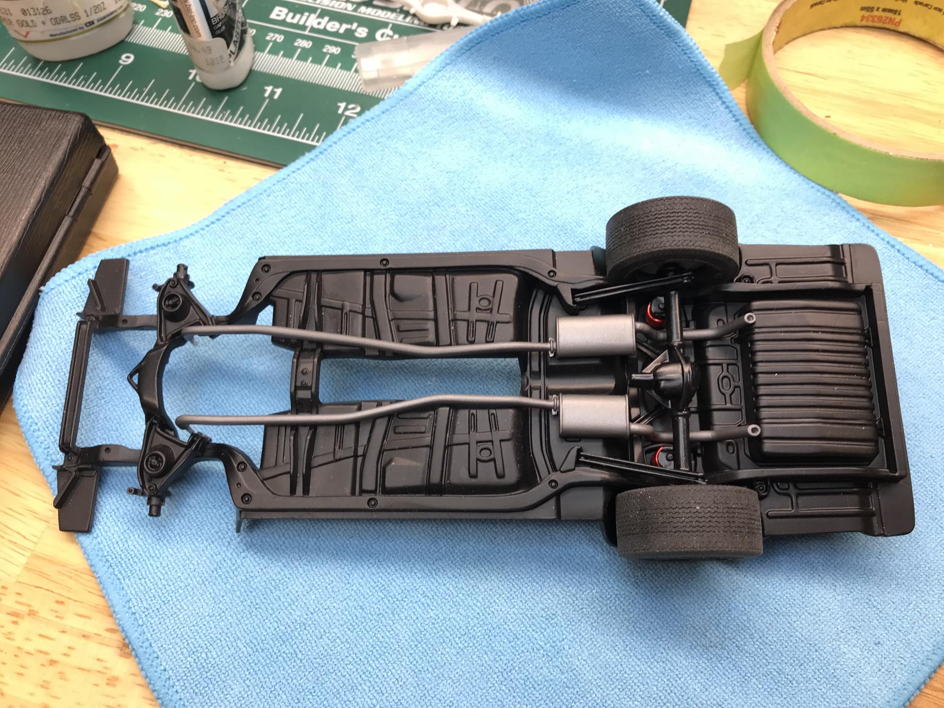

Metalmad Posted February 4, 2019 Author Posted February 4, 2019 I have finished up the exhaust system which is now painted except for the inside of the pipe tips. I have also started to scratch build the Ram Air system which will take a little time to engineer so I will be posting slowly on the progress of the Ram Air system.

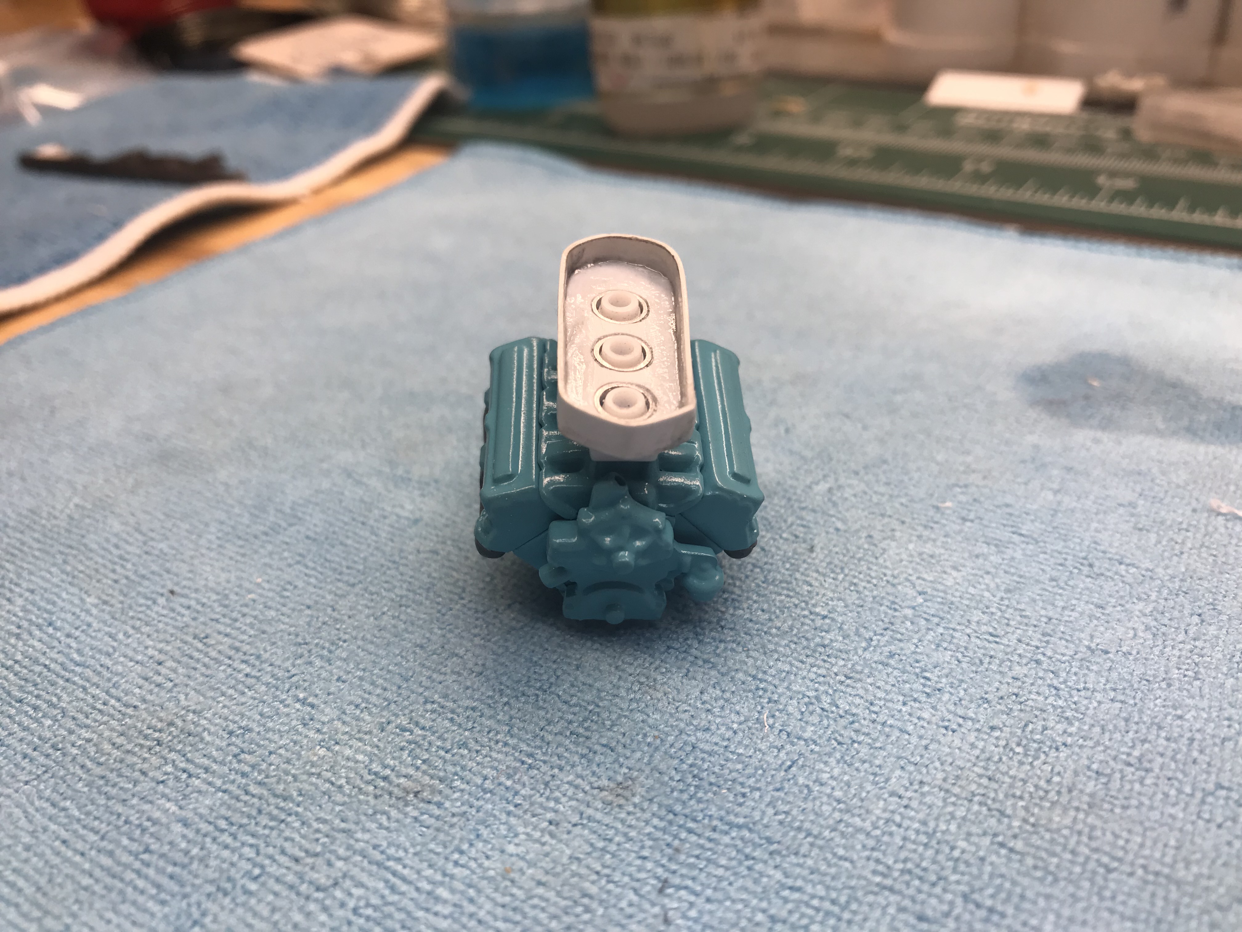

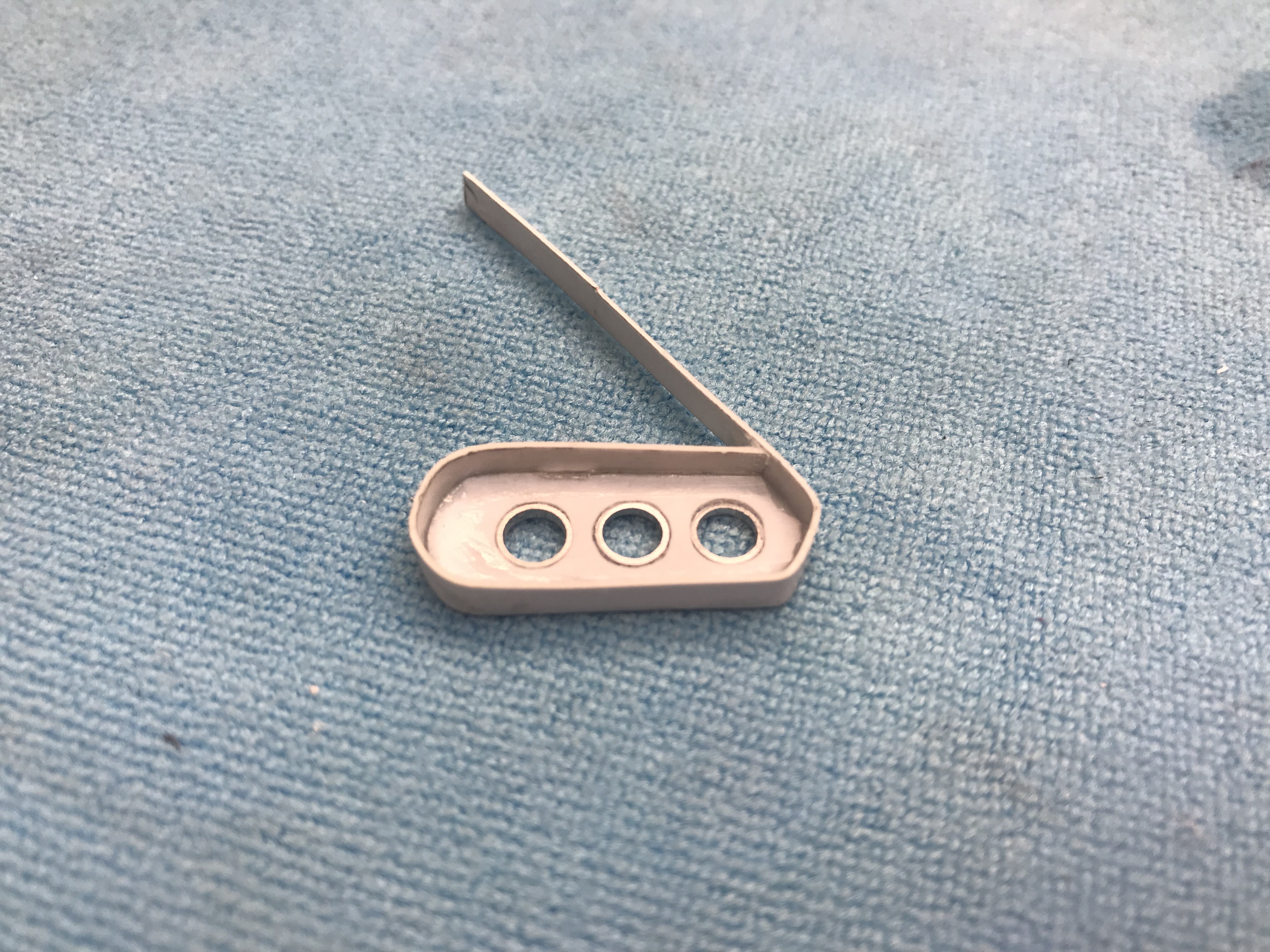

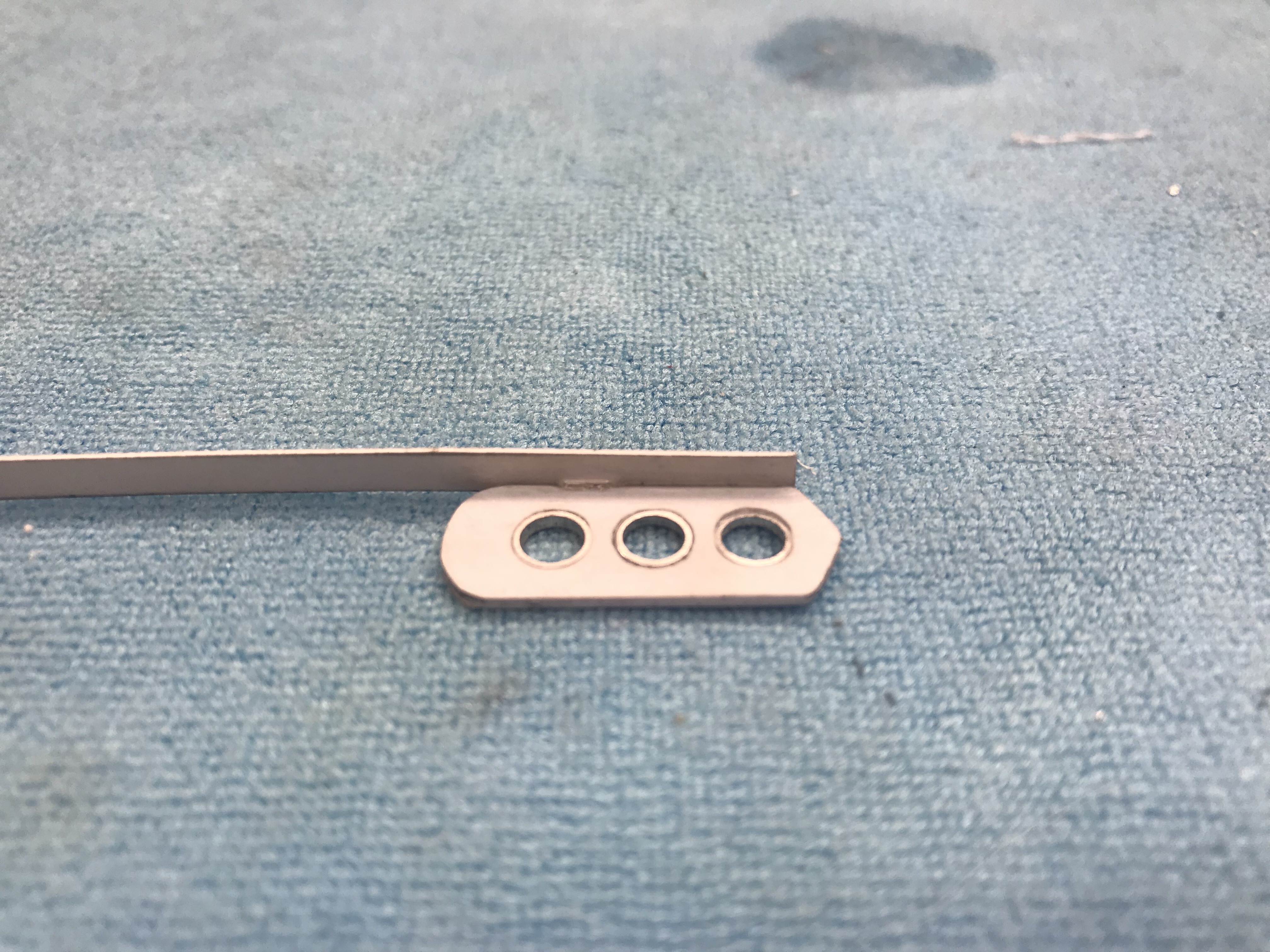

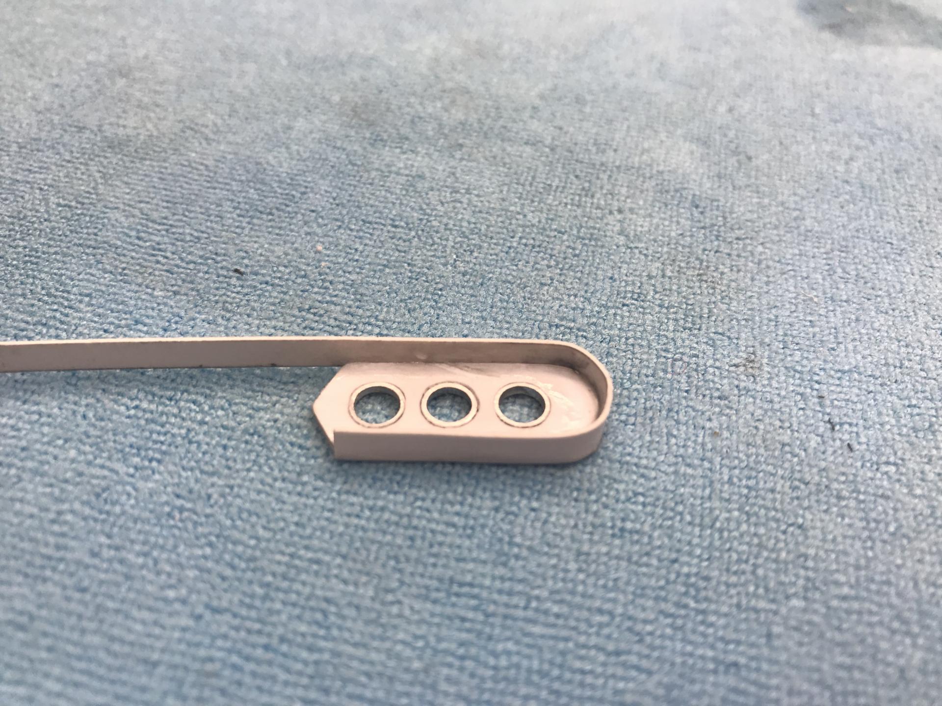

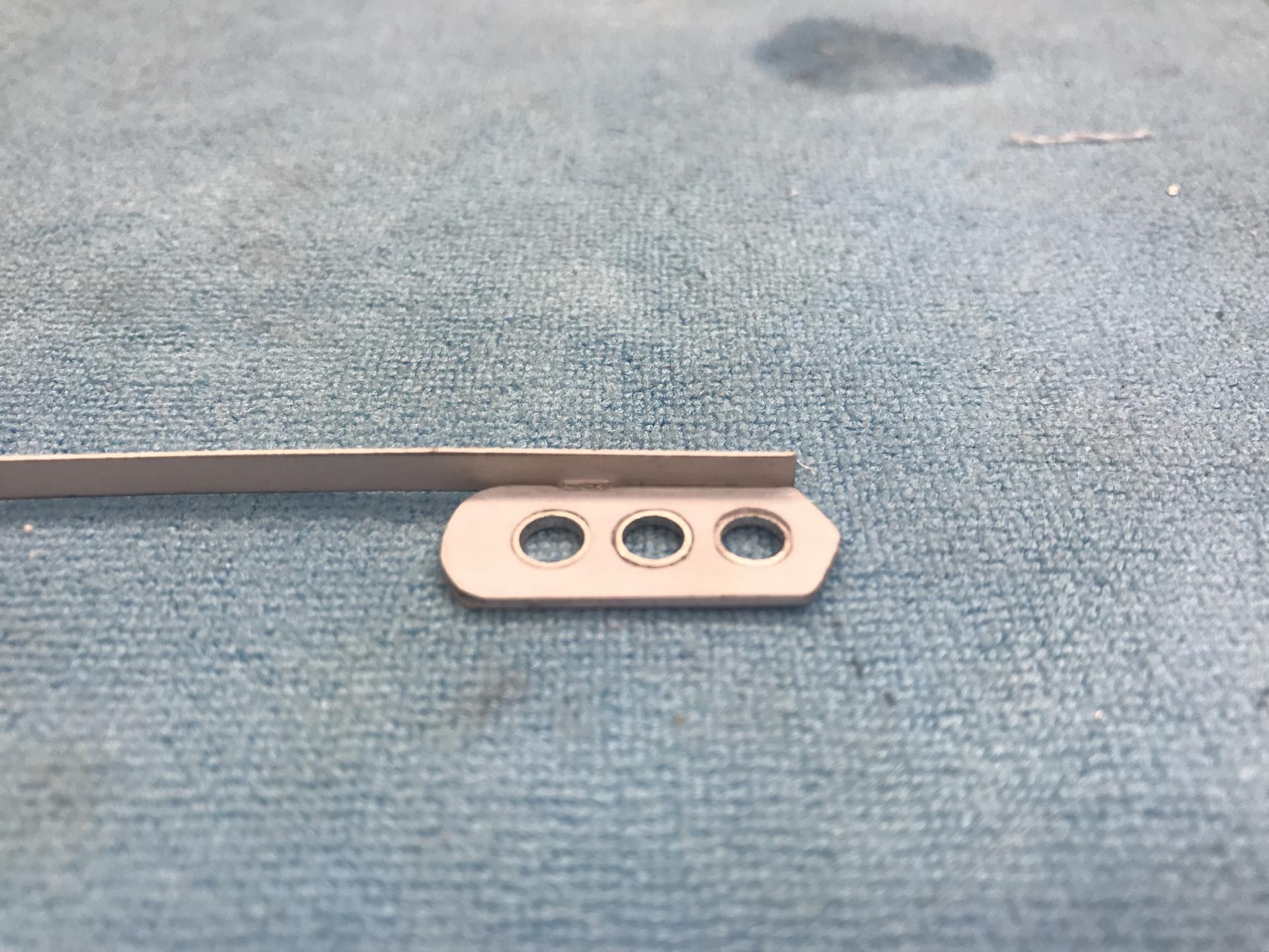

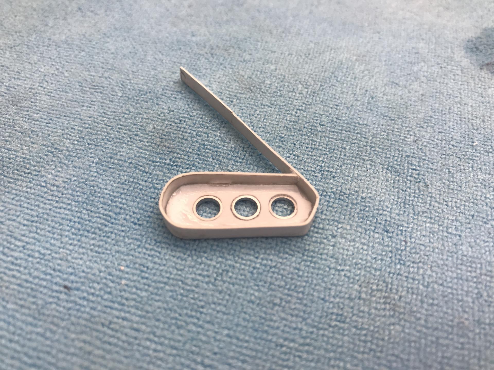

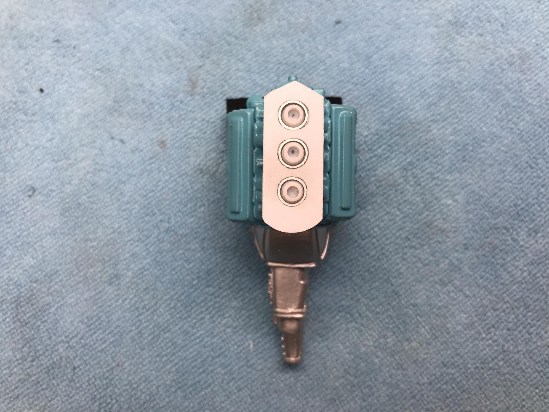

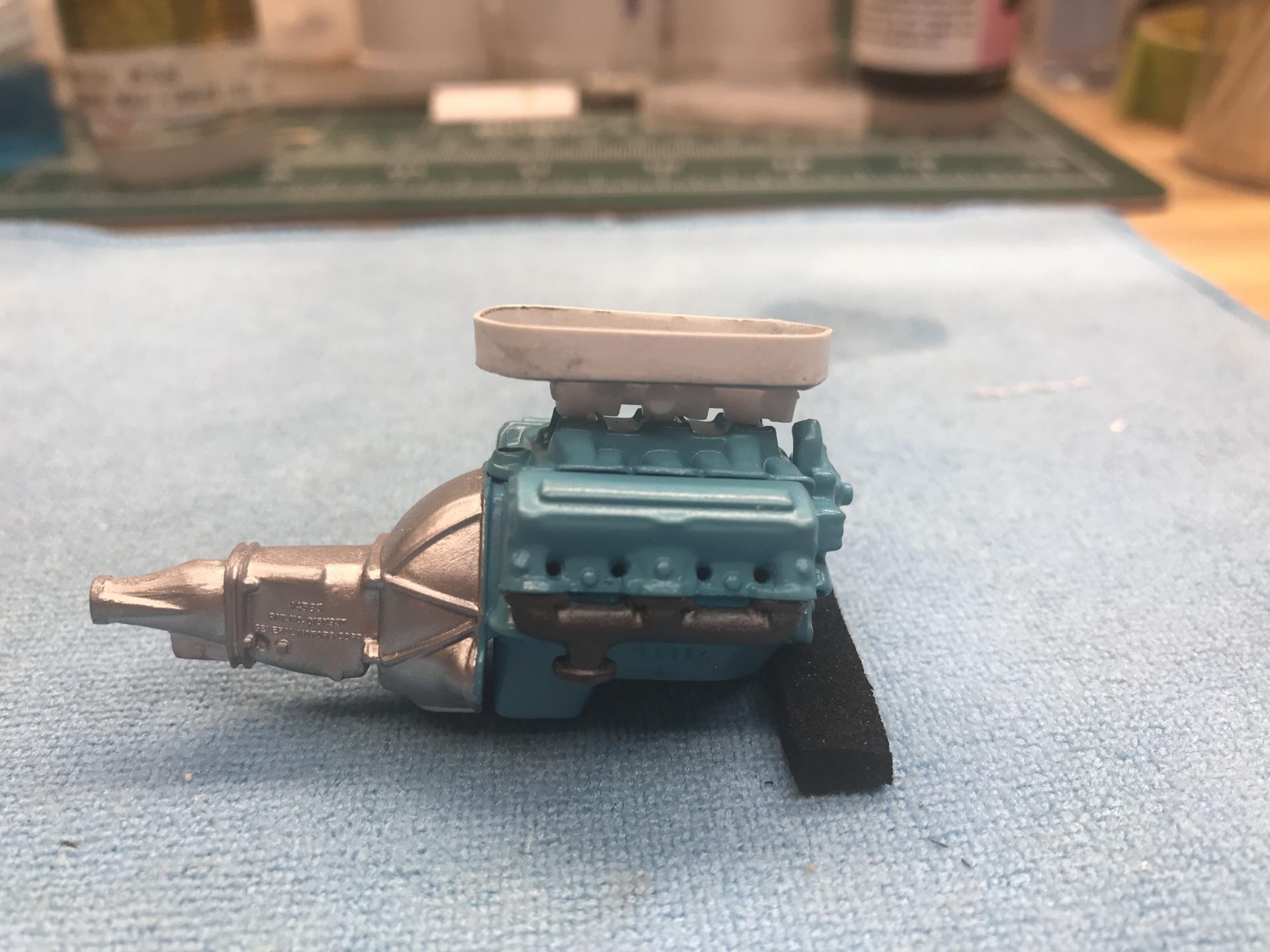

Metalmad Posted February 11, 2019 Author Posted February 11, 2019 Here is a small update on the Ram Air which I have the pan almost done. I have added aluminum rings on the bottom of the pan where it will sit on top of the carbs to give it some support and I have also added the wall around the perimeter so next will be the outer flange and then foam to seal the Ram Air on the under side of the hood.

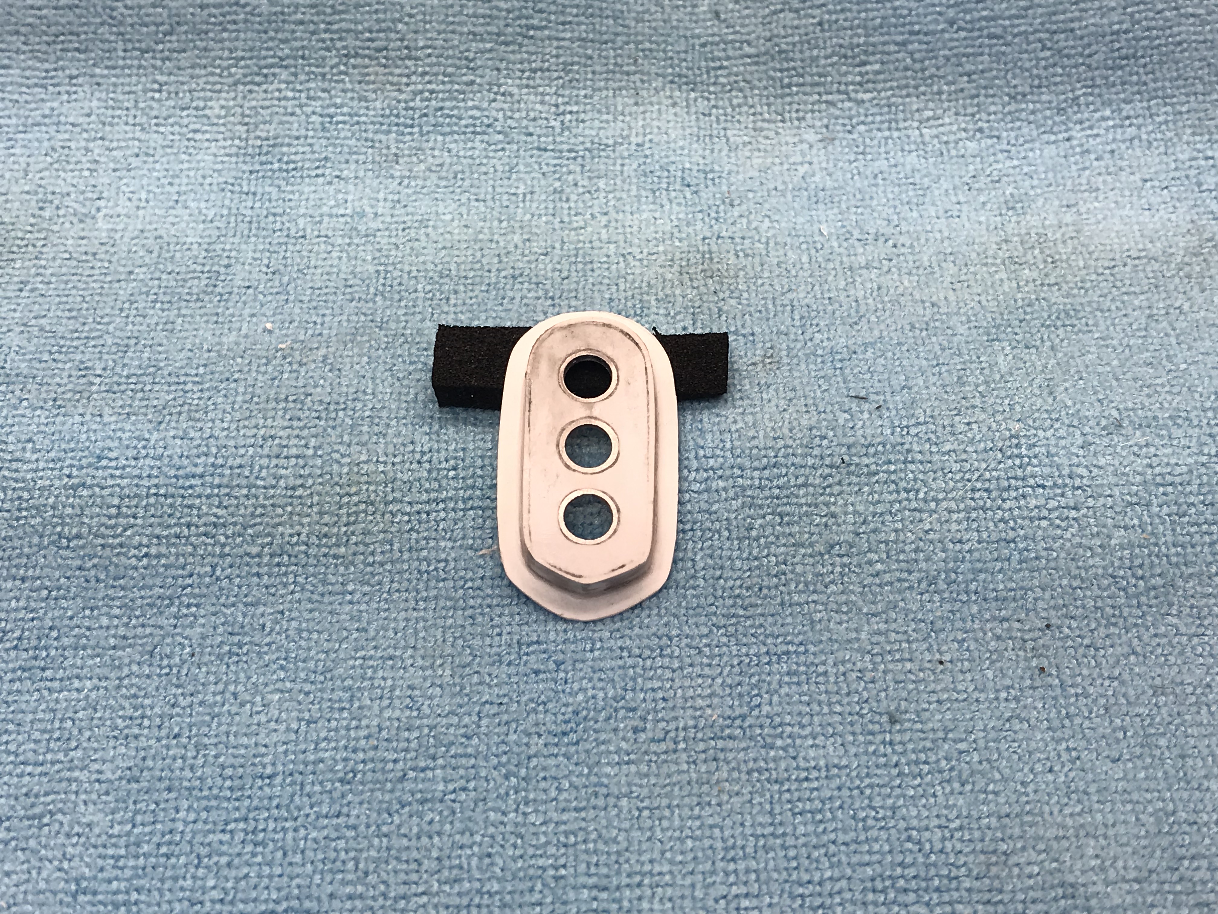

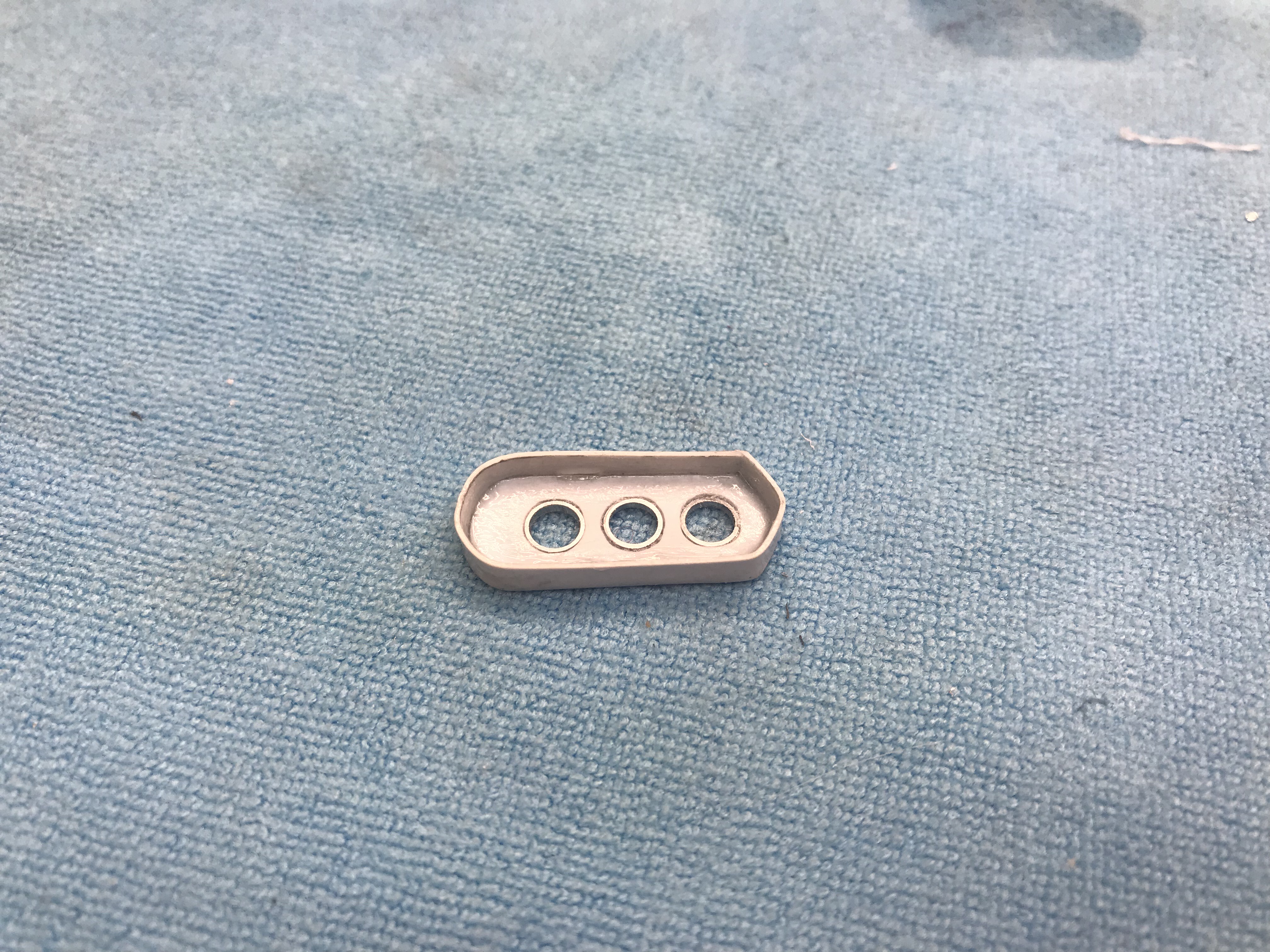

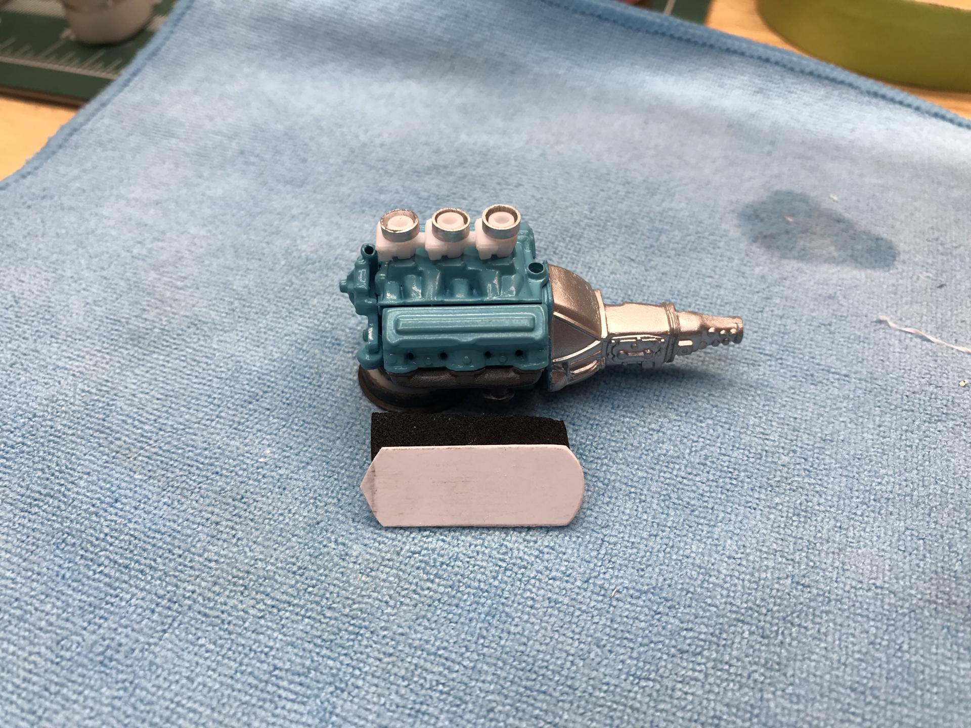

Metalmad Posted February 11, 2019 Author Posted February 11, 2019 Thank you Dann & JC ! and yes the rear tires came from Fireball and after looking at the pictures and examining the fitment on top of the carbs I noticed that the back of the belly pan was not to scale so I shorten the belly pan a bit. I will post pictures of the shorten pan later which now it looks much better.

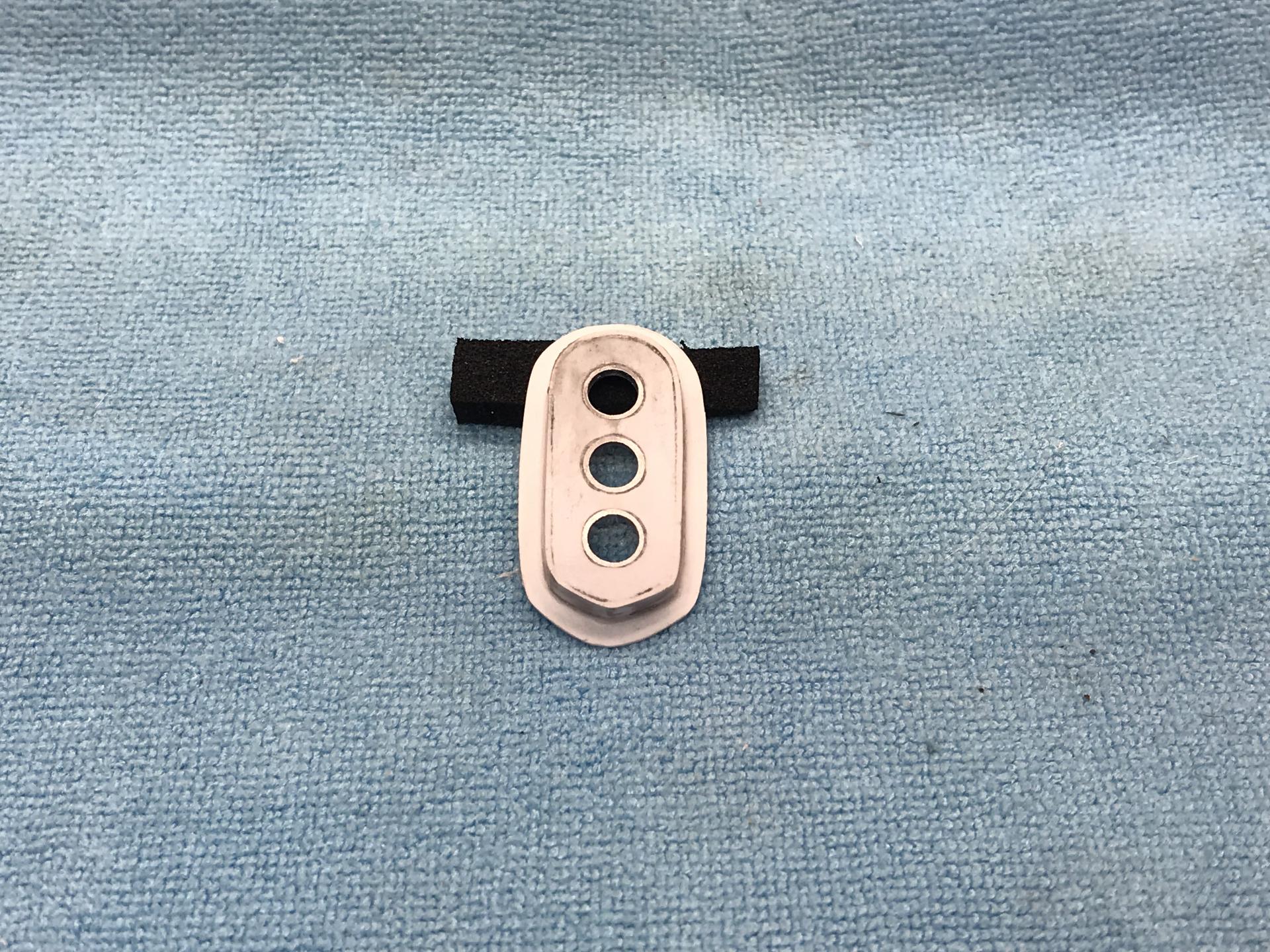

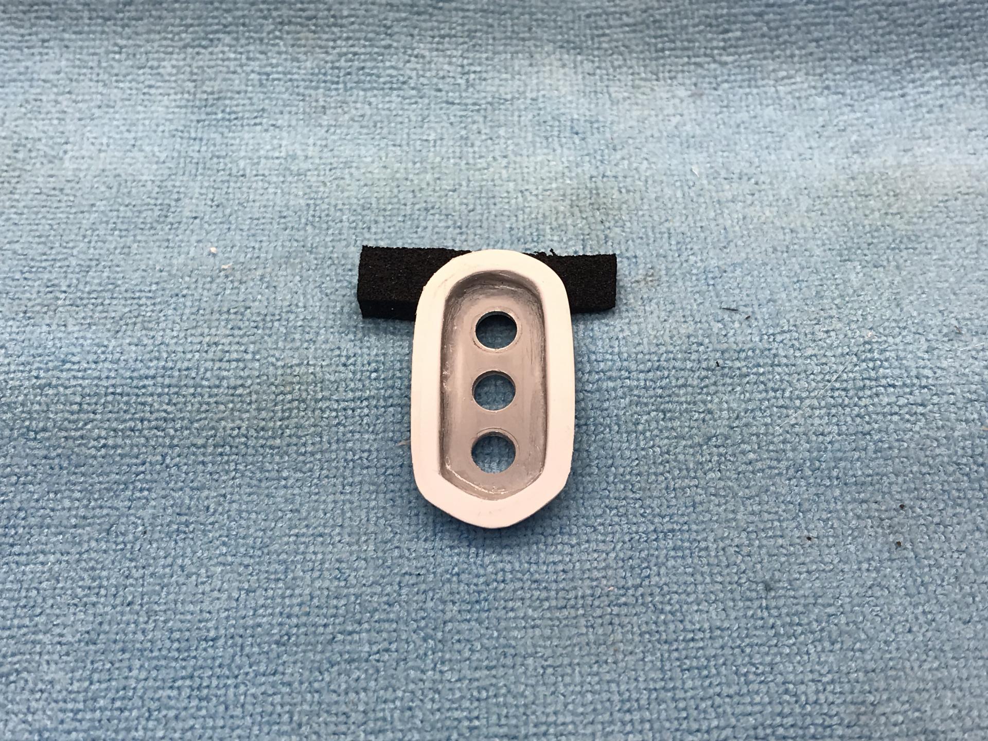

Metalmad Posted February 16, 2019 Author Posted February 16, 2019 (edited) A small update. I have finished up the ram air pan with the exception of getting it painted and the foam that will seal it to the bottom of the hood. Im planning to go to Michael's & Joanna's this weekend to see if I can find something to replicate the foam. Edited February 16, 2019 by Metalmad

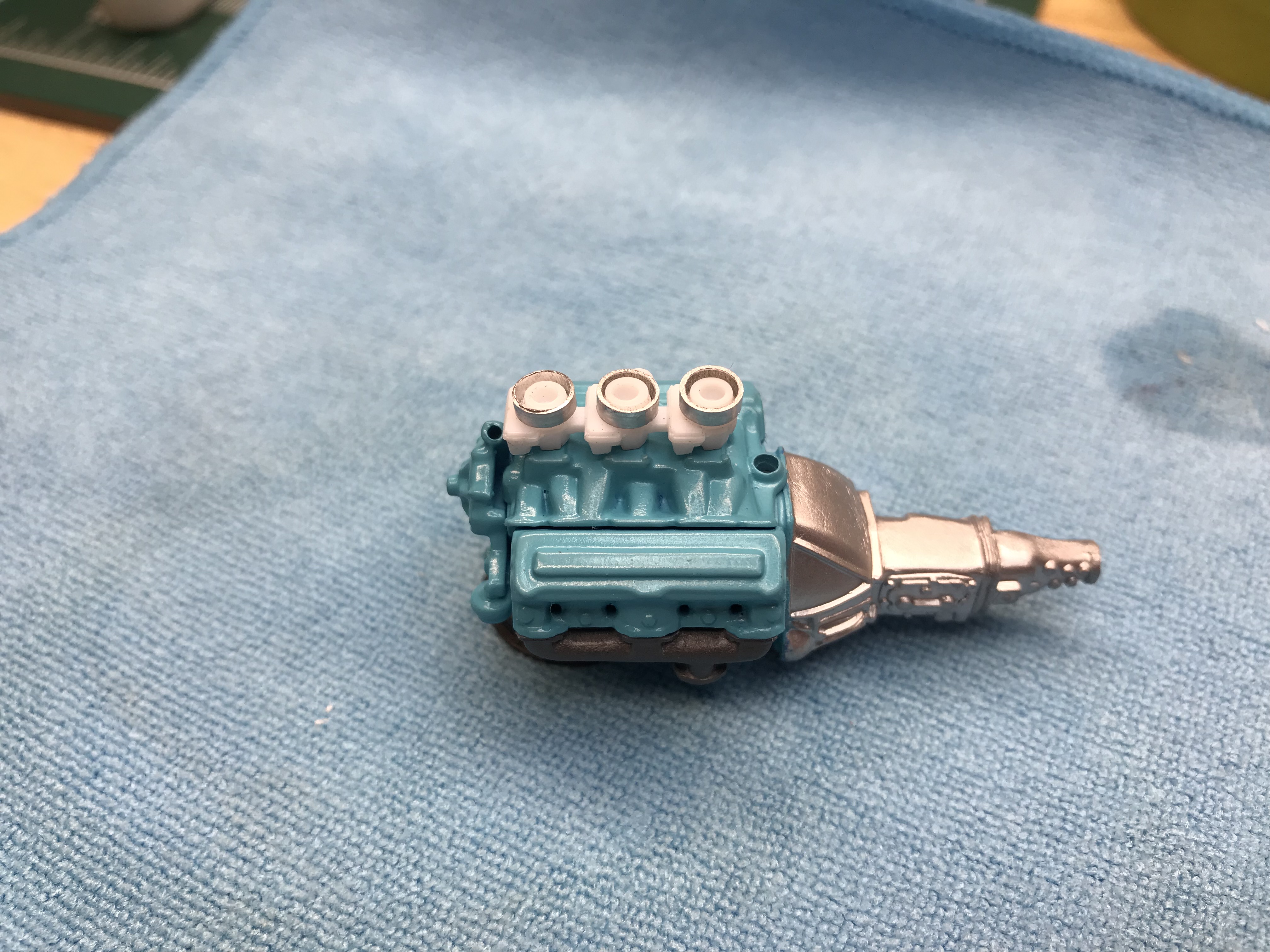

djflyer Posted February 16, 2019 Posted February 16, 2019 Not sure if you can still make use of these, but 3D Model Specialties has this set of 3x 2bbl carbs available on Shapeways. They look pretty good and you get 5 sets for $11.00
Metalmad Posted February 16, 2019 Author Posted February 16, 2019 Thank you David & I'll look into these to see if they will work for me.
Deuces Posted February 17, 2019 Posted February 17, 2019 I was wondering if the intake from the AMT '62 Catalina SD 421 fit the Revell GTO long block.... I'm just thinking out loud here... Nice build by the way!!!... ☺️
espo Posted February 17, 2019 Posted February 17, 2019 13 hours ago, Deuces said: I was wondering if the intake from the AMT '62 Catalina SD 421 fit the Revell GTO long block.... I'm just thinking out loud here... Nice build by the way!!!... ☺️ I have used the early 3x2 set up from the AMT '64 GTO kit on the '62 Cataline engine and they fit perfectly. I know that's different but I think with very little finessing the 2x4 set up should work.
