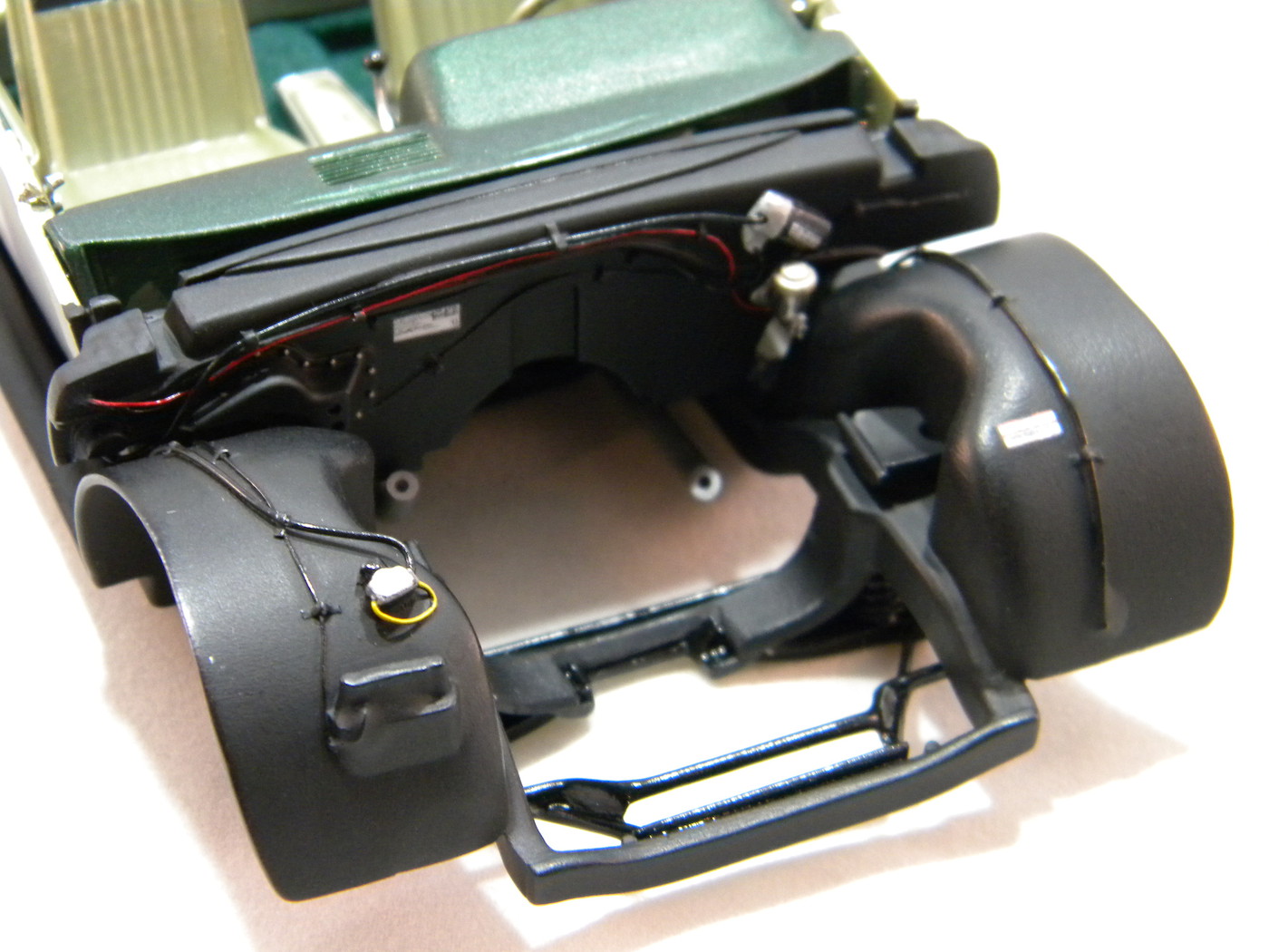

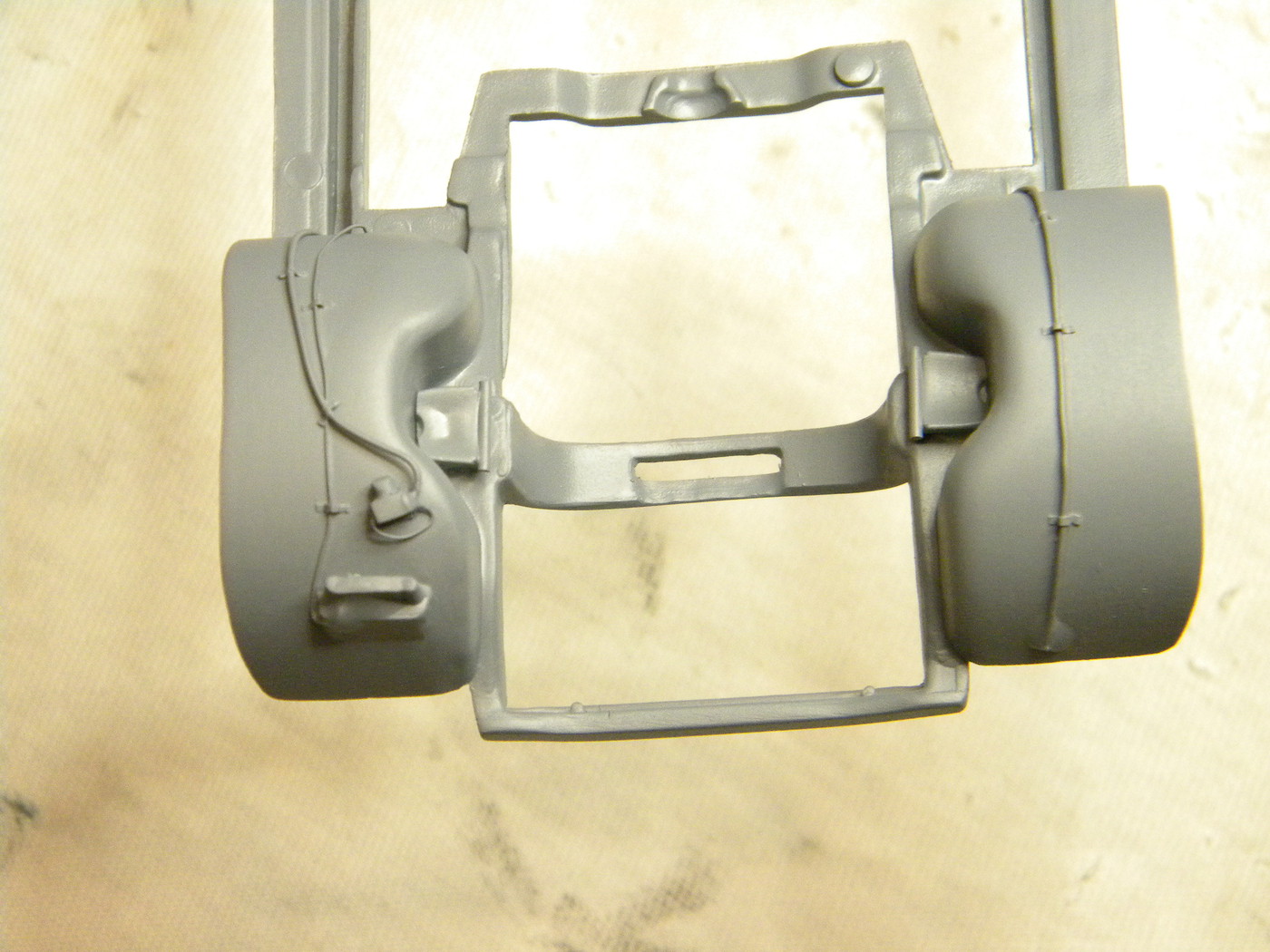

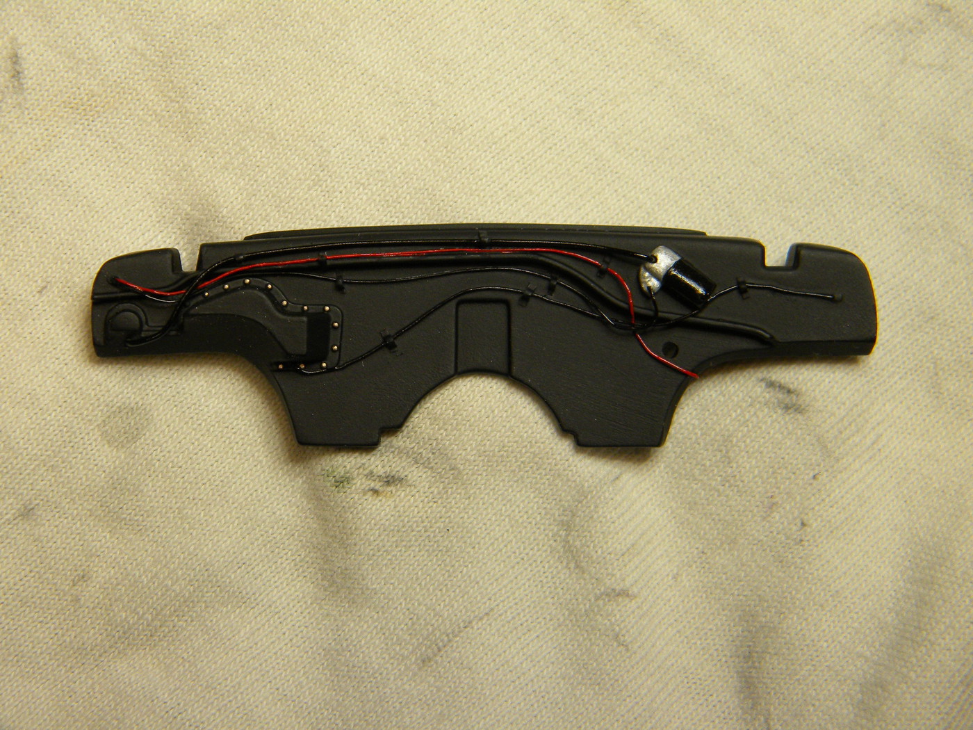

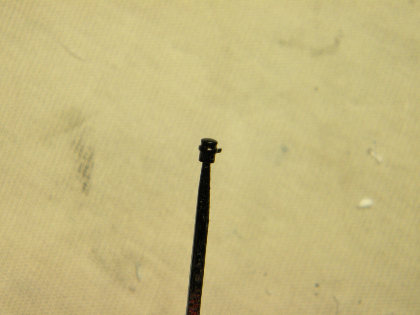

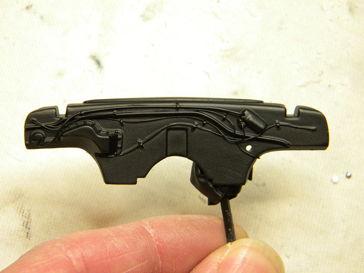

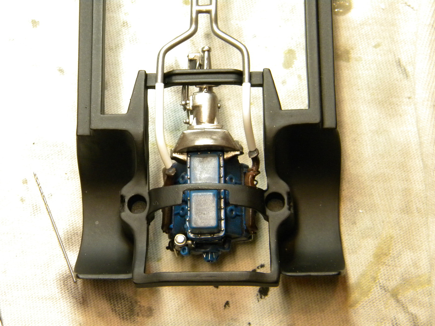

StevenGuthmiller Posted January 31, 2019 Author Posted January 31, 2019 2 hours ago, Mike Chernecki said: Good job on the wiring, what did you use for the hold downs. Thin strips of aluminum cut from a soda can and bent to shape. Steve
Mike Chernecki Posted January 31, 2019 Posted January 31, 2019 19 minutes ago, StevenGuthmiller said: Thin strips of aluminum cut from a soda can and bent to shape. Steve Thanks Steve, they look great, not over-sized and bulky.

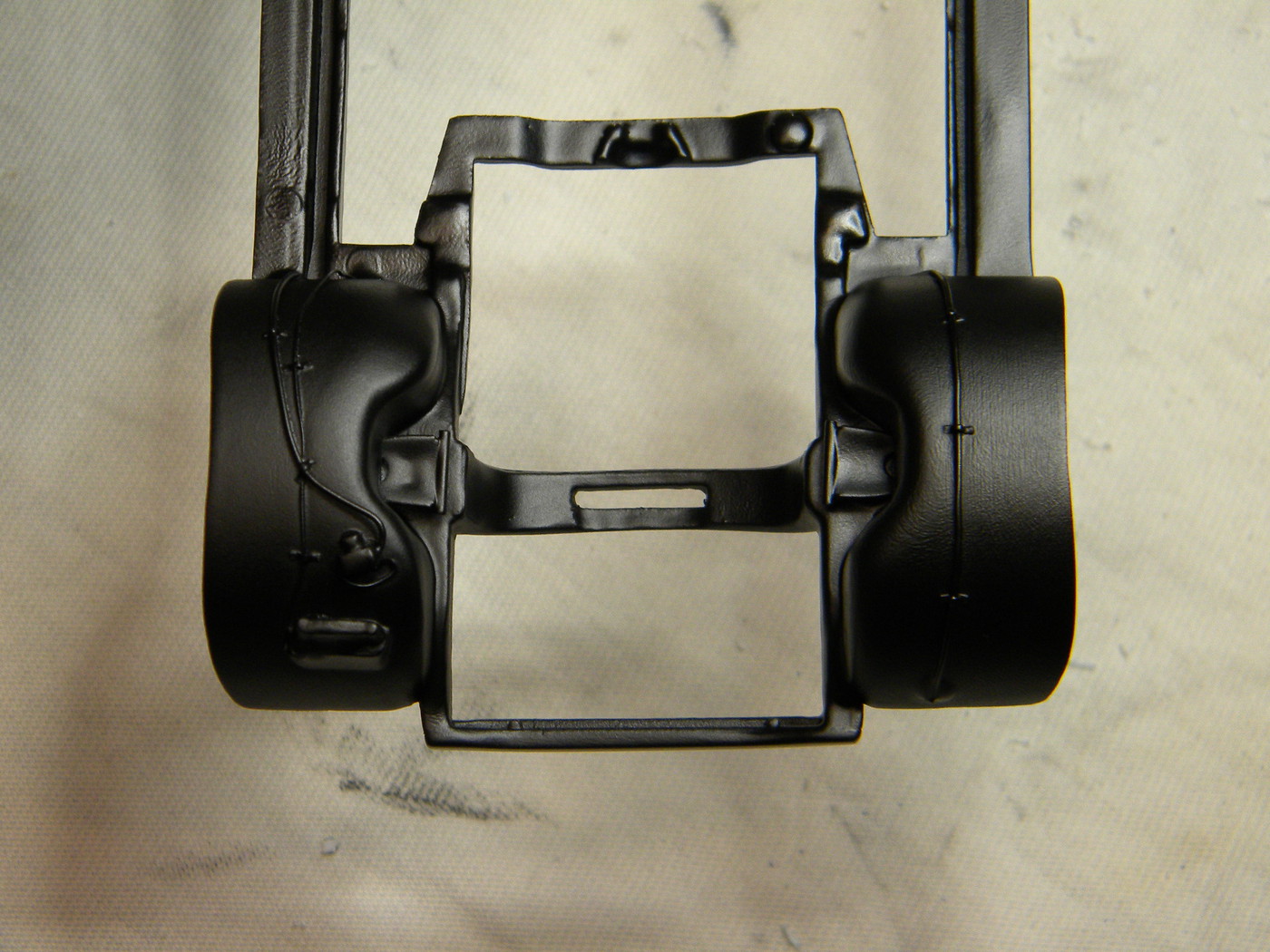

Brutalform Posted January 31, 2019 Posted January 31, 2019 Talk about detail... I see that this kit needed some extra attention paid to the underhoid area. Looks fantastic. Nice idea using the aluminum soda can for clamps.
StevenGuthmiller Posted January 31, 2019 Author Posted January 31, 2019 Looks fairly acceptable with a little primer. Steve

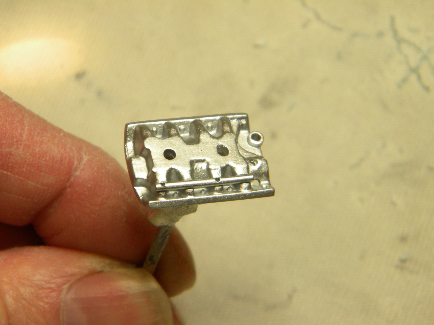

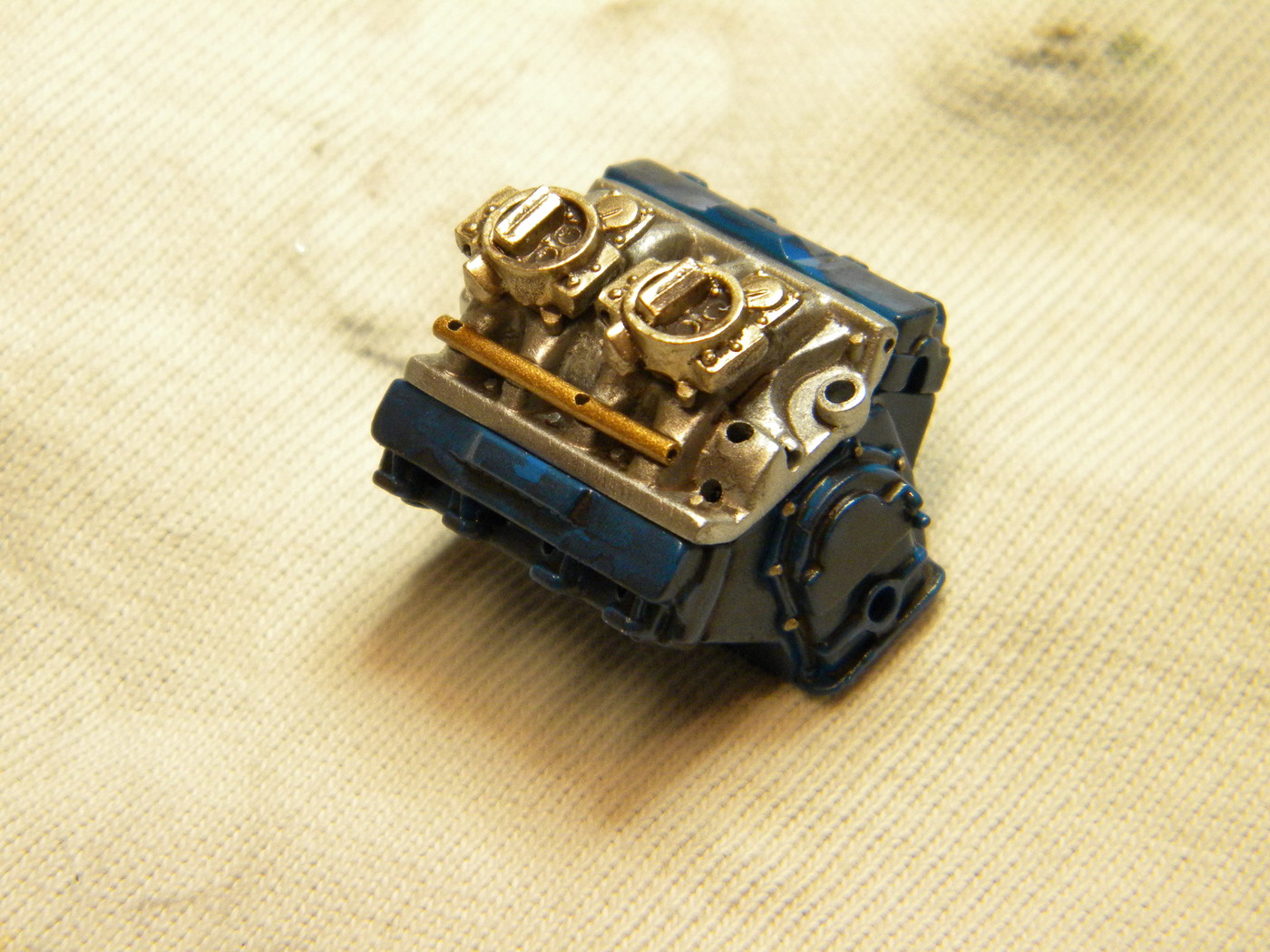

StevenGuthmiller Posted February 1, 2019 Author Posted February 1, 2019 Still chuggin' along. Got all of the engine parts and a few chassis parts painted. Testors "Ford Engine Blue", flat and gloss black, and several different shades of Alclad. Still have some "refining" to do with some of the chassis parts before painting, but I'm really very happy with how quickly this project is moving along. It's surprising how much bench time a guy can get when he gets a break from home remodeling! I'm sure that won't last, so I need to keep the pedal to the metal! I have a pretty good mix of parts that I've assembled for this engine. The majority of the engine comes from the AMT 1967 Cyclone kit. The Intake manifold is from the '67 Galaxie kit, valve covers from a '68 Mustang, and air cleaner from a '63 Galaxie. I scratch built a few parts including a fuel filter and radiator brace. I also added a "fuel bar" for the dual quads to the intake, and removed the ugly oil filler caps from the valve covers to be replaced. Steve

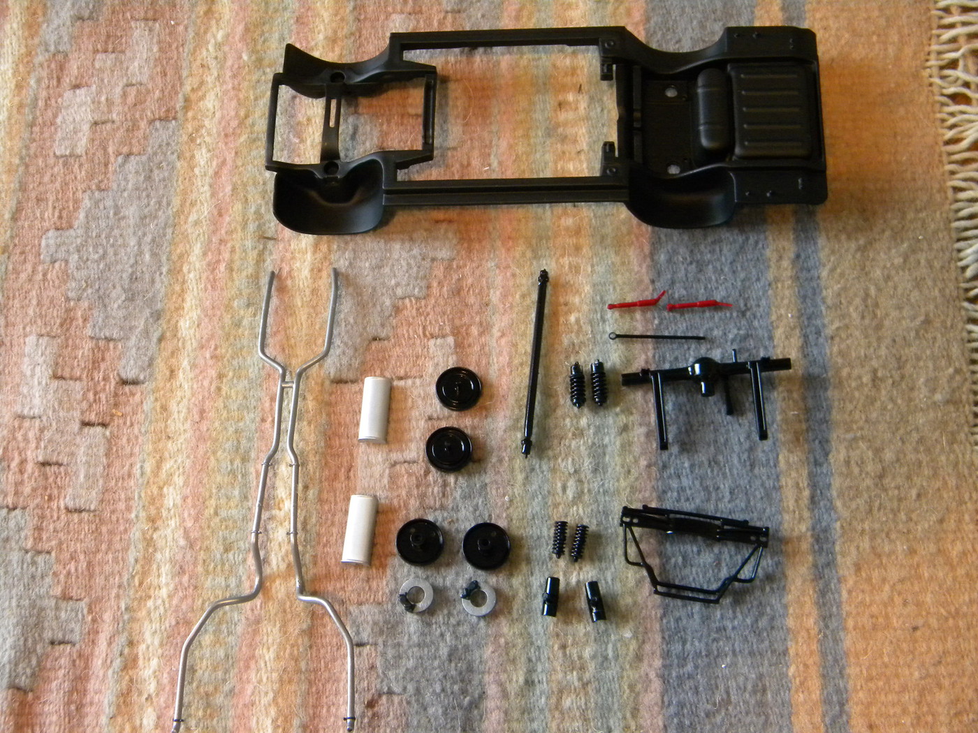

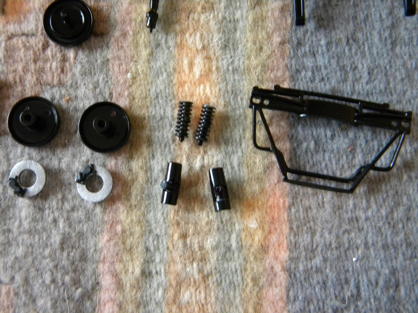

StevenGuthmiller Posted February 16, 2019 Author Posted February 16, 2019 I have to admit, lack of firewall and fender well detail aside, AMT did a fair job of chassis detail for a 50+ year old kit! There are separate front and rear springs, shocks and even a control rod for the suspension parts. The front wheel backs include separate disc brake detail, and the exhaust includes separate mufflers. Something even most modern kits don't have! The kit even includes glass pack mufflers as an option! I scratch built my own front spindles. Not necessarily aesthetically pleasing, but neither were the original kit pieces. While they will not be tied together with a functioning tie rod, they will allow the front wheels to be poseable. Steve

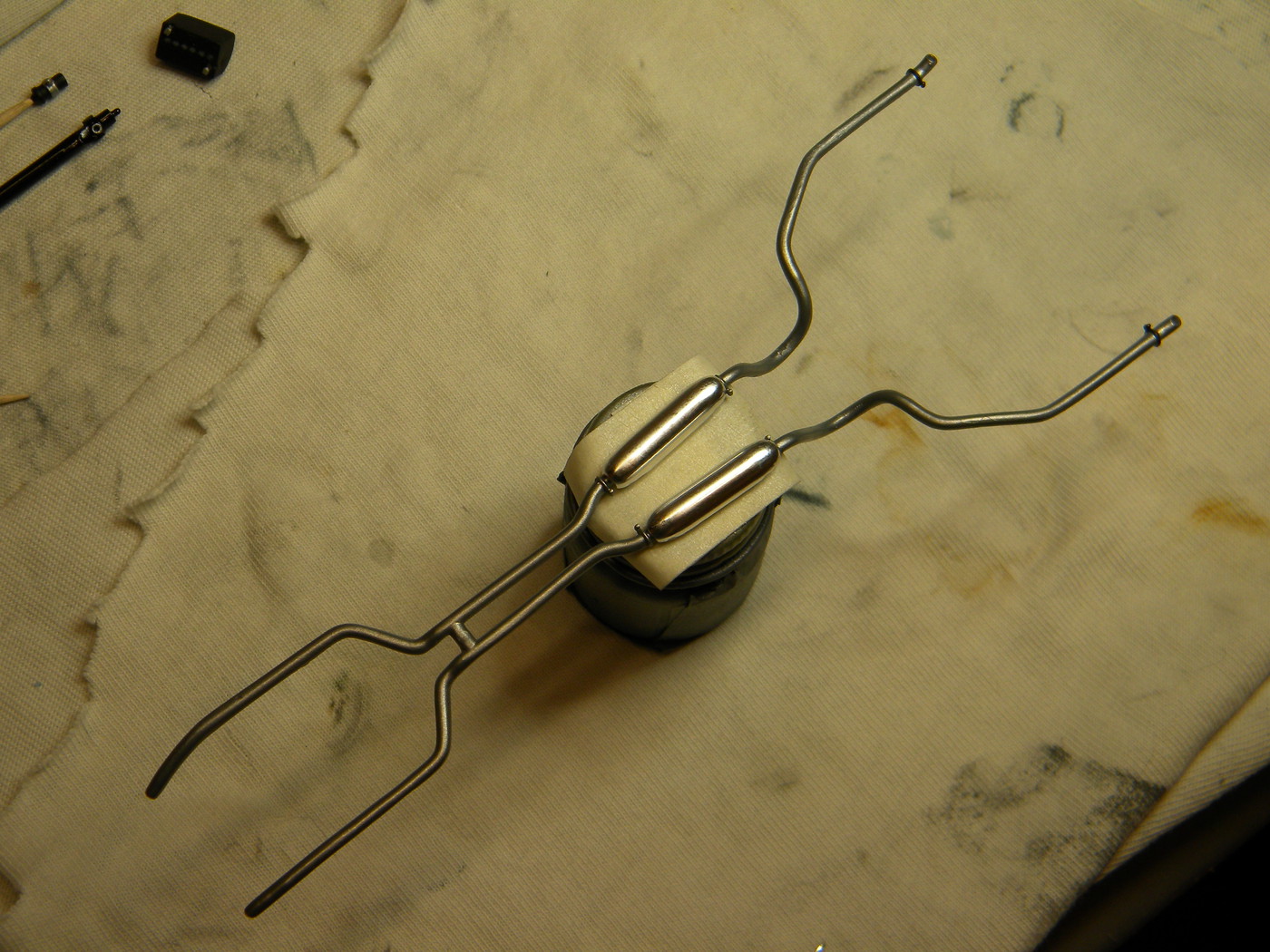

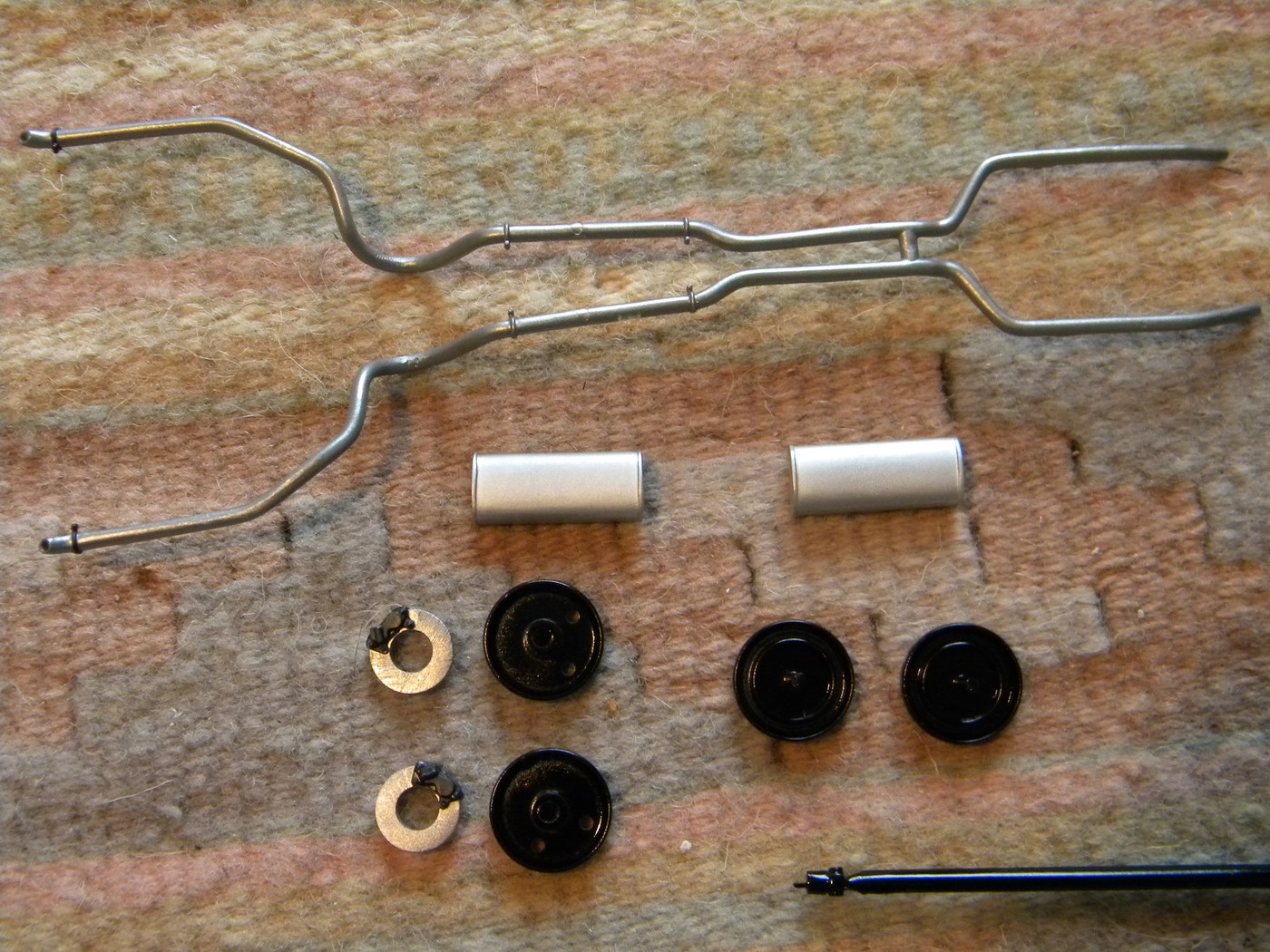

StevenGuthmiller Posted February 17, 2019 Author Posted February 17, 2019 As I stated before, this kit came with a set of optional glass pack mufflers. What do you guys think? Should I use them? I would probably strip the chrome and paint them, but I kind of like the look. Steve

Brutalform Posted February 17, 2019 Posted February 17, 2019 28 minutes ago, StevenGuthmiller said: This was another obvious harbinger of things to come with the AMT Cyclone kit. The kit contained 2 carbs, even though it only included a single 4bbl intake. Must have been looking ahead to the 427 Fairlane already when the Cyclone kit came out. Steve I especially like the distributors. I have a few that I carefully cut the caps off, and add a MAD wired cap, then drill the advance for the vacuum hose. I have a few of those carbs in my bins. It doesn’t take much to make them look realistic. What did you use for that gold fuel rail? Is that brass/ aluminum tubing?
StevenGuthmiller Posted February 17, 2019 Author Posted February 17, 2019 4 minutes ago, Brutalform said: What did you use for that gold fuel rail? Is that brass/ aluminum tubing? Nope, just plastic tubing painted with Testors gold. Steve
espo Posted February 17, 2019 Posted February 17, 2019 I would use the Glass Pack Mufflers. This was often the first addition a new owner would have done back when. Your detail painting on the firewall looks great. you must have a steady hand. I also like how you used a light wash on the engine giving it much more depth and realism.

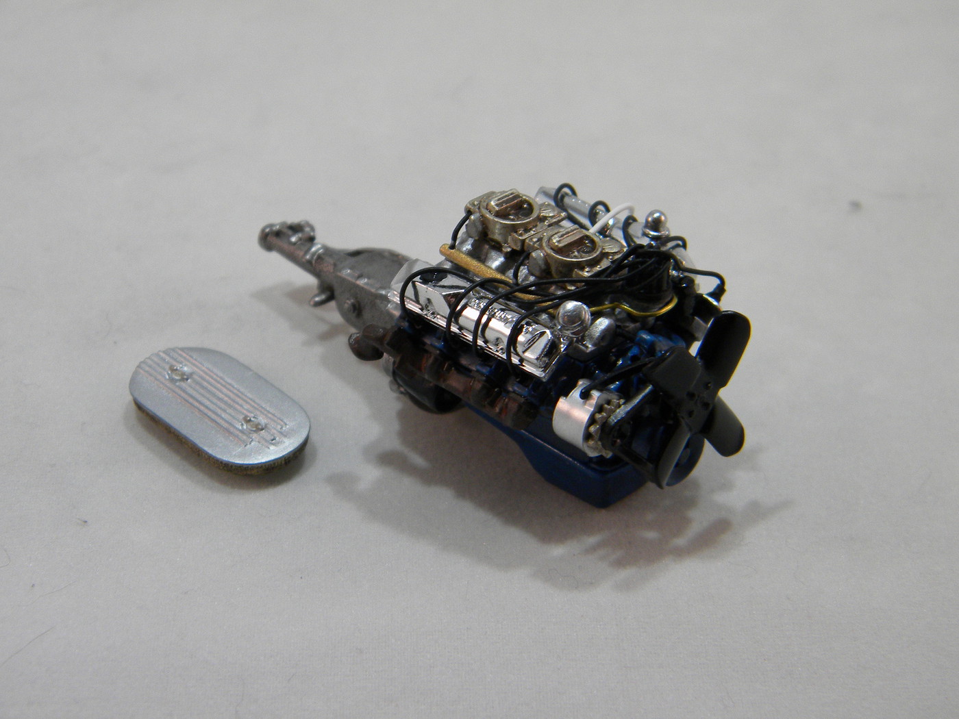

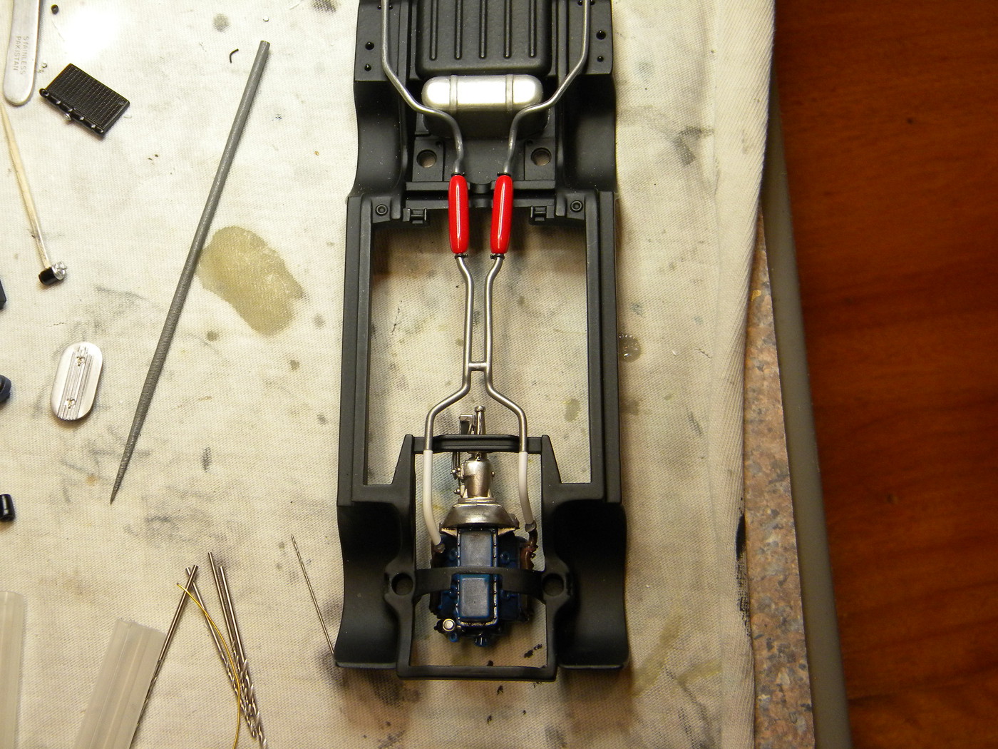

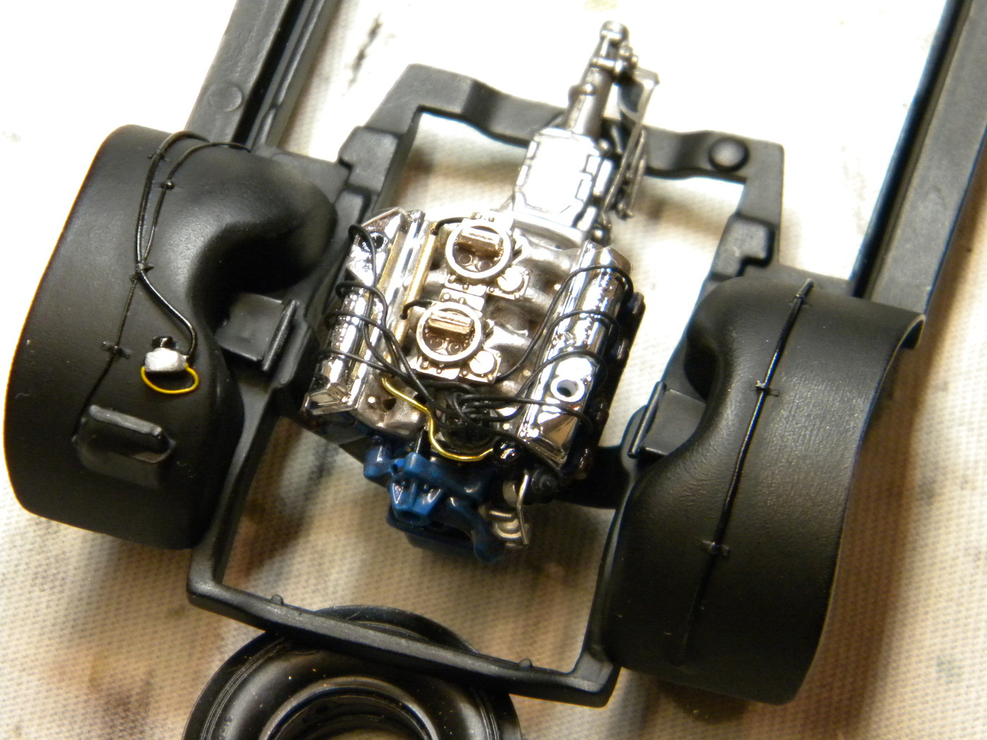

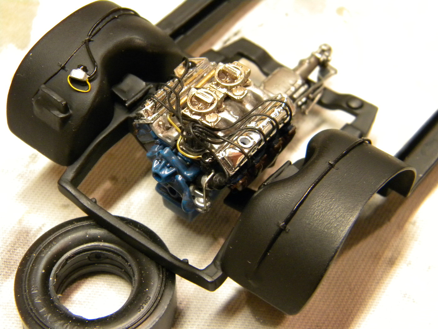

StevenGuthmiller Posted February 20, 2019 Author Posted February 20, 2019 Things have slowed down a little due to a couple of issues that have arisen. First, the oil pan is shaped a little differently on this engine versus the original kit piece, so some trimming was required on the frame cross member to get the engine to sit in the position where it needed to be. Likewise, the air cleaner sat too low to allow room for the distributor and plug wires, so I needed to fashion some spacers to raise it up a bit. The combination of lowering the engine slightly and raising the air cleaner a touch has left me with very little hood clearance, but it appears at this point that it will be just enough. I knew that there would likely be some exhaust issues, and I was correct. The exhaust manifolds came nowhere near to meeting up with the pipes, So I removed the forward section of the original exhaust and fashioned new header pipes. Otherwise, most of the engine is assembled and looking pretty good. Still need to add the pulleys, alternator and fan, as well as a few other parts such as the starter, oil filter and a few odds and ends on the top of the engine. Next problem could possibly be the length of the drive shaft due to the fact that the original kit tranny is a little longer. But that will be a relatively easy fix when I get to that point. Steve
Brutalform Posted February 20, 2019 Posted February 20, 2019 Very nice work, Steve. The engine looks fantastic. That solenoid looks really good too. Nice job on all the details you added to this kit. Pretty cool idea with the glass packs. Some guy wanted a throaty sound from his Galaxie, so he threw them on. Exhaust systems, especially the headers, and manifolds can be a pain. I keep black coffee stirrers on hand in case I need to make a quick driveshaft, or change the length. Looks like it’s all figured out.

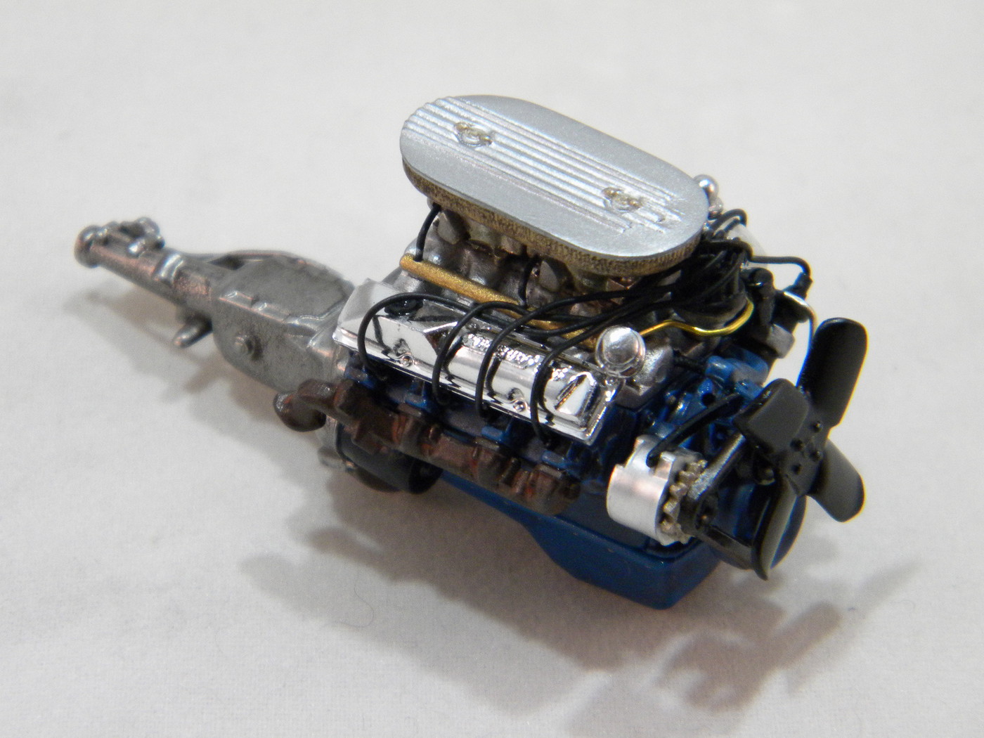

StevenGuthmiller Posted February 24, 2019 Author Posted February 24, 2019 The engine is finished! I also mounted the firewall to the interior bucket and finished assembling the chassis. After a few adjustments ad touch-ups, I should be able to mate the engine to the chassis. Steve
