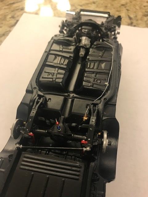

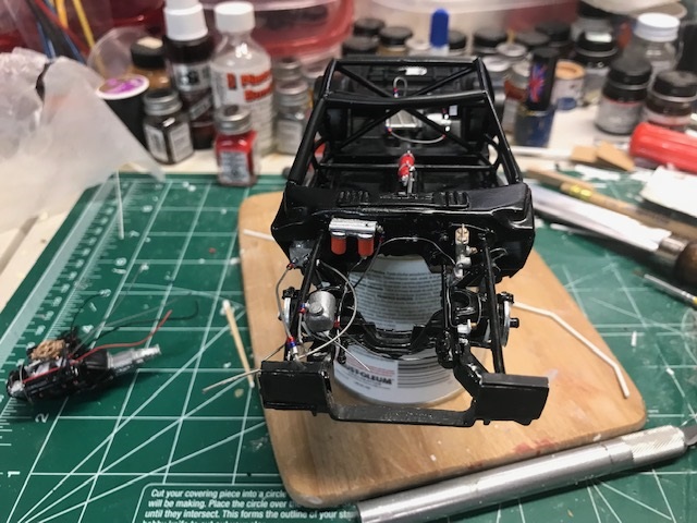

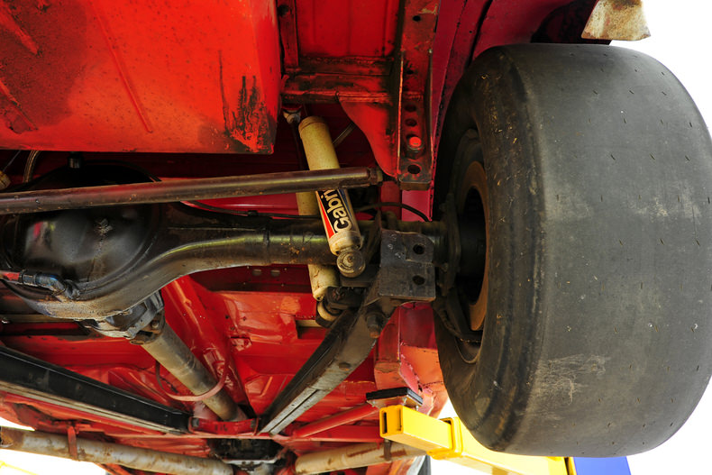

yellowsportwagon Posted March 19, 2019 Posted March 19, 2019 You need a panhard bar or watts link to locate that axle side to side! Otherwise the driver is gonna fill his pants!? 1

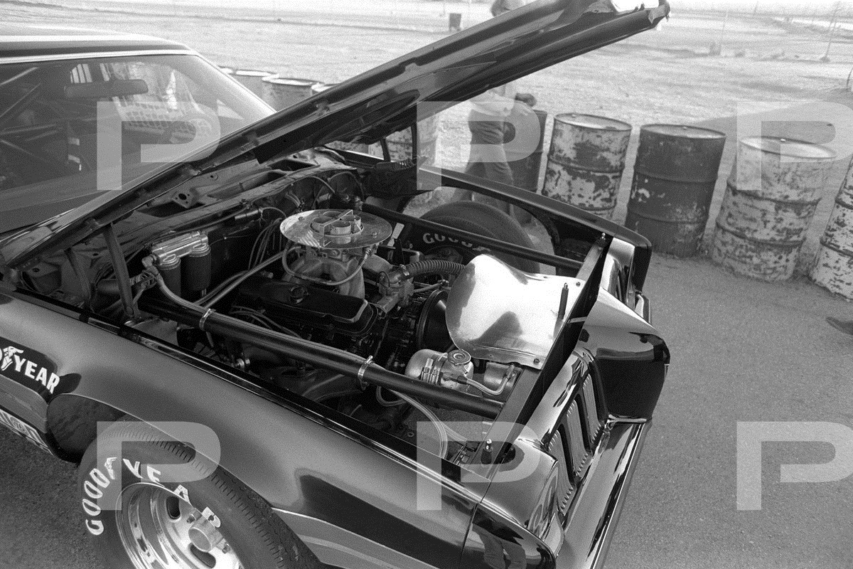

DoctorLarry Posted March 19, 2019 Author Posted March 19, 2019 That's what the white brackets are for. I have a panhard bar from the TBird but I have to shorten it. I was looking at the Olds Cutlass photos I have to see which way it ran.
MarkJ Posted March 20, 2019 Posted March 20, 2019 Looks good. I've usually seen it attached the other direction. Is it because its a road course car, or it doesn't really matter?
yellowsportwagon Posted March 20, 2019 Posted March 20, 2019 On 3/20/2019 at 12:44 PM, MarkJ said: Looks good. I've usually seen it attached the other direction. Is it because its a road course car, or it doesn't really matter? Expand I don’t think it matters. Monogram has there’s going like Larry’s. Amt goes the other way.
DoctorLarry Posted March 20, 2019 Author Posted March 20, 2019 In pictures of a Cale Yarborough Cutlass, that was how it was aligned but it had brackets on both sides so I put brackets on both sides as well.

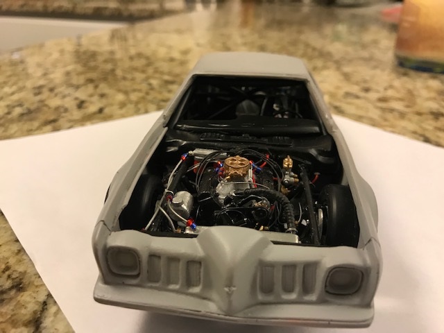

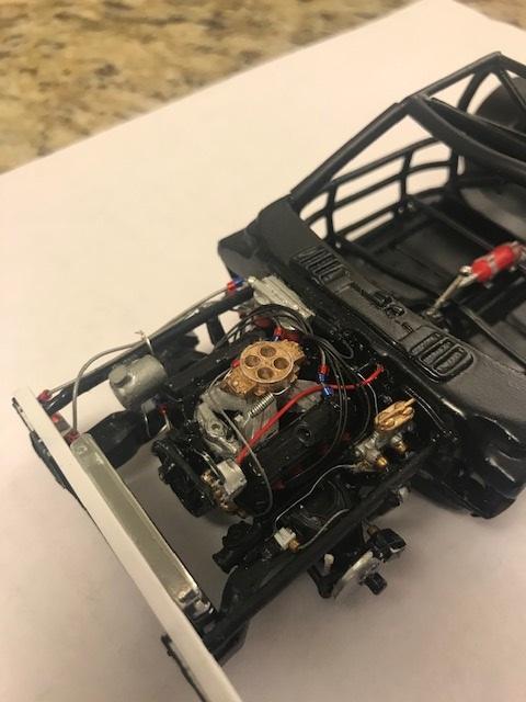

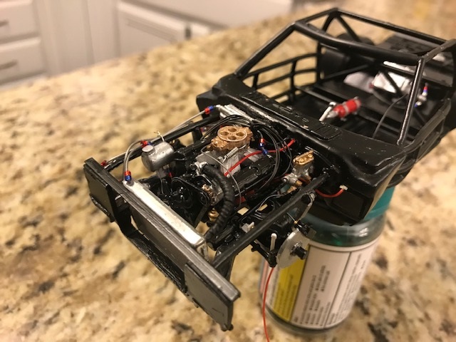

Heartattaq Posted March 21, 2019 Posted March 21, 2019 Beautiful RL car, and great build. Am absolutely loving all the reference material in this thread. Quick question and I am sorry if it was answered and I passed it by. The plumbing used on the engine, and oil cooler and whatnot, are they photoetched parts or is it various thickness wire, painted with transparent red and blue? Just curious as the pictures are just the perfect size that my garbage eyes cant make them out lol. Thanks in advance and cheers on the build.
DoctorLarry Posted March 22, 2019 Author Posted March 22, 2019 Hi, Derick. The stuff I am using is beading supplies from my local Hobby Lobby. They are cylindrical glass beads (not the round ones) and they make flexible braided wire that can be easily bent to 90 degrees. They have three sizes so you can do large hoses like oil coolers as well as fuel and brake lines. The beads are Miyuki Delicate. Not cheap, but will last a lifetime.

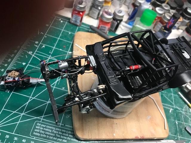

DoctorLarry Posted March 27, 2019 Author Posted March 27, 2019 Trying to get the engine in the chassis. Had to move the core support up closer to the nose. I added a throttle linkage and return spring to the carb to mirror the original. I also put the wires on the battery and mounted it in the battery box I built to mimic the real car.

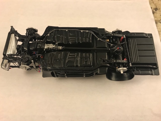

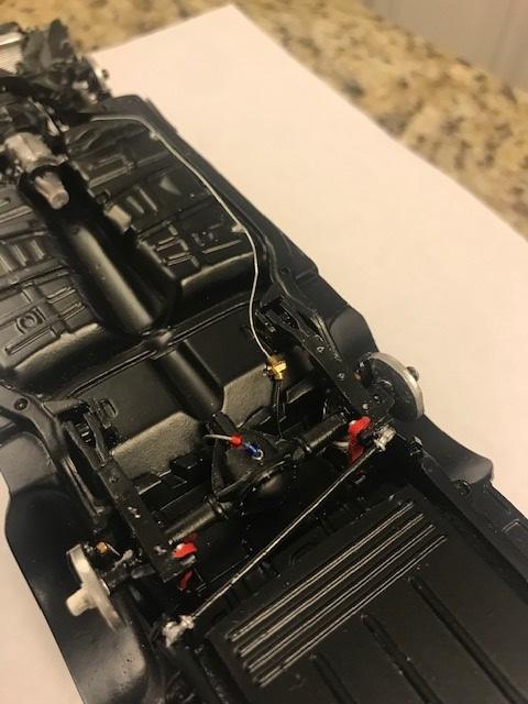

DoctorLarry Posted April 1, 2019 Author Posted April 1, 2019 Almost done with the chassis. Added front rotors/calipers, master cylinder and began running brake lines. Added steering box as well. I need to finish the brakes and add fuel line to the tank and pump, mount the engine and wire/plumb it all up. Then 180 degree headers and exhaust and we are ready for the body/ Also made some shocks for the rear and made brackets to mount them
DoctorLarry Posted April 2, 2019 Author Posted April 2, 2019 Finished the brakes last night and mounted the engine. Now I need to put all the plumbing in place.
DoctorLarry Posted April 5, 2019 Author Posted April 5, 2019 Moving along. Finished plumbing and rear chassis. Installed the radiator. Have to plumb the puke tank tonight. I changed some colors on parts for contrast. The whole car was basically black. Probably GM Reconditioning Paint!

DoctorLarry Posted April 8, 2019 Author Posted April 8, 2019 A little engine work. Needs headers, some roll bar braces, interior and fuel lines.

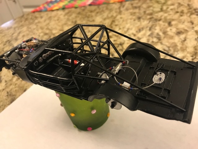

DoctorLarry Posted April 11, 2019 Author Posted April 11, 2019 Worked some yesterday evening. Put decals on the dash board and painted some on that. Added the rear fuel filter on the original car and plumbed the line to the fuel pump. Had to scratch build a drive shaft because I shortened the frame to fit the body but got that installed. Probably needs a drive shaft loop in the back but underneath is pretty much done. Still have to figure out exhaust, the fan shroud and the carb plate
DoctorLarry Posted April 23, 2019 Author Posted April 23, 2019 Got some more done. Scratch built the front sway bar and heim joint ends. Mounted the seat after making the racing harness. That has to be the most time consuming and painful thing there is! The photo etch parts are so tiny that it is very hard to do. I used black crepe paper from a streamer to make the belts and then painted them to make them a little stiffer. Threading them into the photo etch was so hard to do! Seat belts are a snap compared to that ordeal. I am now working on the 180 degree headers and then the chassis is done. Because of the contortions involved in building them I am using solder. I have seen a lot of builders make headers out of it so we will see how it goes.

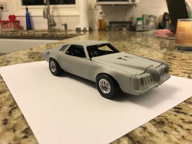

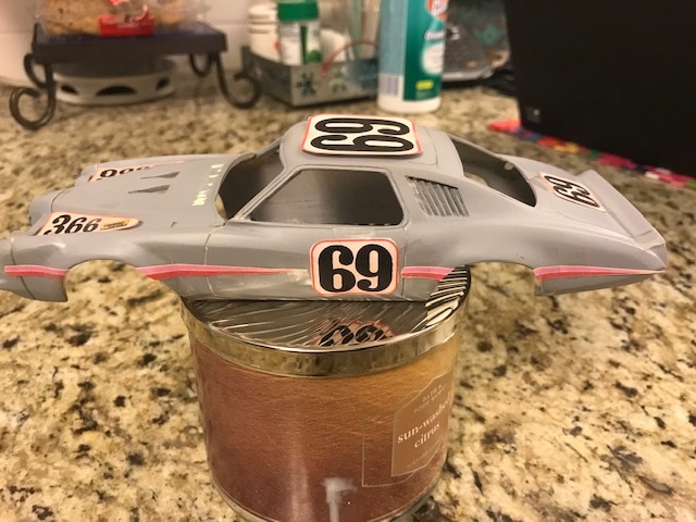

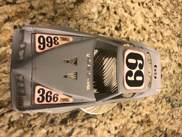

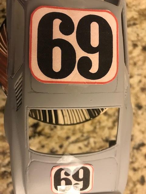

DoctorLarry Posted May 21, 2019 Author Posted May 21, 2019 Got the decal art proof from Speedway decals. Looks great. Hood needs to be longer and narrower and roof needs to be longer but they will look good in the actual colors over foil.
DoctorLarry Posted May 28, 2019 Author Posted May 28, 2019 Got my decal sheets from Speedway in the mail today and they are beautiful. They were not inexpensive but great art never is. This will be a very expensive build when it is all said and done but it will look killer, just like the real car. Now I just have to finish the body!
