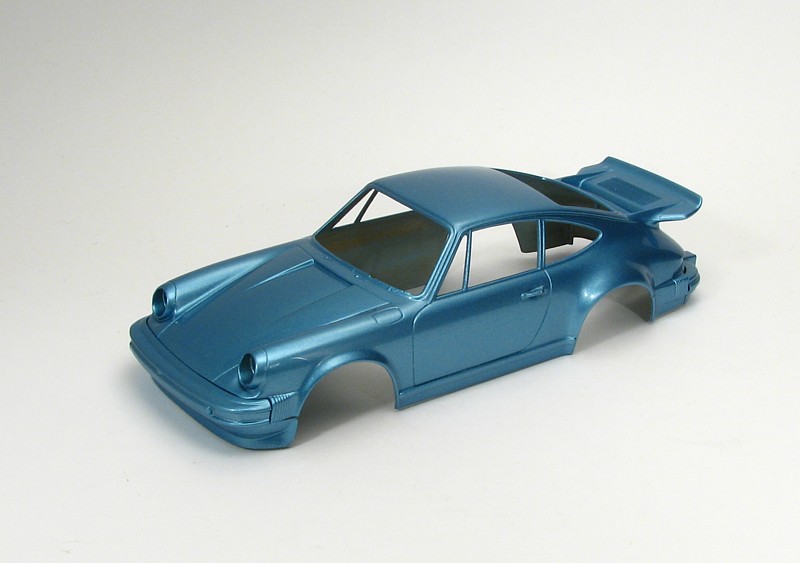

Zoom Zoom Posted December 20, 2018 Posted December 20, 2018 On 12/18/2018 at 12:22 PM, aurfalien said: Hi, While I use cheap lacquer thinners from hardware stores, I've noticed that both the Gunze and Tamiya lacquer thinners are not hot and seem to have an odd wetting affect on my air brush. A sort of lube and retarder at the same time. Gunze and Tamiya lacquer thinners are awesome! I use Gunze (Mr. Hobby Mr. Color Thinner, sometimes Mr. Leveling Thinner if blushing conditions warrant) with a variety of the "aftermarket" model car paints. I learned 25 or so years ago when LMG productions was selling the line of House of Kolors candy lacquers and bases that Gunze thinner was their suggested thinner of choice. Roughly 15 years ago I was fighting ghost lines on a model painted w/Black Gold's HOK paints and Cobra Colors clear; it suddenly dawned on me the old recommendation about using Gunze thinner. Suddenly my clearcoats were going down smooth as enamel and not causing the previous ghosting issues that plagued the paint job every time I applied clear. Problem solved. I used Mr. Color Thinner this past week on this vintage (from '76) Monogram Porsche 911 Carrera that was molded in yellow. Prepped the sanded mold lines with liquid cement to prevent ghosting, used hobby primers (Tamiya and Mr. Surfacer) and a mix of some automotivetouchup.com's (Pontiac) Atlantis Blue w/some vintage Cobra Colors Porsche Polar Silver got me the desired shade of blue. It thinned the mixture of both colors perfectly. I use Mr. Color Thinner on nearly of all my builds; whether automotive based or Tamiya or Mr. Hobby lacquers decanted or from a jar. Tamiya lacquer thinner should work as well, but with either it's good to test a bit in a mixing cup w/color of choice to make sure it mixes and doesn't clump up into a glob of gel. Hardware store thinners are great for cleaning my airbrush, I don't mind paying a bit more $ for quality reducers for my colors and clear. In the long run it pays off.
crowe-t Posted December 20, 2018 Author Posted December 20, 2018 Bob, The color on the Porsche 911 Carrera looks great! The finish looks very smooth. I didn't think Gunze thinner would be hot enough to work in automotive lacquer. I have Gunze Mr. Leveling Thinner so I'll give it a try.

aurfalien Posted December 20, 2018 Posted December 20, 2018 (edited) 6 hours ago, Zoom Zoom said: Gunze and Tamiya lacquer thinners are awesome! Your paint job on that 911 looks awesome! What ratio do you use for both your Mr. Color Thinner and Mr. Leveling Thinner? Edited December 20, 2018 by aurfalien
Zoom Zoom Posted December 20, 2018 Posted December 20, 2018 2 hours ago, aurfalien said: Your paint job on that 911 looks awesome! What ratio do you use for both your Mr. Color Thinner and Mr. Leveling Thinner? Thanks! I use the same ratio as any thinner, no exact number. Enough to thin the paint to a consistency roughly similar to 2% milk so it flows smoothly. Sometimes pre-thinned paints need a few drops, unthinned paint often needs roughly 1 part paint to 1 part thinner. Often I use more thinner for the wetter layers of clear. Your mileage may vary.
