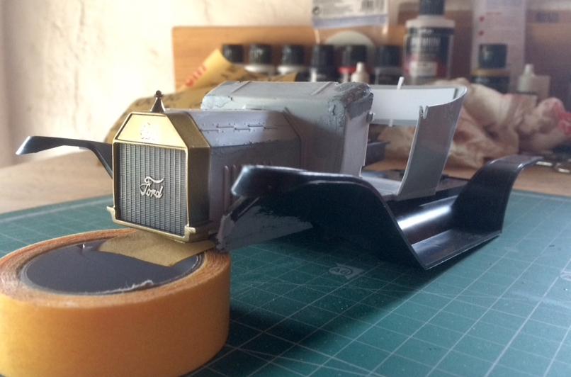

Today I have been able to get it out of the box, and carve up a few major parts to give it the vintage look:
The front wheel arch fenders have been raised 5mm to bring them to the correct height and angle.
The body bucket has been chopped out at the back- ready for a scratch-build pickup bed, much preferable to the guilded dickie seat museum piece offered in the kit.
The bucket sides and doors are undergoing some reshaping and ‘contouring’ - the kit provides flat slab-sided parts which do nothing for the looks and accuracy. The front bulkhead has also received some of the same treatment. -This is a good project to practice scratch building, as the curvature and panel fit can be a bit off, yet still appear authentic.

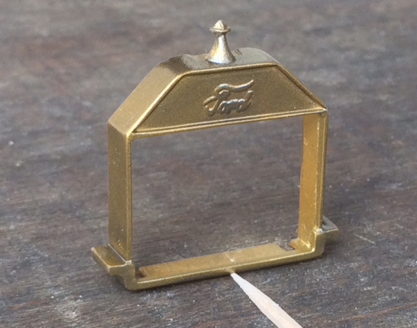

I am experimenting with a more subdued brass finish on the radiator shroud and other parts, thanks to Vallejo Model Color Brass which I diluted, misted then wetted on the bare grey plastic. Then I brushed very lightly a metalizer powder by C1 over parts of the now touch-dry paint and buffed softly.
It looks like clean but not over polished brass, and is much more acceptable than the bright plated finish as supplied. It could be a little smoother, but I reckon a few coats of lacquer and sanding could fix that if necessary.

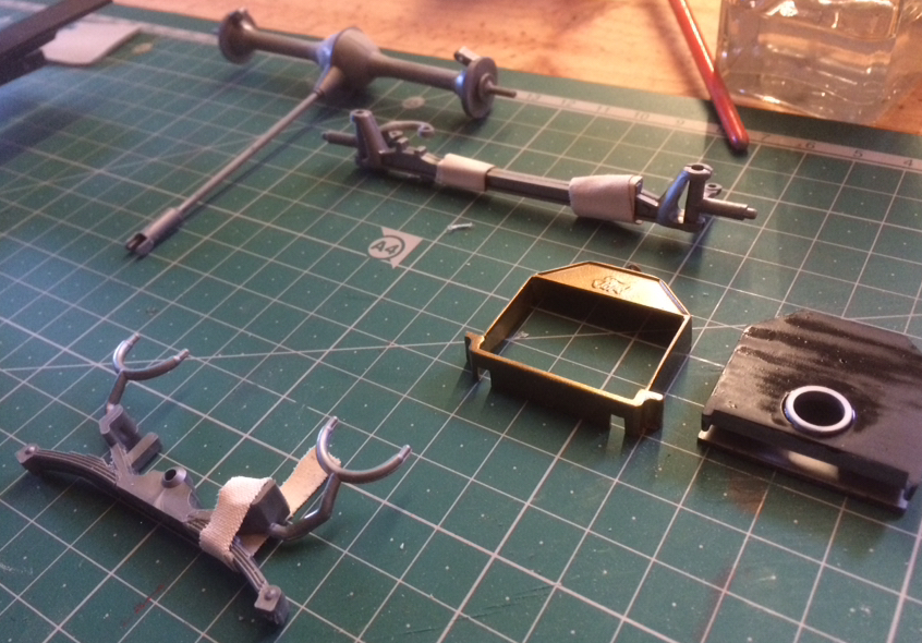

Next up are the transmission, suspension and steering assemblies, now built and ready for some paint. Black, of course.
As expected, every part removed from its tree so far has been, or shall be, modified somehow!

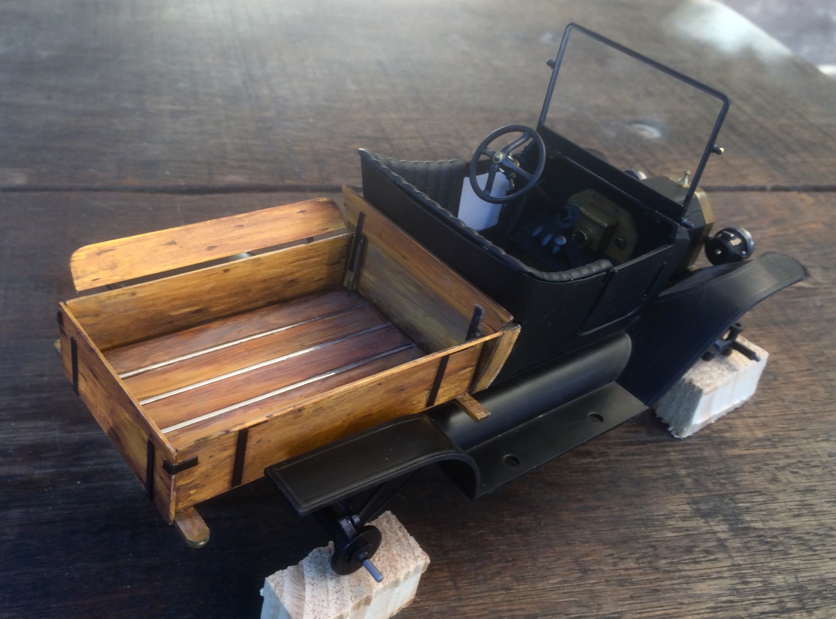

Other than that, I have completed the pickup bed, all poly sheet, painted and glued to look like real, knarly hardwood,
Yellow ochre base:
Finger-applied woodgrain (acrylic paint):
Add a few wood knots, chrome beading added. A pale grey wash to back-off and unify the strong wood colours. Adding a heavy black wash in the seams and interior corners helps the final effect.
The whole assembly just slips in:
that’s all for now folks, thanks for looking.

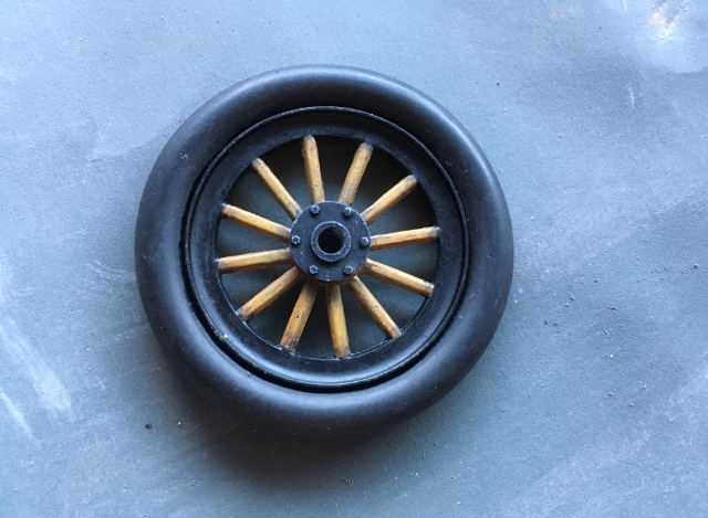

At last I got around to remove the blingy gold chrome off the rims, trim the tyre locating flange off the outside edge, and have a little play with some paint.
The tyre is in fact an o-ring, the kit tires are a bit too chunky for the front, and treadless tyres (!) were available back when.
I have gone for the natural wooden spokes with some staining/weathering to go with the used maintained look of the model..
Wheels painted and test fitted, the rear axle is too wide, and the wheels themselves are too chunky, but it will do. It is reasonably close to my reference photo.
