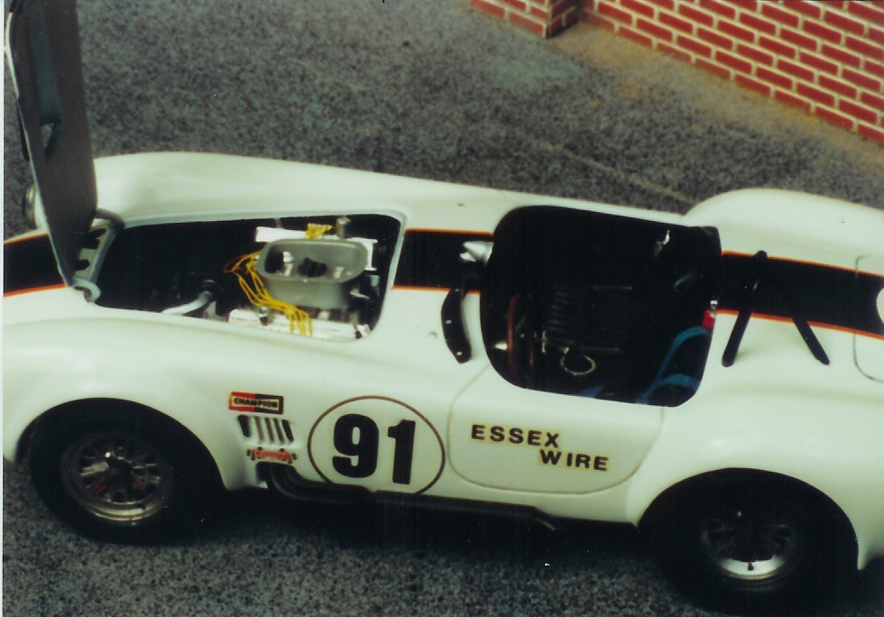

Gramps46 Posted December 27, 2018 Posted December 27, 2018 I built this model before Monogram released their version of it and used dry transfers on clear decal sheet for the Essex Wire lettering. Over time the decal has yellowed. Perhaps if I had clear coated it that would not have happened and being used over white did not help either.
Snake45 Posted December 27, 2018 Posted December 27, 2018 17 minutes ago, Gramps46 said: I built this model before Monogram released their version of it and used dry transfers on clear decal sheet for the Essex Wire lettering. Over time the decal has yellowed. Perhaps if I had clear coated it that would not have happened and being used over white did not help either. Try putting that model in a sunny window and see if the sunlight bleaches out the yellowing. It works a charm on unapplied old decals; it might work on applied ones too.
Gramps46 Posted December 27, 2018 Posted December 27, 2018 4 minutes ago, Snake45 said: Try putting that model in a sunny window and see if the sunlight bleaches out the yellowing. It works a charm on unapplied old decals; it might work on applied ones too. Thanks Richard, I will give it try.

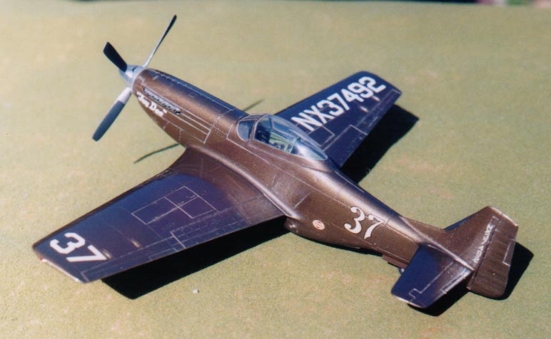

Snake45 Posted December 27, 2018 Posted December 27, 2018 IIRC, I used Woodland Scenics dry transfers to create the small number on the fin of this P-51. And I THINK I put them on a clear decal sheet, and then covered them with Micro Superfilm.

Hotrod 97 Posted December 28, 2018 Author Posted December 28, 2018 10 hours ago, Snake45 said: IIRC, I used Woodland Scenics dry transfers to create the small number on the fin of this P-51. And I THINK I put them on a clear decal sheet, and then covered them with Micro Superfilm. Thanks for the pics, Snake! Just curious - what scale is that P-51?
Snake45 Posted December 28, 2018 Posted December 28, 2018 53 minutes ago, Ty Gontz said: Thanks for the pics, Snake! Just curious - what scale is that P-51? It's the old Otaki kit (also boxed by ARII, AMT, and Airfix) in 1/48.
