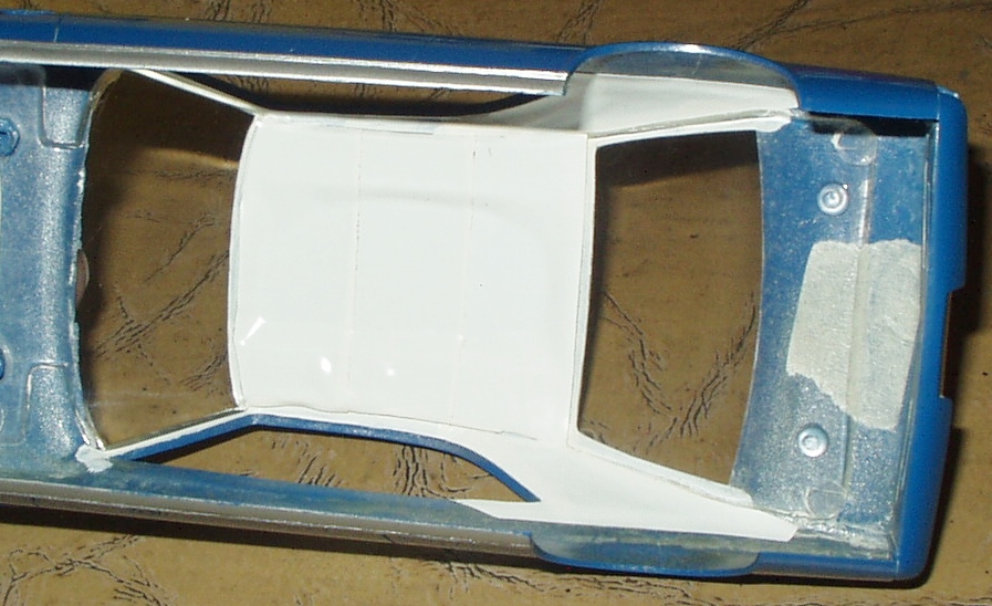

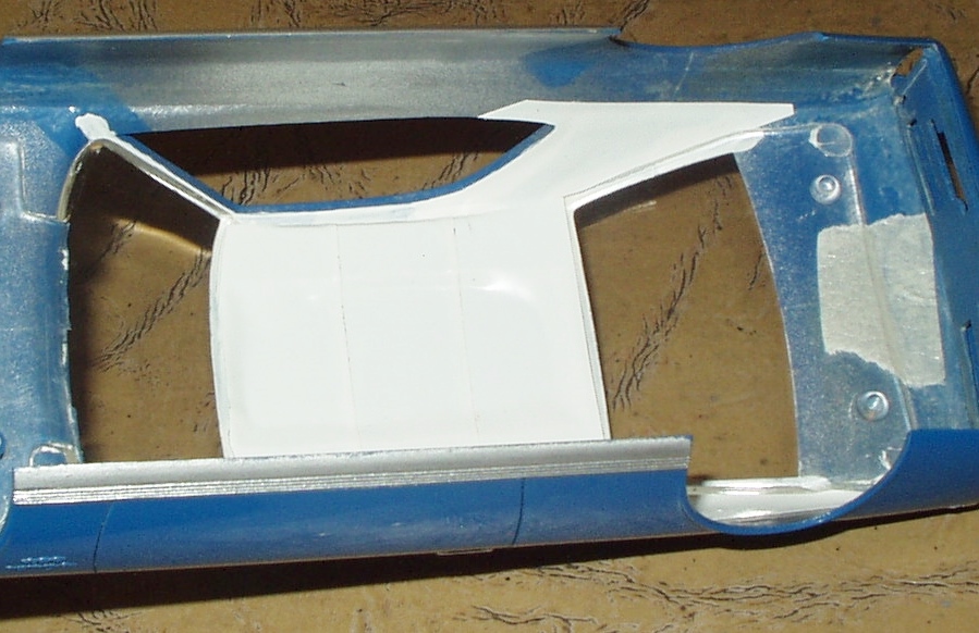

Snake45 Posted December 24, 2018 Posted December 24, 2018 Mask off the windows on the outside (before painting the exterior color), shoot your white on the inside, then mask off the inside white, clean up any overspray on the outer body, and proceed as usual. For white headliners, I've also been known to use 3M white vinyl tape, run side-to-side so the seams look like seams in a fabric headliner.

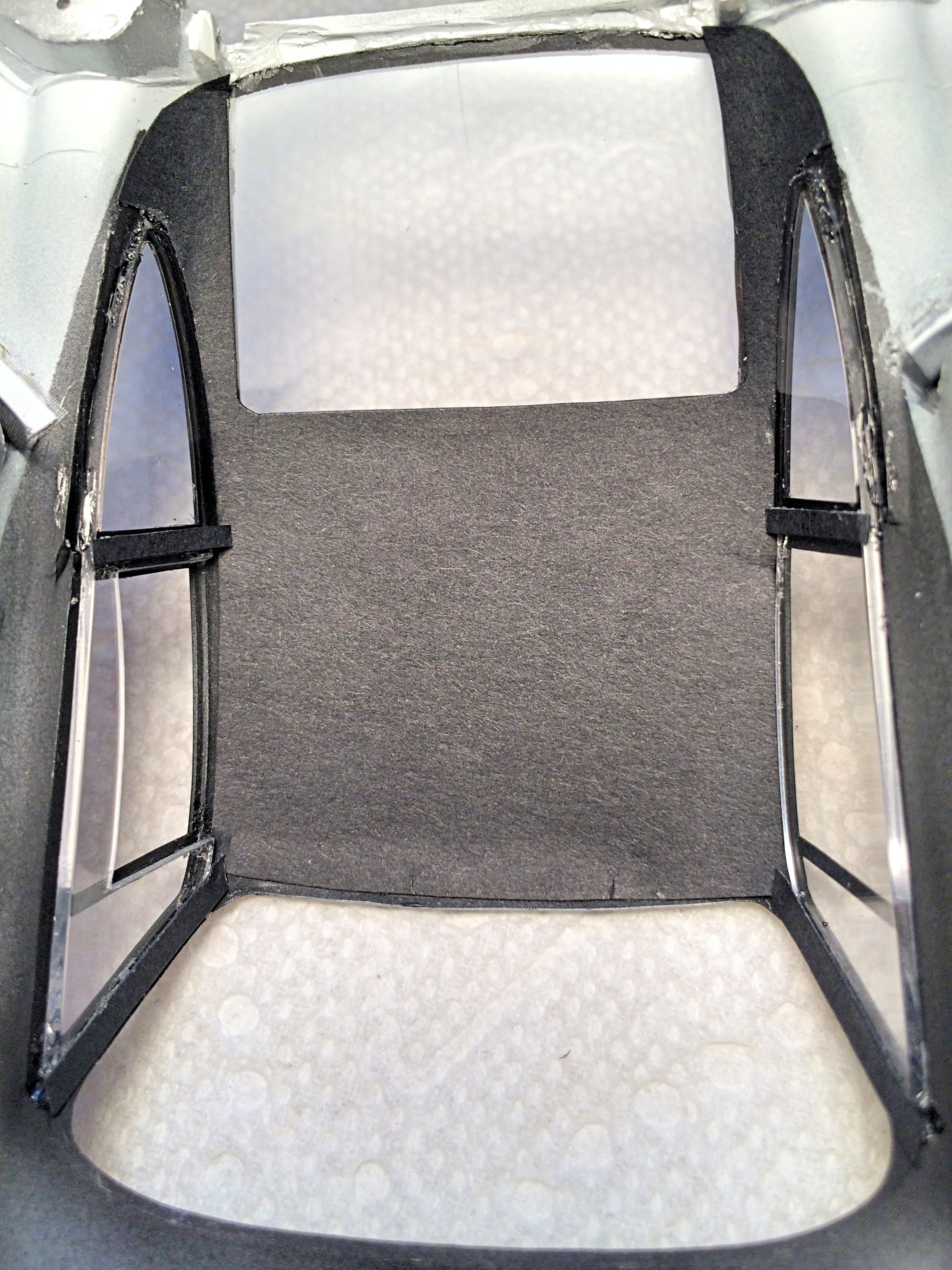

rsxse240 Posted January 5, 2019 Posted January 5, 2019 This is a very multi-layer question. Just painting a headliner, box stock build, I like Snake's plan. Covering mold imperfections and such, 89AKurt's plan would work well with any number of materials. I have used both of these examples and had great success. But there's no limit to how detailed you can get. I have used sheet styrene to build up interior details on a, b, and c pillars to give depth and dimension and used masking tape for headliner. I've used Bondo to fill in spaces to smooth out the inner roof. The thing is to find a 1:1 reference photo of what you wish to replicate, then through trial and error, asking for suggestions, and brainstorming, come up with a plan to achieve your goal. You see in this picture, I had a full bucket type "glass". I temporarily installed and scribed the door window opening to the bucket, carefully scribed out the door glass leaving the bucket minus the door glass to represent the interior trim plastics. I then shaped and polished things accordingly. I then used masking tape to cover the square hole in the headliner, did some creative masking and painting to create a very believable headliner and inner roof. Then I thinned and polished the door glass and installed them to be halfway down. All because I wanted to hang the seatbelts where they belong. Lol Here's the finished product. See how well the effort payed off? Oh, no, you can't see it, but it does look very good, take my word. Hahaha
