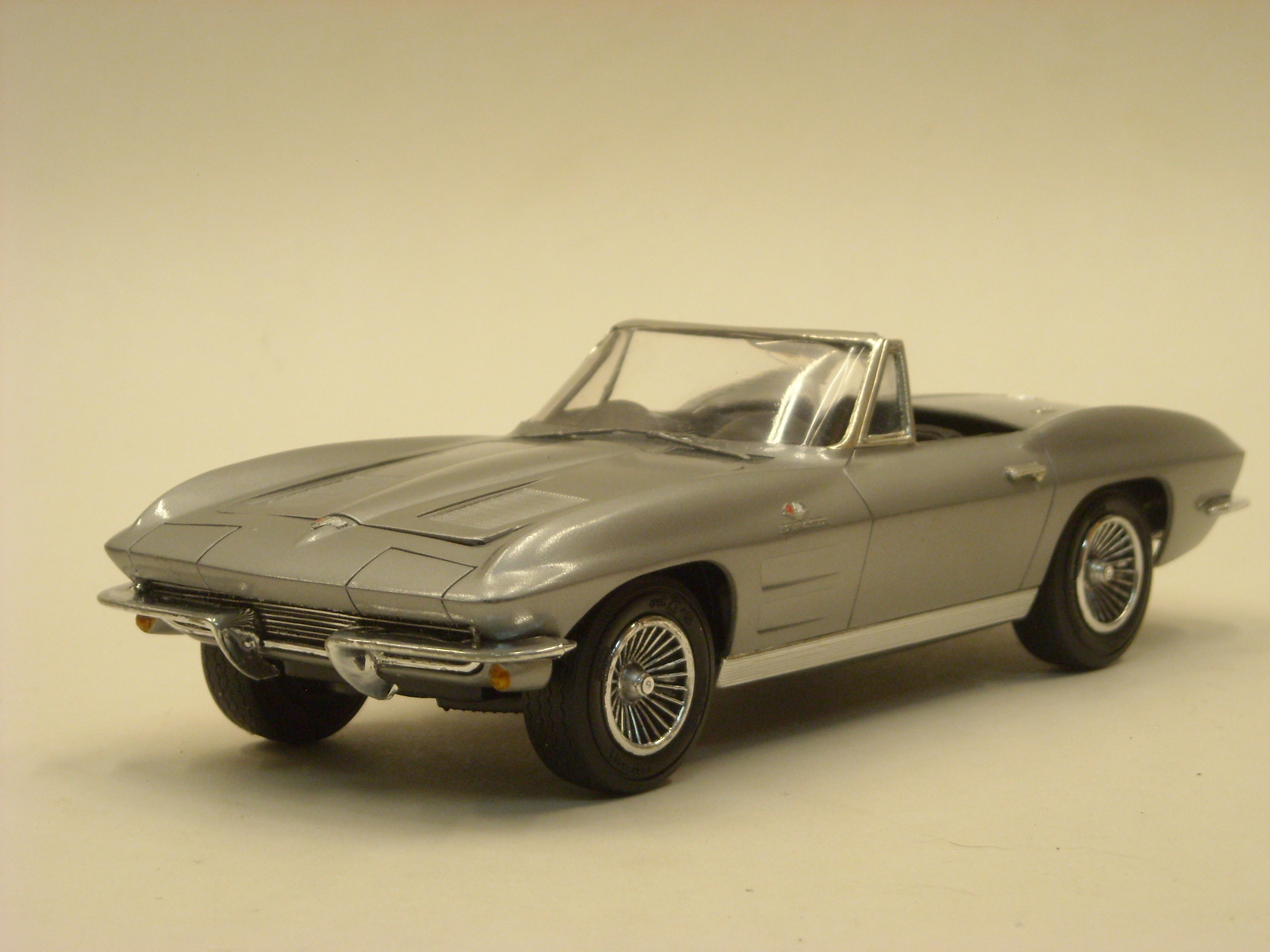

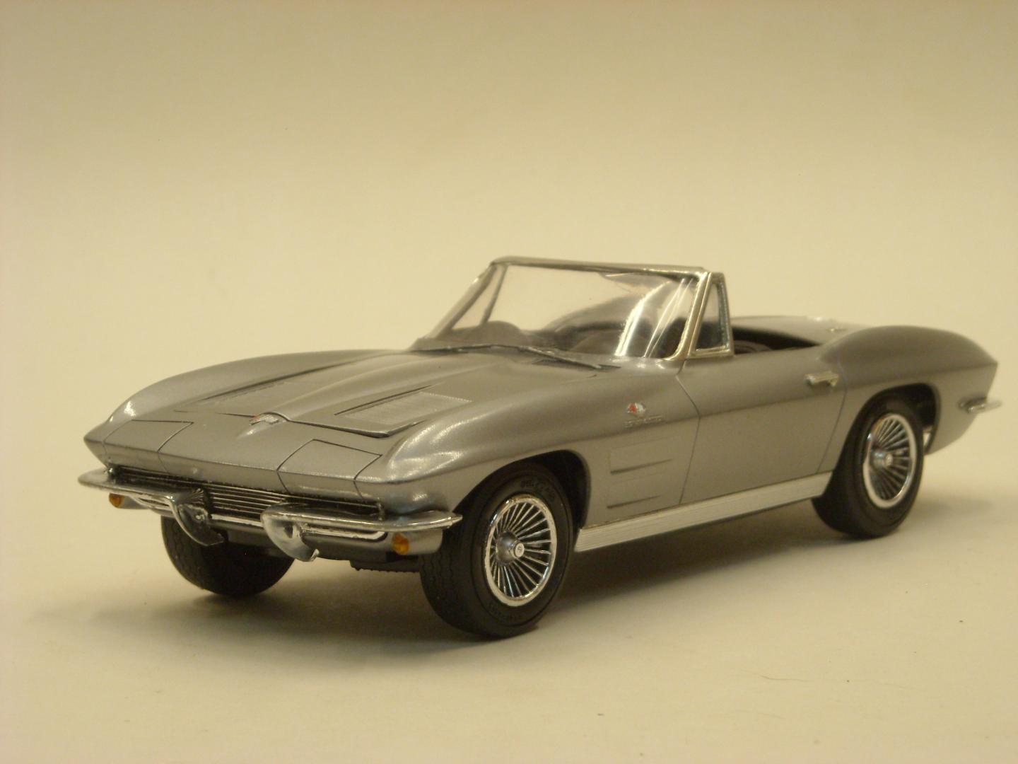

Kit Basher Posted December 27, 2018 Posted December 27, 2018 (edited) 2 hours ago, BigTallDad said: There's a product called "Pearl X" available at Michael's. It's a dry powder you add to paint for the metal-flake effect; it's also available in several different colors (gold, silver, etc.). I tried mixing Pearl Ex with regular paint and it didn't work. There was no metallic/pearl effect at all. If you mix Pearl Ex with clear, and spray it over your color coat, you can get some very nice effects. "CrazyJim" has posted some models on this forum showing this technique. I routinely mix Testors Silver and Gloss Black to get a darker silver color, that works fine. I have never tried it with any color other than black. This is Testors Silver with some Gloss Black in it: Edited December 27, 2018 by Kit Basher

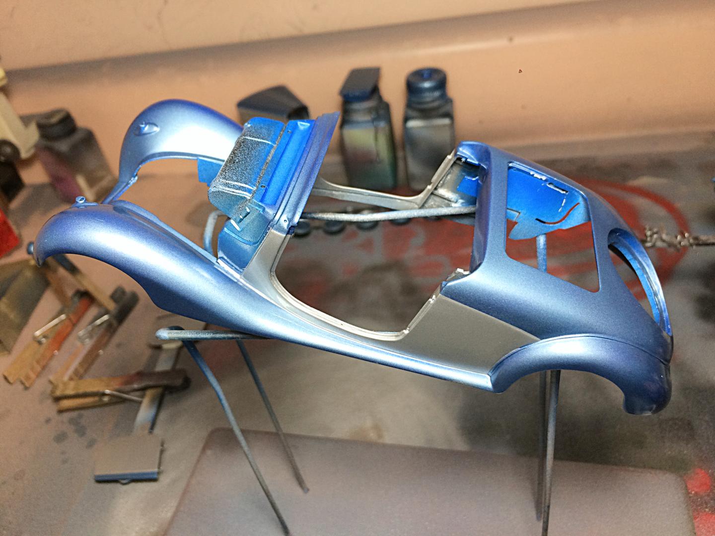

89AKurt Posted December 27, 2018 Posted December 27, 2018 I'm no expert, and my experience is with enamels. But you should learn how to mix paint colors. Doing a test as Snake45 suggested is always a good idea. But it could look different when mixed in the airbrush and sprayed, vs. mixing a puddle. As I struggled with this project, I thought the straight-out-of-the-bottle metallic blue was close, but after spraying, I could not live with it. So I mixed silver with that paint until I was happy, and then hoped I would never need to touch up later. But I would like to read what acrylics do.
