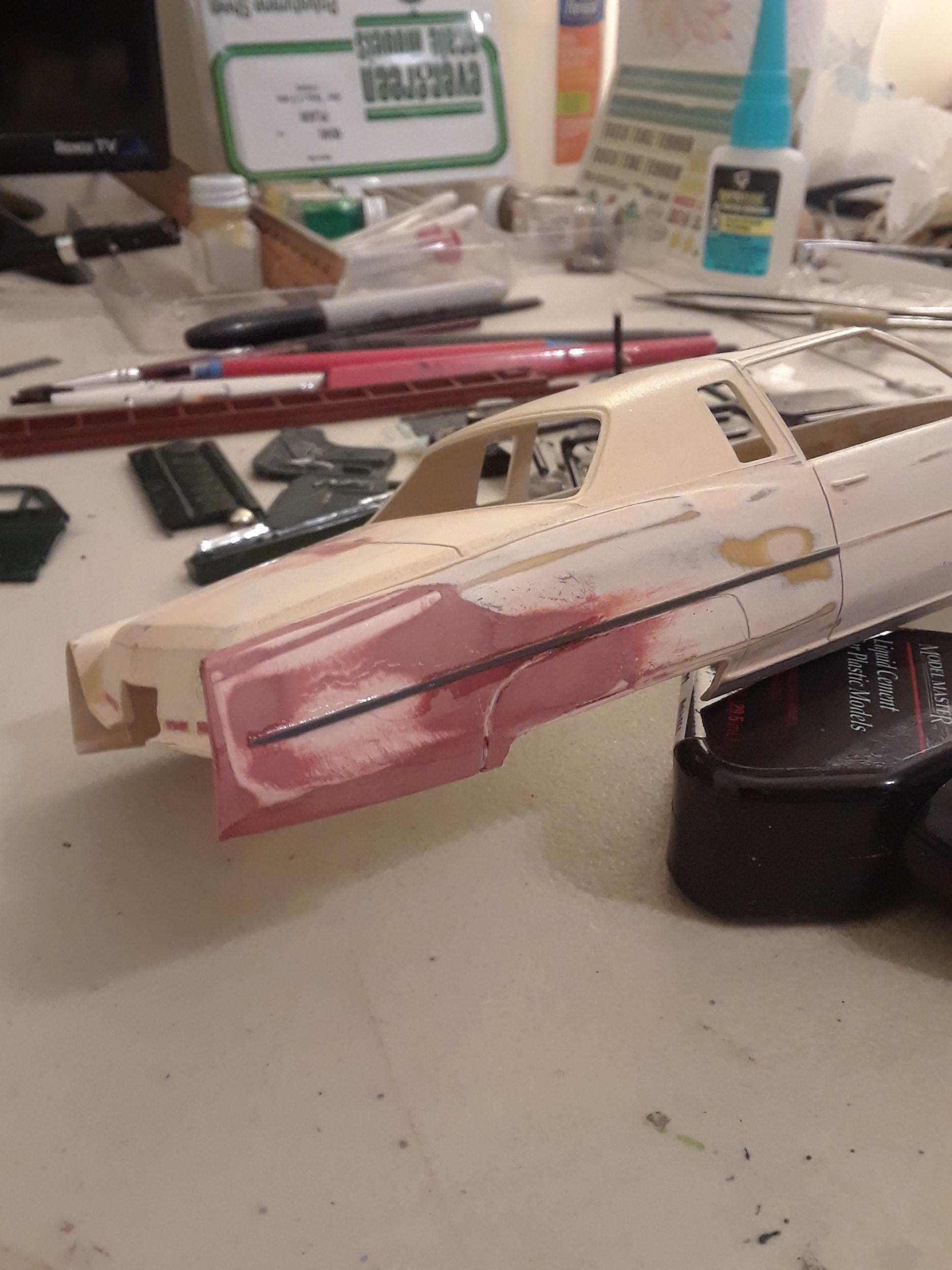

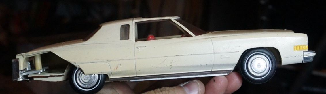

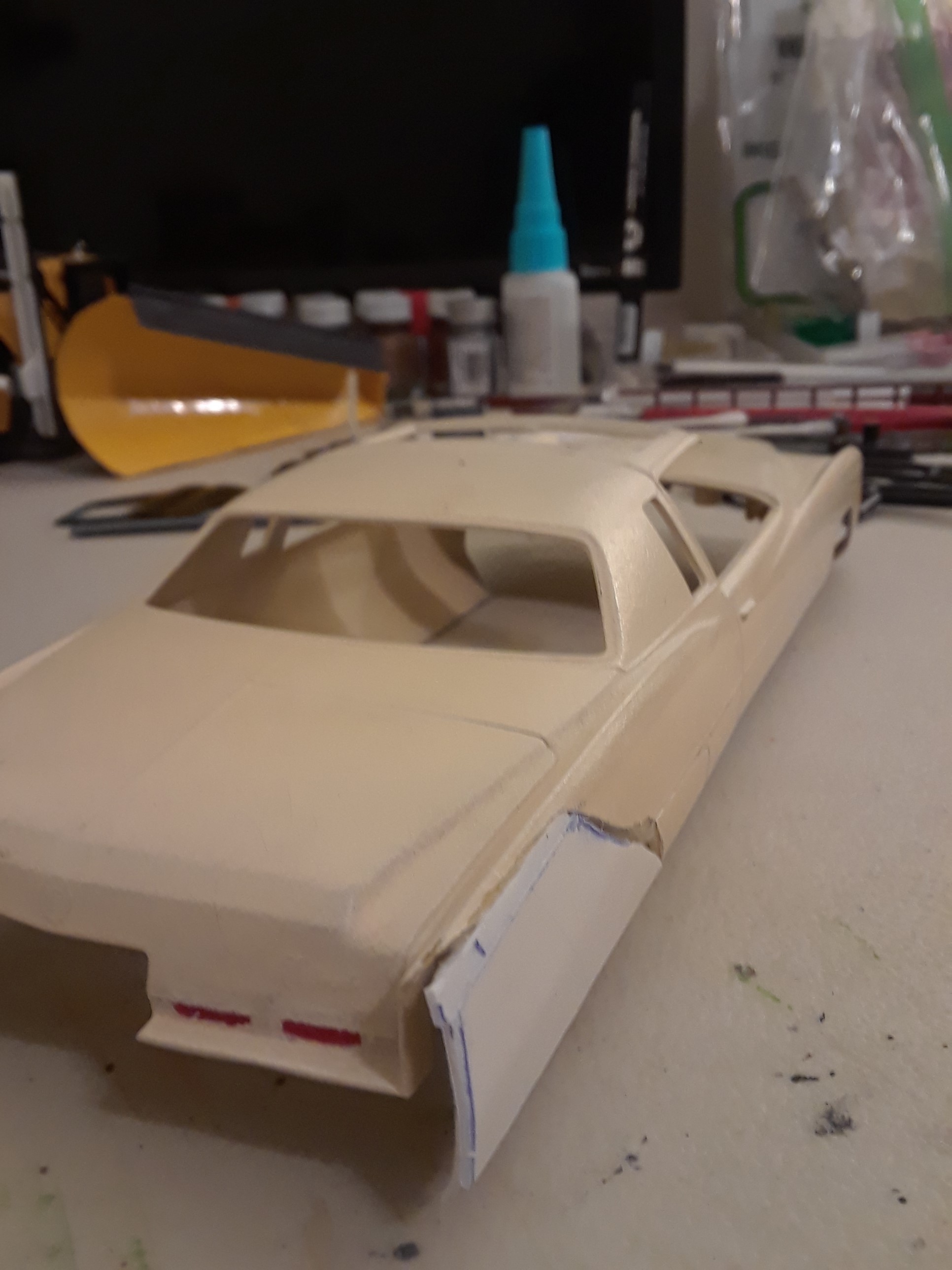

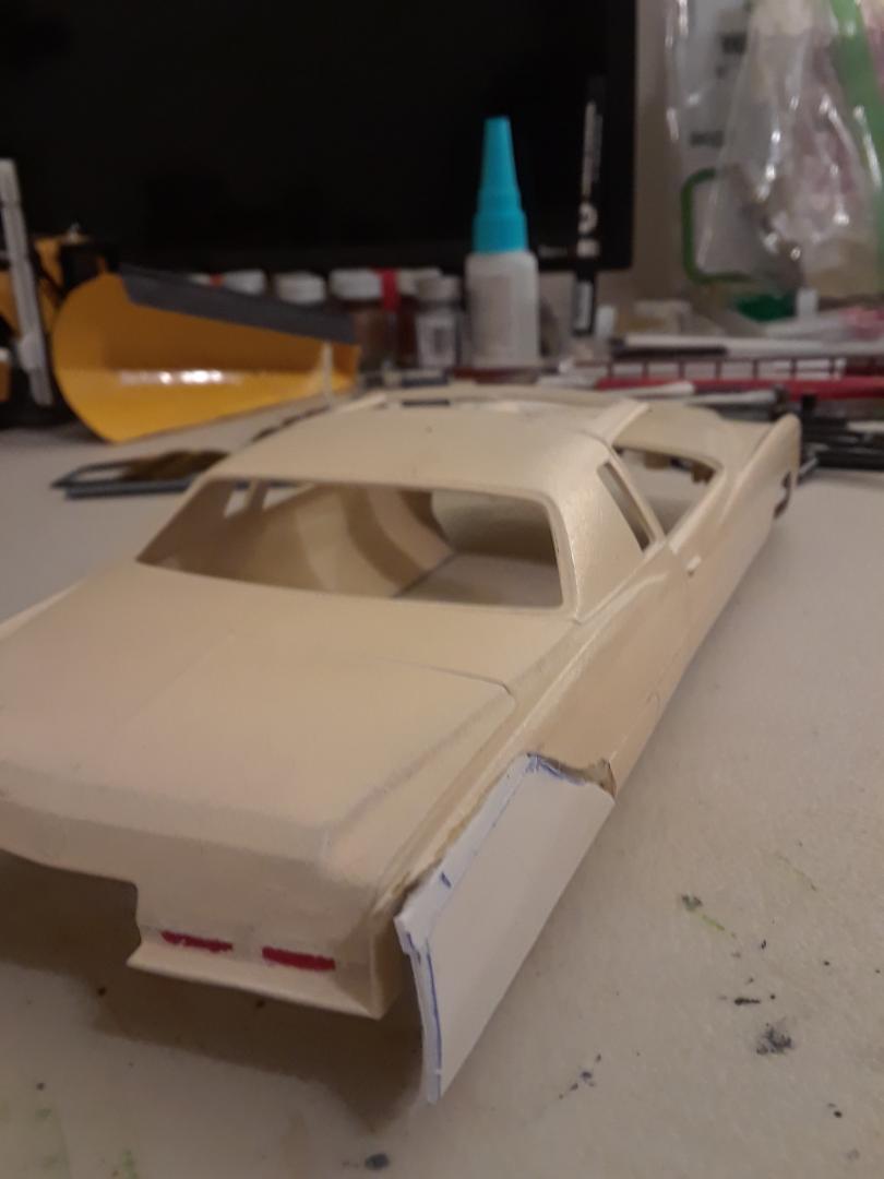

caddy guy Posted January 17, 2019 Posted January 17, 2019 i do a lot of styrene fabricating . This stuff works great !. similar to super glue but thicker. it bond's pretty quick and within 30 minutes i can usually work with glued pieces and nothing comes apart. Home Depot is where I got it. I used it to rebuild this missing section of quarter panel on a 74 eldorado. It took 5 pieces of sheet styrene . It sands well too. I use this a lot. got a bunch of fabricating project going on and this stuff works great. In a few hours its not coming apart.

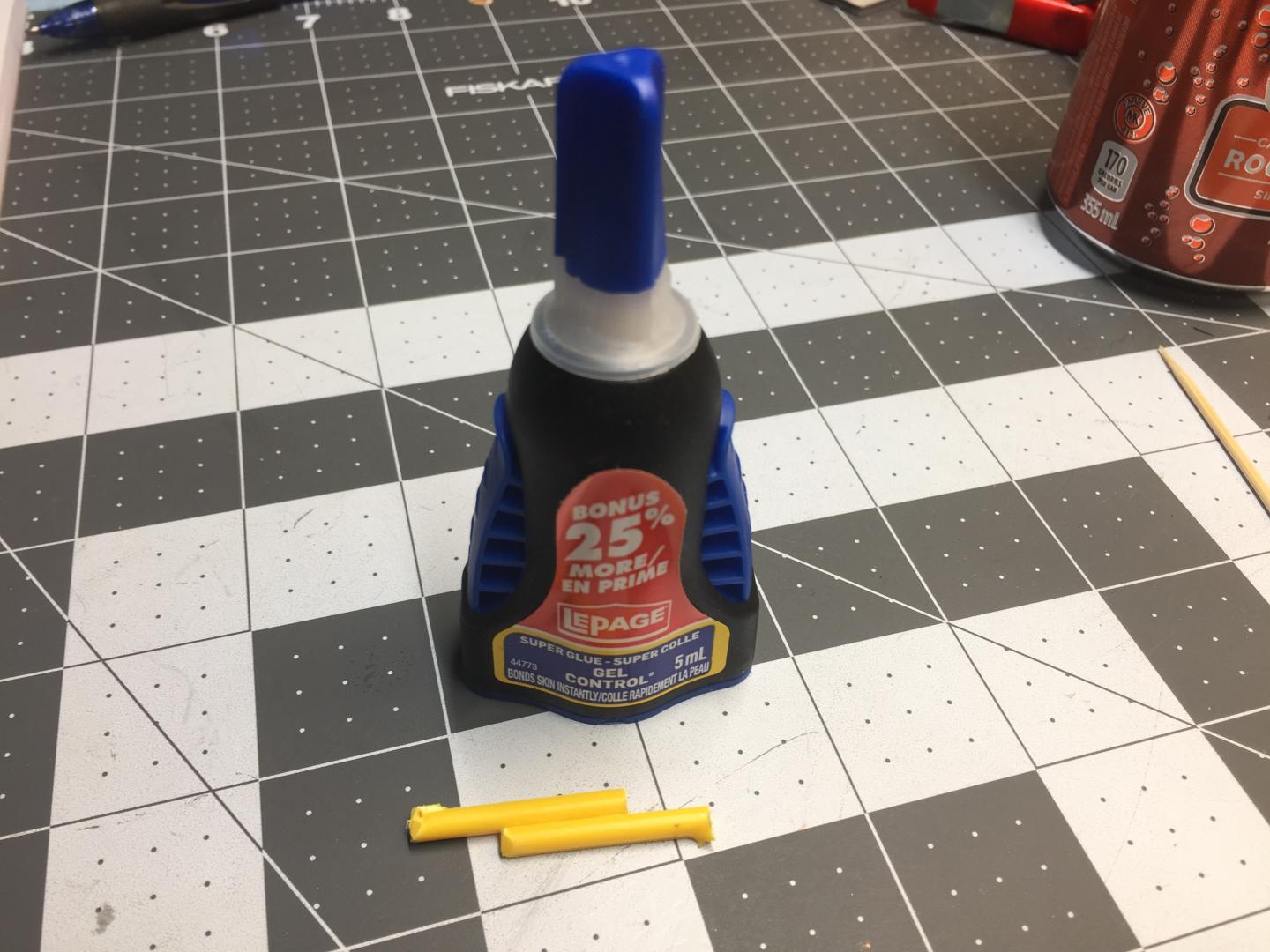

NOBLNG Posted January 18, 2019 Posted January 18, 2019 (edited) I went looking for that stuff at Home Depot, but they didn't have it. They did have this stuff on sale though. I filed a slight flat spot on two pieces of sprue and lapped them inline for about a half inch. They are stuck together real good! I really like the applicator on this bottle too. You squeeze the blue tabs on each side to dispense the gell-like glue. It is very easy to control minute amounts coming out. Edited January 18, 2019 by NOBLNG
peteski Posted January 23, 2019 Posted January 23, 2019 That LePage stuff is just gel-type Super Glue (CA glue) - it says so right on the bottle. Is it really any better than all other gel-type CA glues?
NOBLNG Posted January 23, 2019 Posted January 23, 2019 (edited) 7 hours ago, peteski said: That LePage stuff is just gel-type Super Glue (CA glue) - it says so right on the bottle. Is it really any better than all other gel-type CA glues? Probably not, and it doesn't claim to be, unlike the DAP stuff. I just broke those two pieces of yellow sprue apart. They were stuck pretty good, but nothing like good old model cement would do. I did buy some other thick super glue at the hobby shop and it was so thick that I couldn't squeeze it out of the bottle. This LePages stuff applies beautifully, and that is what I love about it! I wish I could find the DAP stuff to try. The video says it is stronger than polyurethane (Gorilla) glue and more durable than super glue (cyanoacrylate)...but what is it? Edit: I Just looked on DAP website and they say it can be dissolved with acetone. So it is their own special formulation of cyanoacrylate (superglue). Edited January 23, 2019 by NOBLNG
