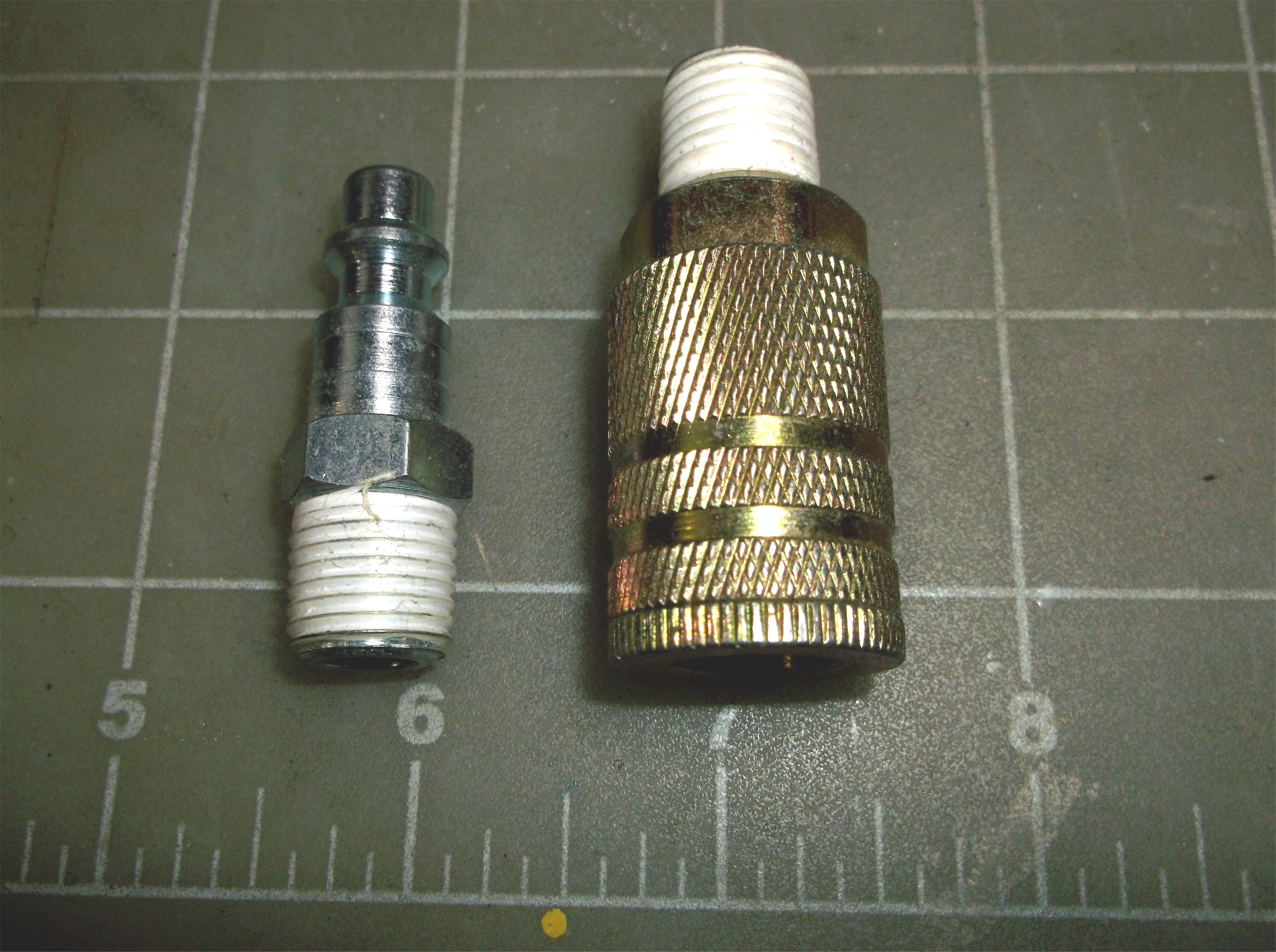

DPNM Posted December 30, 2018 Posted December 30, 2018 Your airbrush hose should attach to the connection off the water-trap. A better way would be to get a set of quick disconnects. The silver one would attach to your hose. The gold one would attach to the water trap. My gold one in the pic has a male end. You will need one with a female end. Also, use teflon tape on all threads. Hope this helps.
