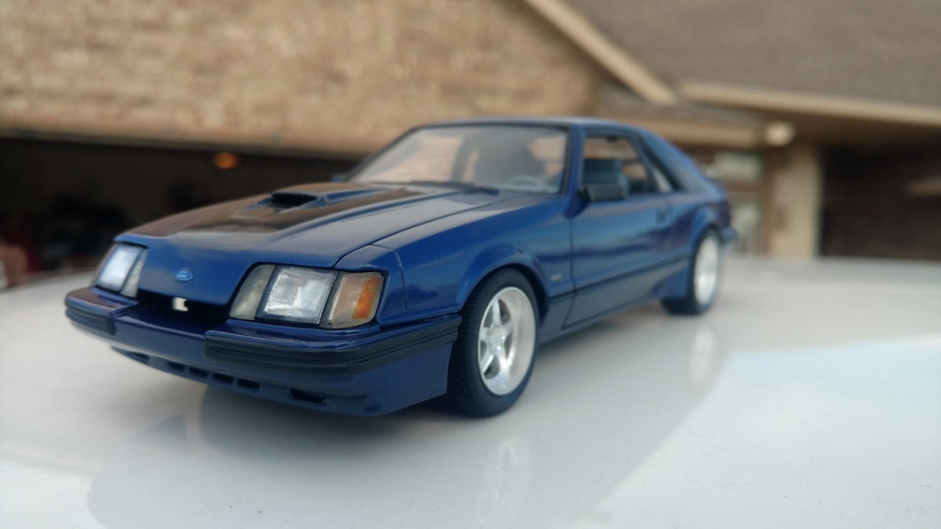

rsxse240 Posted January 5, 2019 Posted January 5, 2019 (edited) Testors Model Master ice blue pearl acrylic, shot through my Paasche H. Clear coated with Testors gloss acrylic clear, wet sanded and polished (to eliminate the very slightest orange peel that was likely from the primer) Edited January 5, 2019 by rsxse240
