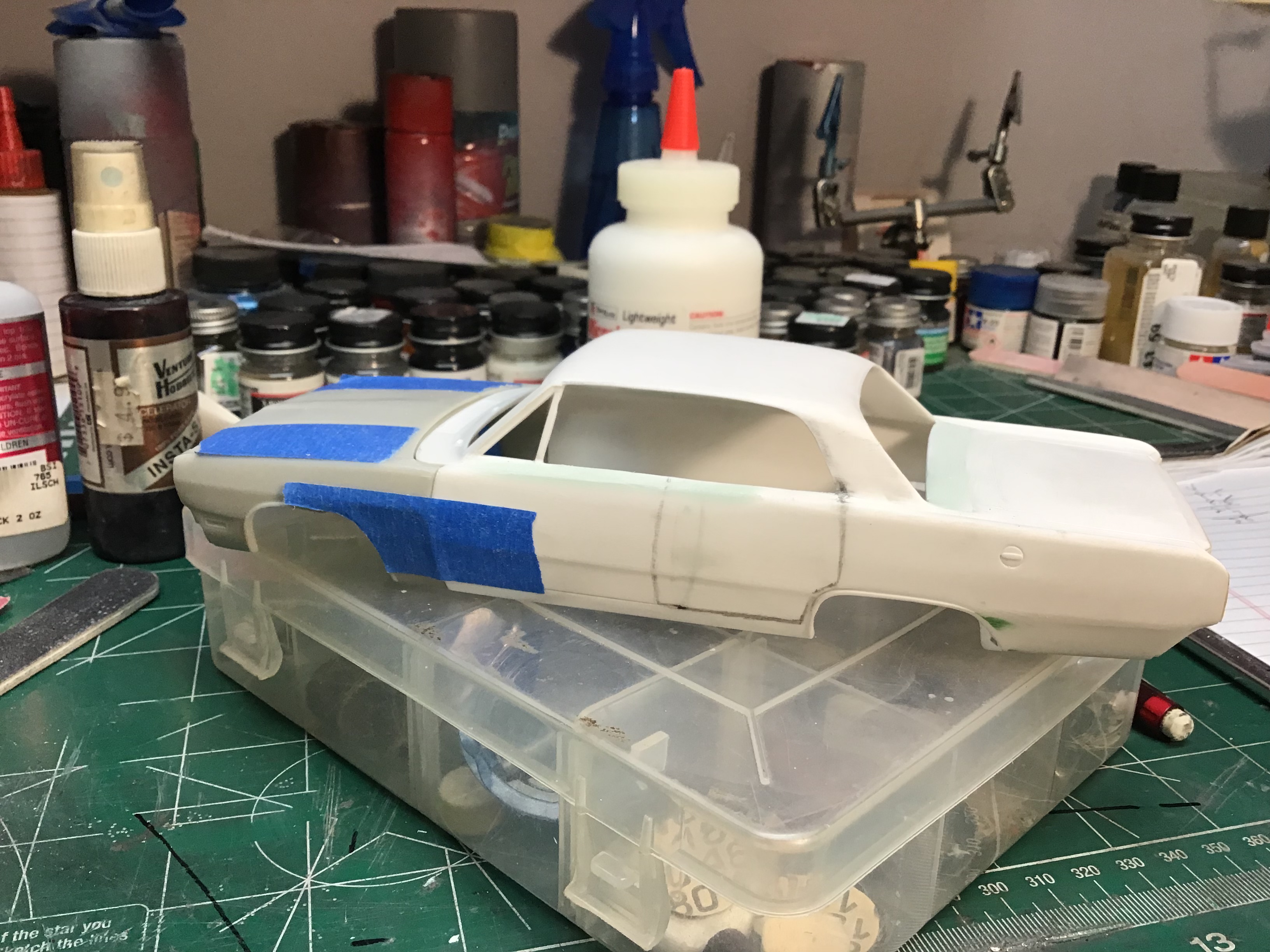

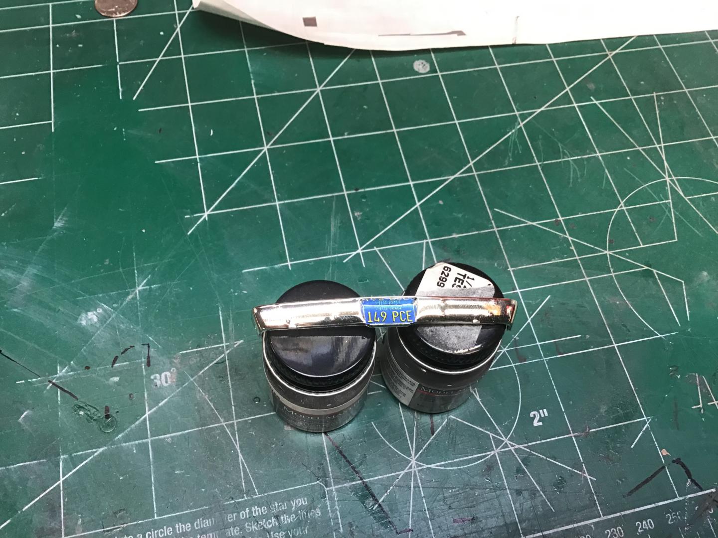

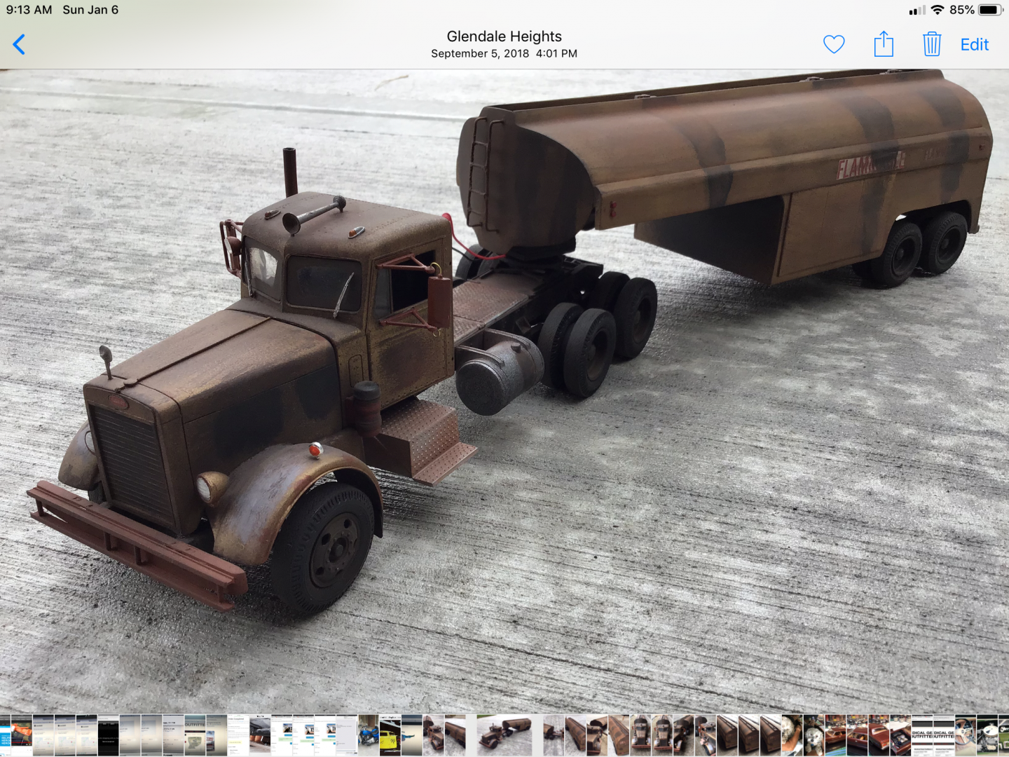

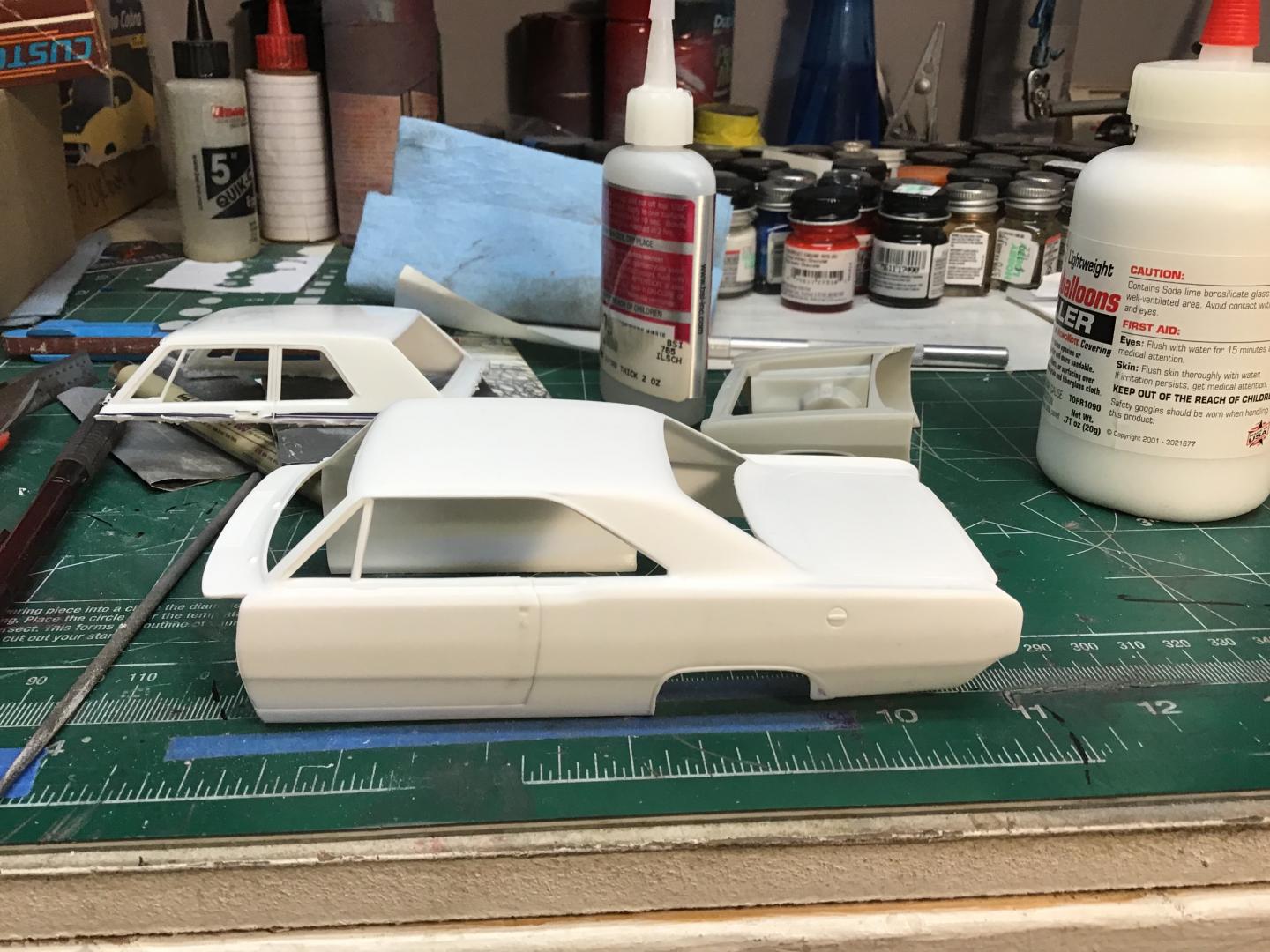

dragmodels44 Posted January 6, 2019 Posted January 6, 2019 (edited) Hey Guys, I wanted to share a new project that I’m starting. I’ve collected most of what I need to start. This is really a continuation of what I started when I did the evil truck from the movie “ Duel “ starring Dennis Weaver, who drove the red Valiant as he was chased by the truck. From what I’ve learned they were several Valiants used. One of which having the 318 V8, but the one he is supposed to be using is the slant 6 Valiant, explaining why its such a pooch. There’s a scene where he’s at the gas station and the attendant is checking under the hood and tells him his radiator hose is bad. I cant recall if they show the engine, but I don’t think so. I know this one’s been done before, but I just felt I needed it to complete the movie set. Plus, I saw it as another challenge to make a 4dr from the 2dr kits. At least I got the plate! Here’s some pics from the starting point. The Dodge 330 will provide the drivetrain. My plan is to use the front clip from the 71 340 and mate that to the 68 Dart. Here’s a pic of the truck. Edited January 6, 2019 by dragmodels44 Misspelling

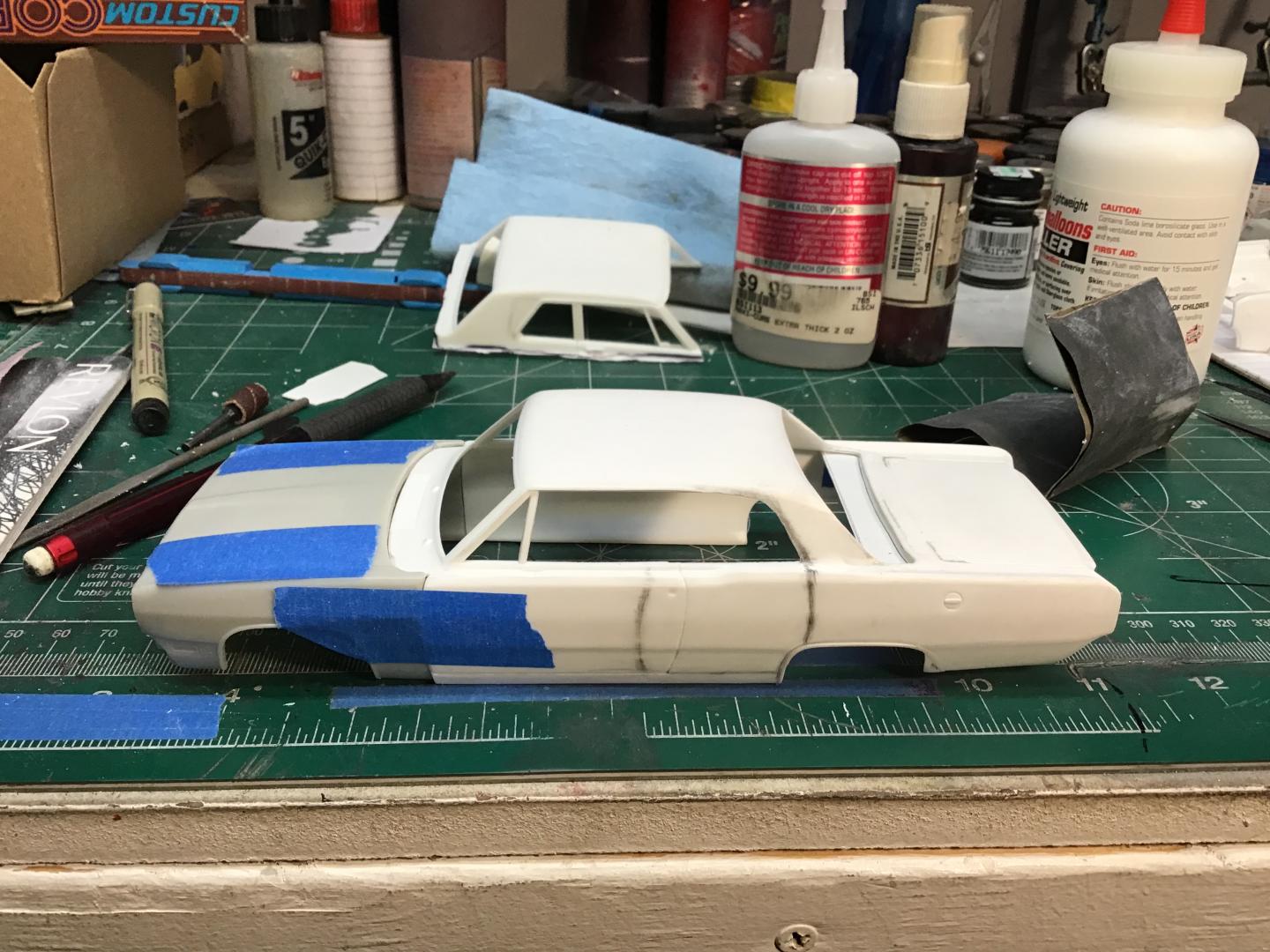

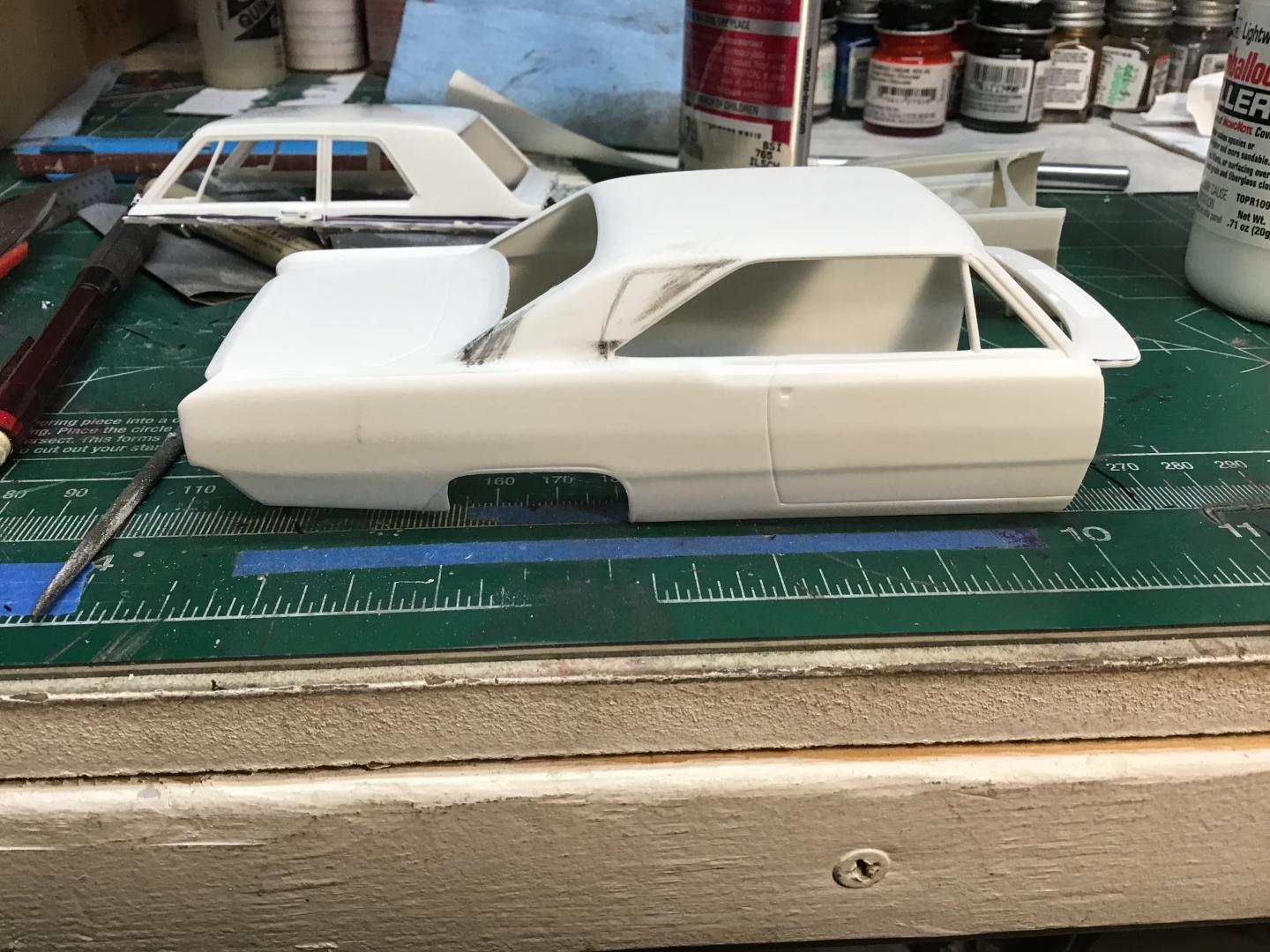

dragmodels44 Posted January 7, 2019 Author Posted January 7, 2019 Well, here’s the first steps of progress... The clips are separated and the 340 F/E is up against the 68 Dart body. I did some pencil markings... Not to bad

dragmodels44 Posted January 7, 2019 Author Posted January 7, 2019 Thanks for all the additional info! I made a little progress today in that I sanded the vinyl top and the top moldings off. More to come...
Superbird McMonte Posted January 7, 2019 Posted January 7, 2019 (edited) Looks good so far. Just double check the trailing edge of the front door. I think it should be curved opposite the way you pencilled it on. Edited January 7, 2019 by Superbird McMonte
dragmodels44 Posted January 7, 2019 Author Posted January 7, 2019 You’re absolutely right, thanks! I’m thinking about what Bill said bout using the roof from the Dodge 330...

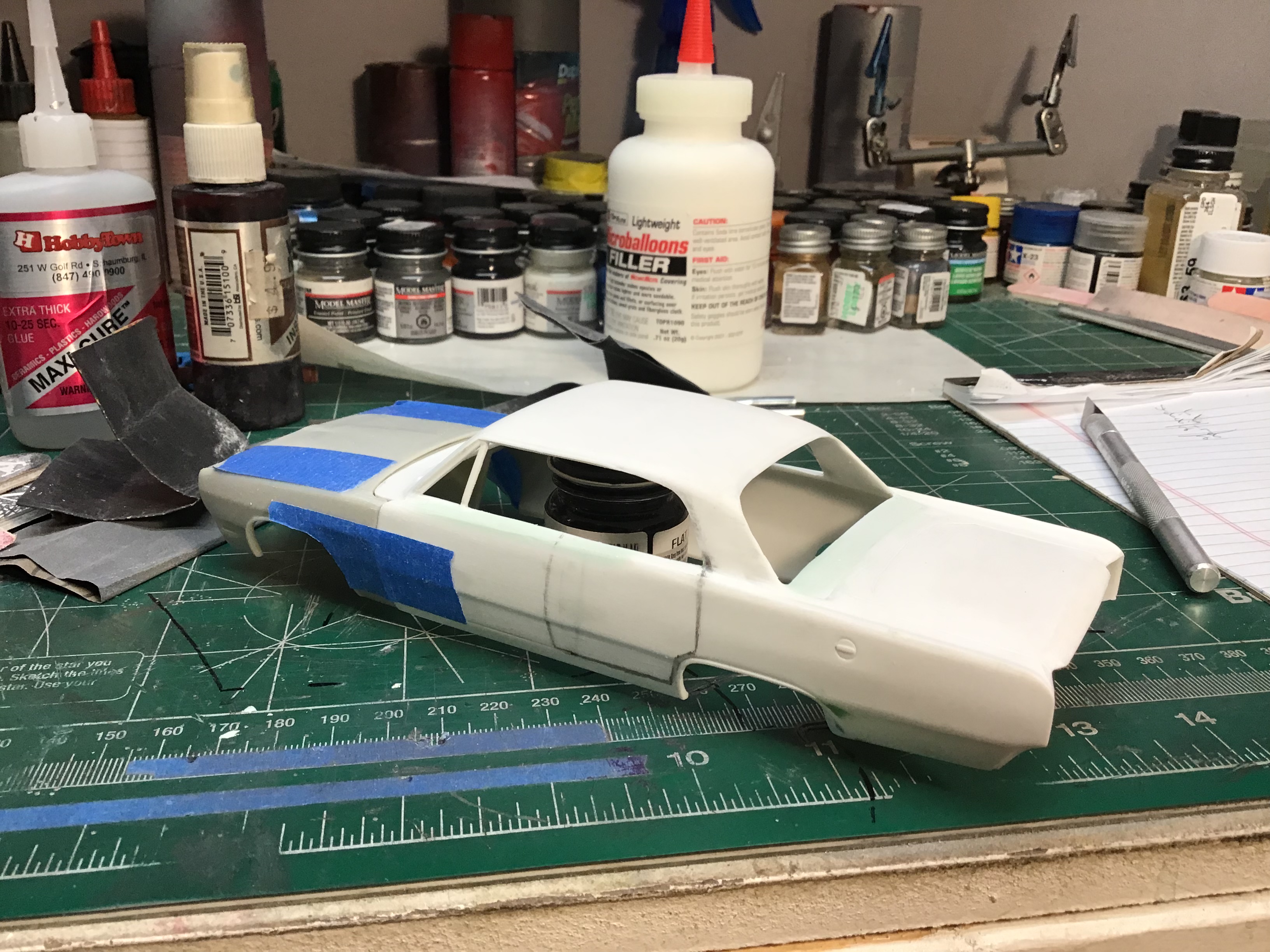

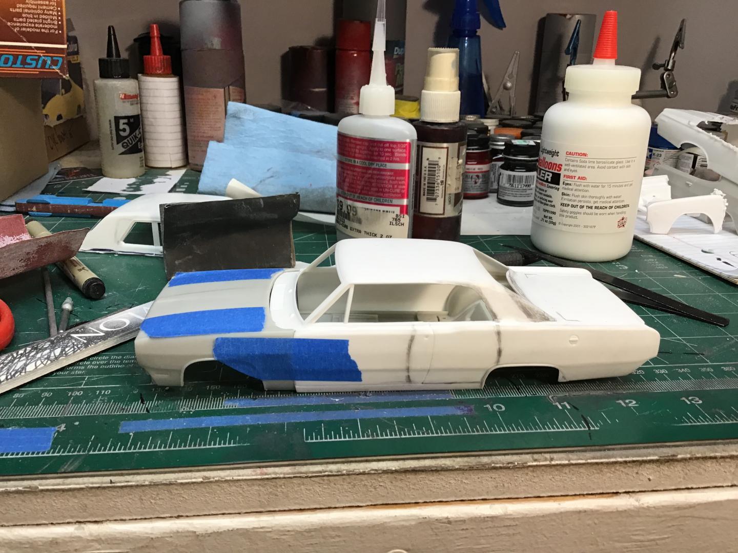

dragmodels44 Posted January 8, 2019 Author Posted January 8, 2019 I started reshaping the rear wheelwells and I cut the roof off of the 330. This is definitely a project! Again, thanks for all the help & info. Any comments welcome!

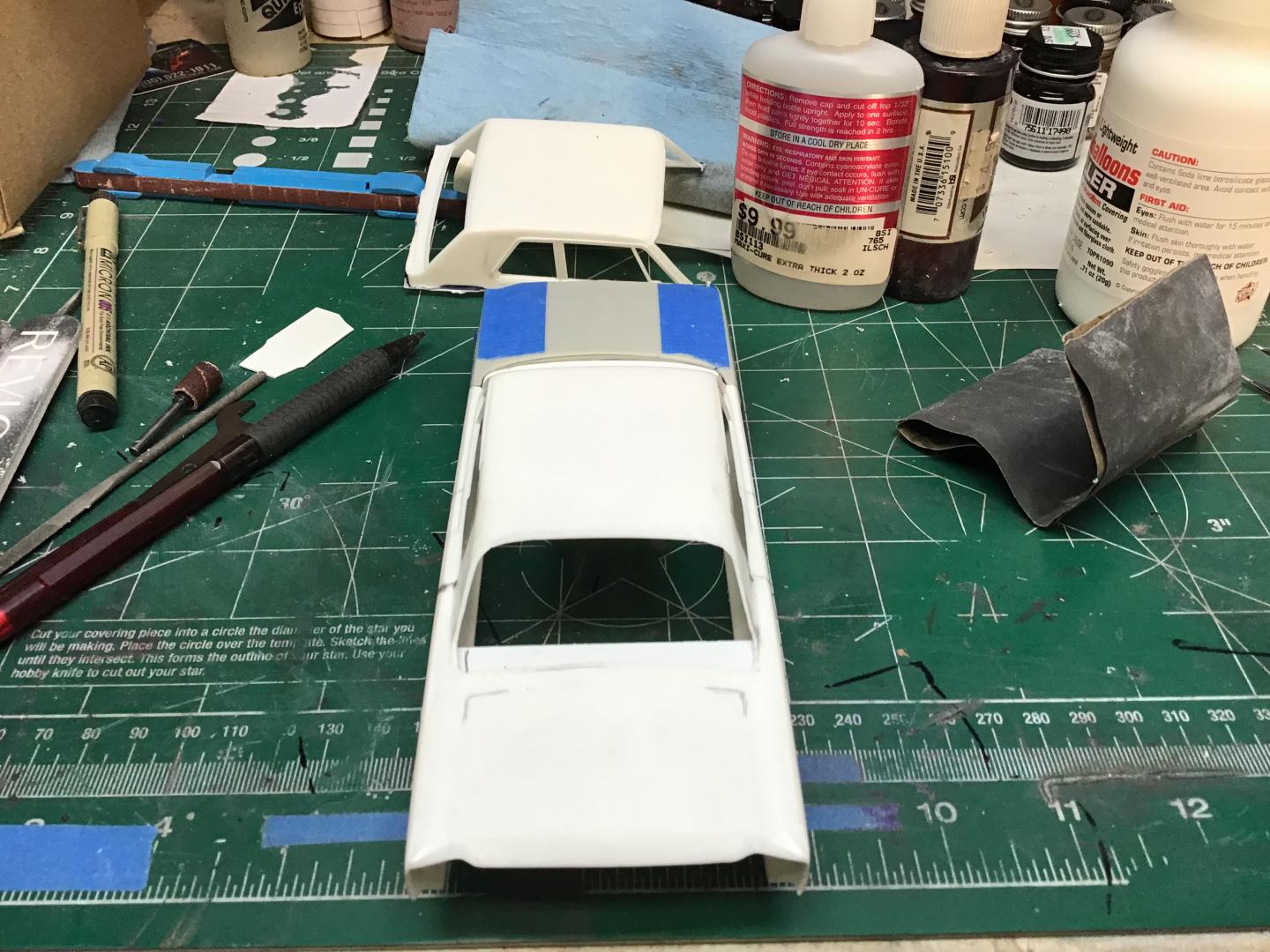

dragmodels44 Posted January 9, 2019 Author Posted January 9, 2019 Well, I made a little more progress. I opened up the area for the rear windows and removed material from the back of the roof. I then flattened out the area at the bottom of the roof by the trunk and made a filler piece. I’m not unhappy but I keep thinking the height of the roof is not tall enough for a sedan... anyway here’s more pics. Thanks for looking!
dragmodels44 Posted January 9, 2019 Author Posted January 9, 2019 Here’s the filler panel in and smoothed in with glaring putty. I also filled in the gap by the top of the doors. I feel like its starting to look better. Thanks for looking.
dragmodels44 Posted January 10, 2019 Author Posted January 10, 2019 Here’s an after shot of the roofline opened up. It looks better I think. I wanted to try this before completely separating the roof.

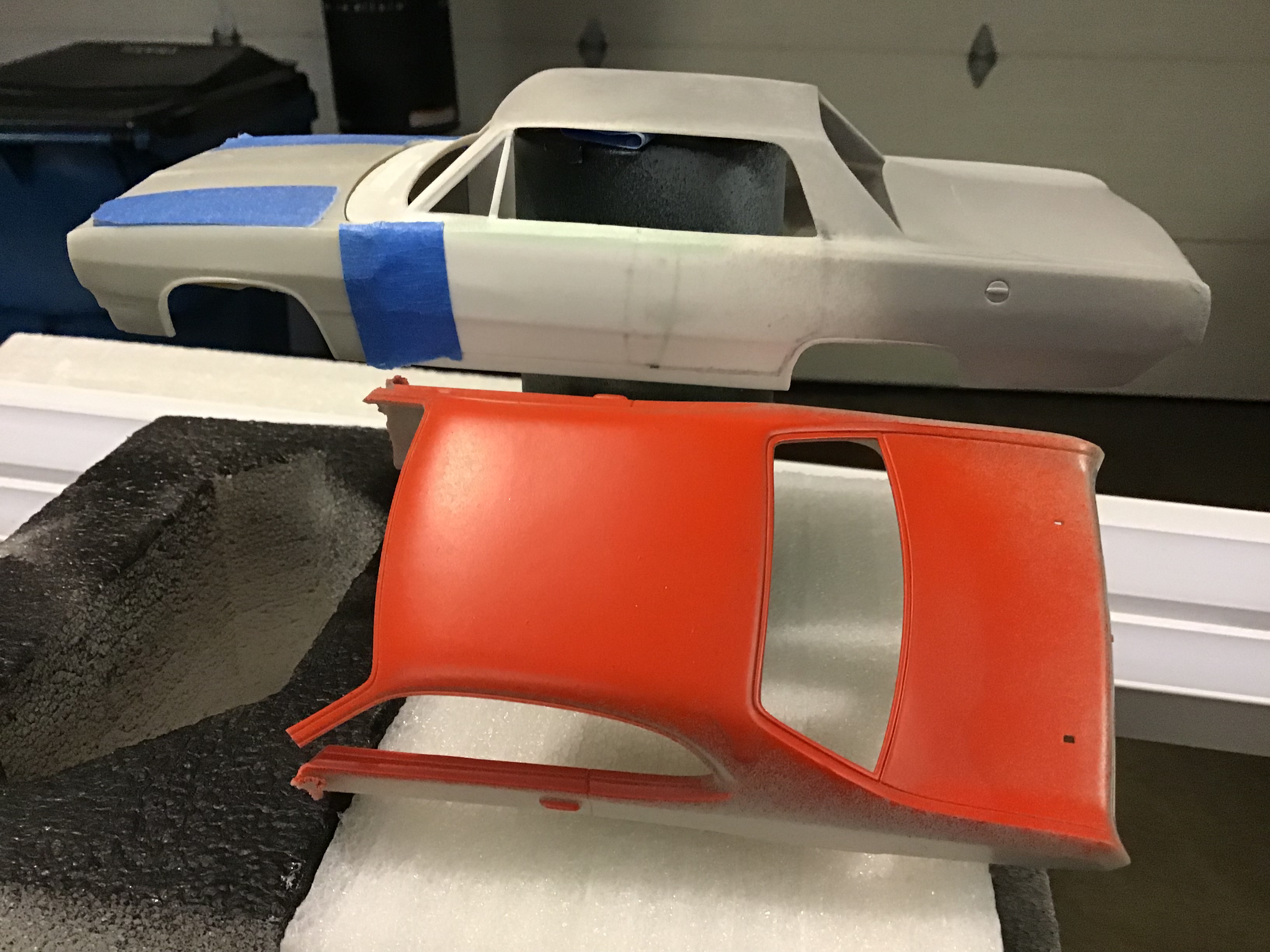

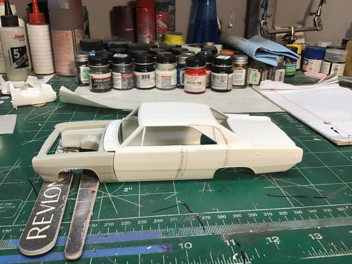

dragmodels44 Posted January 12, 2019 Author Posted January 12, 2019 Here’s some updates on the body and a test coat of the color.

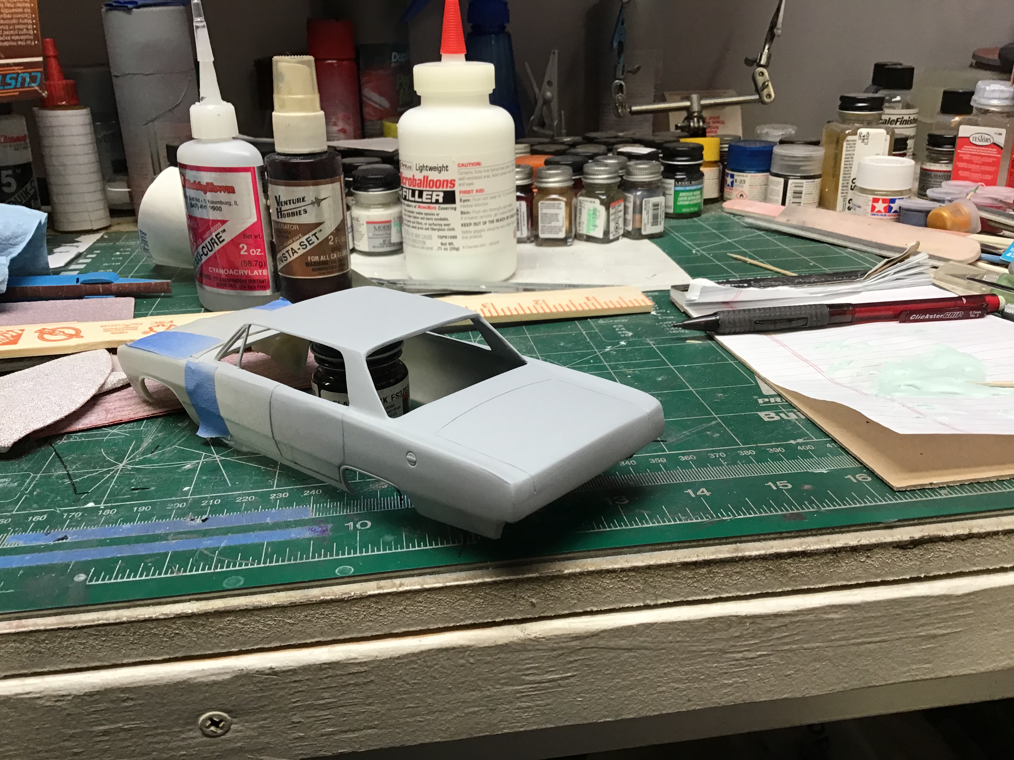

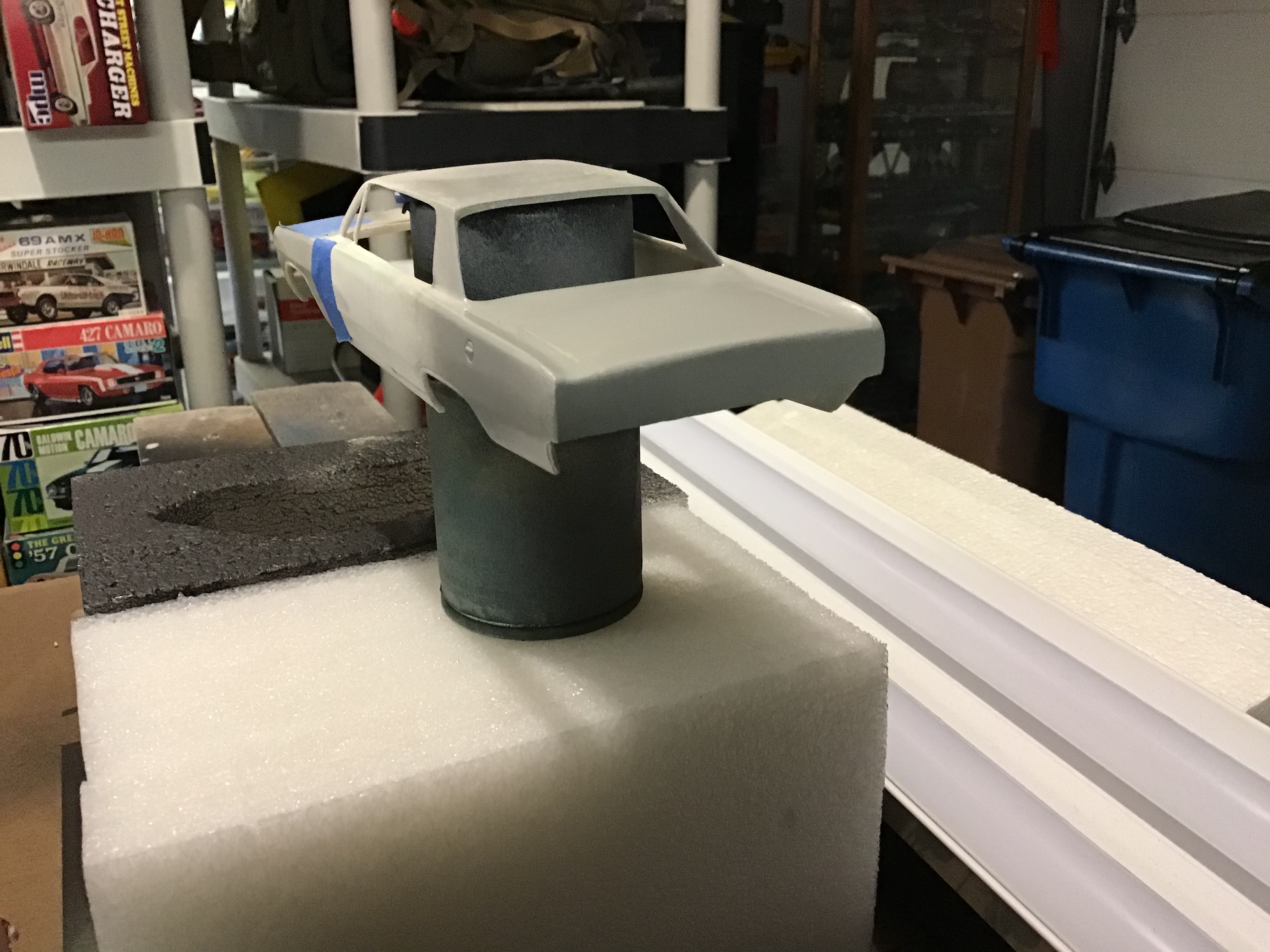

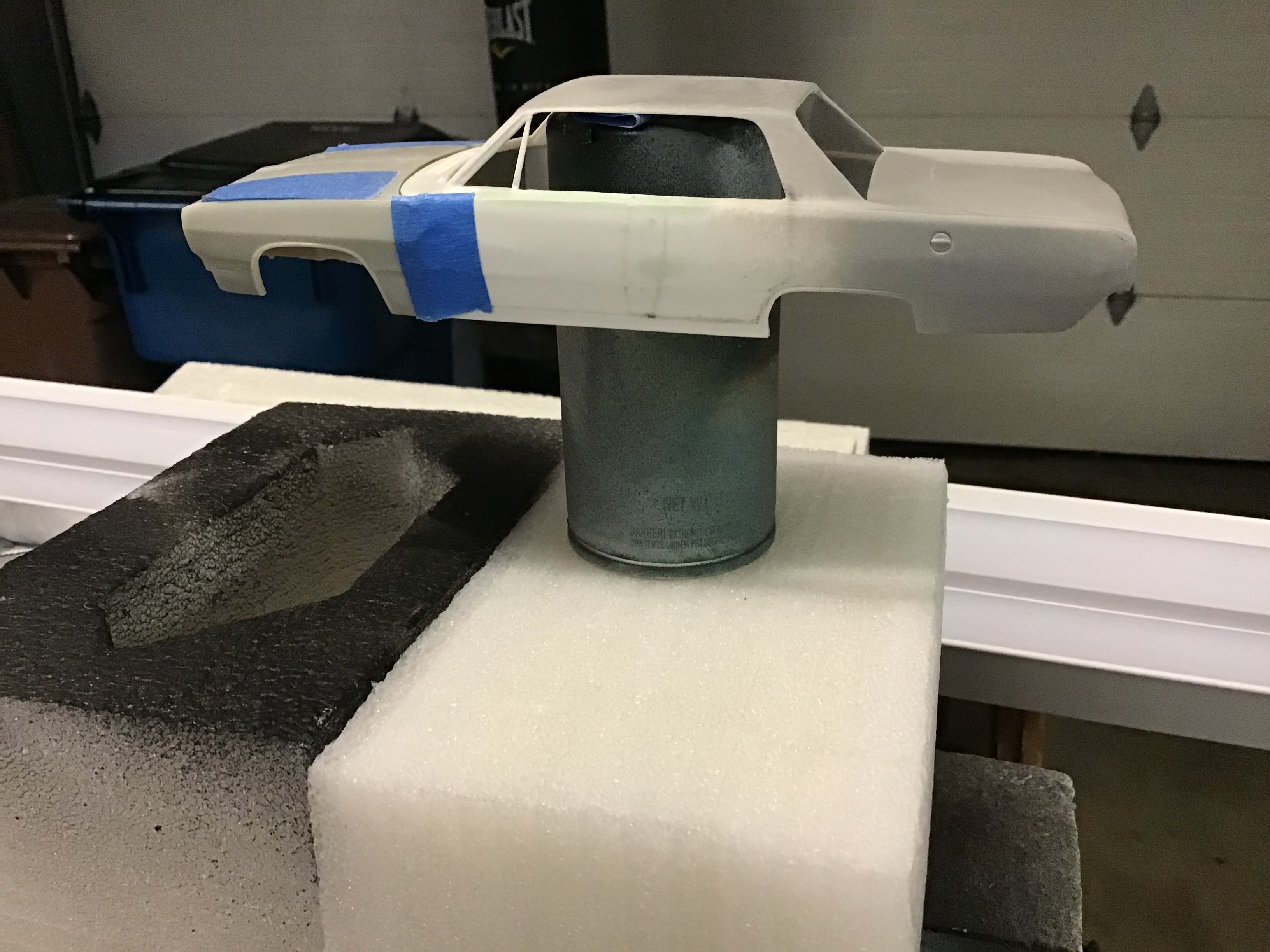

dragmodels44 Posted January 13, 2019 Author Posted January 13, 2019 Well, I’ve been working on this all weekend. Here’s the update on the bodywork for today. It’s progressing along well, there’s still a lot of sanding to do, but so far I’m happy with it. Just wanted to share a pic. Thanks!
