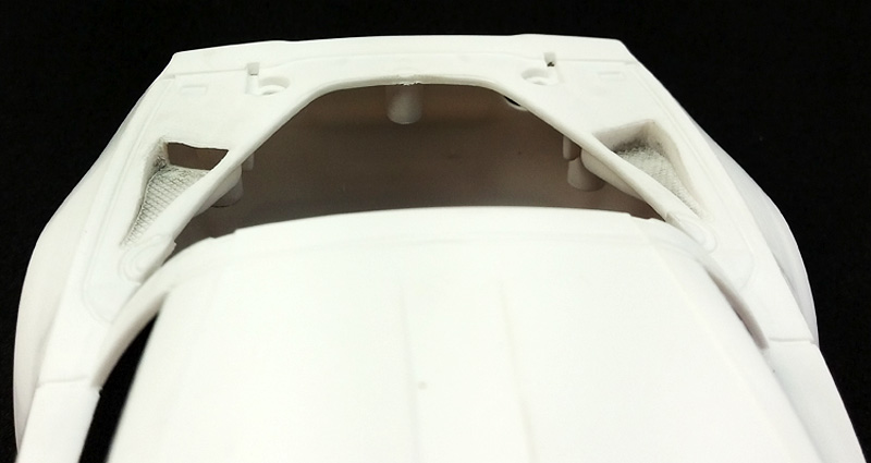

ismaelg Posted February 14, 2019 Author Posted February 14, 2019 Hello, Because of the subject I have a detailed thread active on the race car models forum. So I haven't updated this one in a while. Here is a summary of the latest updates: Looking at this car, something is bothering me. Something doesn't look right. And that is the tail lights. They are too big, too round and too low. So I'm looking at possible ways to fix it. This snap Corvette had already donated the decklid for a full detailed C6 convertible a long time ago. So I cut the rear bumper. The idea is to trim close to the taillights and somehow graft it into the GT2 body. Most likely they will be separated as 2 pieces: left and right. Measured a million times to ensure proper location. Now I need to fill the surgery scars with putty so I can smooth and blend everything together... Thanks, 1
