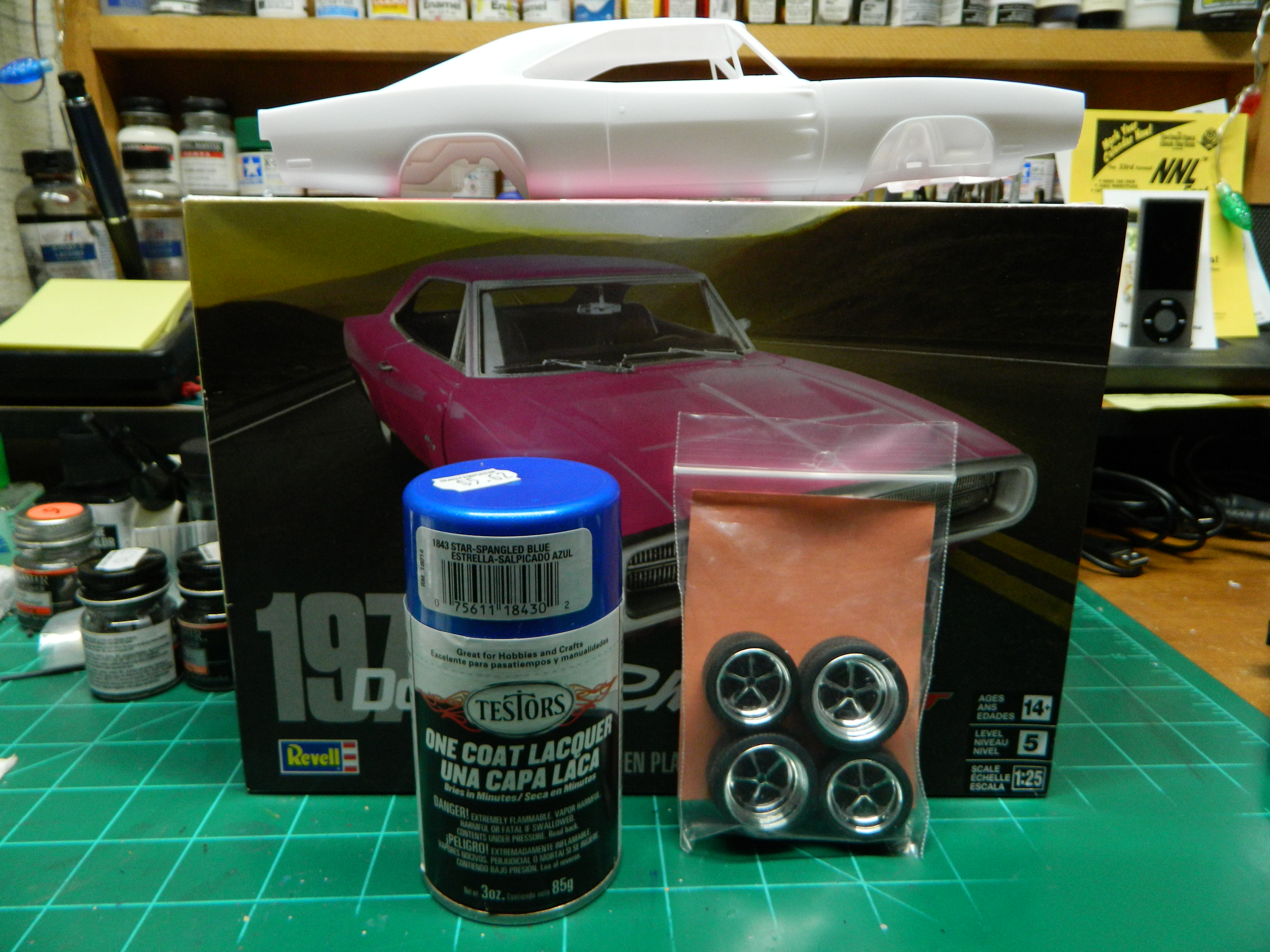

Tommy124 Posted January 9, 2019 Posted January 9, 2019 Nice kit, nice paint and nice wheels. Looking forward to see your progress!

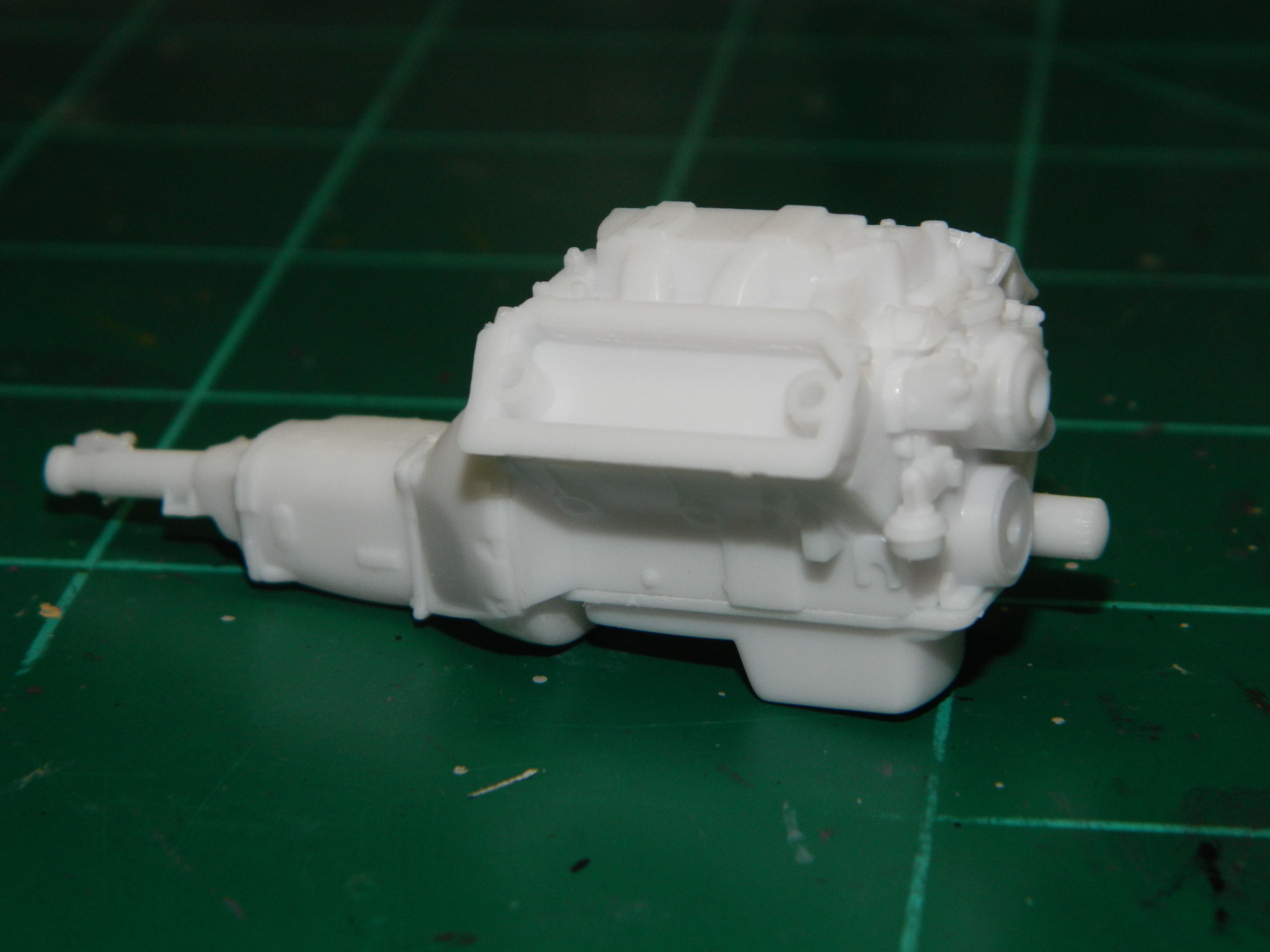

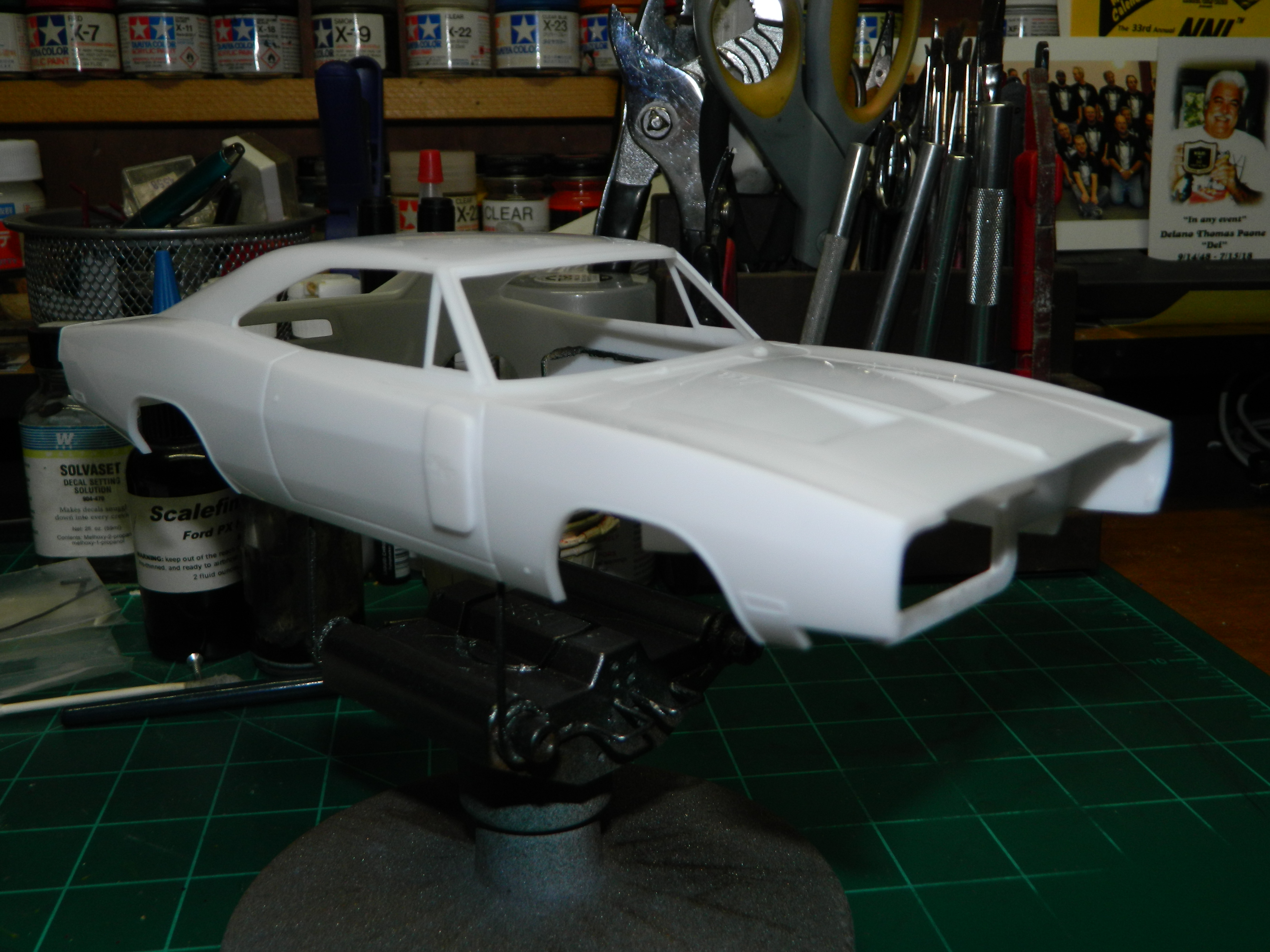

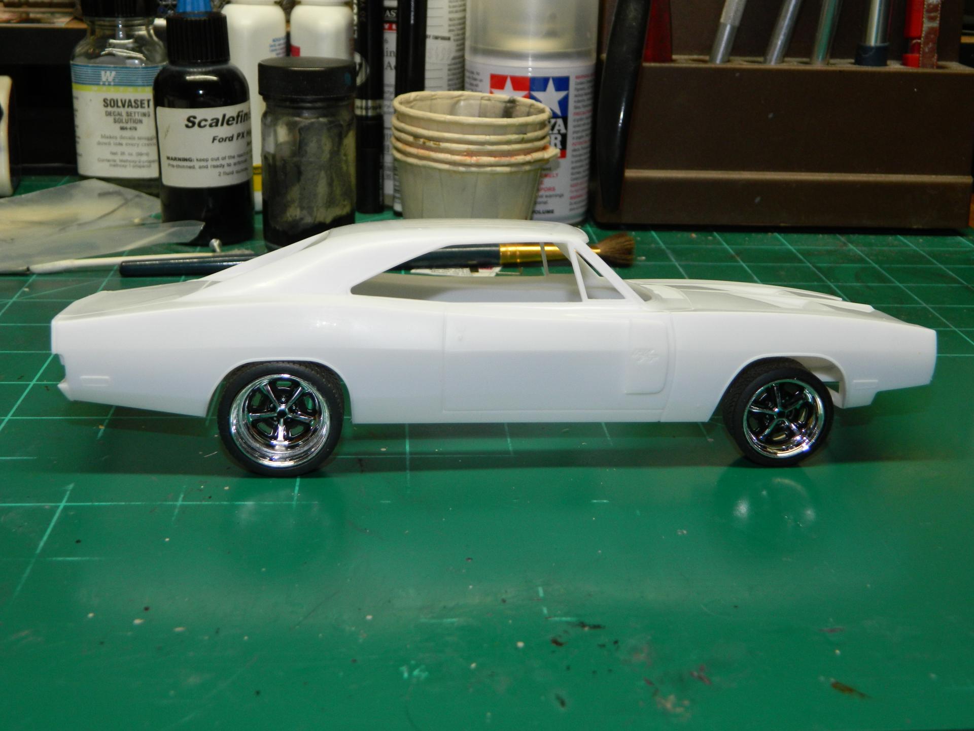

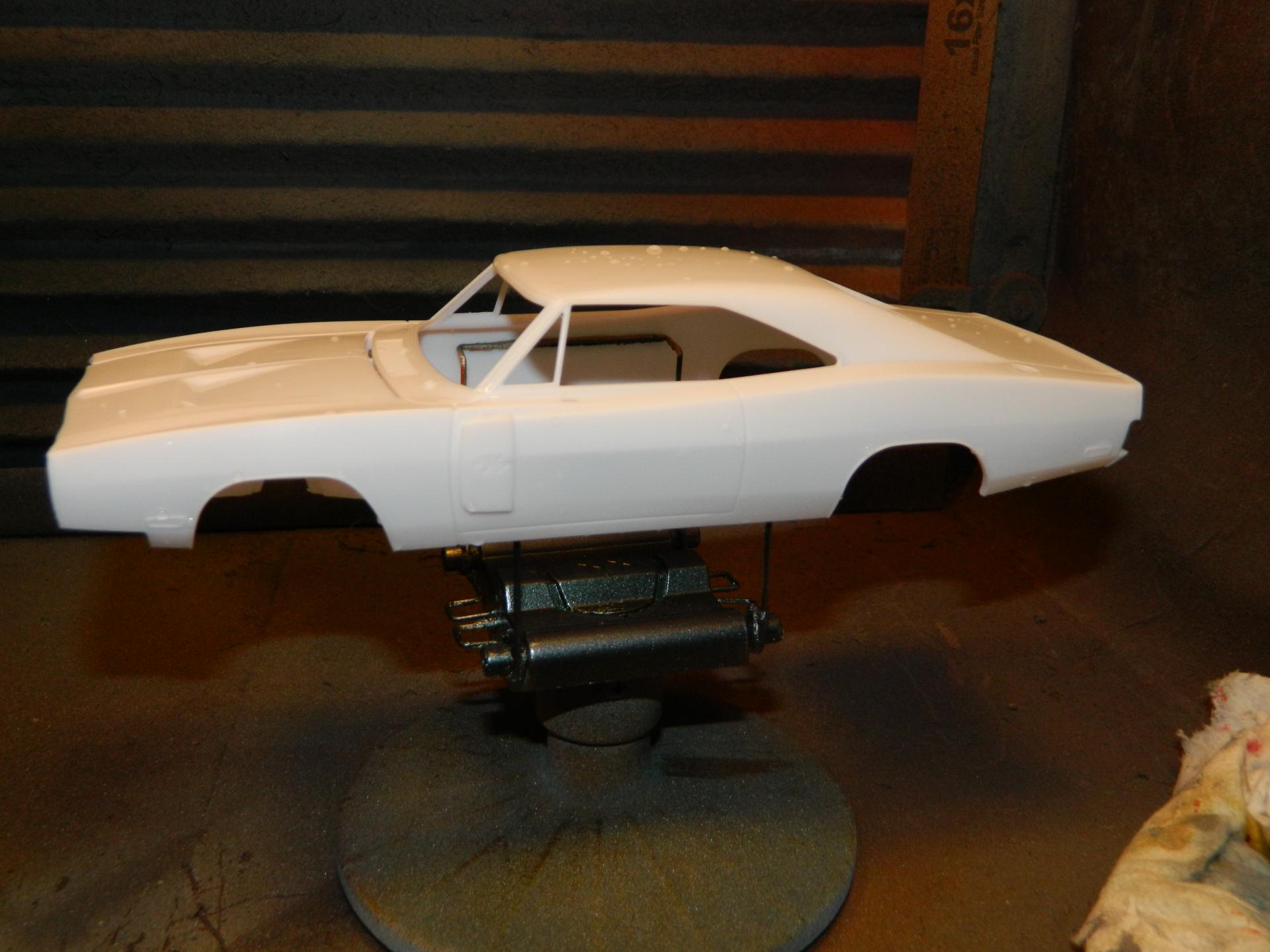

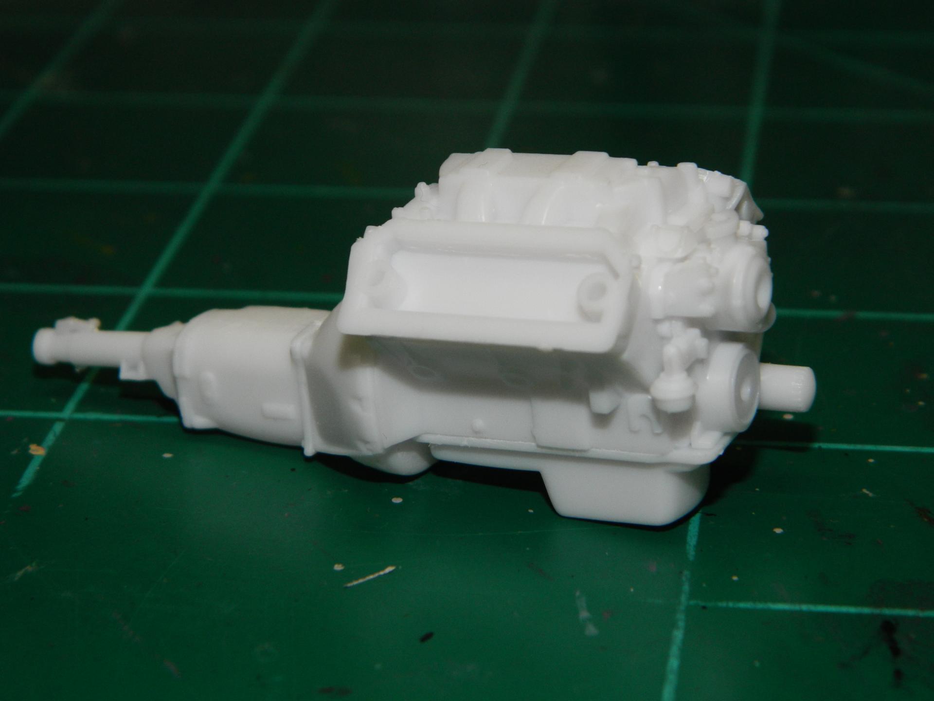

mrmike Posted January 12, 2019 Author Posted January 12, 2019 I spent some time on the Charger yesterday afternoon. I installed the door side scoops, core support, hood hinges, and added the hood. I assembled the engine and got it ready for paint. A partial mockup with the Zimmerman wheels and tires. This is going to look good! More to come...

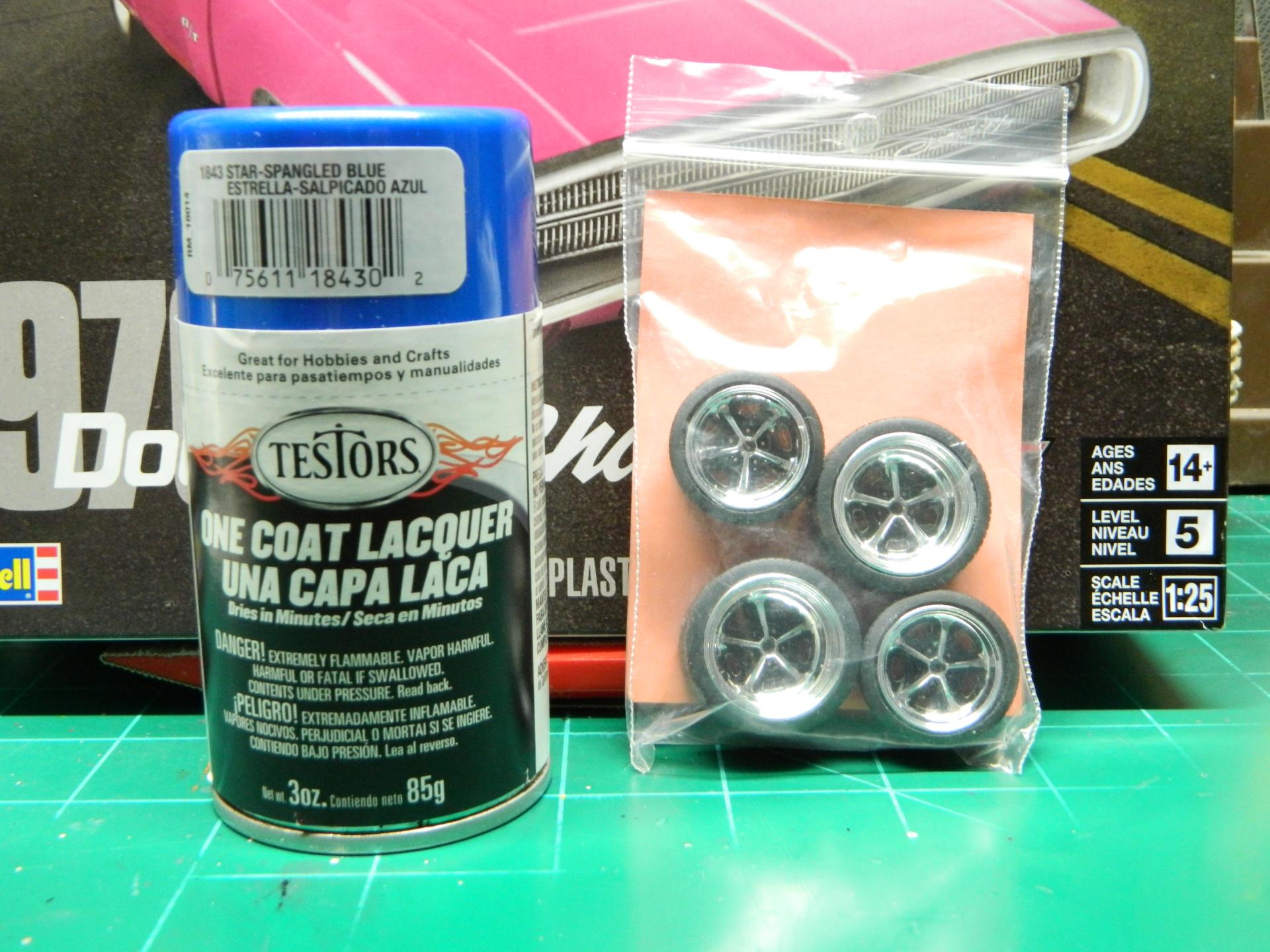

Can-Con Posted January 12, 2019 Posted January 12, 2019 I have a can of that Testors blue I got as a door prize at the last show I was at ,, I wonder how close it is to actual Mopar B-5 blue?
mrmike Posted January 13, 2019 Author Posted January 13, 2019 I don't know how close it is to B5 Blue. The car from Garage Squad (my inspiration) was painted a color called Intense Blue and this Star Spangled Blue is kind of close to that color.

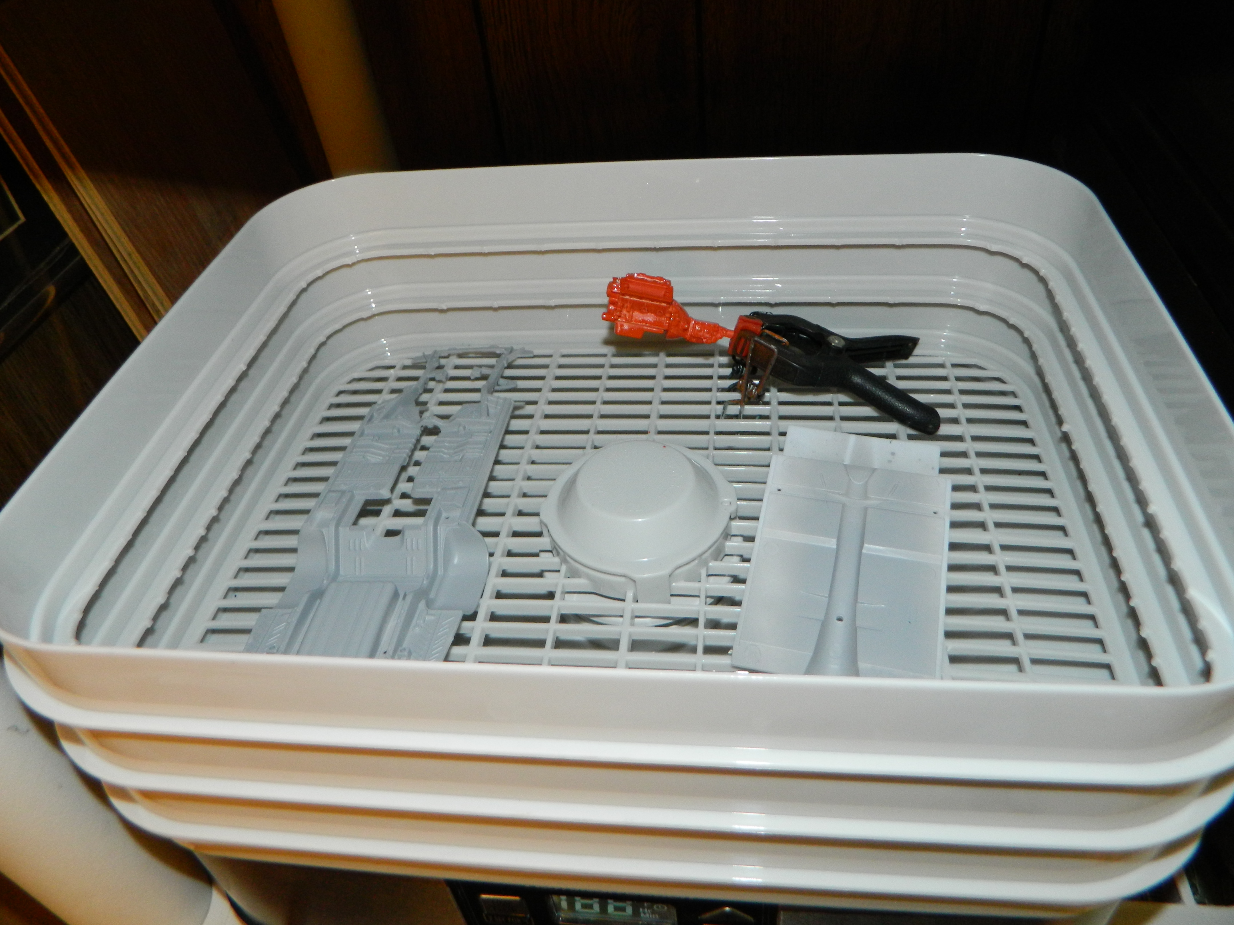

mrmike Posted January 18, 2019 Author Posted January 18, 2019 Some progress on the '70 Charger. I painted the Hemi with Mopar Street Hemi Engine Paint and the chassis and floor pan bottom got a coat of grey primer and then placed in the dehydrator for 4 hours. While those are in the dehydrator, I washed the hood and body with Dawn detergent. I painted some engine and suspension parts. More to come...
Brutalform Posted January 18, 2019 Posted January 18, 2019 That’s going to look awesome. Those are some really nice looking wheels. Perfect for this car.
mrmike Posted January 18, 2019 Author Posted January 18, 2019 Thank you Tom! Those wheels look like large Magnum 500 wheels which is why I choose them.
Geno Posted January 19, 2019 Posted January 19, 2019 That is gonna be sweet Mike, may I ask where you purchased the wheels from? Those would look great on a '69 Coronet R/T I'm building.
mrmike Posted January 20, 2019 Author Posted January 20, 2019 I bought those wheels and tires from Steven Zimmerman at the 2018 NNL East show. He does not have a web site, but he can be contacted through his Face Book page.

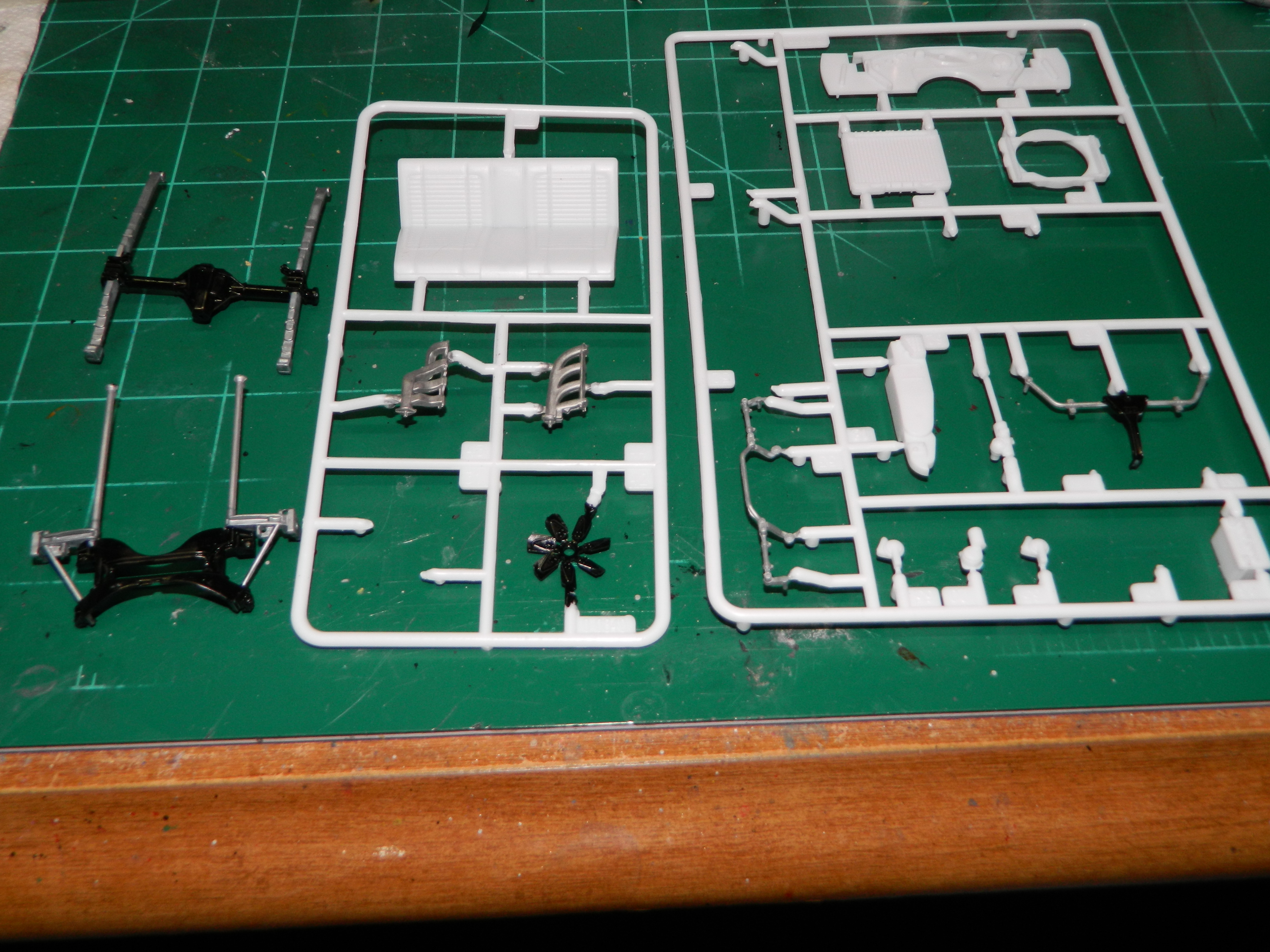

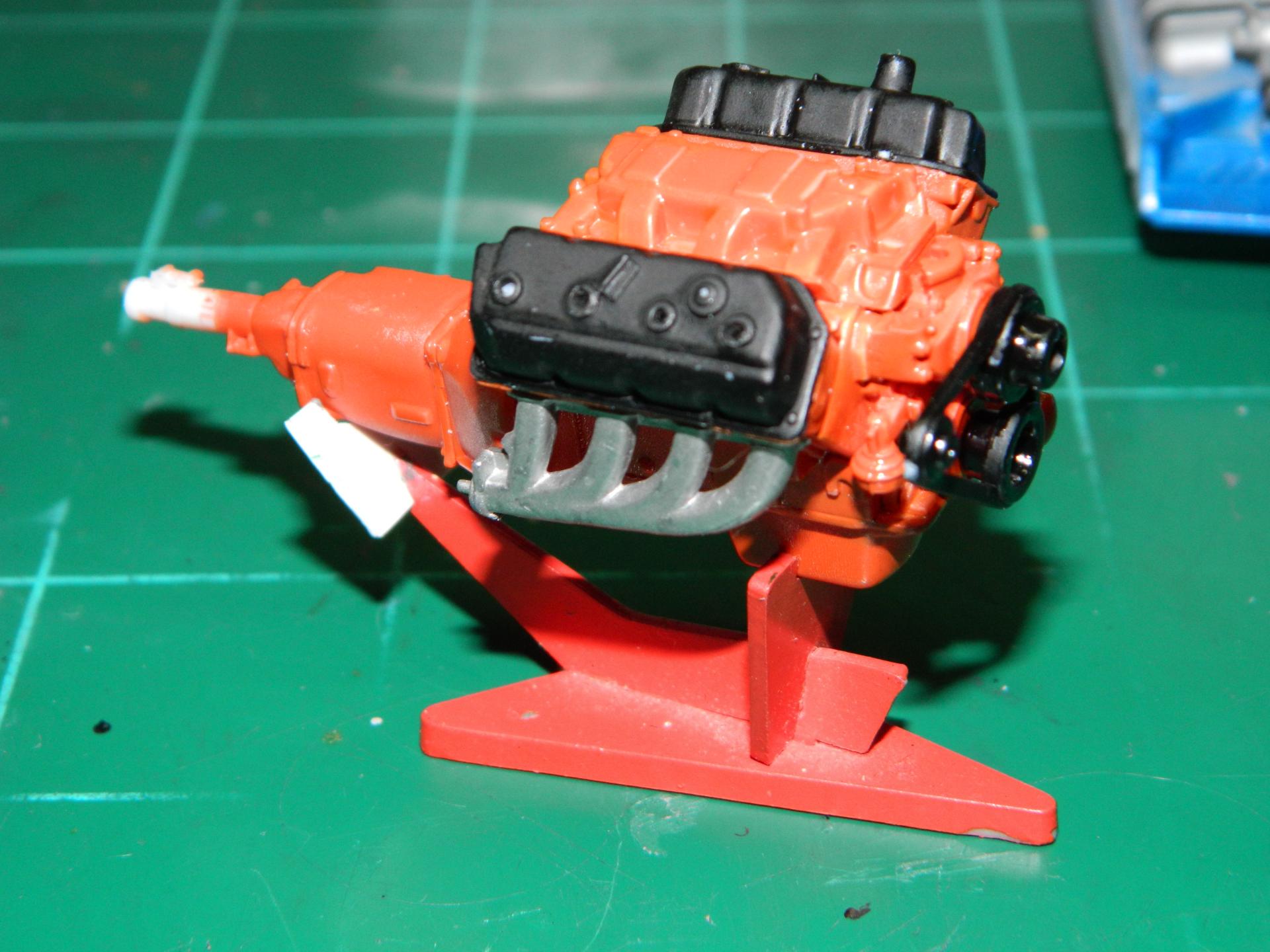

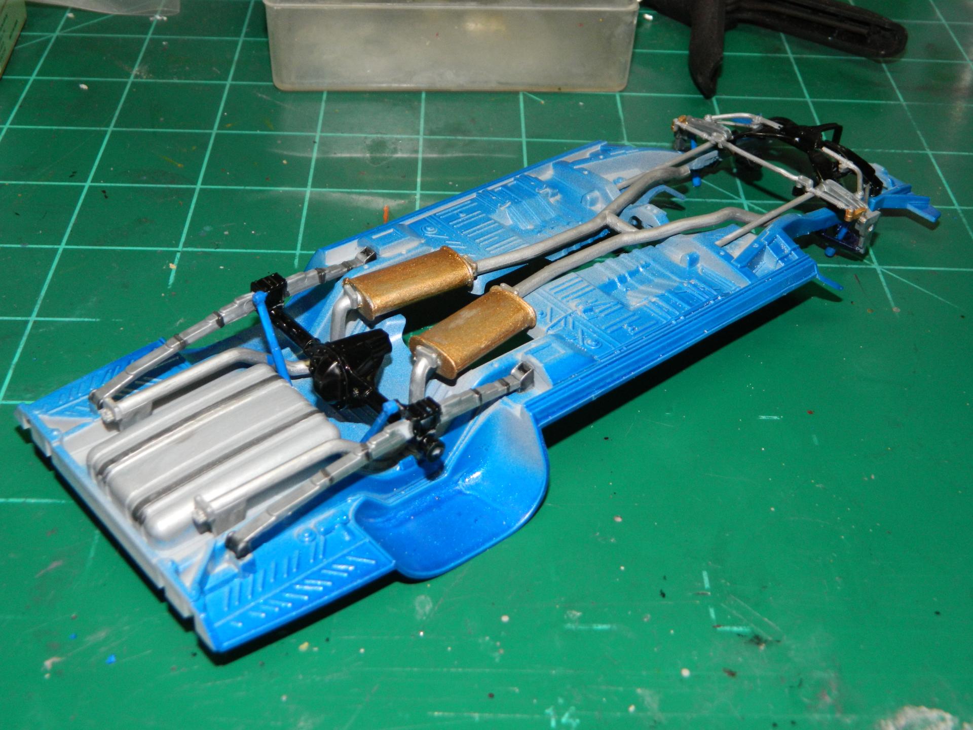

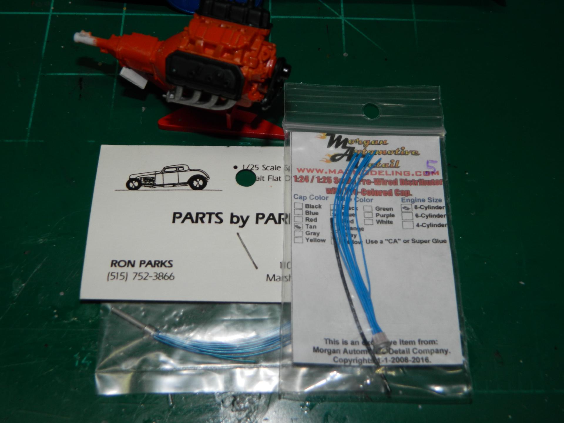

mrmike Posted January 21, 2019 Author Posted January 21, 2019 (edited) The chassis is now complete. I added overspray which has been difficult with a spray can for me and the front and rear suspensions. I'll leave the brakes and wheels and tires off until the body and chassis are together. The Hemi is in progress. The carbs, fan clutch, and the alternator are being stripped of their chrome with Easy-Off Oven Cleaner. I have distributors from Parts By Parks and Morgan Automotive Detail to decide on. Which one will it be? More to come... Edited January 21, 2019 by mrmike

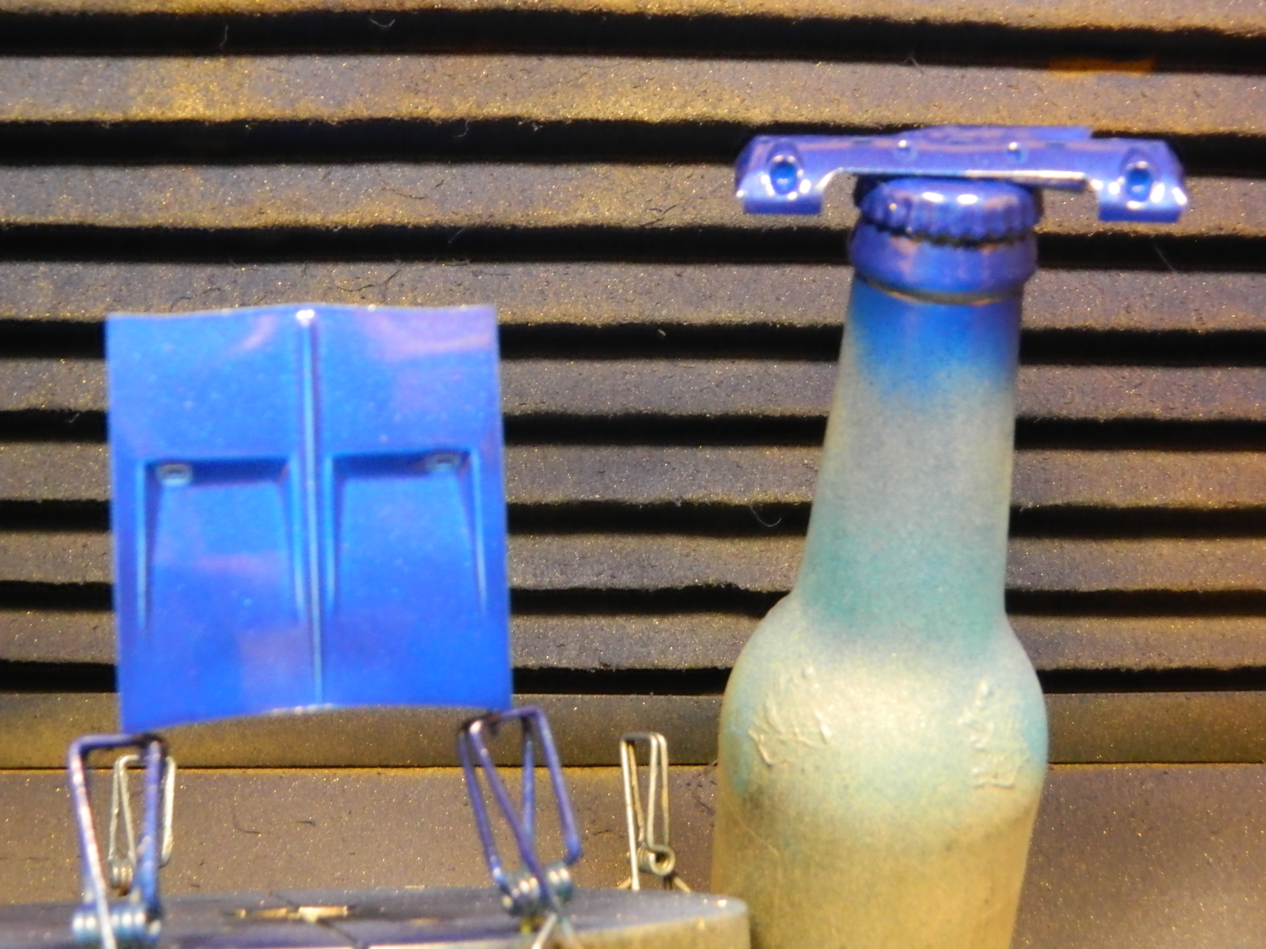

mrmike Posted January 24, 2019 Author Posted January 24, 2019 I painted the interior this afternoon with Dupli-Color Light Blue Metallic and tossed everything into the dehydrator for a few hours. Then, I painted the body, hood, and front valance panel with Testors Star Spangled Blue Lacquer. More to come...
Modlbldr Posted January 24, 2019 Posted January 24, 2019 I'm liking this one very much. The blue is a good color for this one. Looks like it has a bit of purple to it though in that light. Not what I've seen from this color before. Looking forward to your progress. I'm going to have to order a few of those MAD distributors. Those are what I have been looking for. Someone used to sell the caps with holes for the wires but no wires. Been looking for those again but the ones from MAD look good. Later-

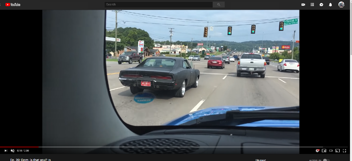

Olskoolrodder Posted January 25, 2019 Posted January 25, 2019 (edited) Looking good, Mike, loving the color choice I have this kit inmy stash as well, I bought it to eventually build something like the one in this pic (this is a screen shot from one of my Youtube videos from last year, the car was local that day--I haven't seen it since--and I saw it while making a 4 wheeled run in the FJ to the bike dealer where I'd just traded for the bike that's in my avatar pic), I think it'd make a fun build I've been away from the bench for too long, seeing your recent posts (and our short chat) on FB has made me itch to get back to build something Glad to see you're doing well, ol friend! Edited January 25, 2019 by Olskoolrodder
