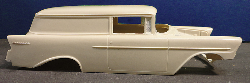

Muncie Posted January 15, 2019 Posted January 15, 2019 Casey, - great answer, my first car was a 1956 Chevrolet two-ten 2-door wagon and I agree with everything. Mike, great project. The tailgate on the regular wagons was more vertical than the Nomad. It is a difficult shape to get correct in scale. The Star model SD body looks like a duplicate of the body that Modelhaus made. Need to soften the peak on the top of the front fenders. It needs the quarter panel trim added (it's the same as the Revell DelRay) and it is a little too flat at the top of the tailgate below the rear window. I'm also thinking two door - the post in the side window is narrow - it would be wider and further forward on a four door.
Snake45 Posted January 15, 2019 Posted January 15, 2019 Almost certainly a 210 2-door wagon. The resin body you posted would probably be your best starting point. Looks like you'll need either the Revell Nomad or Del Ray kits to finish it. About 50 years ago I made a '55 Sedan Delivery out of an AMT '55 Nomad. I know today that this isn't particularly accurate, but it also wasn't particularly difficult. If you don't need to get real anal about your finished project, starting wit the Revell '56 Nomad would be the easiest and cheapest way to get a model on your shelf and not two people in 100 who see the finished model will know the difference. PS: Your brother looks more like James Dean or Dennis Hopper than Steve McQueen.

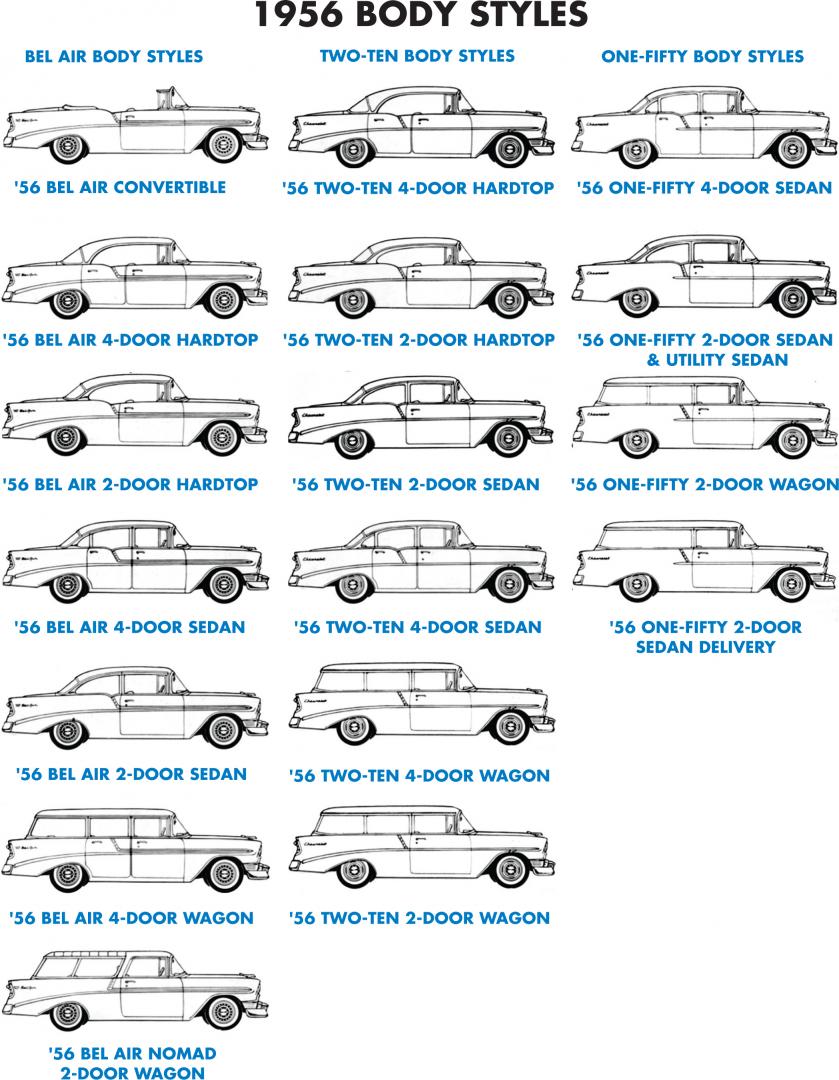

stitchdup Posted January 15, 2019 Posted January 15, 2019 Did the 2 door wagons have quarter lights in the back windows? To me that suggests a 4 door but i know very little about US cars
Snake45 Posted January 15, 2019 Posted January 15, 2019 44 minutes ago, stitchdup said: Did the 2 door wagons have quarter lights in the back windows? To me that suggests a 4 door but i know very little about US cars If by that do you mean was the rear side glass in two pieces? If so, the photo and drawing above both seem to indicate yes.

Ace-Garageguy Posted January 15, 2019 Posted January 15, 2019 Couple things... I think Casey's suggestion "The Revell '56 Del Ray Sedan would be a good starting point, as it has the correct height windshield. You could modify the Revell '56 Nomad's roof, tailgate, etc. to convert it into a wagon" is the best. The resin body pictured has a distinct downward slope to the rear of the roof that the real cars do NOT have. Revell's '57 Nomad has a similar problem. I don't have a '56 here to check.
Ace-Garageguy Posted January 15, 2019 Posted January 15, 2019 ^^^ I could only post 1/2 of my comments due to the big 404 dump, and subsequent offline for an hour. The illustration of the '56 Two-Ten 4-door wagon is incorrect, as it does not show rear doors, or the length these should be relative to the front doors (though they ARE shown on the Bel Air, and their relative lengths can be accurately scaled from same). I believe the period photo is of a two-door wagon, as the door shut-line for a rear door should be just visible on the dogleg immediately forward of the rear wheel otherwise.
Casey Posted January 16, 2019 Posted January 16, 2019 3 hours ago, Ace-Garageguy said: I believe the period photo is of a two-door wagon, as the door shut-line for a rear door should be just visible on the dogleg immediately forward of the rear wheel otherwise. Good eyes.
MrObsessive Posted January 16, 2019 Posted January 16, 2019 That's definitely a two door wagon that's pictured. As Bill said, there's no door lines ahead of the rear wheel wells and I'm seeing a slimmer pillar just behind the main front door pillar on the driver's side. If it were me building this, I'd combine the Revell '56 Del Ray along using it's roof section up to the trailing edges of the doors, then use the roof section of the AMT '55 Nomad to give me the roof length I'd need. Of course, you'd have to fill in the 'grooves' on the roof and then you'd need to fashion the C and D pillars a bit more upright and just a bit taller. You would get the correct front doors as Bill mentioned (no 'swoop' down) and the correct roof/windshield height which I'm one of those that would spot that in a heartbeat. You could use the tailgate off the Nomad, but as was said, make it more upright and get rid of its ribbing. Either which way, you've got some work cut out for you as that's one version that's never been done accurately. I wouldn't mind cobbling together a '55 two door wagon someday. Everyone wants the '55-'57 Nomads, but there's something about the simplicity of those 150/210 wagon series that in some ways are a bit more appealing.

TarheelRick Posted January 16, 2019 Posted January 16, 2019 Star Resins has a 2-dr '55 Chevy wagon. I would think if you swapped a '56 Del Ray front clip and taillights you could easily have a '56 2-dr wagon. http://www.resinrealm.net/Star/STAR Models/55_Chevy_Handiman_SW.html I got a 4-dr '55 wagon from them. It is a bit thick but a very nice body. Steve Kohler is easy to deal with, just email him to make sure the body is available.
Kayma367 Posted January 16, 2019 Posted January 16, 2019 To add to what Ricky wrote above, Star Models also has a '56 Sedan Delivery. This looks to be about 80% of where you want to be as the roof height and door placement are the same as mentioned earlier. Cut out the panels for the rear windows and finesse the trim to accurately reflect that of the 210. Use the 'Nomad kit for the chassis and running gear. I would shoot Steve an email to see if it is still available: SteveKohler@cox.net.
