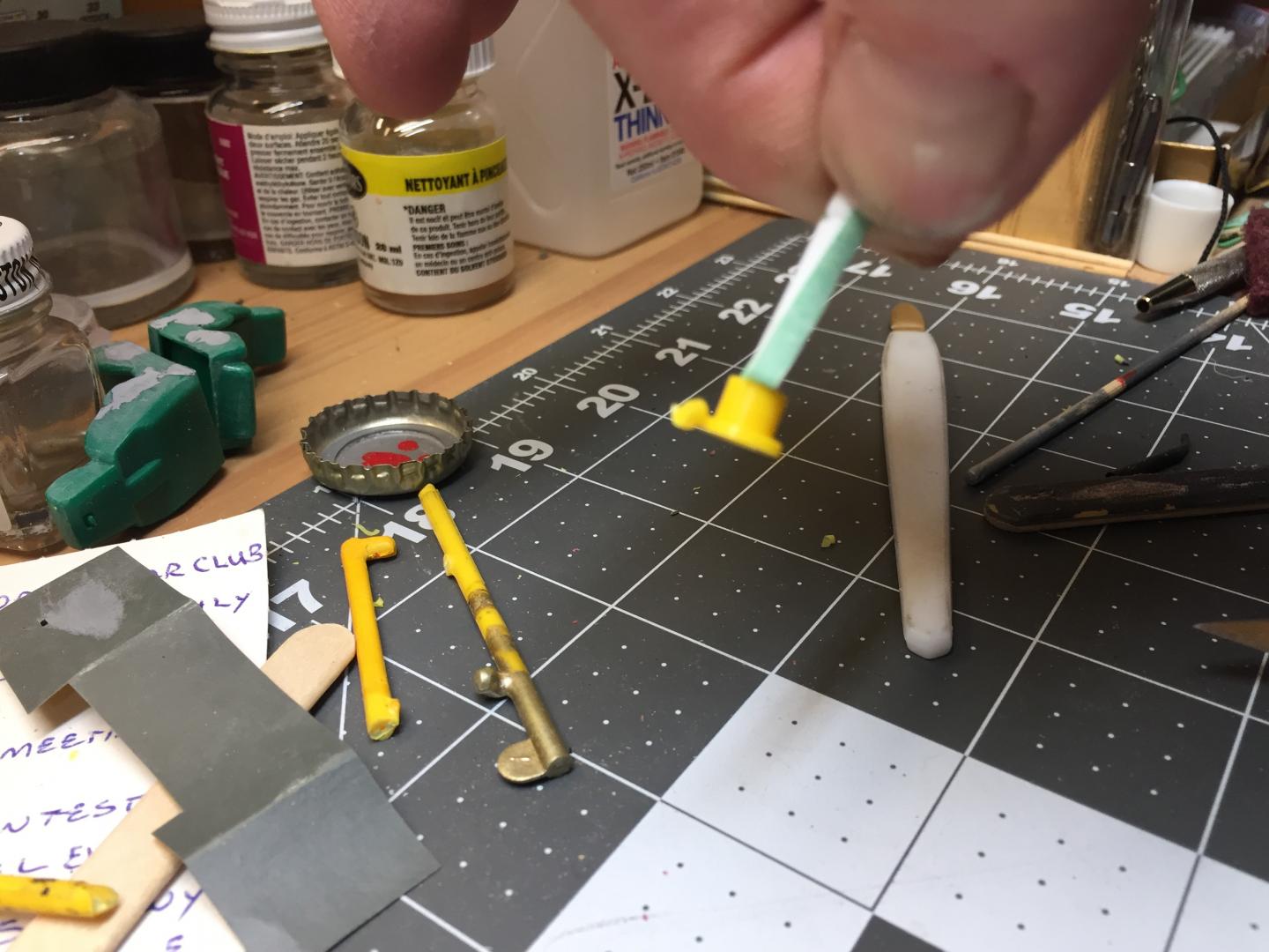

64SS350 Posted January 16, 2019 Posted January 16, 2019 I use an old detail swab tube, or could use anything similar (tube) and have a small bit of blue tack(sticky tack for posters and such) on the end. Use this for lots of small parts. You may need something handy to hold in place ( pick or scribe) to help release from blue tack, depends on how hard you press and adhersion of " glueing agent"
