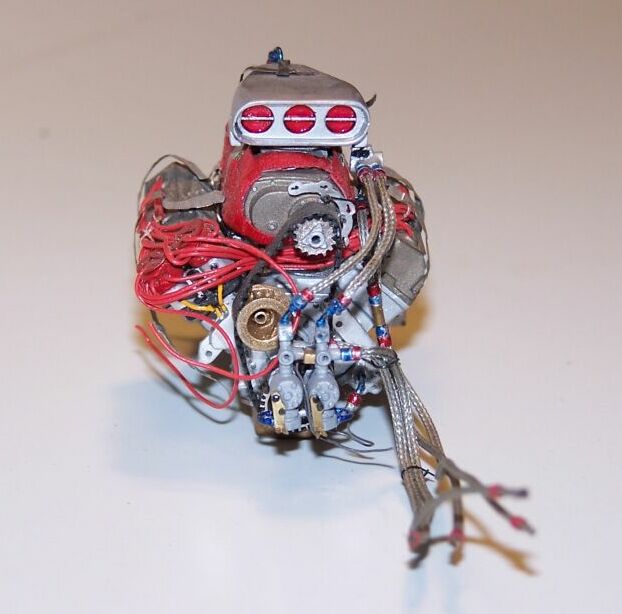

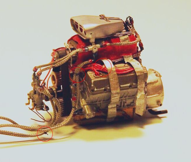

I make zip ties using monofilament fishing line. Clover House also makes (made?--are they still around?) nylon monofilament in black, in a couple of different diameters. I begin by heating one end of the line, until it softens. Then, I flatten the resulting ball between my thumb and forefinger. Then, using a needle, I poke a hole in the middle of the flattened area. All that's left is to wrap the "tie" around whatever you're binding, push the free end through the hole, snug it down, and apply a small drop of cyanoacrylate, and trim the end. In this case, I used clear for the plug wires, and black on the fuel lines. They look better in real life, than they do in my photos!

Awesome idea thanks for sharing....
You might want to consider heating the end then using the flat parts on the jaws of needle nose pliers instead of your fingers to flatten it...more consistent.
