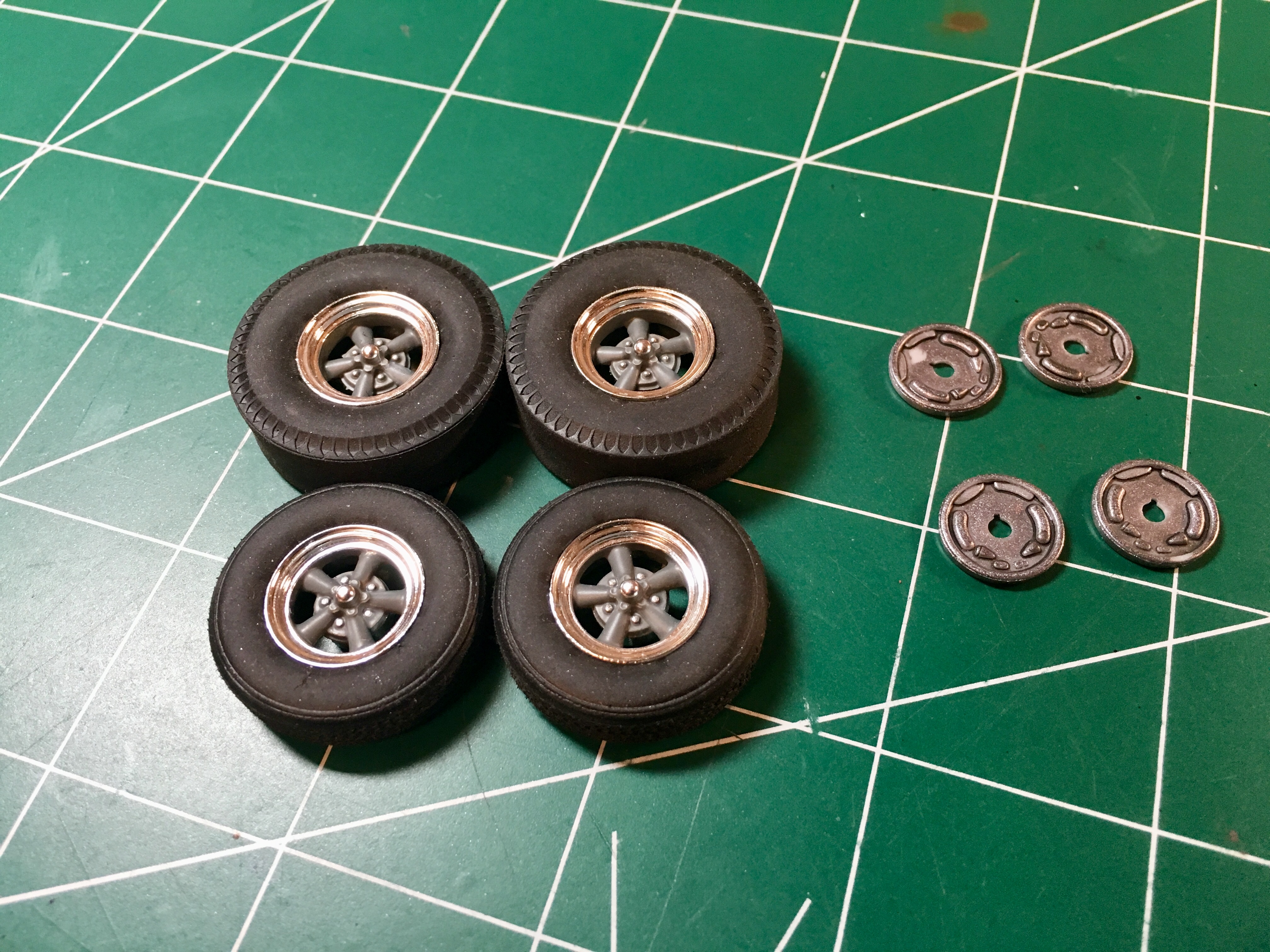

64Comet404 Posted January 24, 2019 Posted January 24, 2019 I am currently working on a Monogram '70 Buick GSX, and I'm trying to find a way to paint those recessed areas on the rims. I have considered painting the back and removing any slips with thinner, but I have already sprayed the rims with Tamiya Smoke to cut back on the shine. Any suggestions?

64Comet404 Posted January 26, 2019 Author Posted January 26, 2019 I eventually went with a modified version of JC's technique. Since I had shot the rims with a coat of Tamiya Smoke, I didn't want to risk lifting the undercoat with thinned acrylic. I went into my swap meet stash, and found a bottle of Testor's 1149 Flat Black. I gave up using Testor's as a wash years ago, because I was tired of rubbing the chrome off the parts during clean-up, but the undercoat definitely made a difference in the application. Thanks to all the people who provided suggestions for my dilemma.

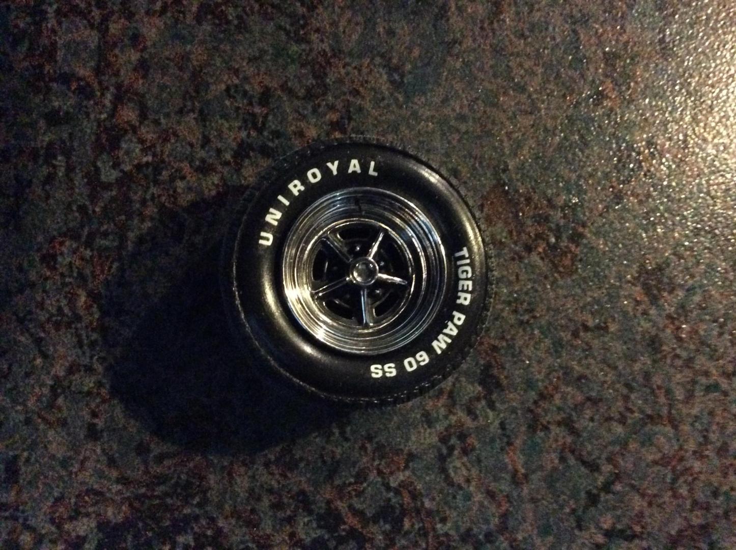

Brutalform Posted January 26, 2019 Posted January 26, 2019 I sprayed these with a flat paint, and just used a cotton swab lightly moistened with 70% alcohol. (91% will remove the chrome). Then touched up the bolts and centers with a Molotow pen.
