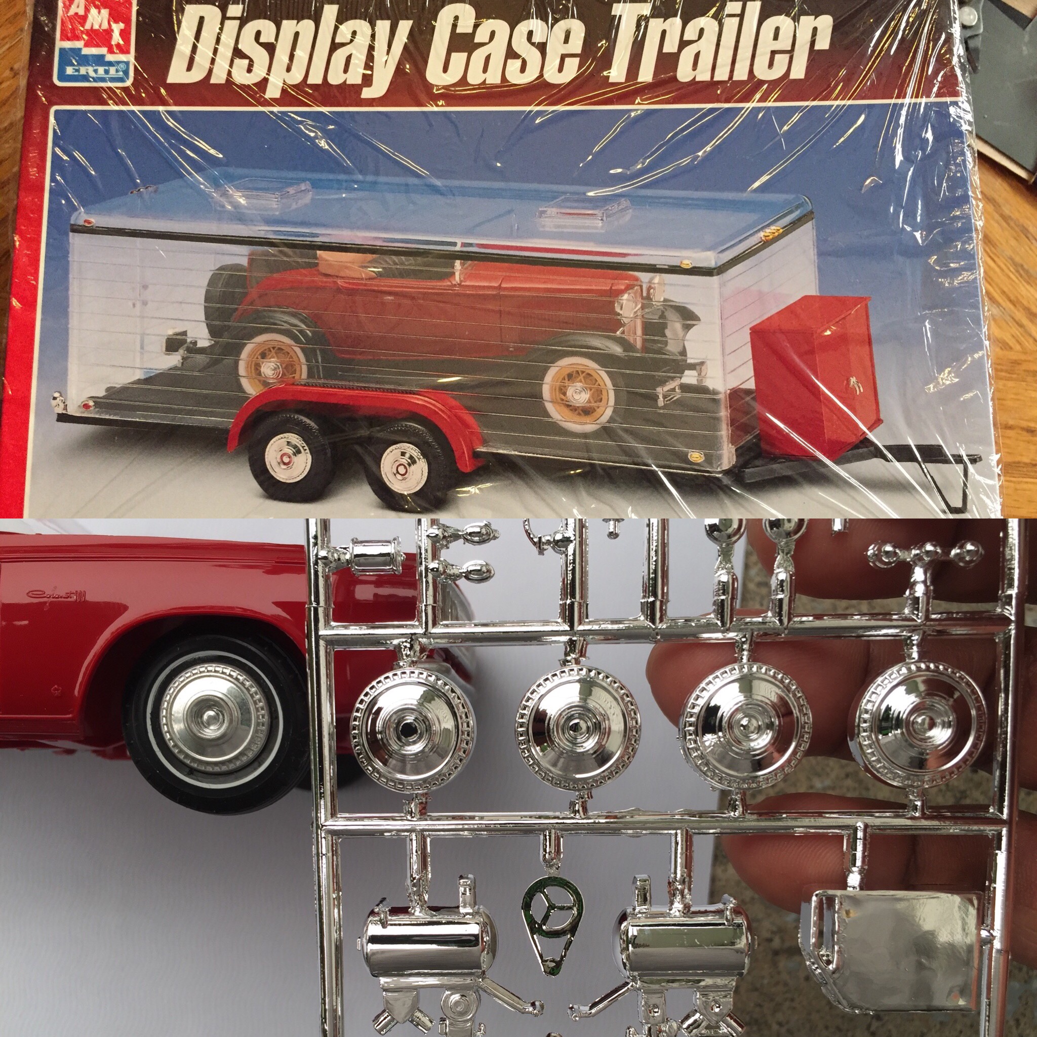

kelson Posted January 29, 2019 Posted January 29, 2019 These are the rims you need,if someone has a spare mpc trailer kit that they don't want the wheels.
br67 Posted January 31, 2019 Author Posted January 31, 2019 On 1/29/2019 at 9:35 PM, kelson said: These are the rims you need,if someone has a spare mpc trailer kit that they don't want the wheels. Thanks Curtis
