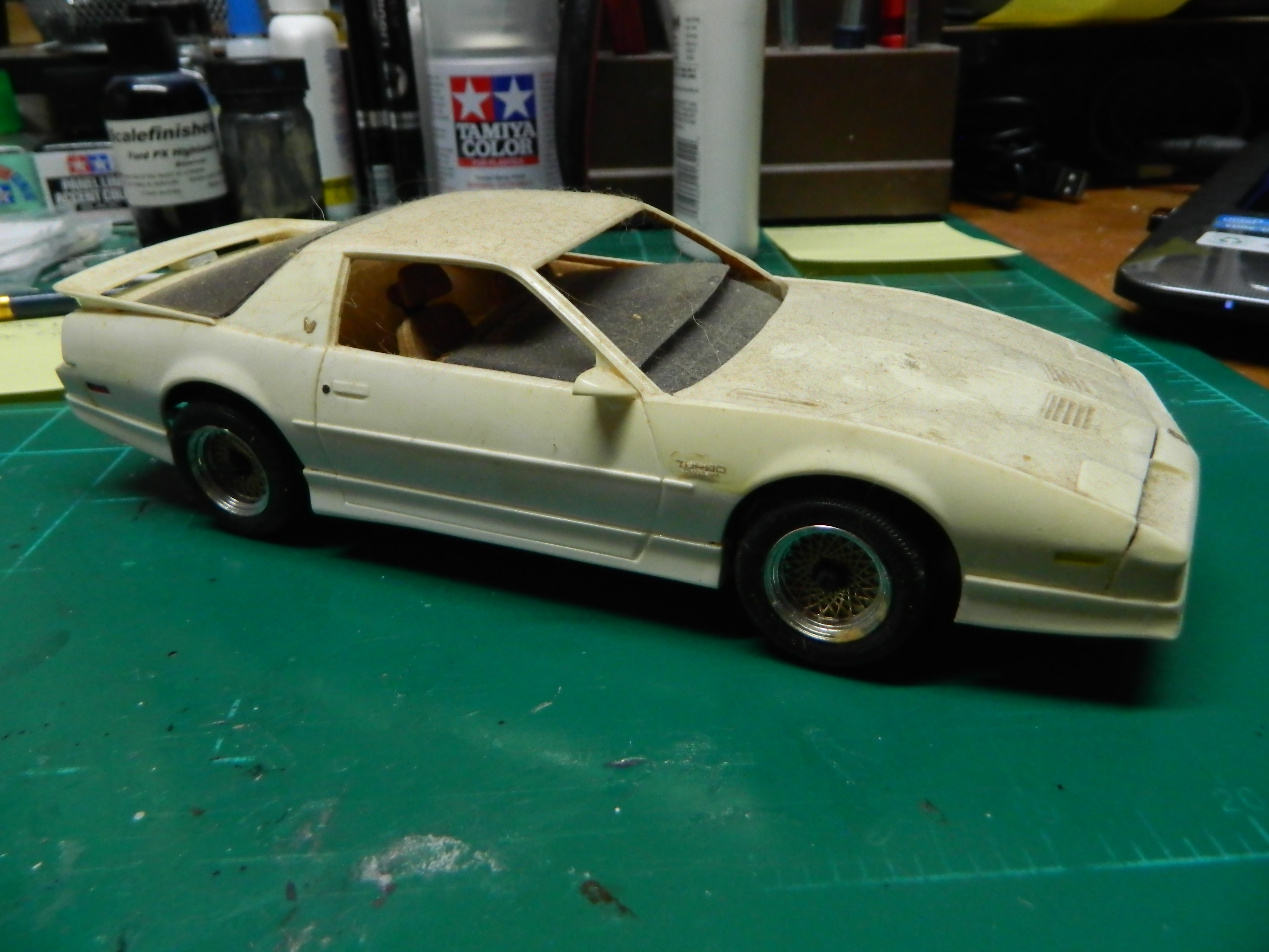

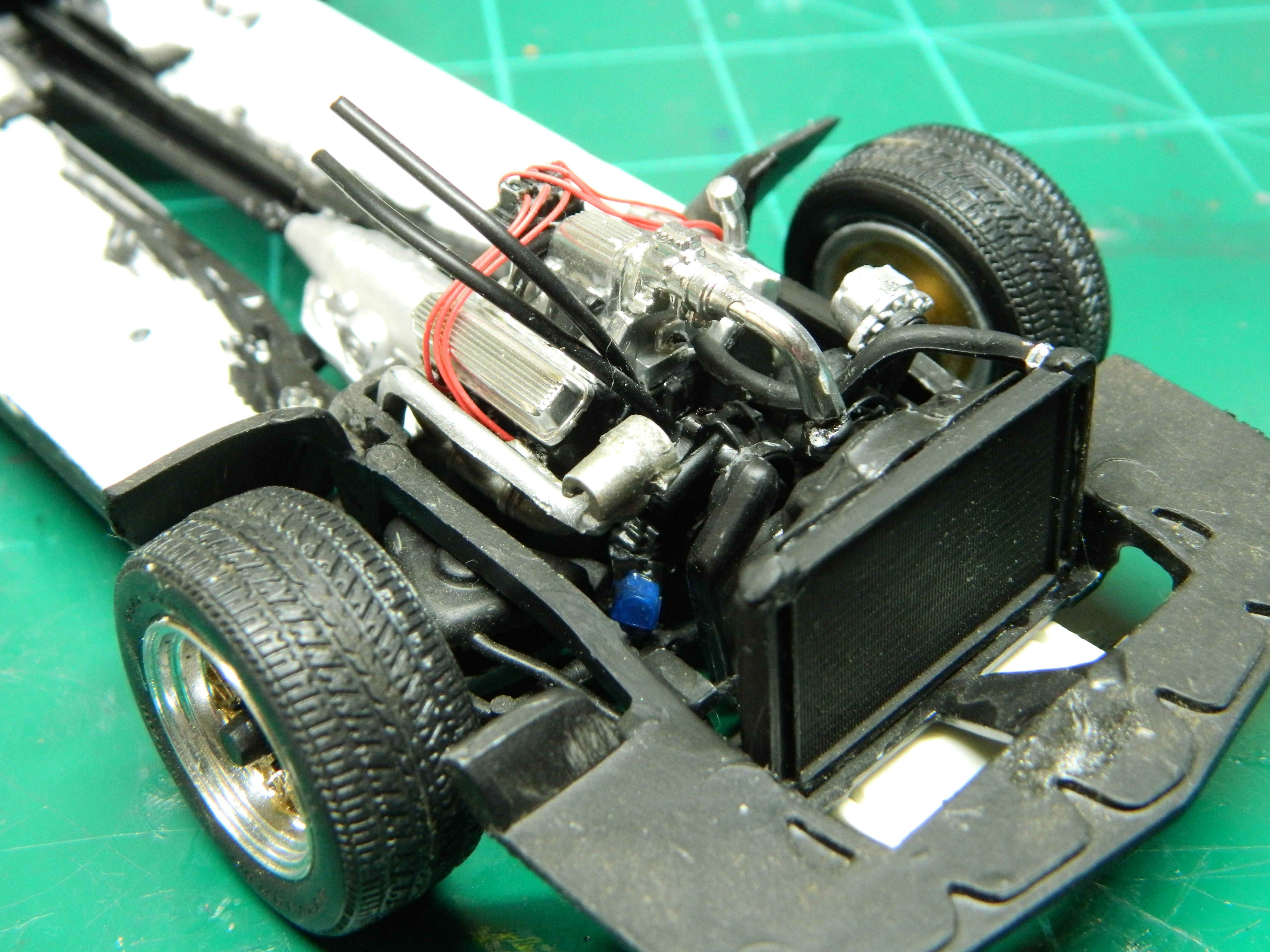

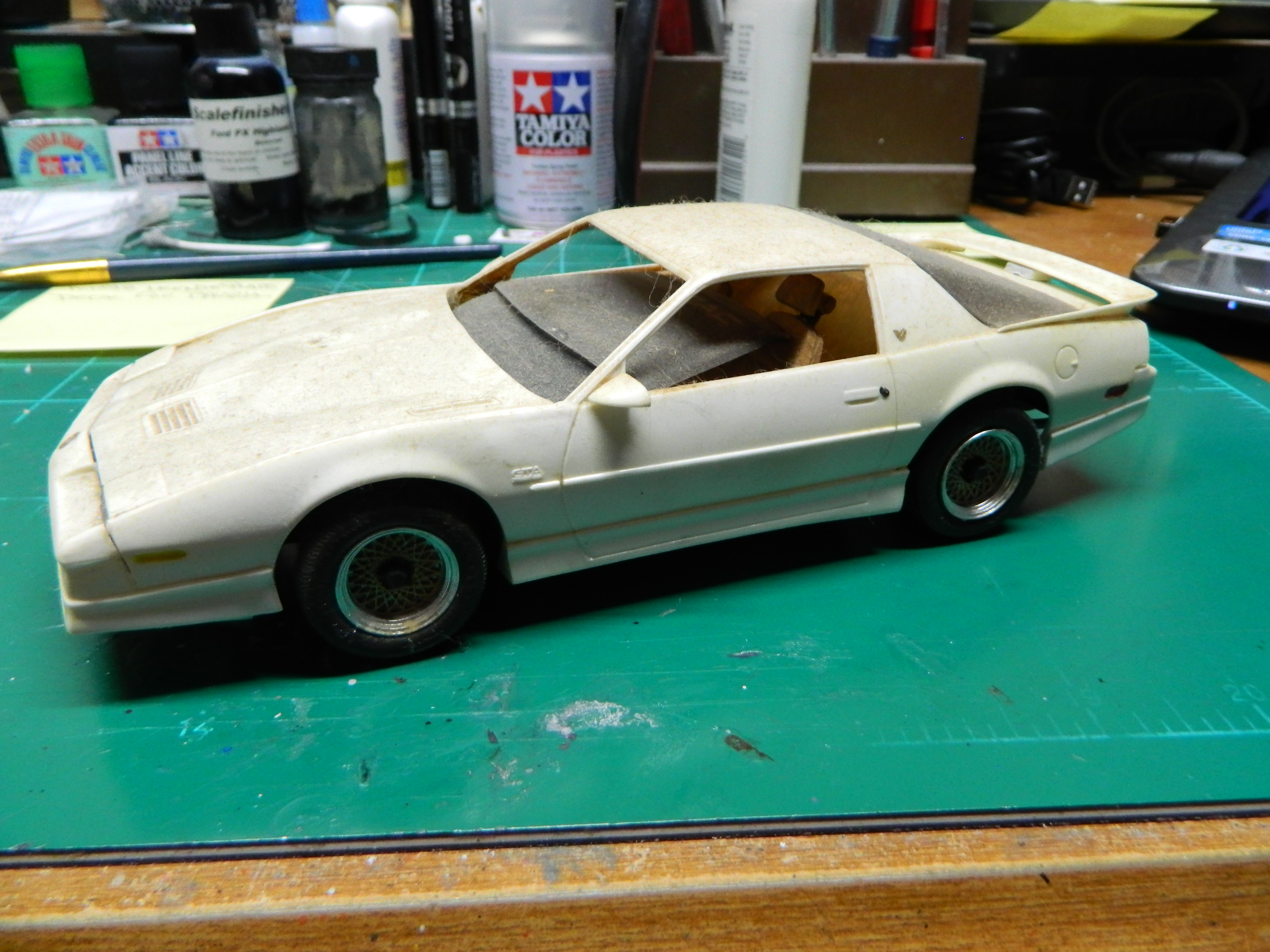

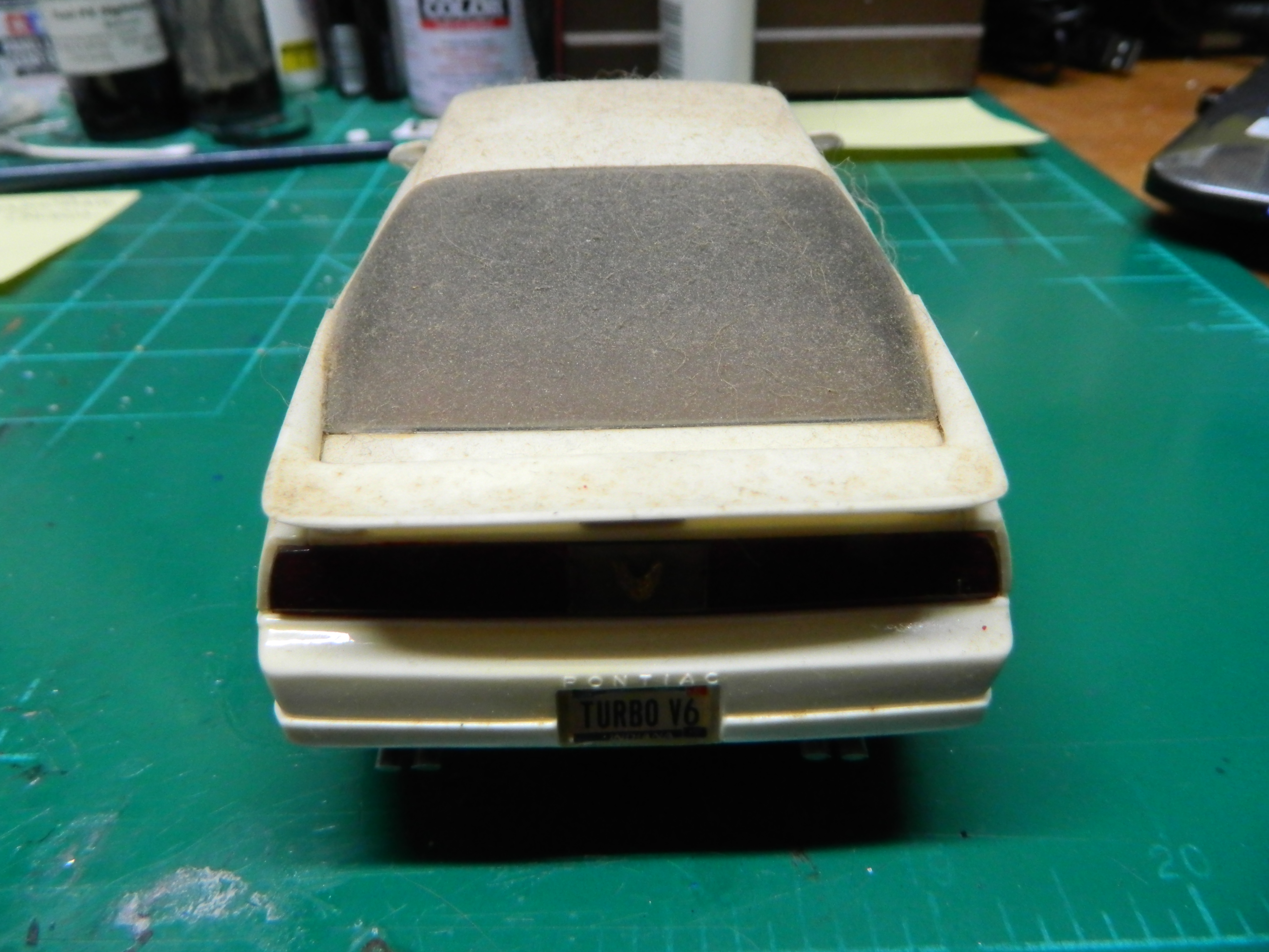

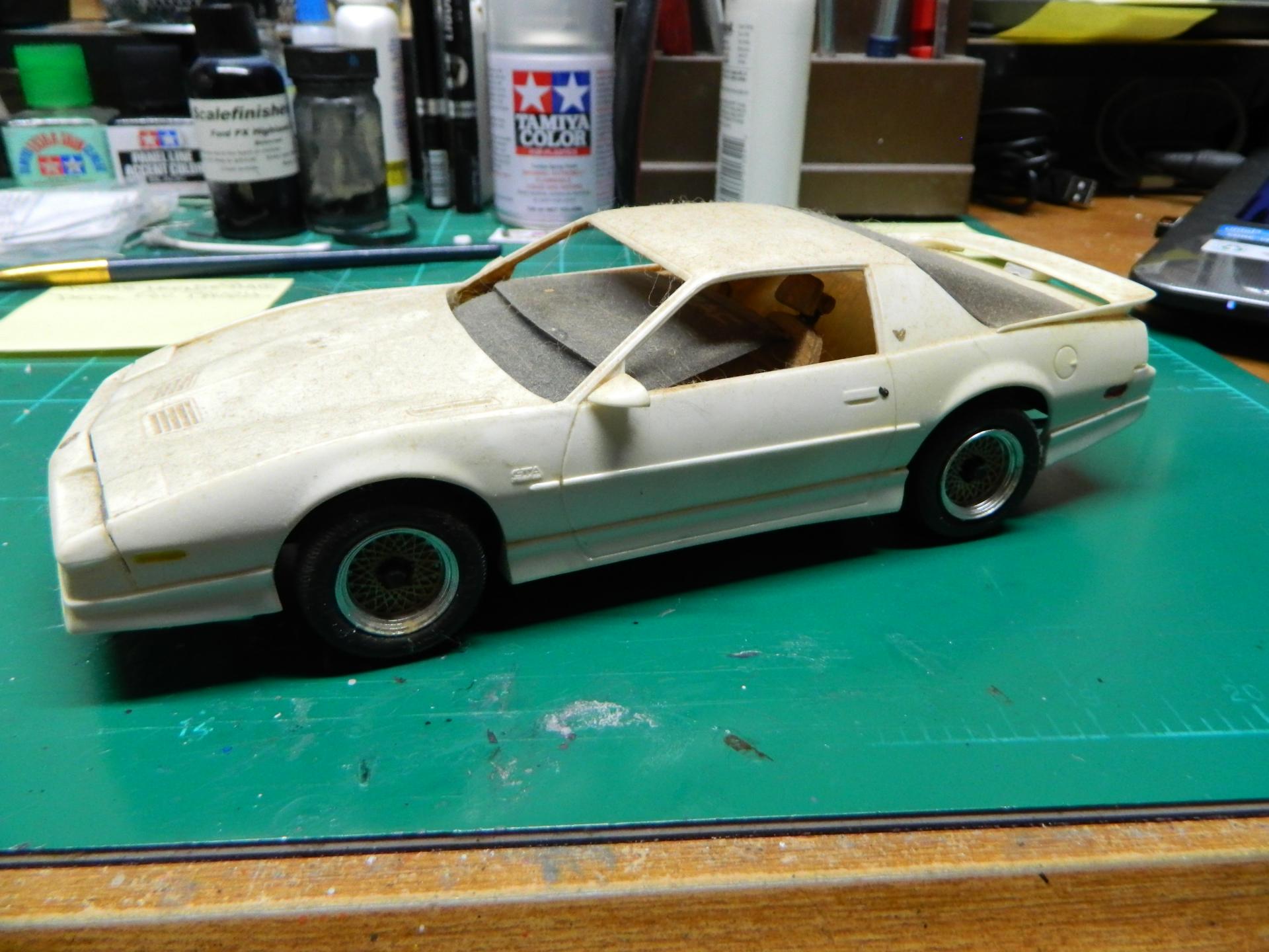

mrmike Posted January 30, 2019 Posted January 30, 2019 (edited) I found this long forgotten Firebird GTA that is in dire need of a rebuild...or I just needed another distraction. LOL This I believe was the High Performance Series kit since the Buick V-6 engine is wired and plumbed and I didn't do that unless the necessary parts were in the kit. Anyway, this Firebird GTA will be blown apart, rechromed, repainted, and rebuilt. This is probably another one of those models that I originally built in a weekend. Once I take the model apart, everything will be washed, inventoried, and refinished. The wheel rims will need to be rechromed. I never painted the model, but I did clearcoat it with enamel clearcoat which has yellowed over time. I always thought the Firebird GTA looked great in white, but I may paint it another color. More to come... Edited January 31, 2019 by mrmike

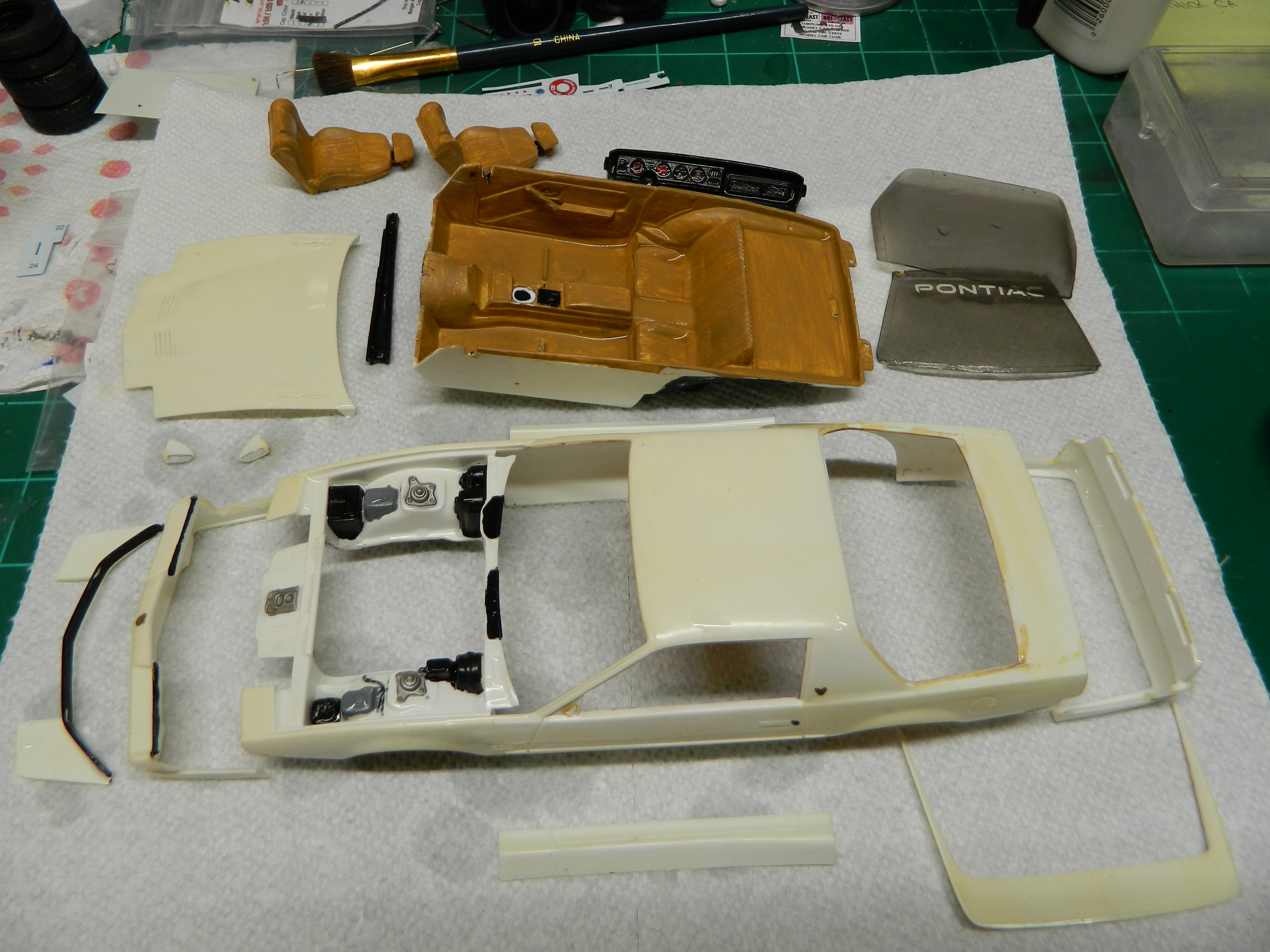

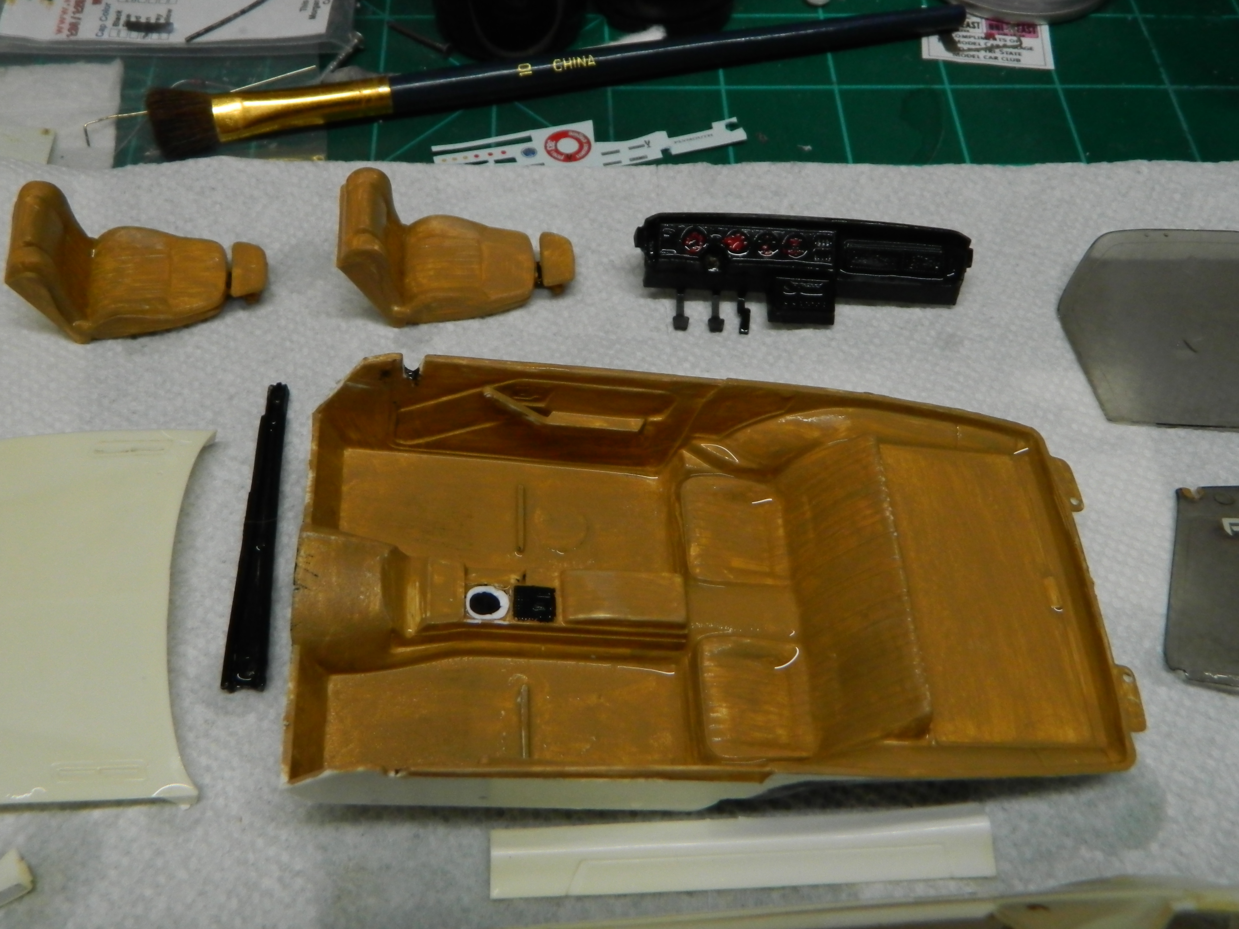

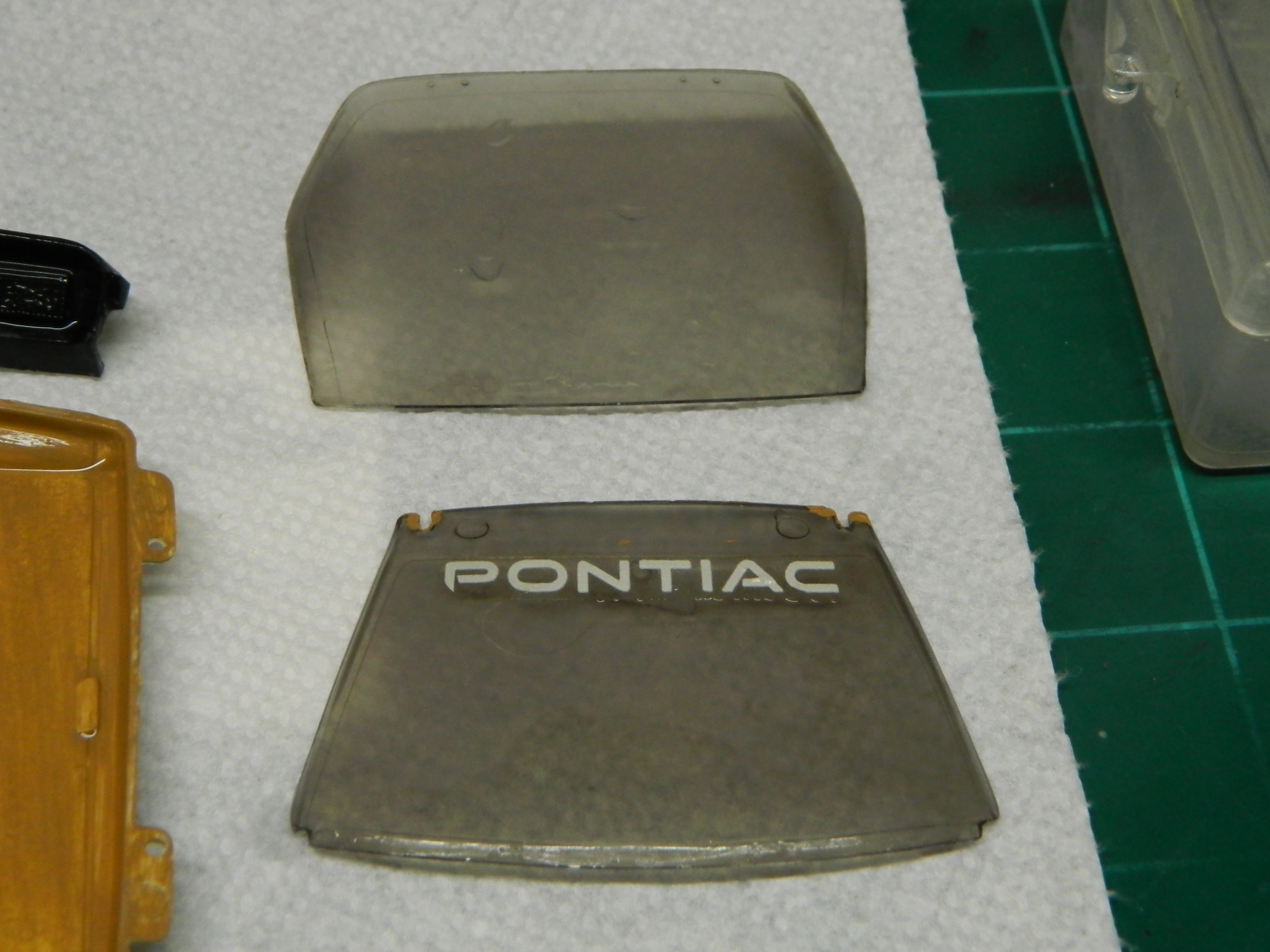

mrmike Posted February 1, 2019 Author Posted February 1, 2019 I washed the parts of my '89 Firebird GTA this morning. As you can see, the enamel clearcoat has yellowed over time. Don Yost says that enamel clearcoat won't yellow so what is his method of adding enamel clearcoat? When this is dry, I'll paint the body parts with primer and then with white paint. I'll have to dig through my paints and pick out a white paint for the GTA. More to come...

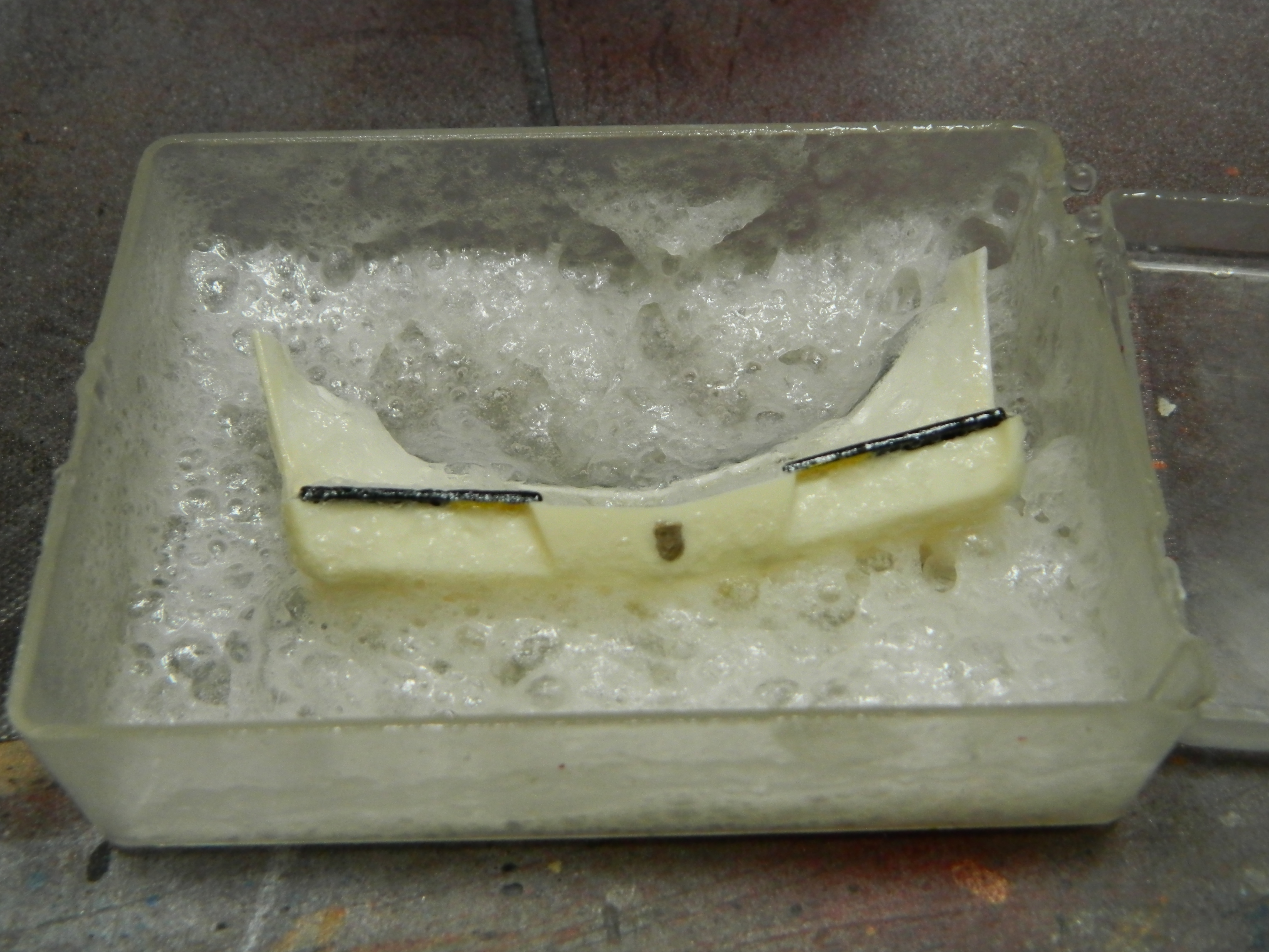

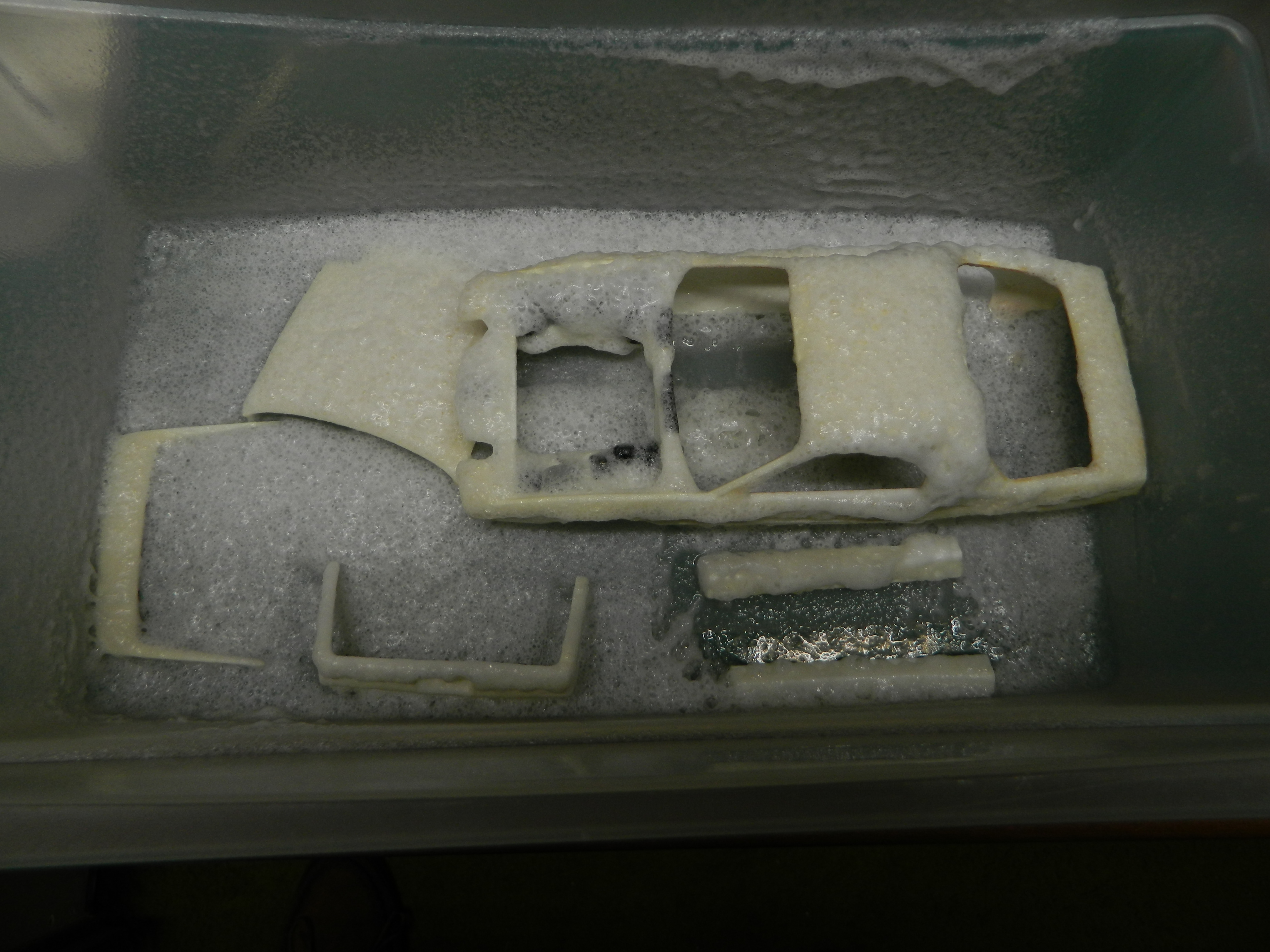

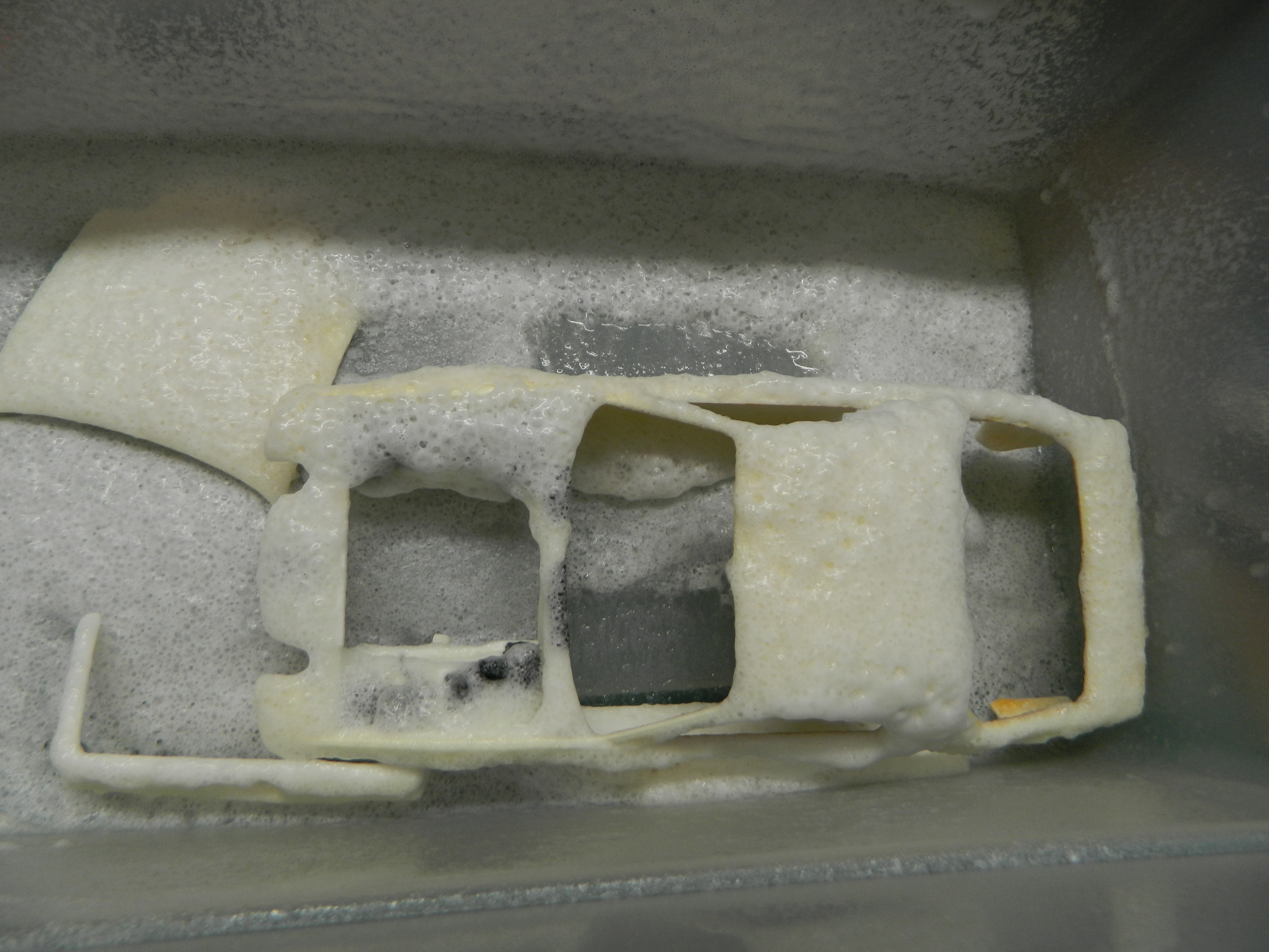

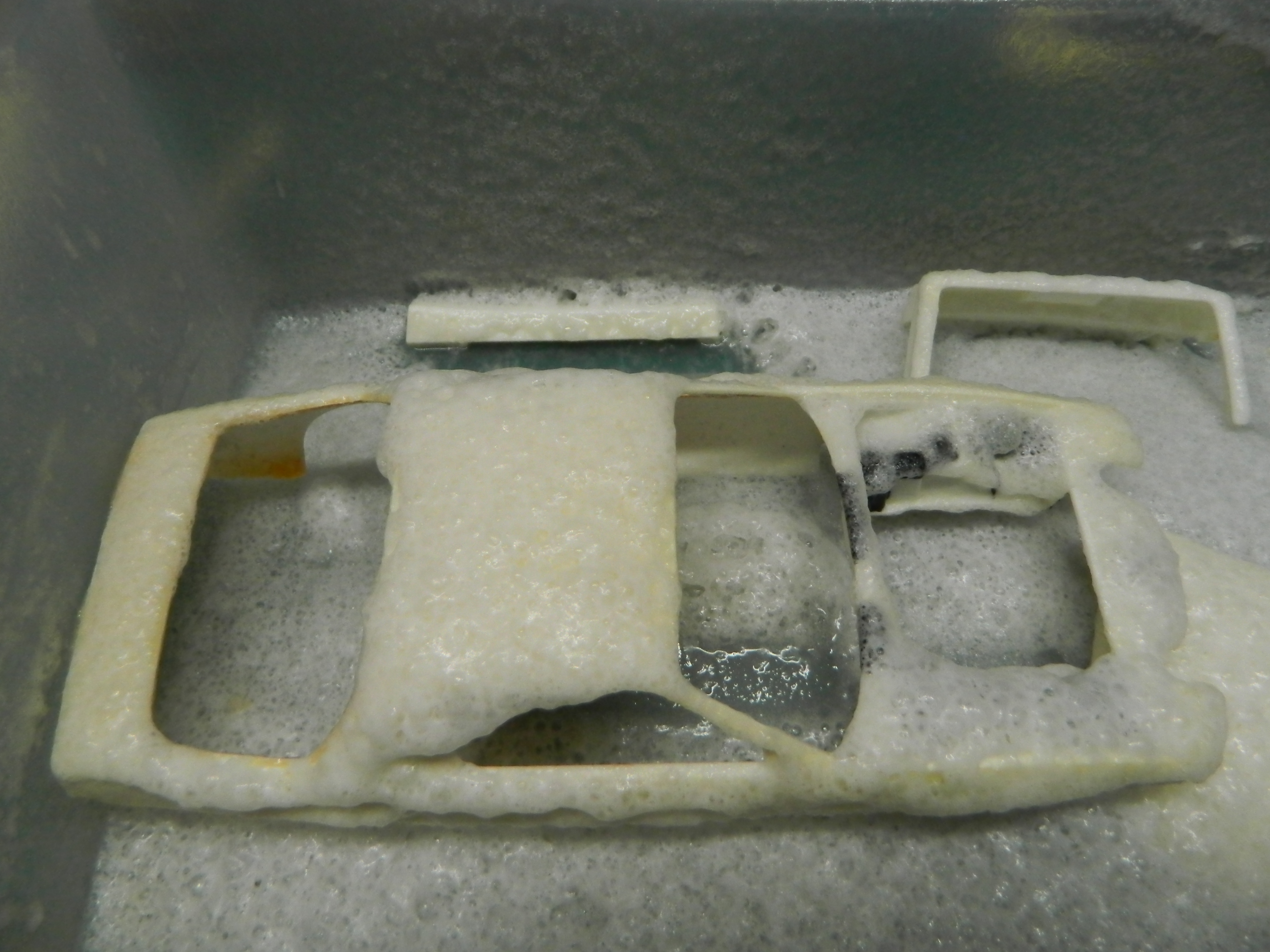

mrmike Posted February 5, 2019 Author Posted February 5, 2019 I've got the body in a stripper solution of Easy Off. Once I get the old clear off, I can prime and paint.
mrmike Posted February 25, 2019 Author Posted February 25, 2019 I was finally able to get some Easy-Off Oven Cleaner since the can I had was still half full, but didn't want to spray anymore. This is a second coat of the Oven Cleaner and then I'll wash it all in a few days. More to come...

mrmike Posted February 28, 2019 Author Posted February 28, 2019 Thanks Ismael! I decided to leave the parts and body swimming in Easy-Off for another day. I'll try to wash the Firebird tomorrow.

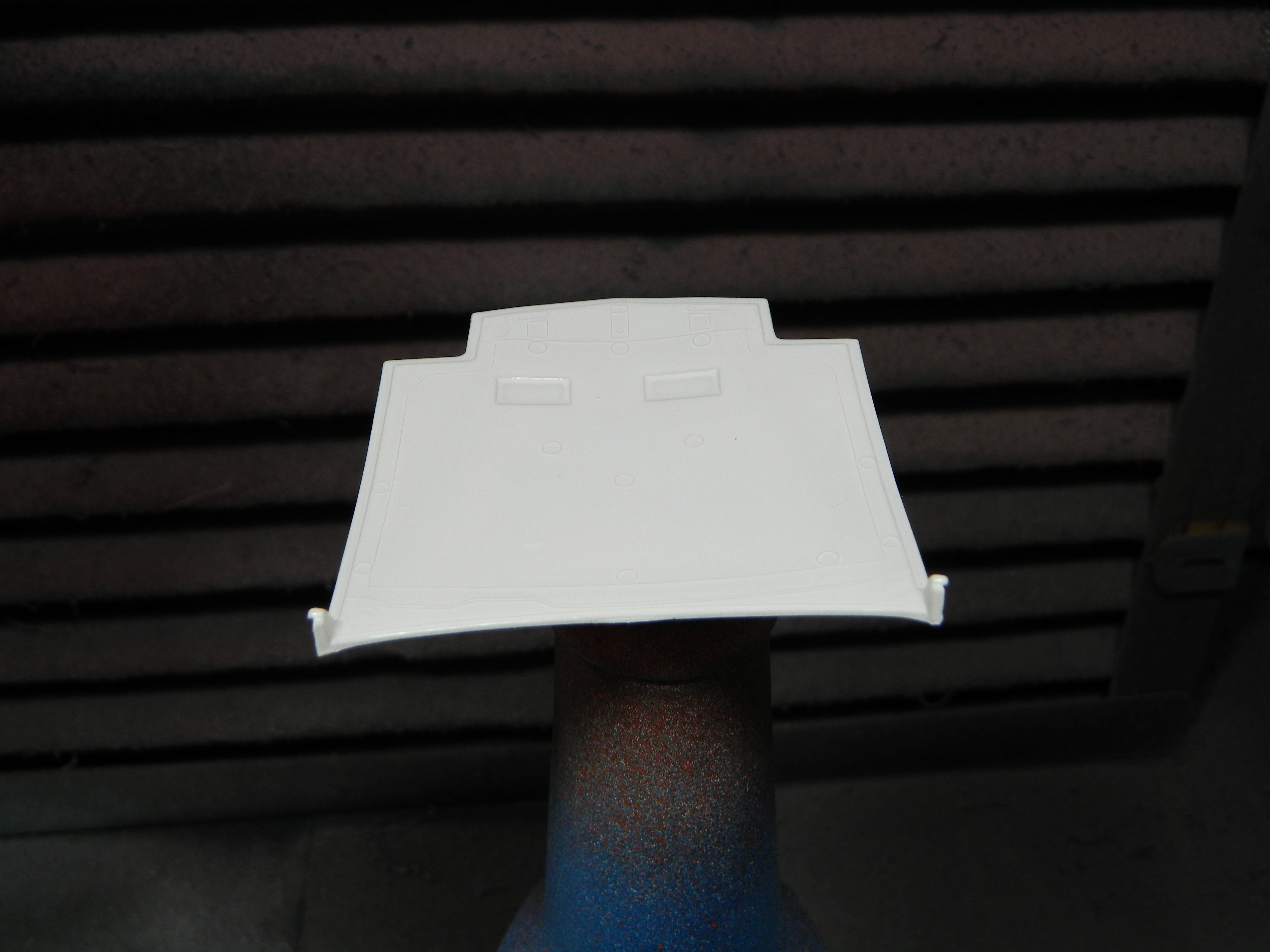

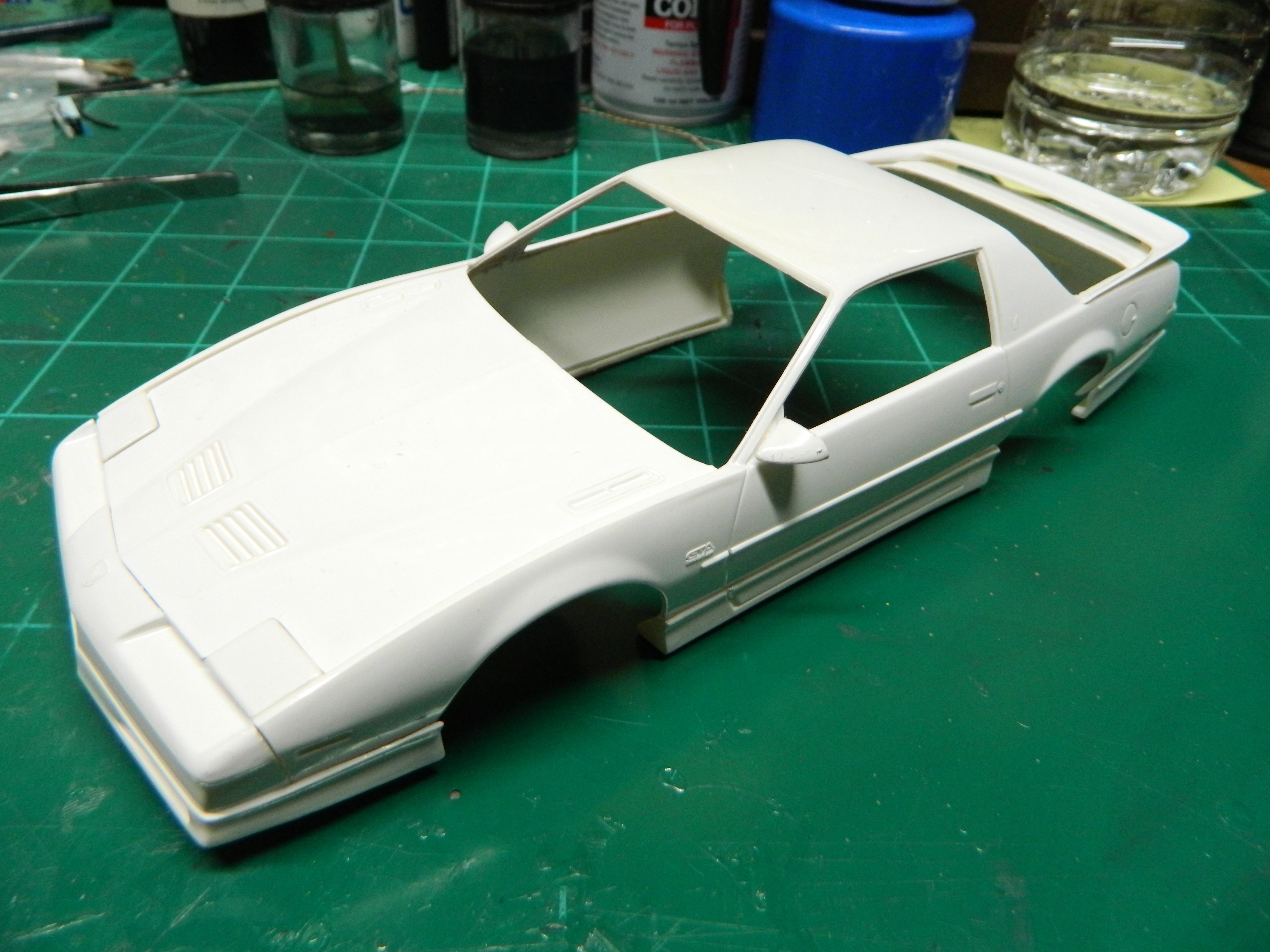

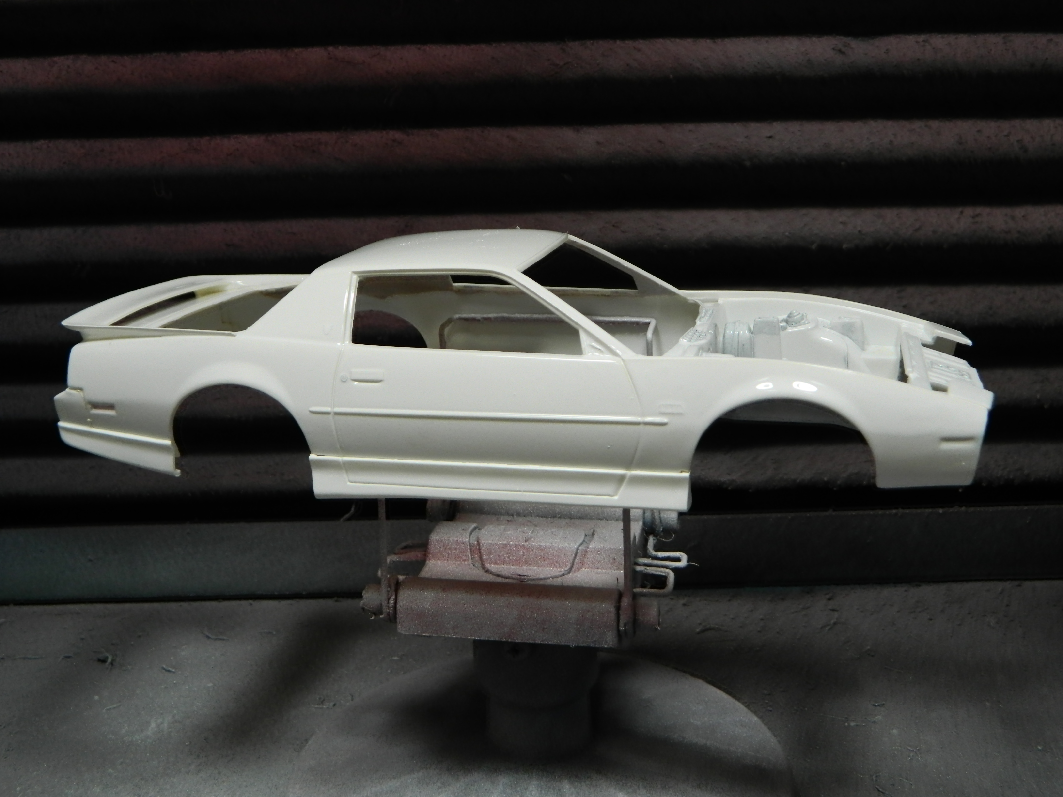

mrmike Posted March 6, 2019 Author Posted March 6, 2019 Thanks Tom! I got the Firebird out of the Easy-Off Oven Cleaner the other day and washed it off with Dawn dish detergent and a scrub brush. I set them aside to dry and forgot about them until a short while ago. I grabbed a can of Model Master Classic White Lacquer and sprayed the body and hood. They appear to have turned out very nicely. I always start by painting the bottom of the hood first. When that is dry, I'll flip it over and spray the top. As usual, I forgot to put something in the Oven Cleaner. Something being the front nose and the side mirrors. More to come...

mrmike Posted March 8, 2019 Author Posted March 8, 2019 Thank you Vince! I have left this in the paintbooth to really dry good, then I'll start detailing and rebuilding it.

ismaelg Posted March 9, 2019 Posted March 9, 2019 Looking good! That car looks really good in white. Many years ago I was told to add a small drop of blue into white enamel to prevent yellowing. Maybe it works on clear as well. Of course that means airbrushing since you can't do that with a spray can.

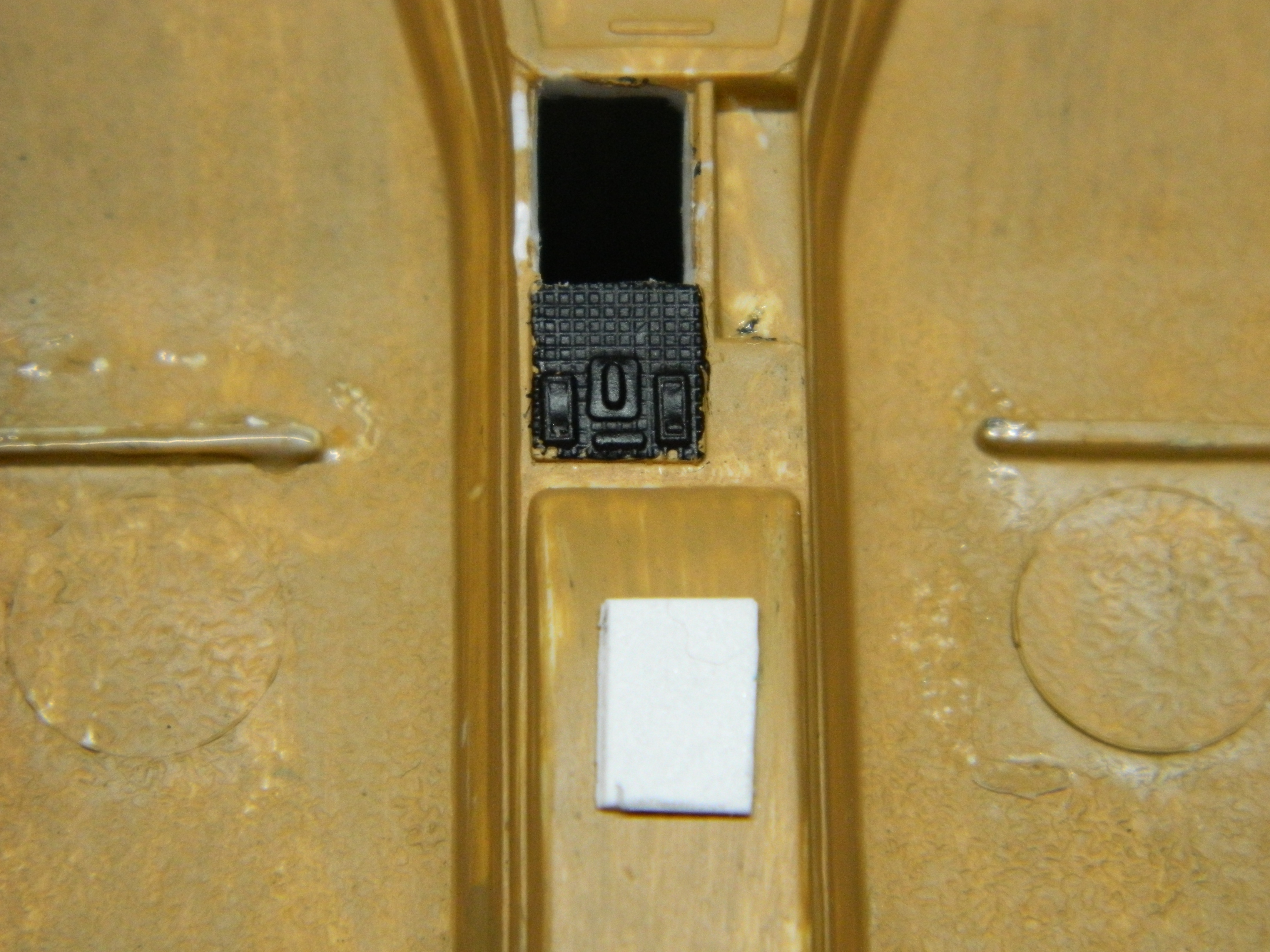

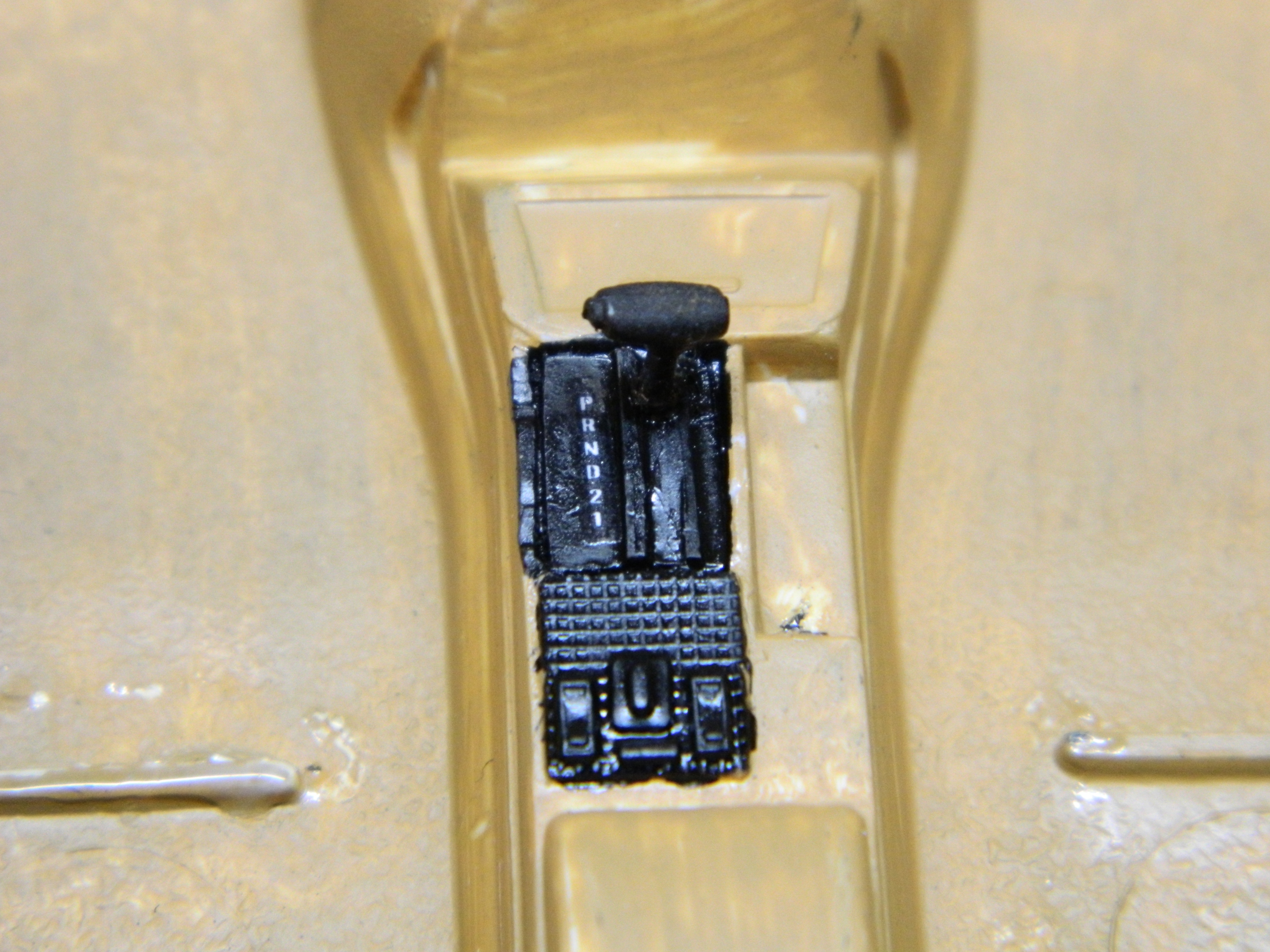

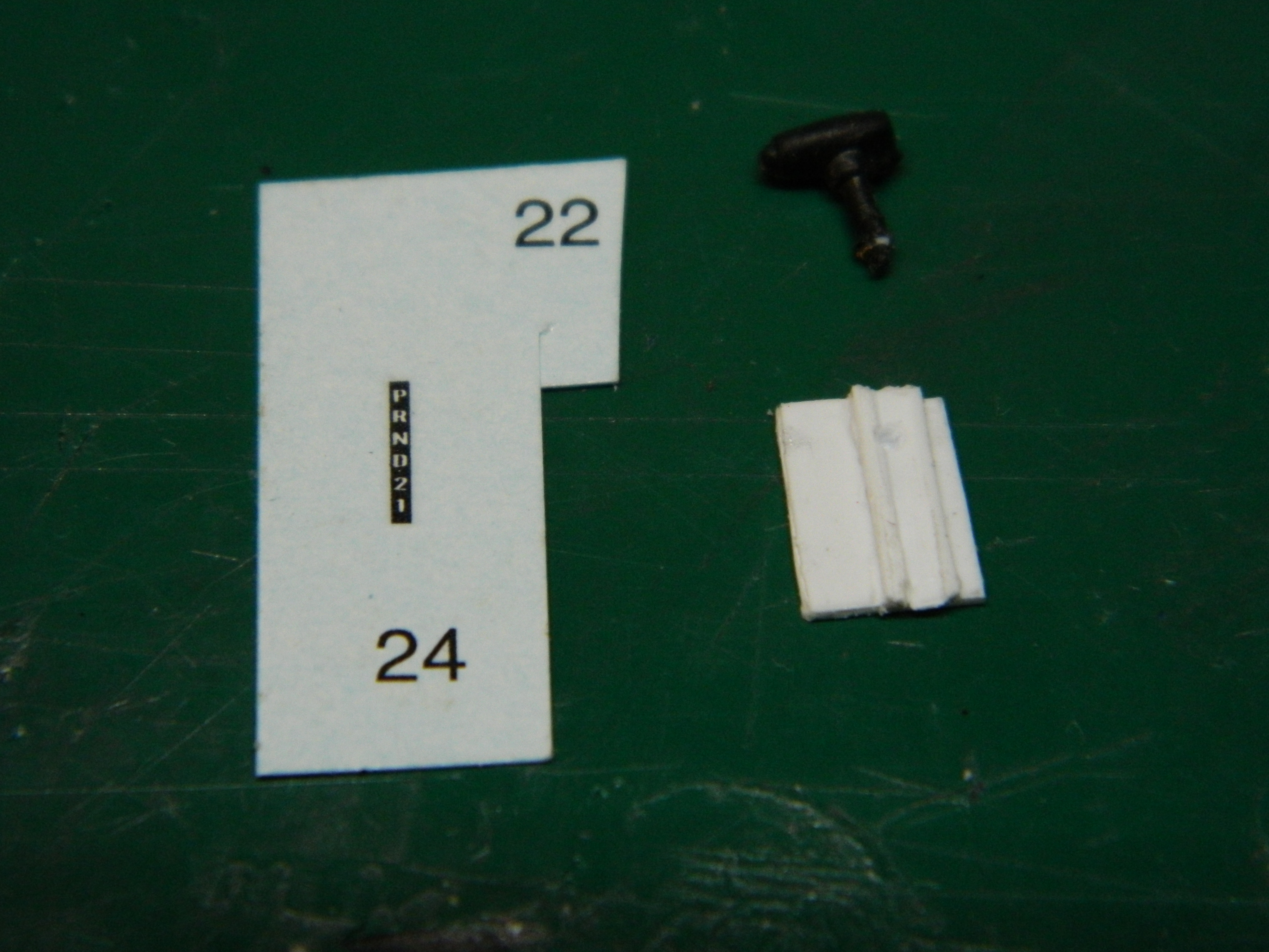

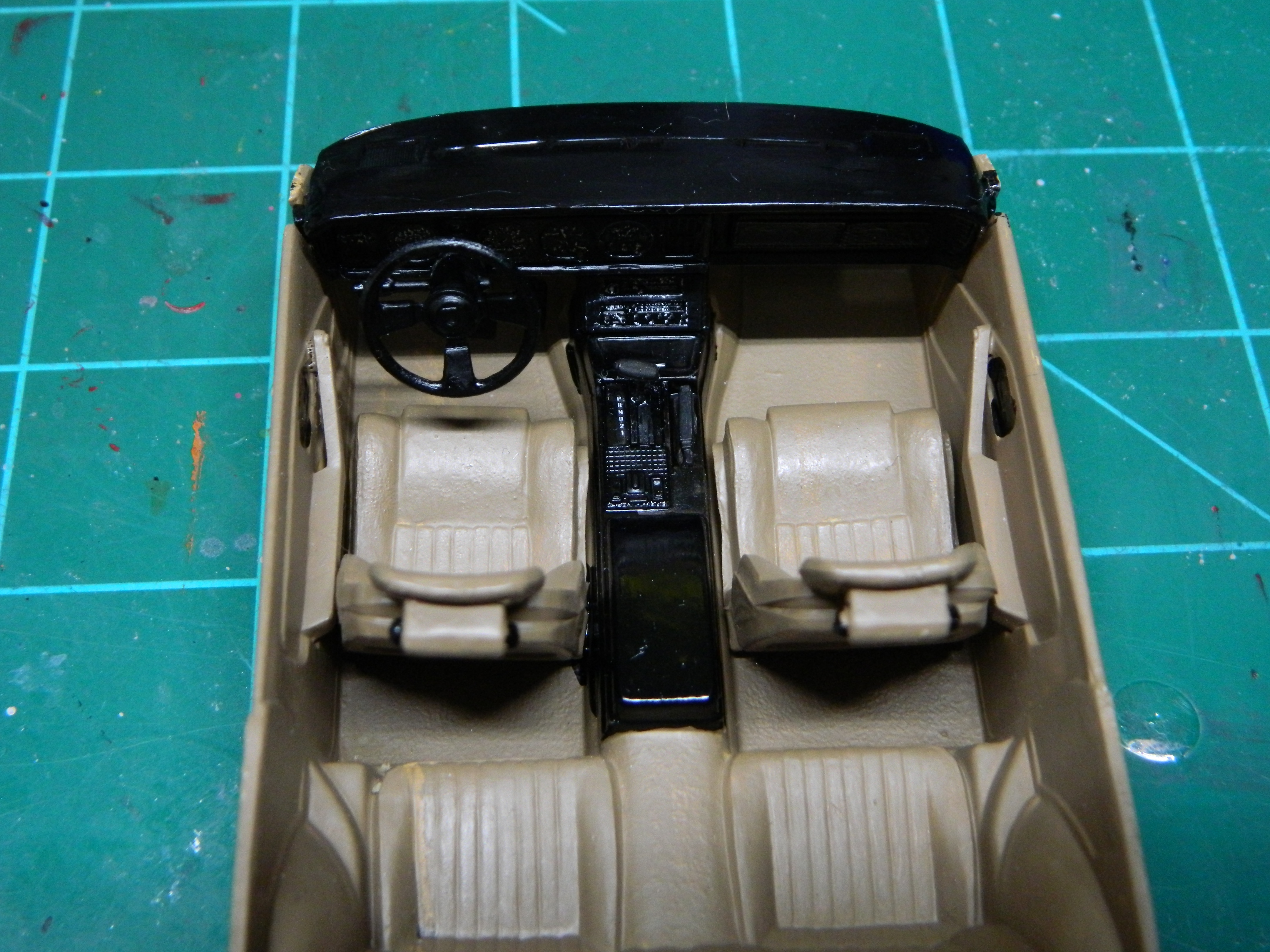

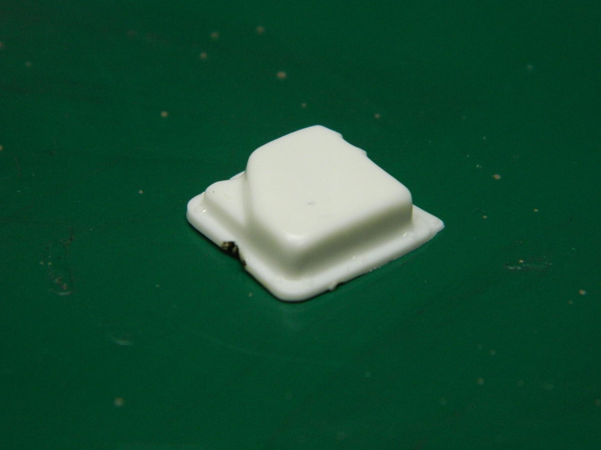

mrmike Posted March 9, 2019 Author Posted March 9, 2019 (edited) Thanks Vince, Andre and Ismael! What you see here is a hole cut into the console for an automatic shifter. The kit is set up for a manual shifter and the engine has a automatic transmission attached to it. I cut out a rectangle piece of styrene for the shifter plate. The shifter plate is nearly complete and it just needs to painted, decaled and installed. Here's the completed shifter plate installed in the center console. More to come... Edited March 9, 2019 by mrmike

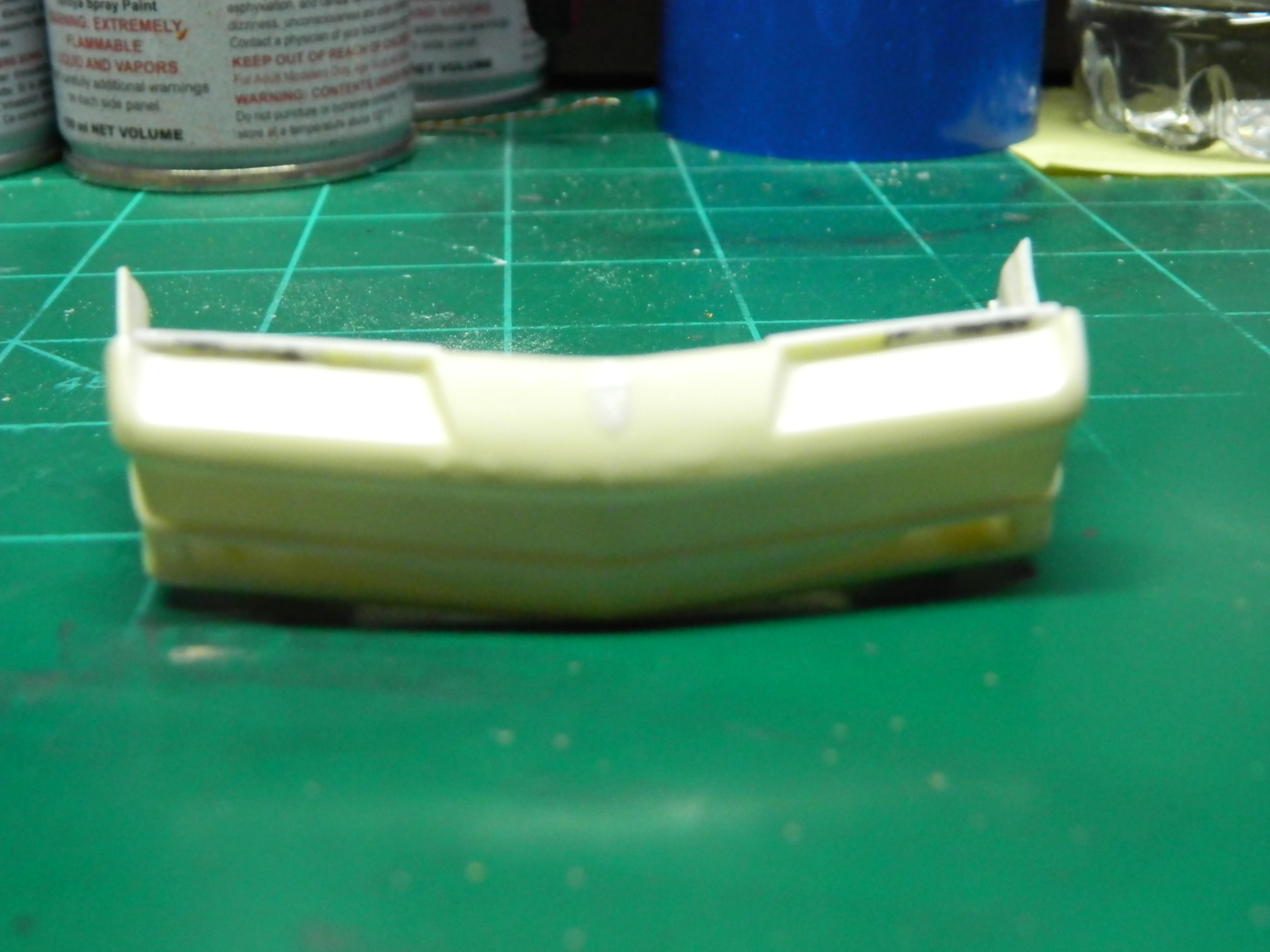

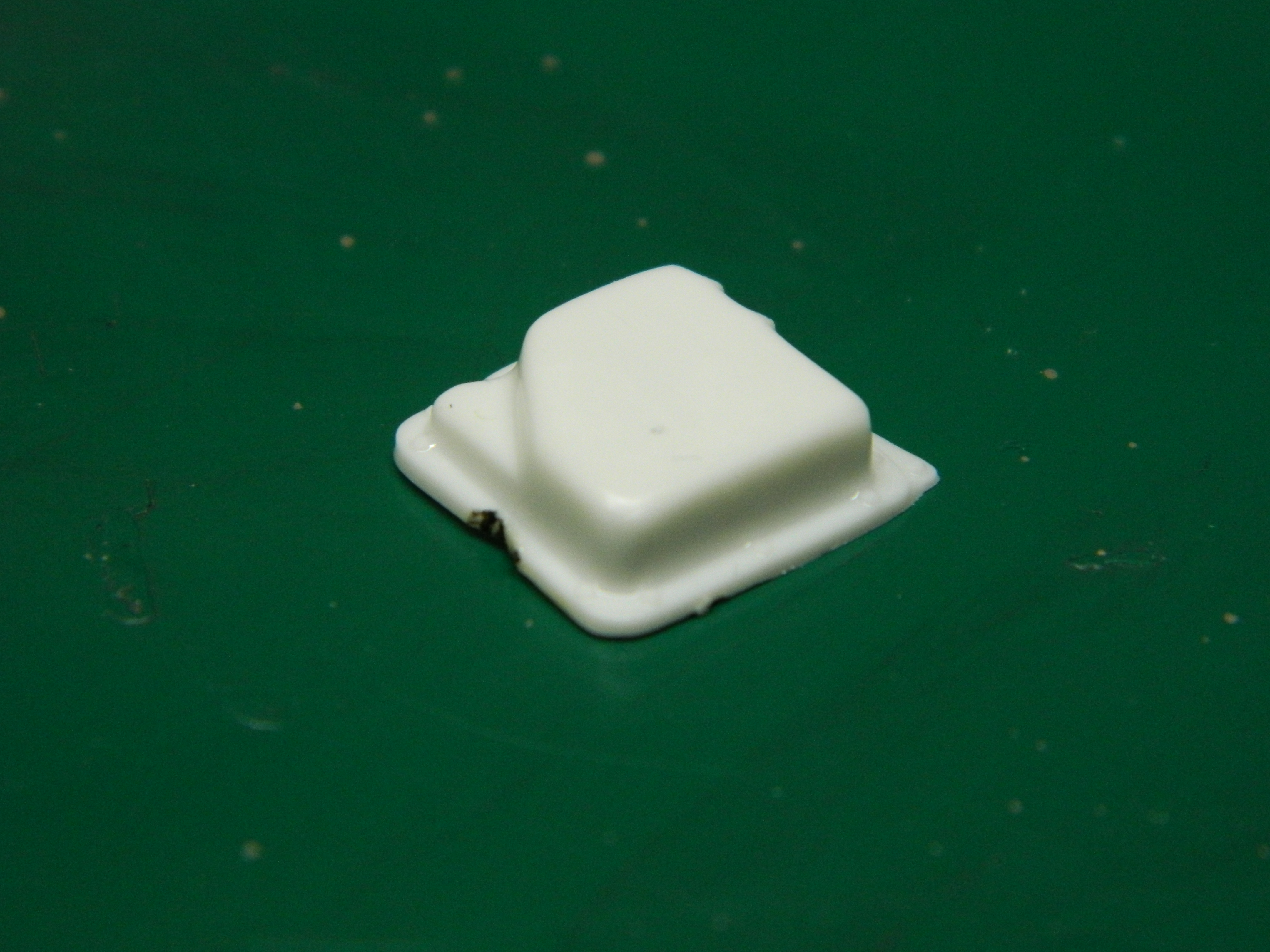

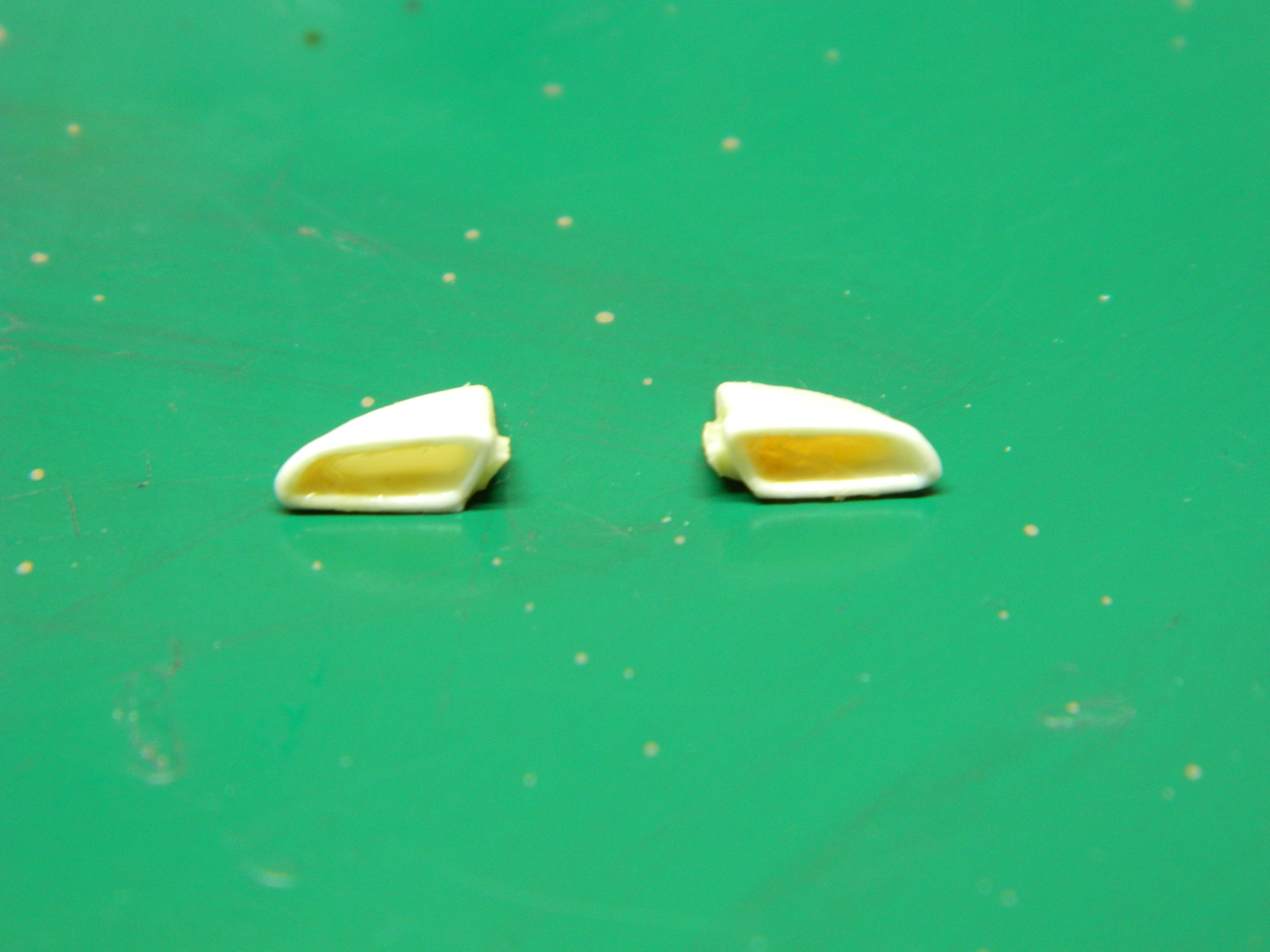

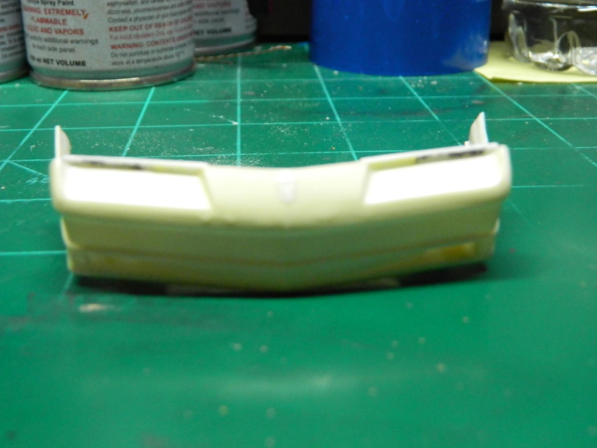

mrmike Posted March 12, 2019 Author Posted March 12, 2019 I just got the last of the parts out of the Easy-Off Oven Cleaner and gave them a good washing with a scrub brush and Dawn Dish Detergent. The nose. The rear view mirrors. The transmission pan which was chrome plated. When this is dry, I'll give a squirt of primer and then a good dosing of Model Master Classic White Lacquer and the transmission pan a good coating of Model Master Aluminium Metalizer. More to come...

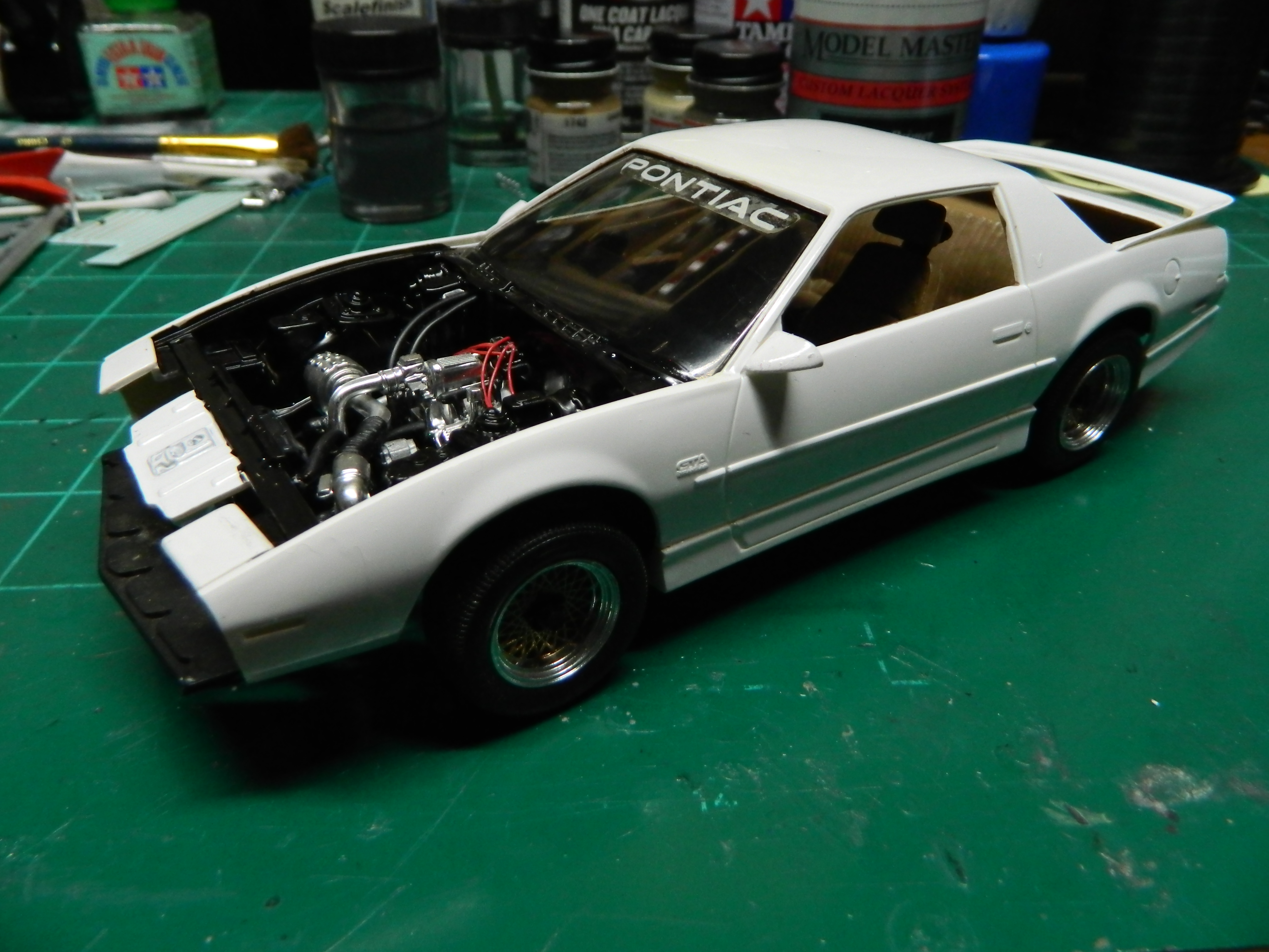

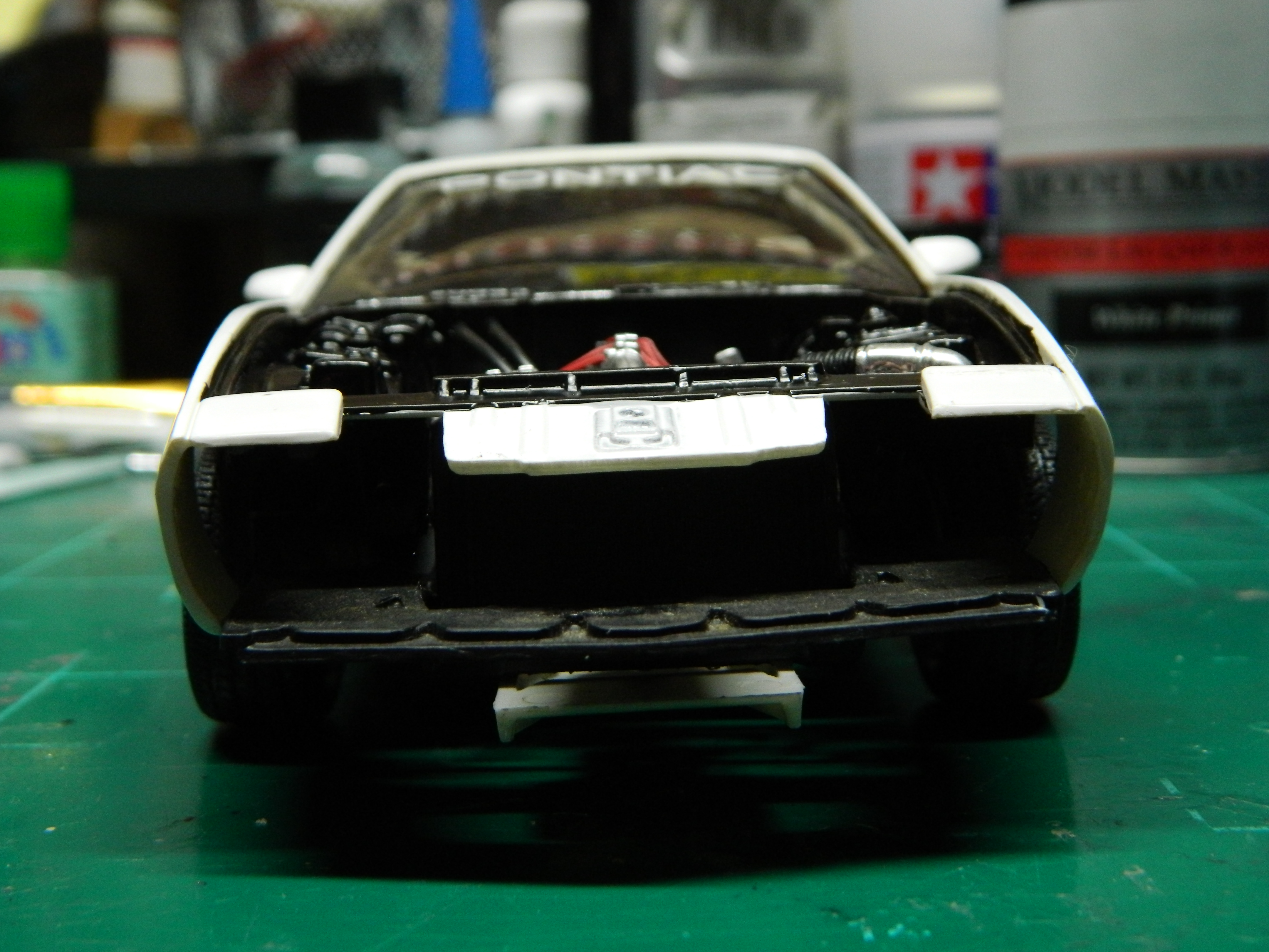

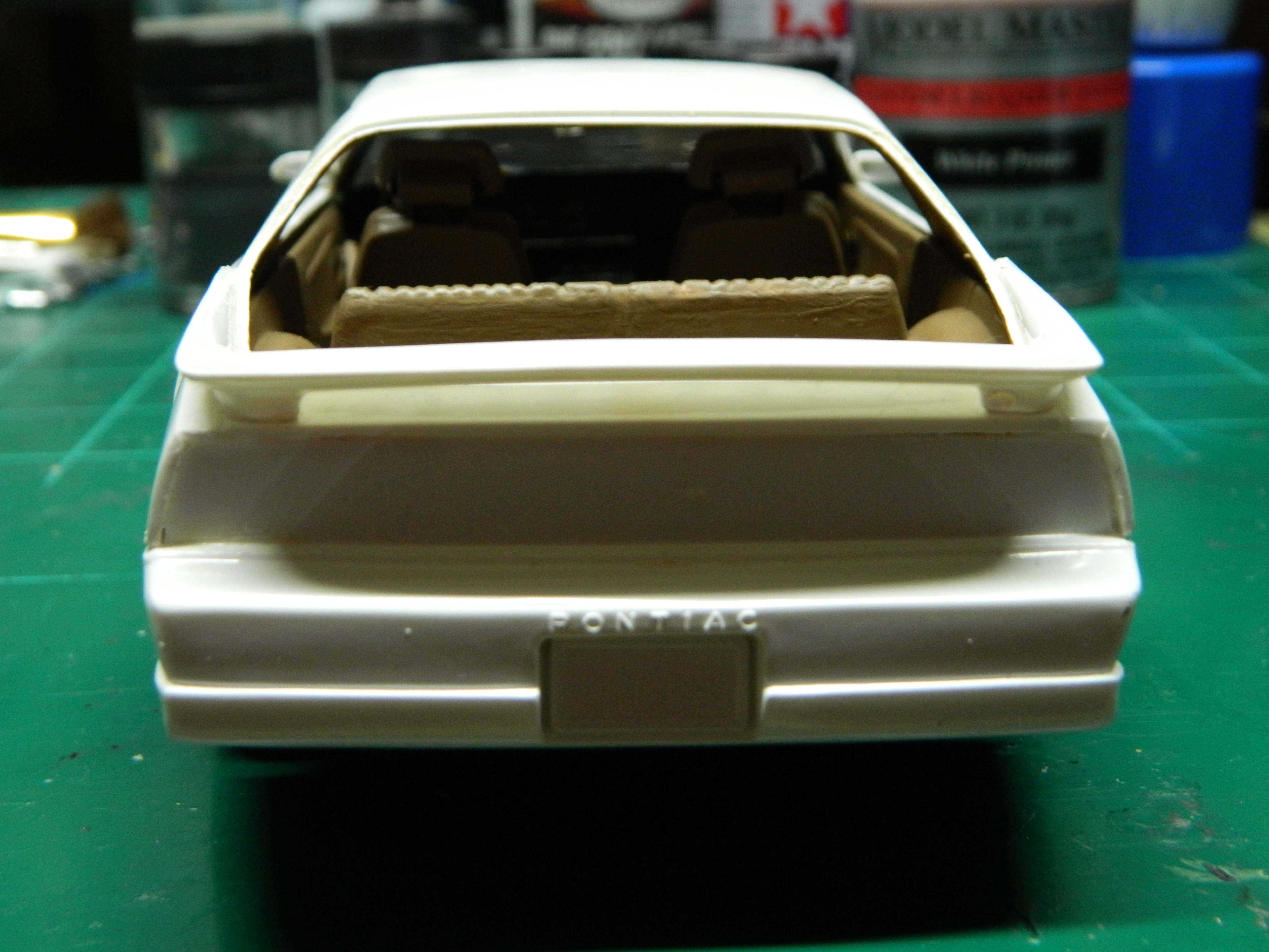

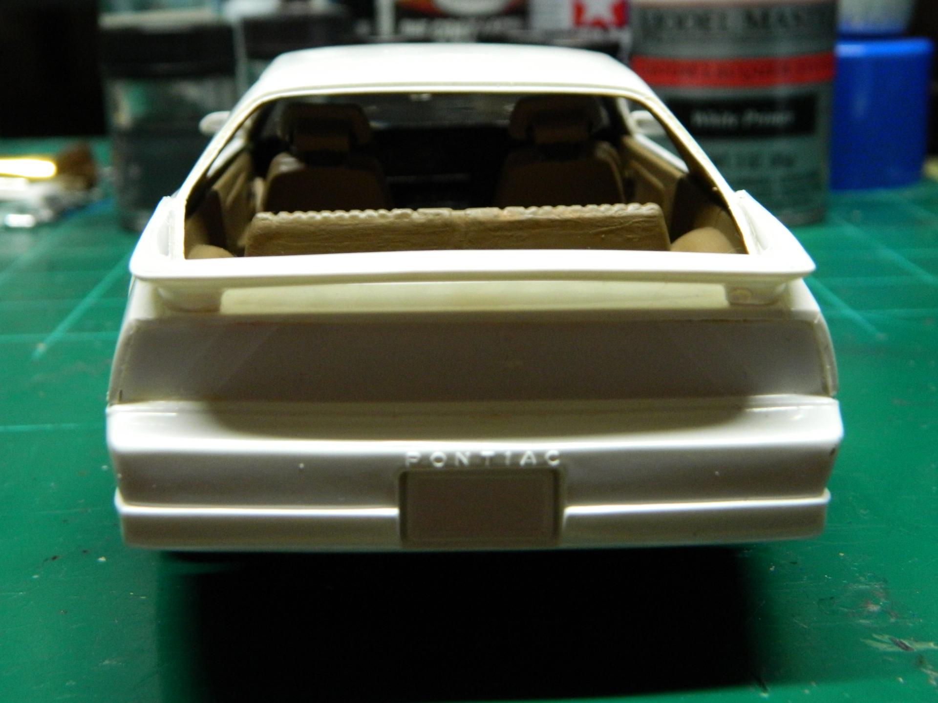

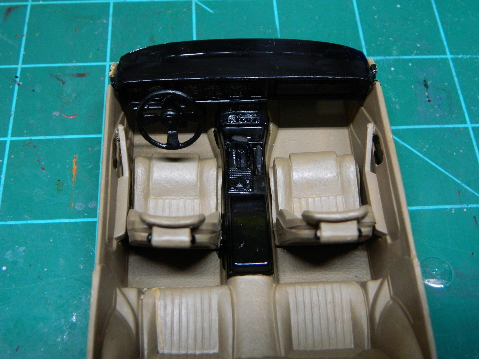

mrmike Posted March 14, 2019 Author Posted March 14, 2019 Thanks Scott! It's always nice to find something that reminds us of our past. Yesyerday, I spent some time on the Firebird GTA by reassembling the chassis. The interior is done with the revised center console. and repainted interior. The body has been repainted and reassembled. More to come...
kelson Posted March 15, 2019 Posted March 15, 2019 Coming along nicely!,great work on redoing the console.
mrmike Posted March 16, 2019 Author Posted March 16, 2019 Thanks Curtis! I started reassembling the Firebird today. More to come...
