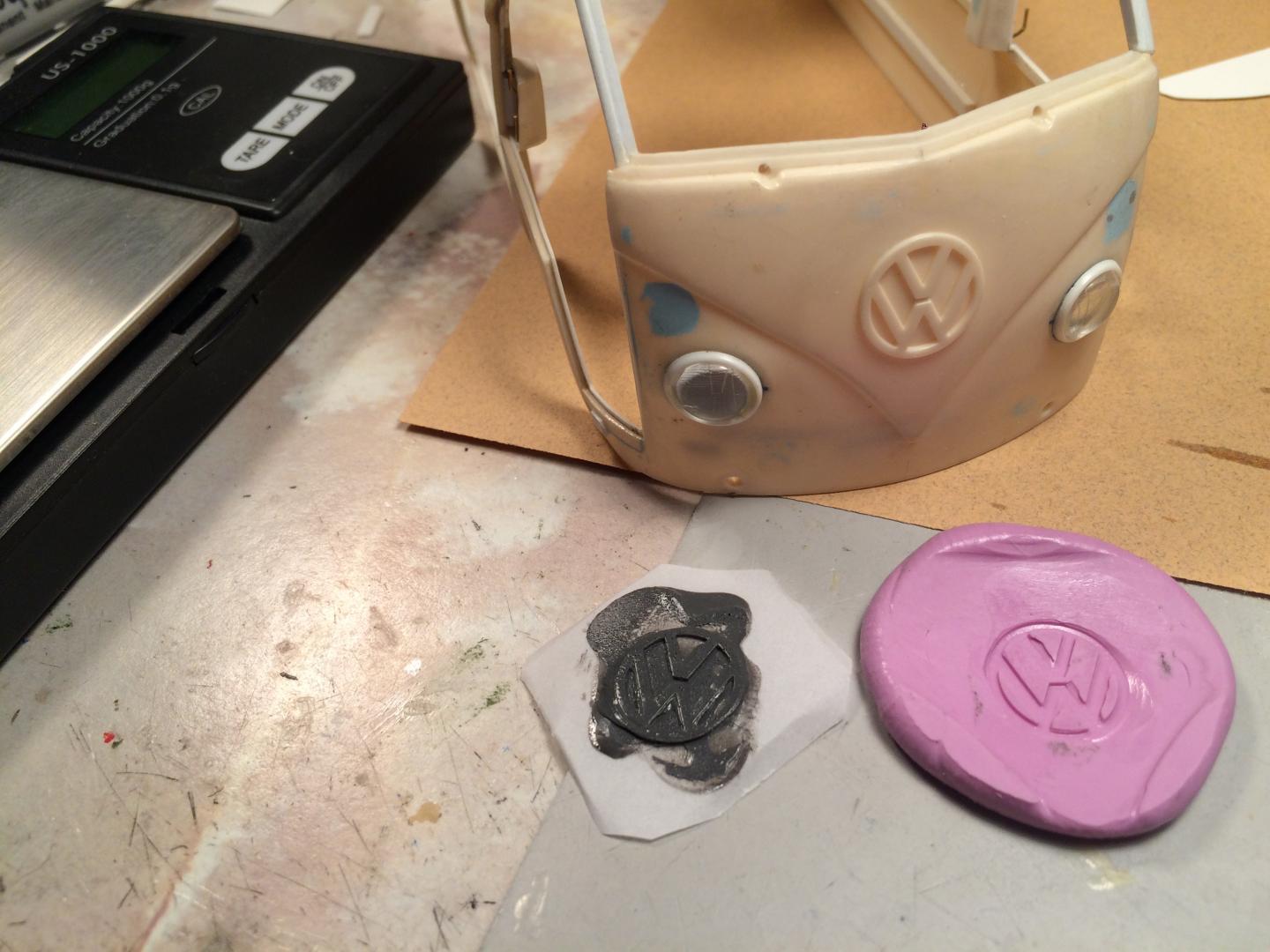

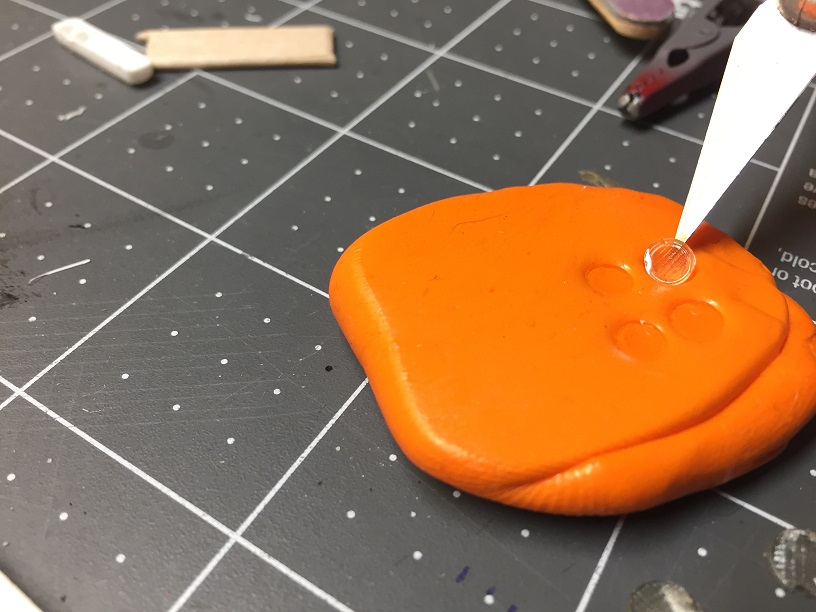

NOBLNG Posted February 1, 2019 Posted February 1, 2019 (edited) I posted these pics on my build thread, but I figure this is a better place for them, so they may be of help to others. The headlights on that particular model are chrome, and to me that is unacceptable! I have read elsewhere on this forum, bits and pieces about Bondic and Laser Bond products. I decided to try it for myself using Bondic. I just used silly putty for the mold. The larger ones were a pre-test and the smaller ones are the ones I need. The whole process took about 30 seconds and I think they came out pretty good. They are not perfectly clear, but close enough for my liking. One could certainly cast any small parts with this stuff. I hope this helps someone. Greg. Edited February 4, 2019 by NOBLNG Change Title

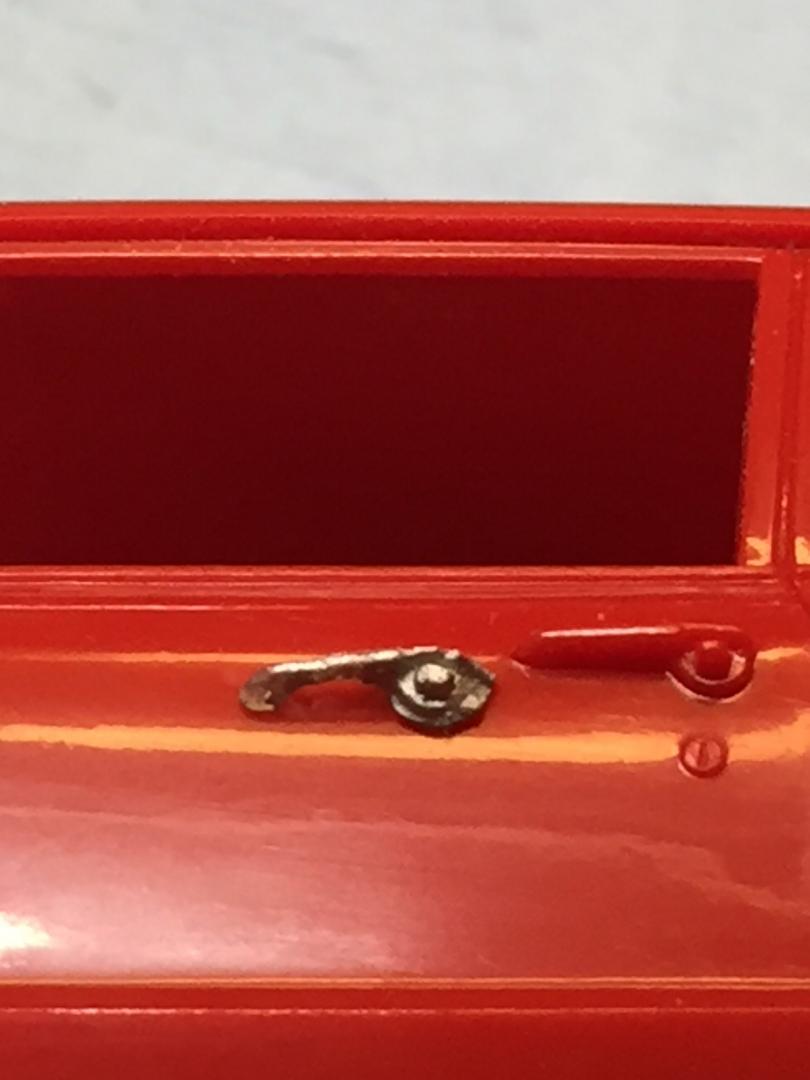

NOBLNG Posted February 1, 2019 Author Posted February 1, 2019 (edited) 35 minutes ago, Casey said: I've seen this movie before... Yes, Steven and others should get the credit for this idea. Thank You Steven!! I am merely simplifying it with the silly putty. It will work great for any small parts. It sands nicely. It seems a little harder and more brittle than styrene, but I was able to file the finger slot out on this door handle. This casting is a bit rough, but I was poking at it with a toothpick to remove an air bubble. Edited February 1, 2019 by NOBLNG add pic

StevenGuthmiller Posted February 4, 2019 Posted February 4, 2019 On 2/1/2019 at 10:45 AM, NOBLNG said: Yes, Steven and others should get the credit for this idea. Thank You Steven!! I am merely simplifying it with the silly putty. It will work great for any small parts. It sands nicely. It seems a little harder and more brittle than styrene, but I was able to file the finger slot out on this door handle. This casting is a bit rough, but I was poking at it with a toothpick to remove an air bubble. I take no credit for this technique. I didn’t invent it. I picked it up somewhere, but I have no idea from whom. I like the silly putty idea. Saves some time and your finished product looks great. The nice thing about using mold putty versus something like silly putty is that you can save those molds and use them over and over again. Steve

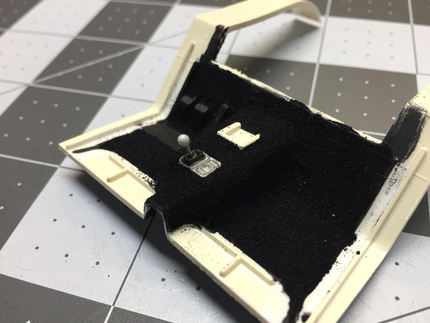

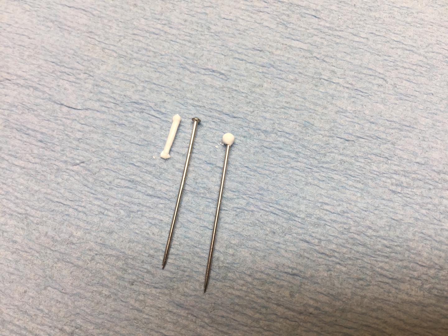

NOBLNG Posted February 4, 2019 Author Posted February 4, 2019 (edited) 1 hour ago, StevenGuthmiller said: The nice thing about using mold putty versus something like silly putty is that you can save those molds and use them over and over again. Steve If you can remember where they are... I can't find my tweezers half the time. LOL. Seriously, this bondic stuff is good for lots of little things. I just made a shifter lever for a Corvette with a little dab on a straight pin. I hate the little plastic kit parts. Edited February 4, 2019 by NOBLNG
