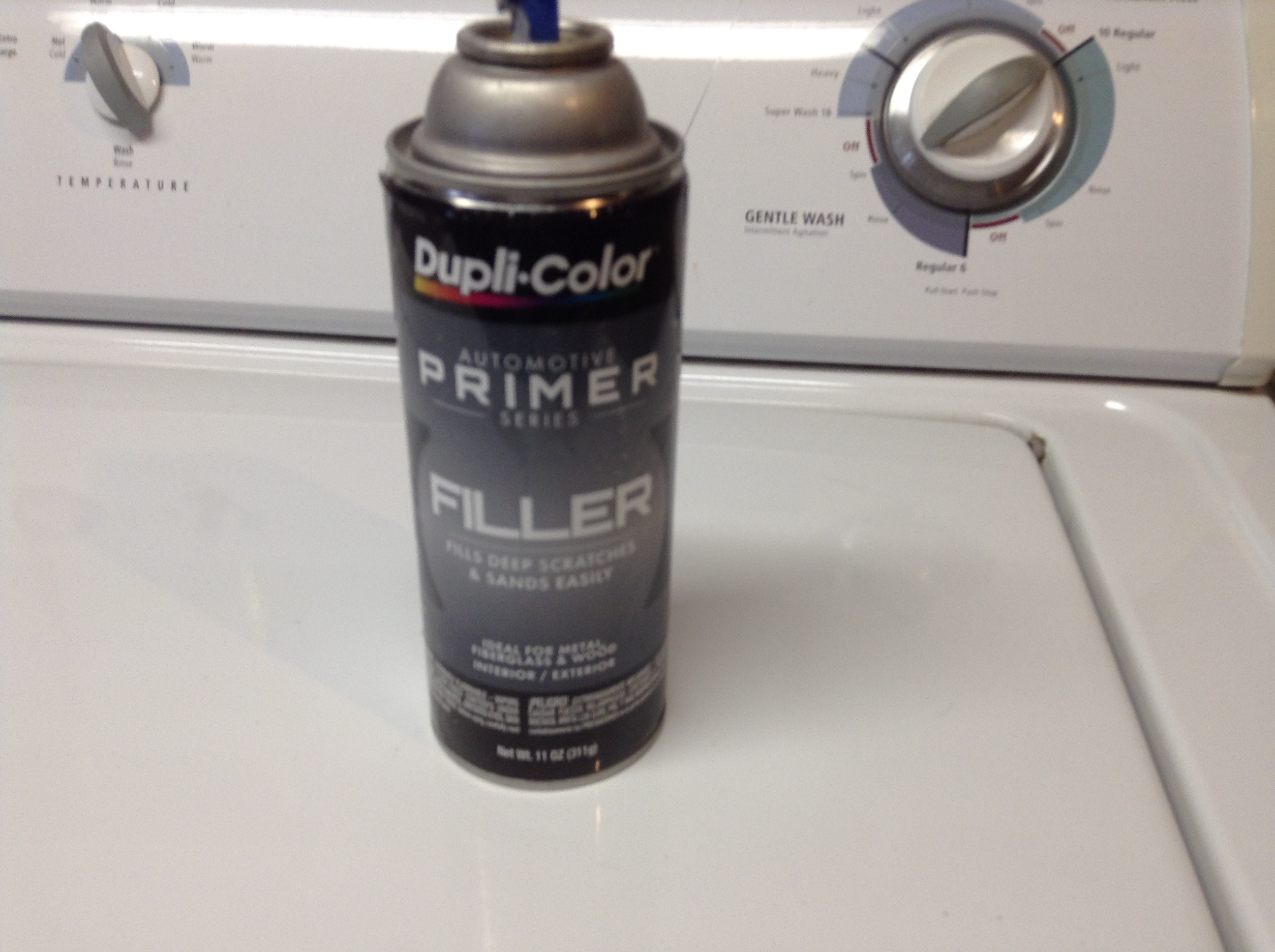

Muncie Posted February 7, 2019 Posted February 7, 2019 Best to strip anything primed with the Rustoleum so the Duplicolor goes directly on the plastic. Duplicolor makes a couple of different flavors of primers and different builders have different preferences. Some primers are made to spray on thicker so they can fill sand scratches and other problems - but they also fill in molded detail. The 1699 primer-sealer comes out a little thinner, less sanding after primer. A sealer is intended to be a barrier and block anything under the sealer from showing thru the top coats and to also prevent the top coats from attacking anything below. Light coats to start and then start building up layers. I've never been a fan of Rustoleum but that doesn't mean it won't work over another primer. There is a much better chance that Rustoleum paint (not bonds to plastic) will work over Duplicolor primer than the other way around. I'll admit that I'm probably biased, but my opinion is that any of the hardware store paints that say bonds to plastic are meant for plastic shelving and other utility plastics, not the fine work that we do. My rule of thumb for paint advise is that if you have 15 model builders in a room that can all do great paint, there will be at least 15 different methods and none of then will work for anybody else. Experiment, find what works, and that's what you do.
Classicgas Posted February 7, 2019 Posted February 7, 2019 (edited) The Duplicolor I showed works fine on plastic. Yes, it is a bit thicker but sprayed properly doesn't hide detail. I always spray 2 or 3 mist coats before a wet one. I use original Easy Off, yellow can to strip paint. Usually removes it overnight. Plastikote works well too if you can find it Edited February 7, 2019 by Classicgas

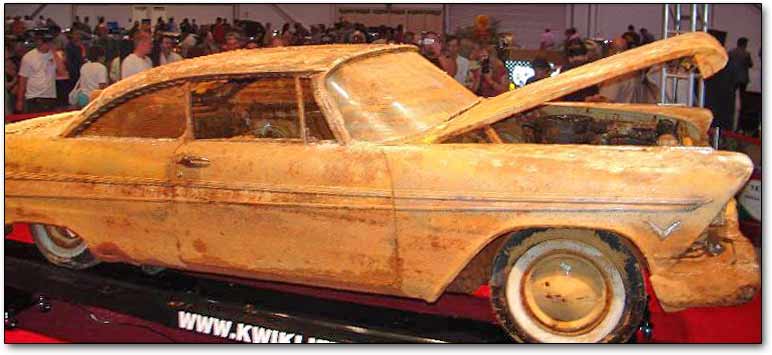

ewetwo Posted February 7, 2019 Author Posted February 7, 2019 (edited) 22 hours ago, Greg Myers said: and we should all go out and buy a compressor along with a nice gravity feed airbrush. I have a compressor and air brush gun. I have to learn how to use them. Just a thought. I could always create this. The Plymouth time capsule. Edited February 8, 2019 by ewetwo
