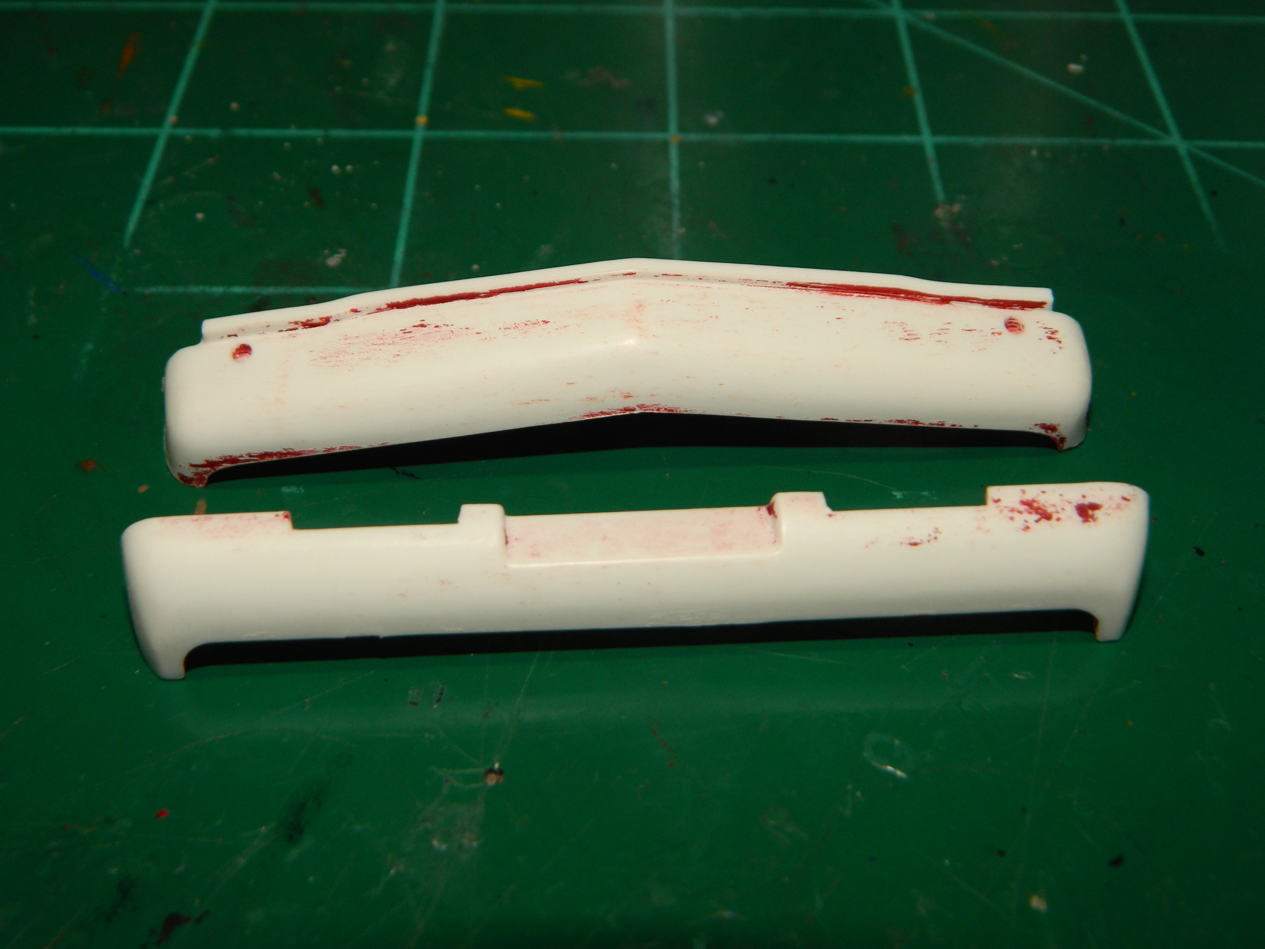

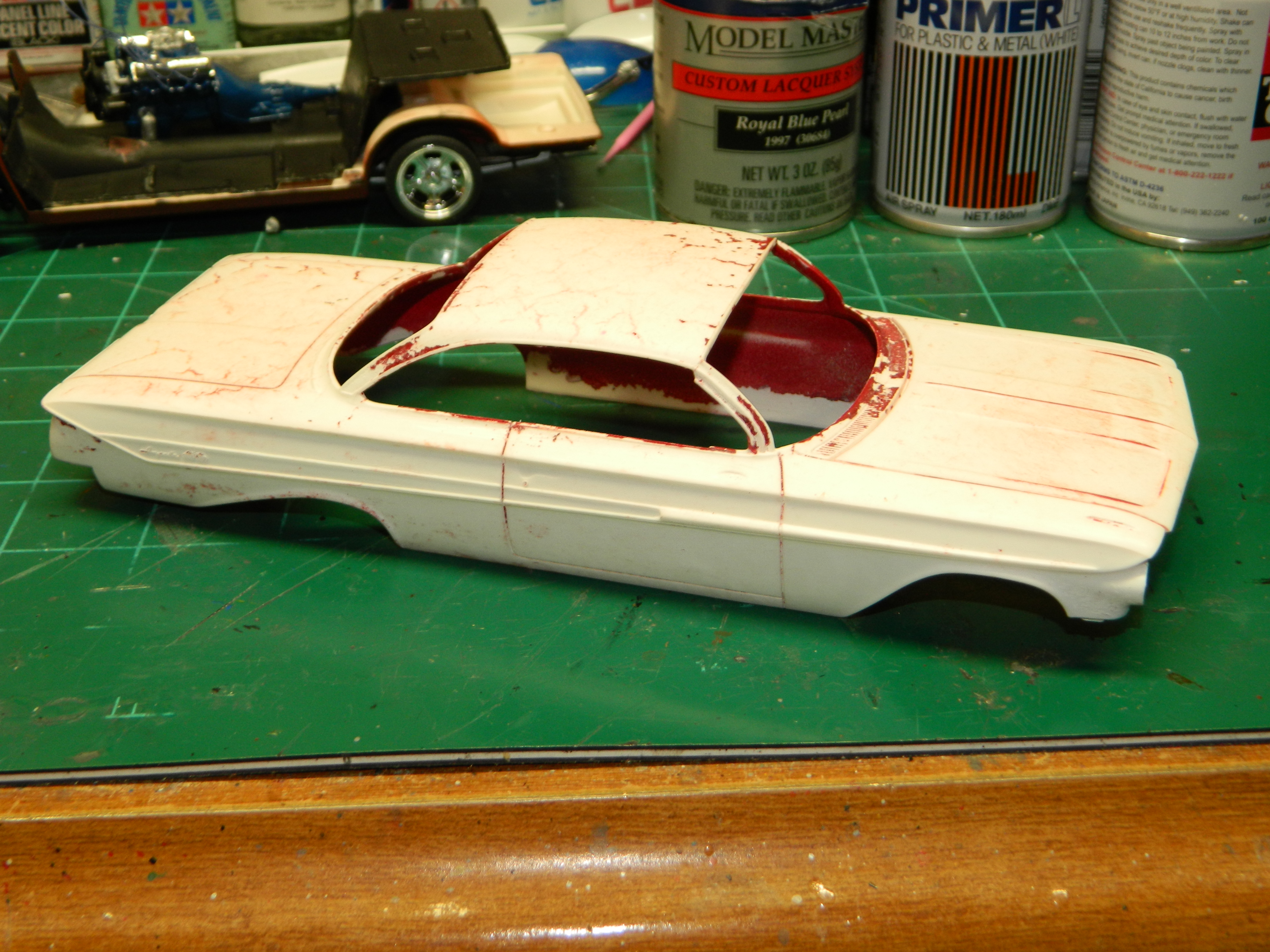

mrmike Posted July 18, 2019 Author Posted July 18, 2019 Well, it has been about 4 weeks since I last posted about the '61 Impala SS409. Just for the heck of it, I placed the model into a plastic box and covered it completely with Easy-Off Oven Cleaner and I left it for a week. I removed the model from the box last week and using a stiff bristle brush and Dawn dish detergent, I removed a good share of the paint. At some point and it will be much later, I'll sand off the remaining red Model Master paint, reprime with Dupli-Color White Primer and repaint with Dupli-Color Light Blue Metallic. Then we shall see if the paint dries completely.

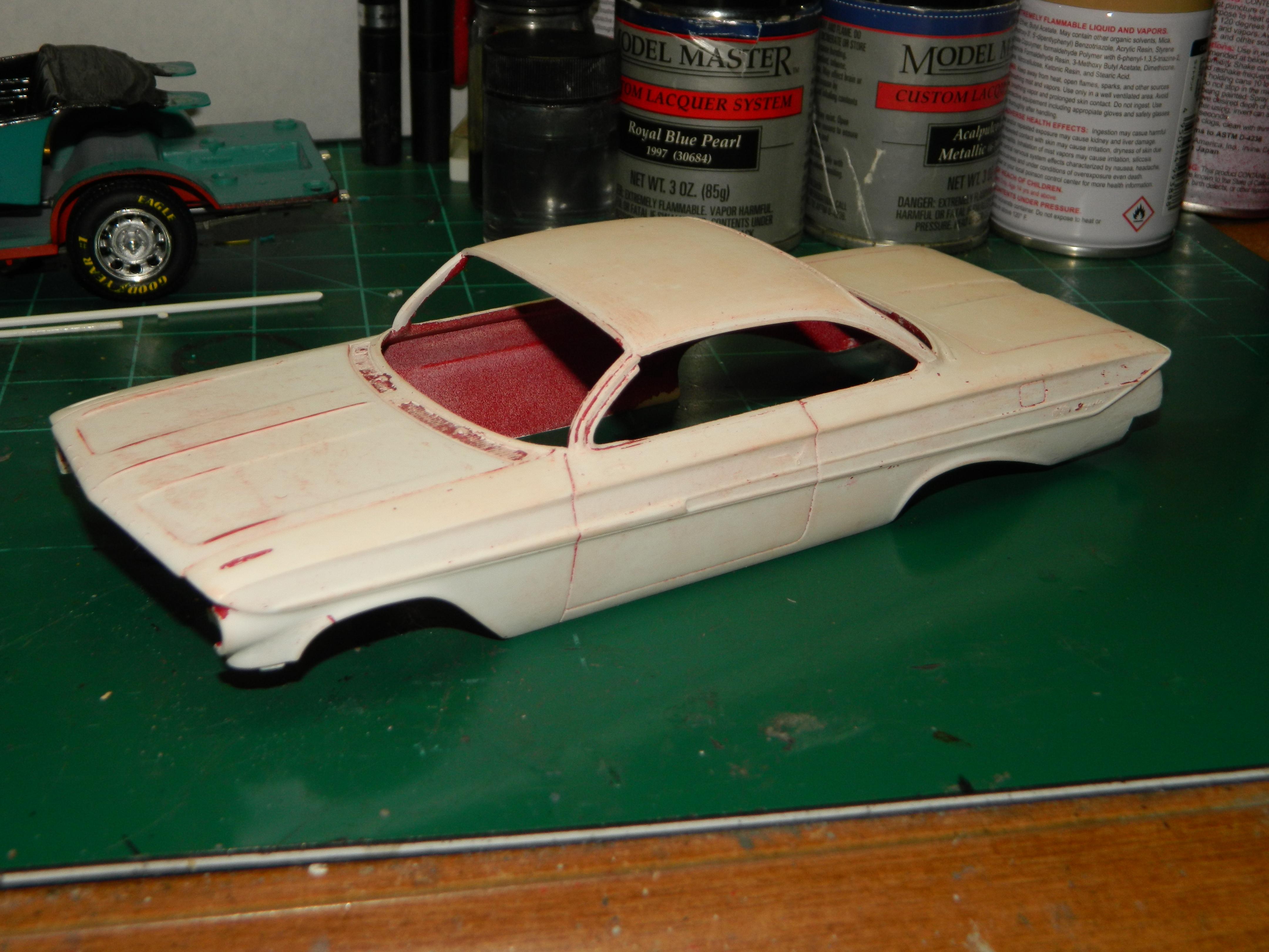

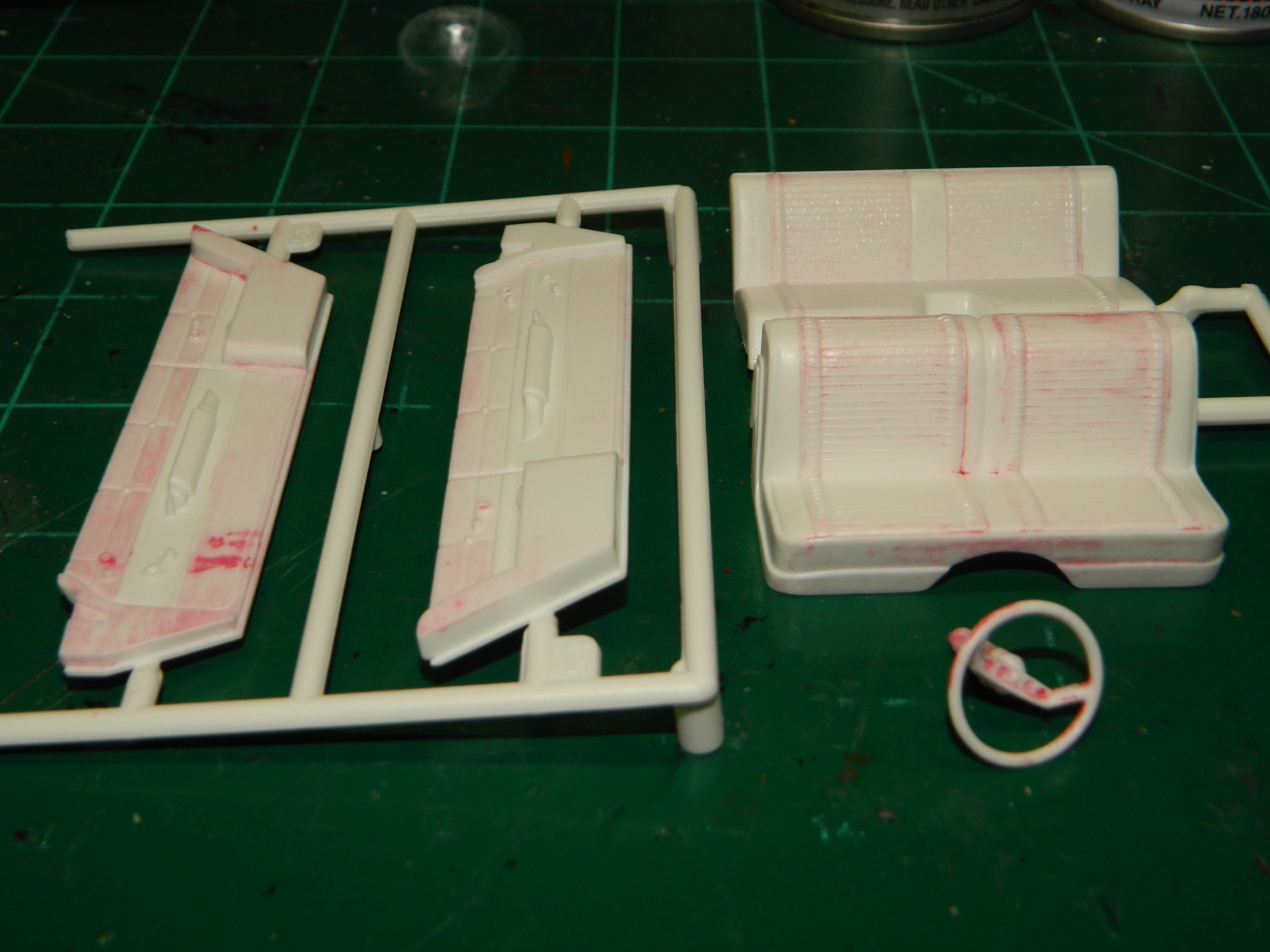

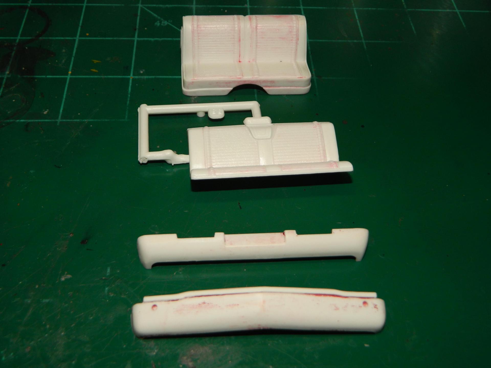

mrmike Posted August 21, 2019 Author Posted August 21, 2019 (edited) Remember me?!!! The '61 Impala SS409 was put away after I decided to strip the Flame Red paint since it had remained tacky to the touch. It has been out of sight, but not out of my mind. Tonight, I pulled the Impala off the shelf and started sanding and removing red paint from wherever I could...and I still have a long way to go. I am going to use Dupli-Color Light Blue Metallic for the body and interior. My goal is to have matching '61 and '62 Impalas. I have a '63 Impala SS in the stash and that will get the same color paint as the '61 and '62 Impalas. More Impala to come... Edited August 21, 2019 by mrmike

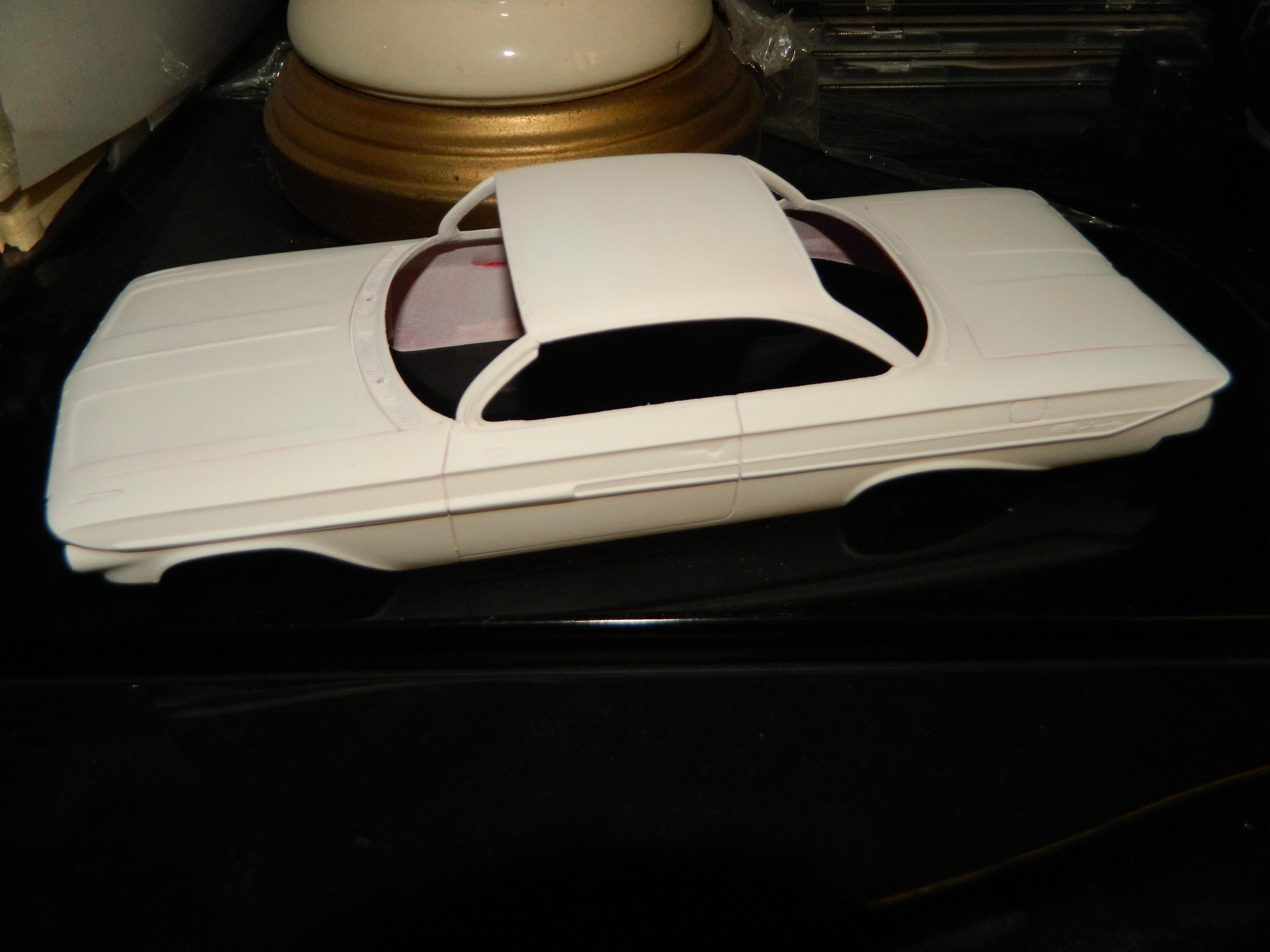

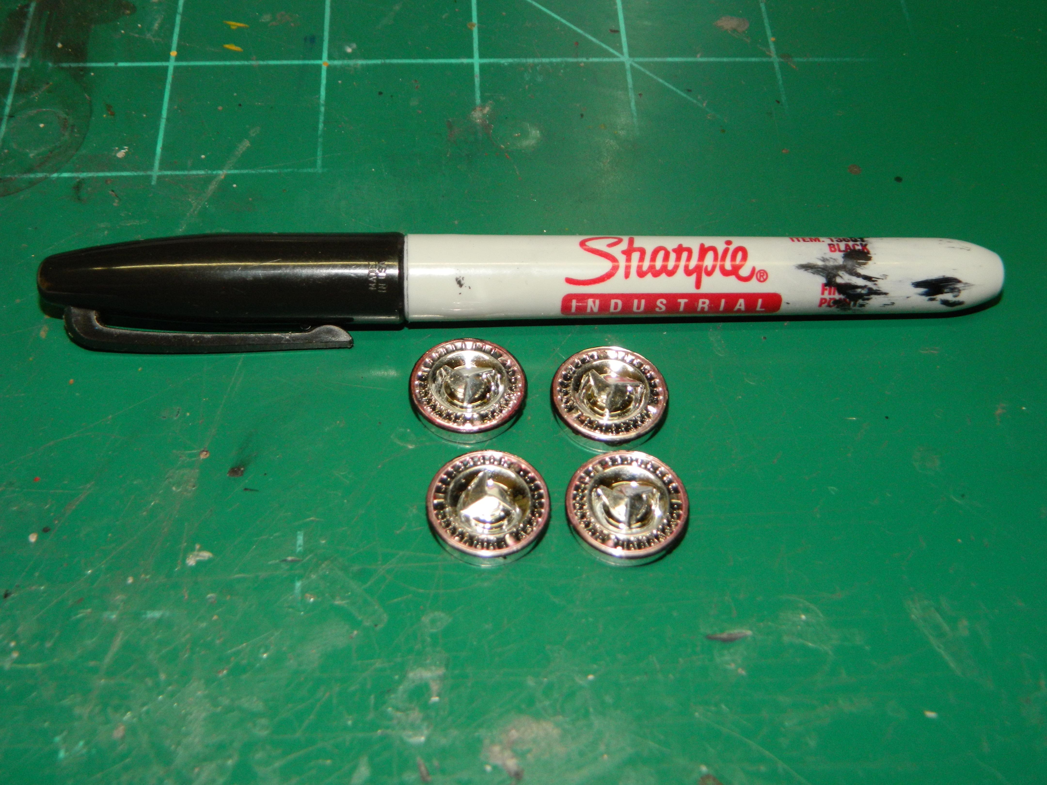

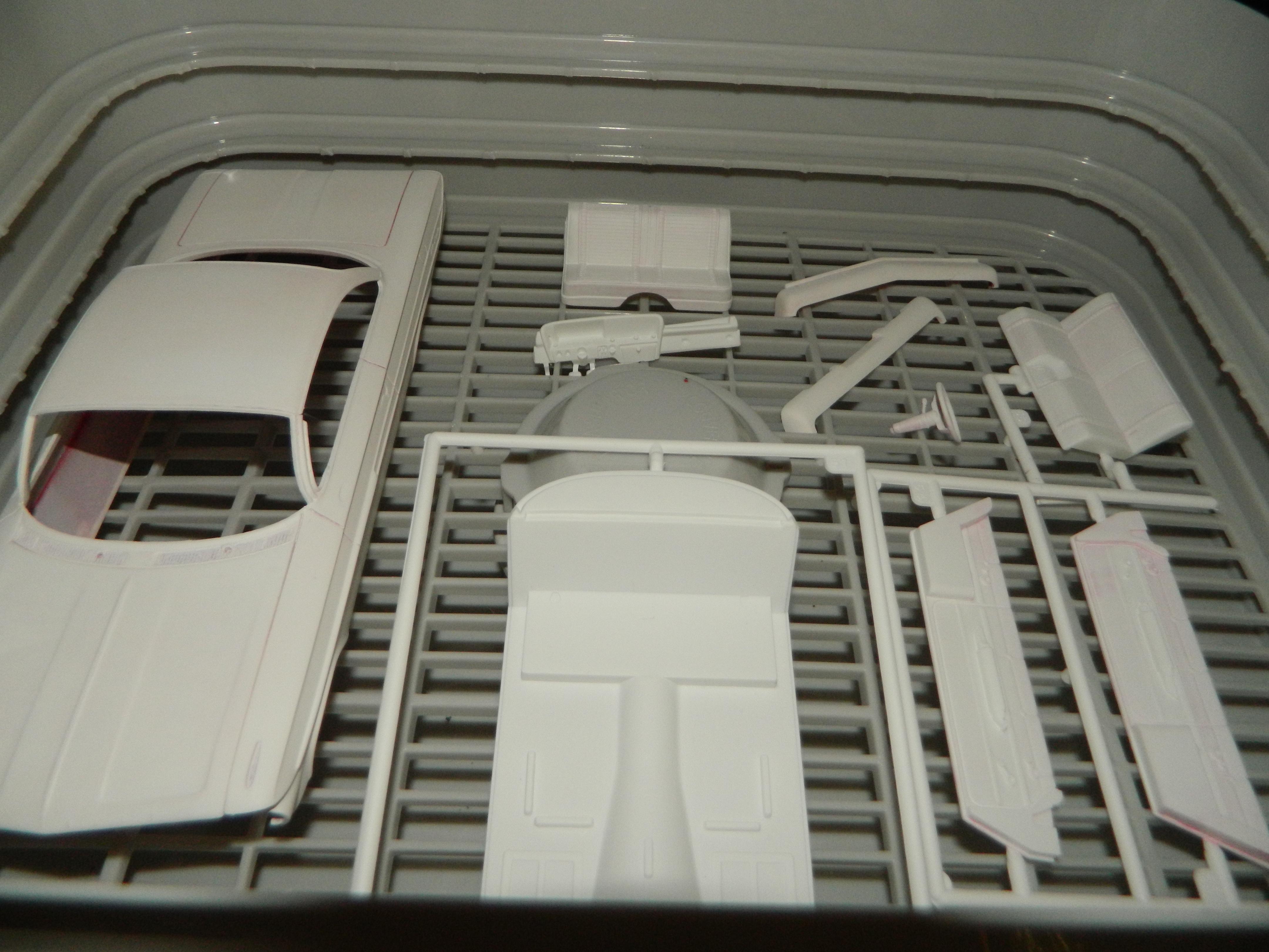

mrmike Posted August 22, 2019 Author Posted August 22, 2019 I primered the '61 Impala this morning with Dupli-Color White Sandable Primer and then I tossed everything into the dehydrator for the next 8+ hours. I had painted the wheel cover edges with a red Sharpie and the blue Impalas had black rims. I repainted the edges in black. More Impala to come...

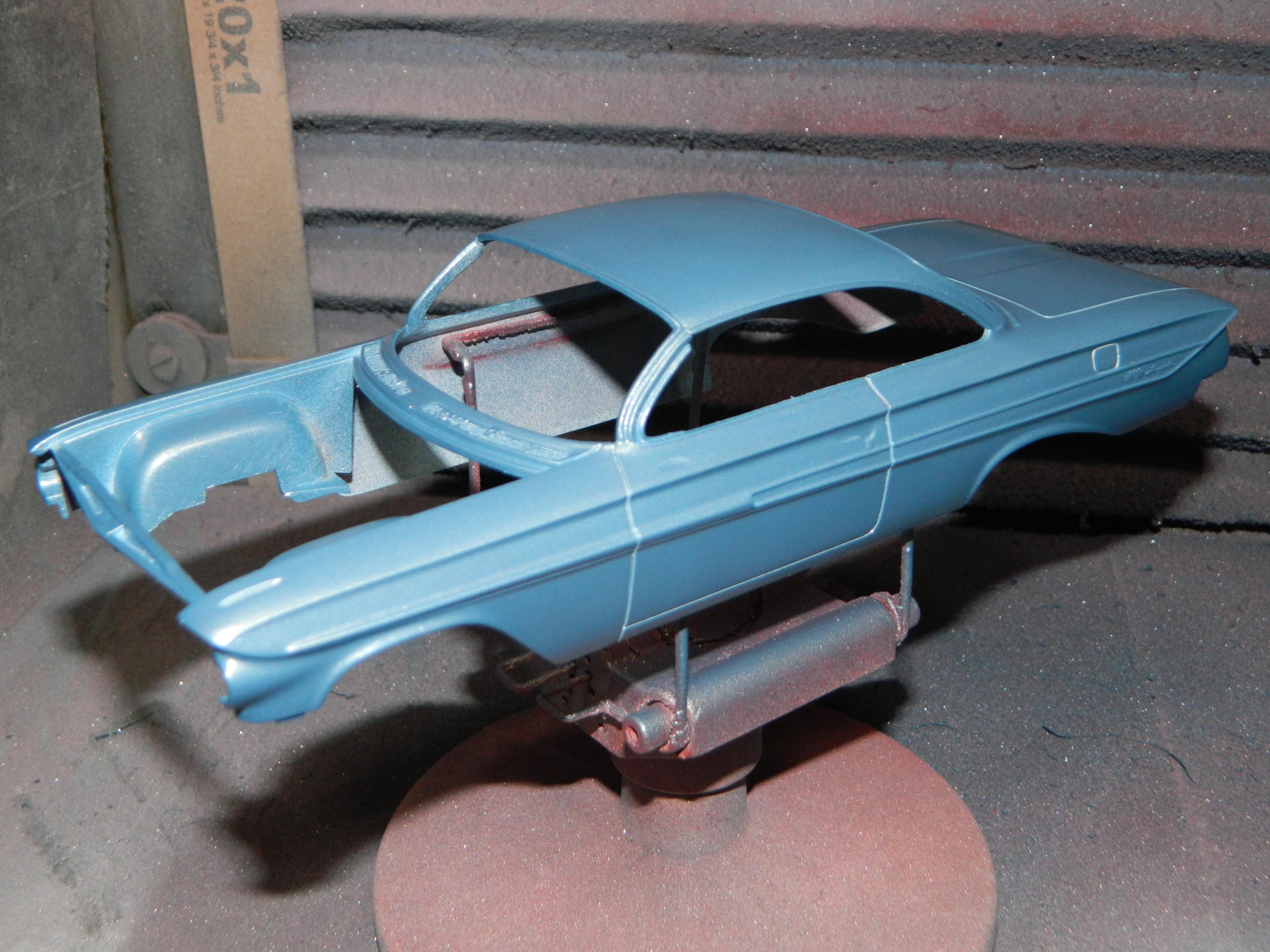

mrmike Posted August 23, 2019 Author Posted August 23, 2019 Now that the primer is nice and dry from sitting for a day in the dehydrator, I painted the '61 Impala this morning with Dupli-Color Light Blue Metallic and it looks pretty nice! More Impala to come...

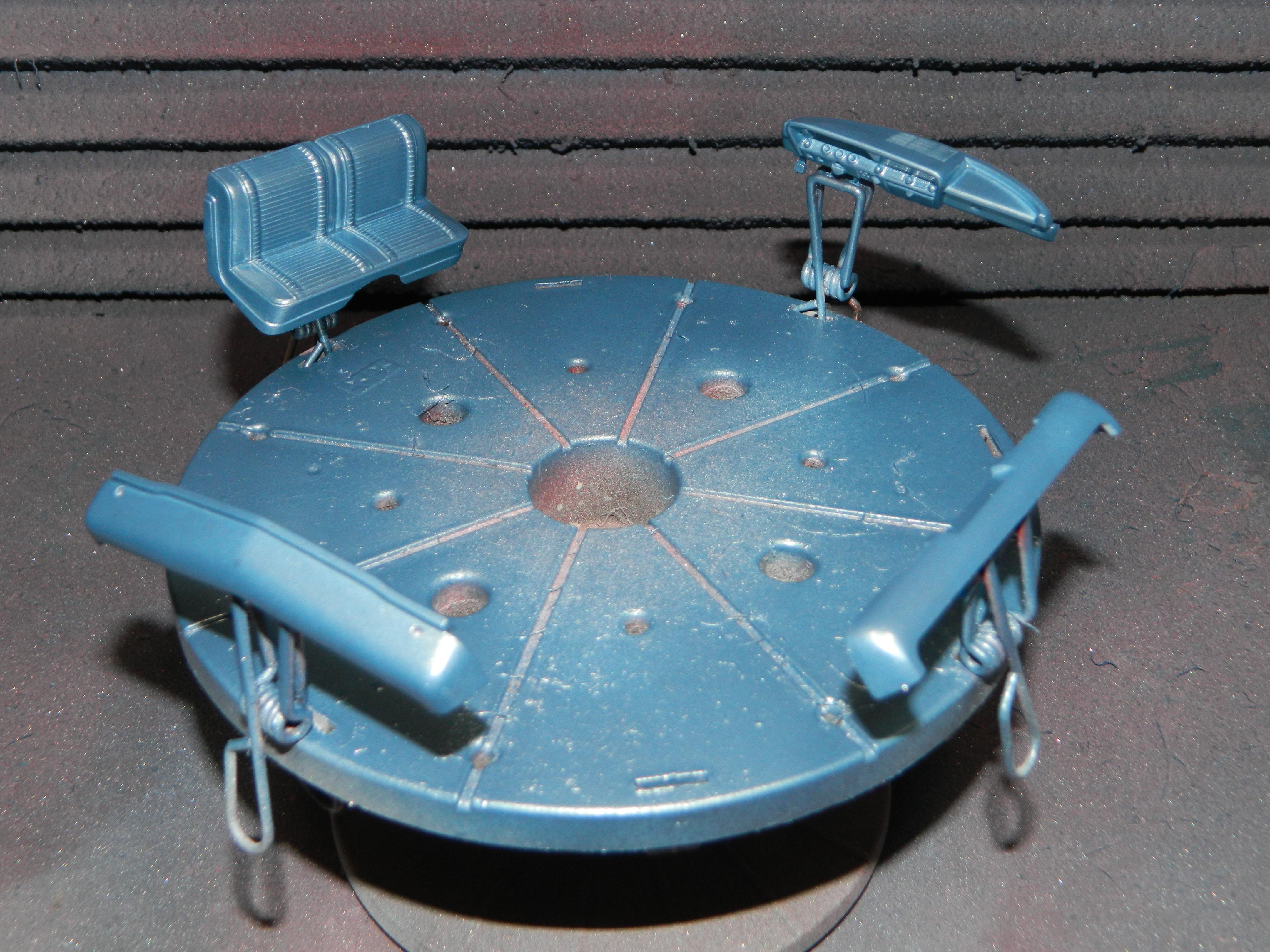

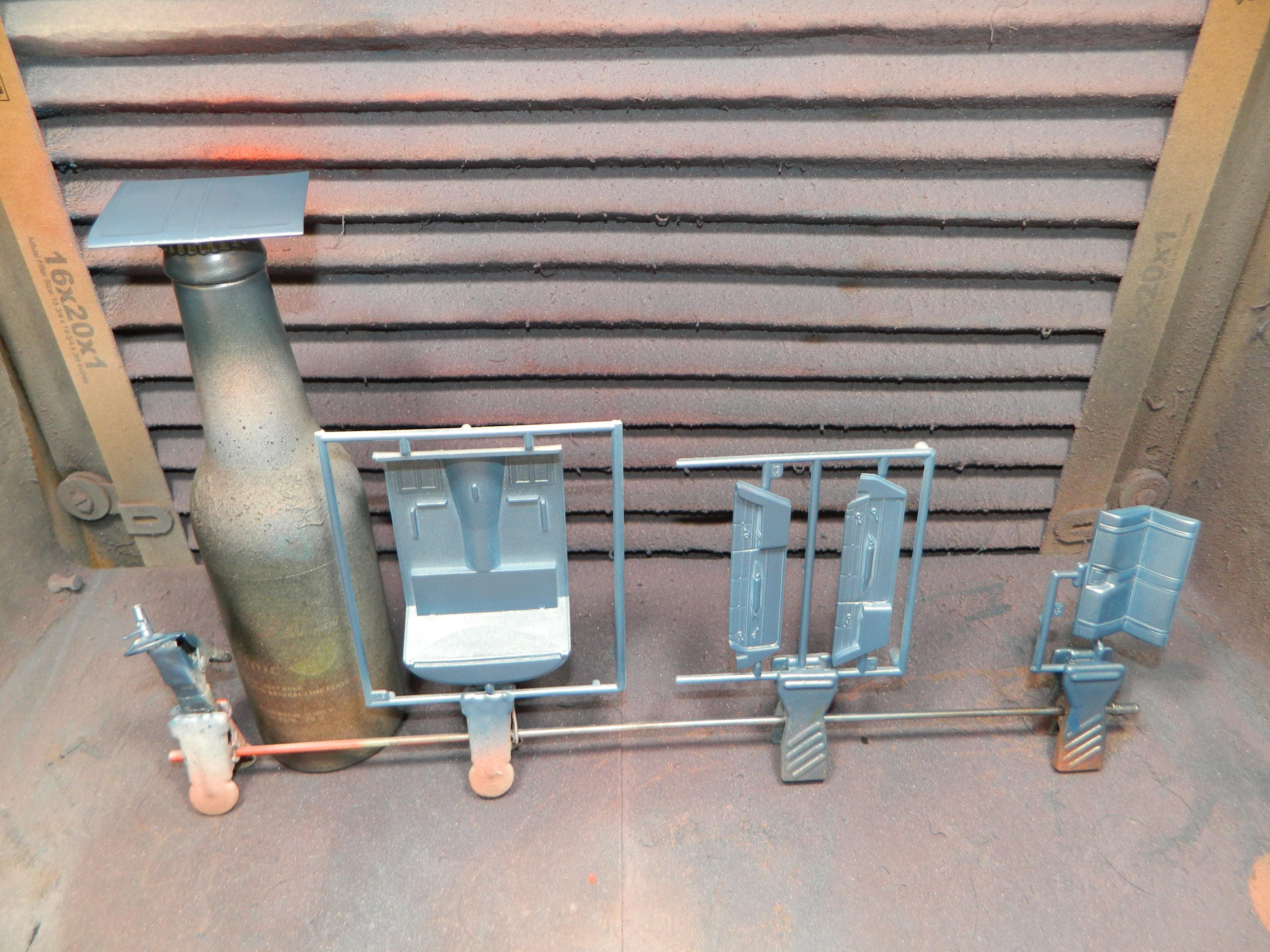

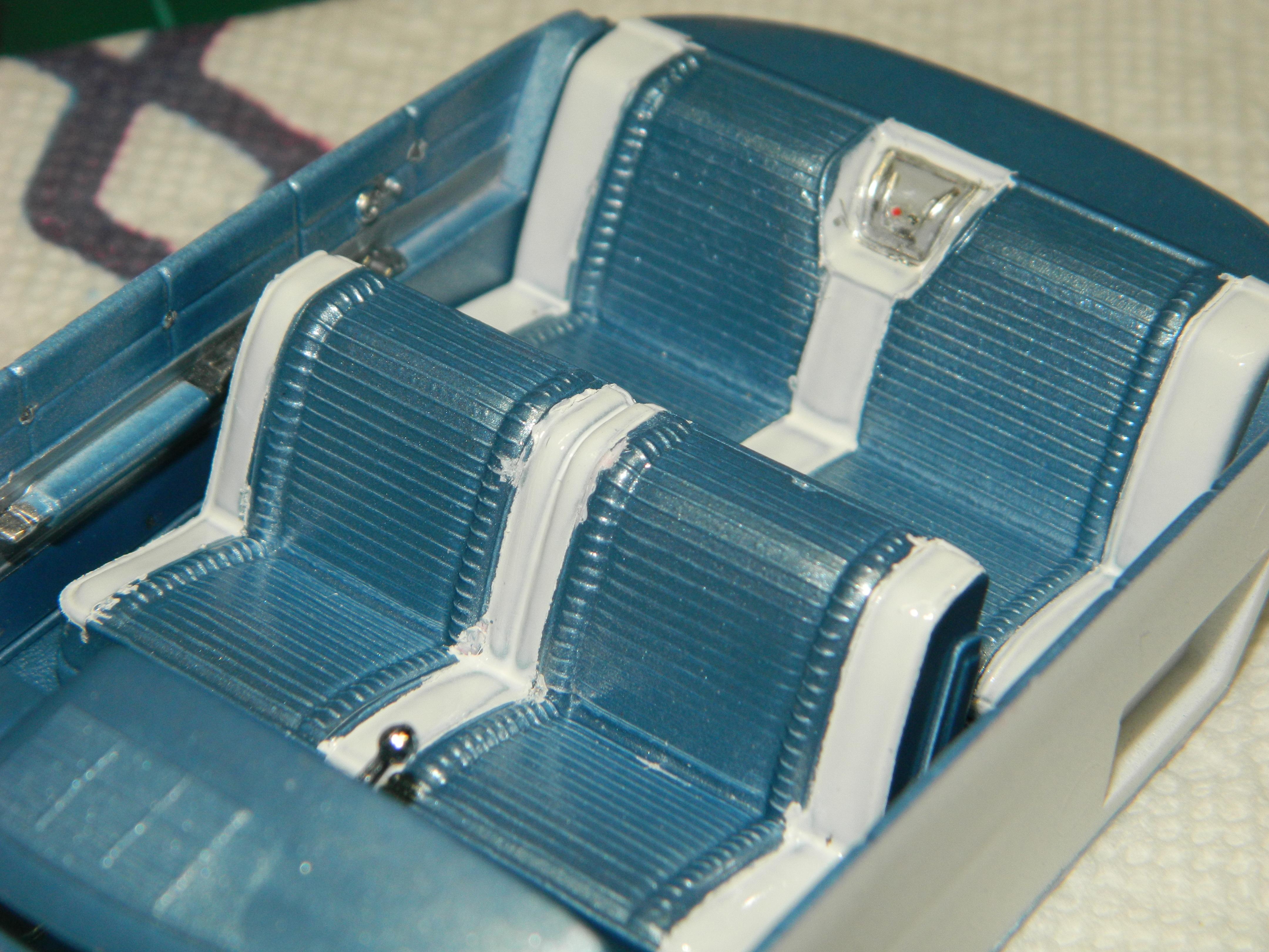

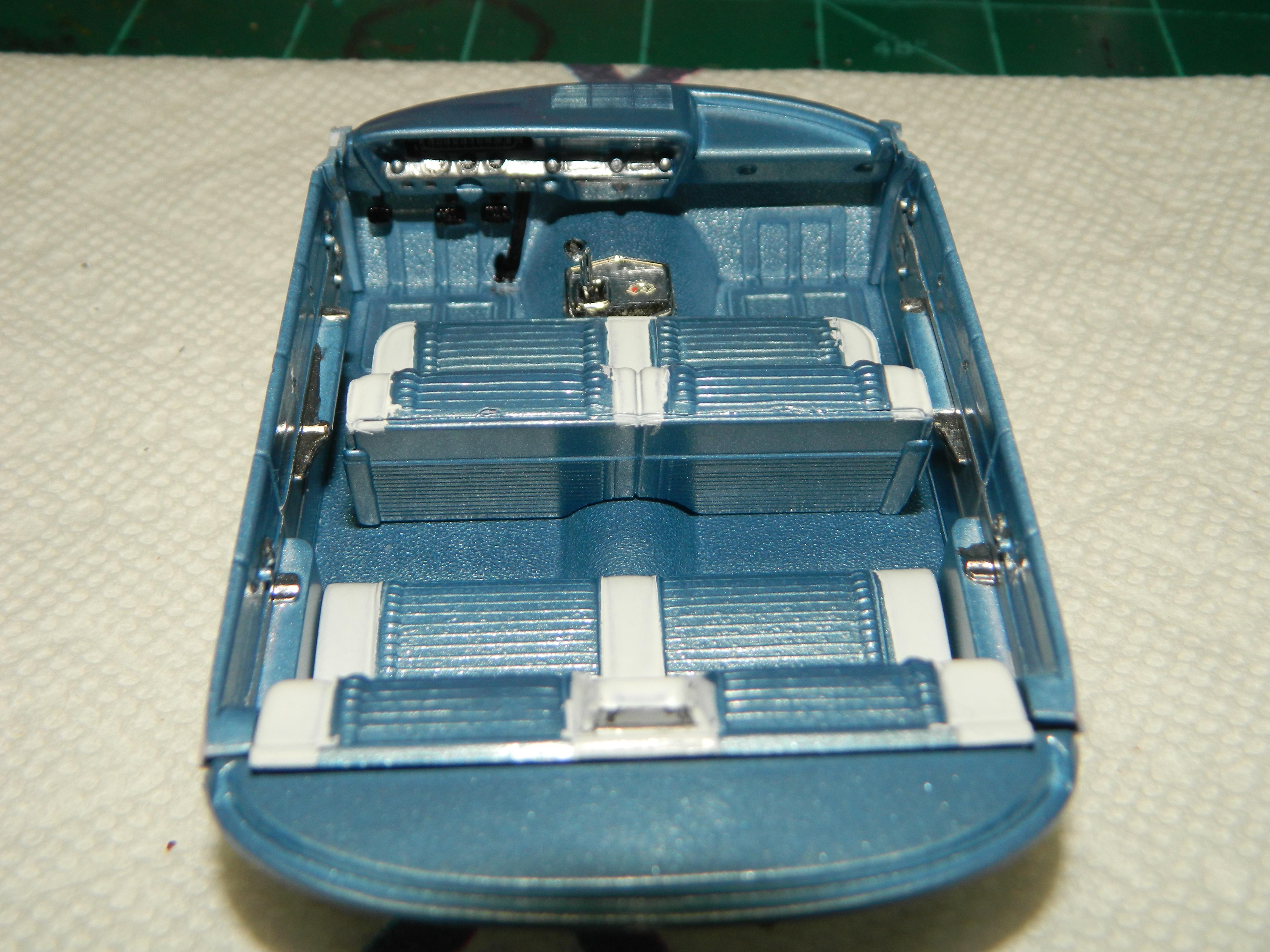

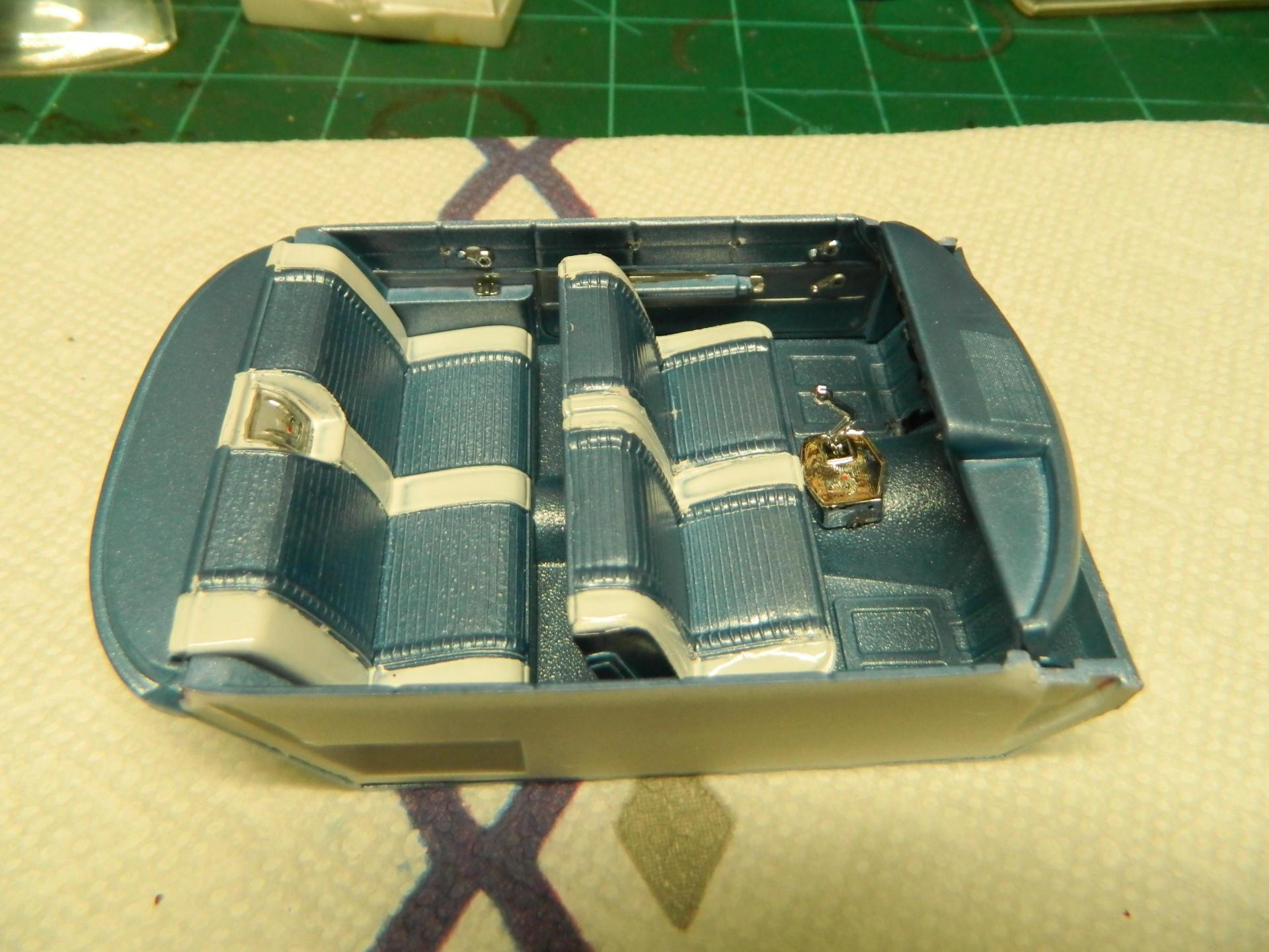

mrmike Posted August 31, 2019 Author Posted August 31, 2019 Assembly of the interior is almost done. I need to touchup the white and install the steering wheel. More Impala to come...
Ace-Garageguy Posted August 31, 2019 Posted August 31, 2019 Body looks great. Glad you were able to save it after the weird paint problem earlier.
mrmike Posted August 31, 2019 Author Posted August 31, 2019 Thanks Bill! Weird is right as I have never had a problem like that before. A friend of mine had the same prolblem when he was building a Lindberg '66 Chevelle SS 396 years ago, so we must have had the same plastic in our kits.
