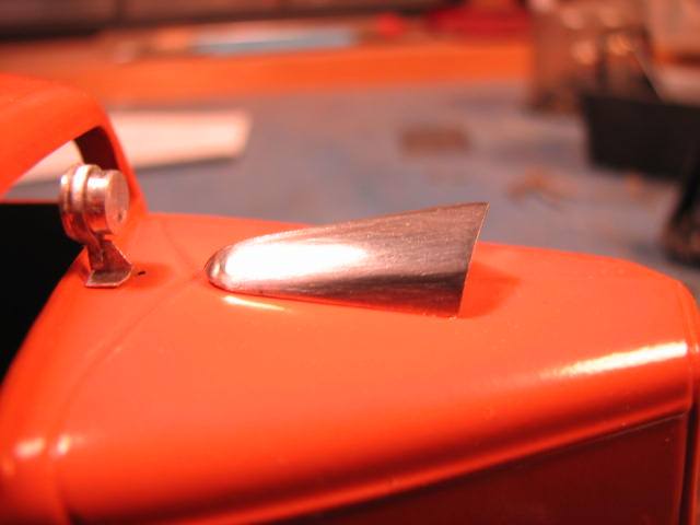

Straightliner59 Posted February 17, 2019 Posted February 17, 2019 I use 5"X7" aluminum flashing. It has a plastic coating that needs to be sanded off, but it's worth the effort. Once it's annealed (if your application requires it), you can do anything with it, if you're patient. It's .005" thick, which, while a bit out of scale, looks better than plastic for things like dragster bodies, and provides more rigidity for things like firewalls, interior panels, dashes, etc.

Straightliner59 Posted March 14, 2019 Posted March 14, 2019 48 minutes ago, Bainford said: Have you measured the thickness? I’d be curious to know how thick it is. I use a lot of pie plate and beer can aluminum of various thickness, but always looking for new sources of material. .005". Technically, that's a little thick for dragster bodies, but, it looks great. WAY better than kit provided plastic bodies. I use it for dashes, interior panels, and the hood scoop on my '34 coupe.
Bainford Posted March 14, 2019 Posted March 14, 2019 Cheers Straightliner. .005” will be good usable material. I like the work you’ve done there. I agree that sheet metal is much better than plastic for replicating panels and thin metal parts.
