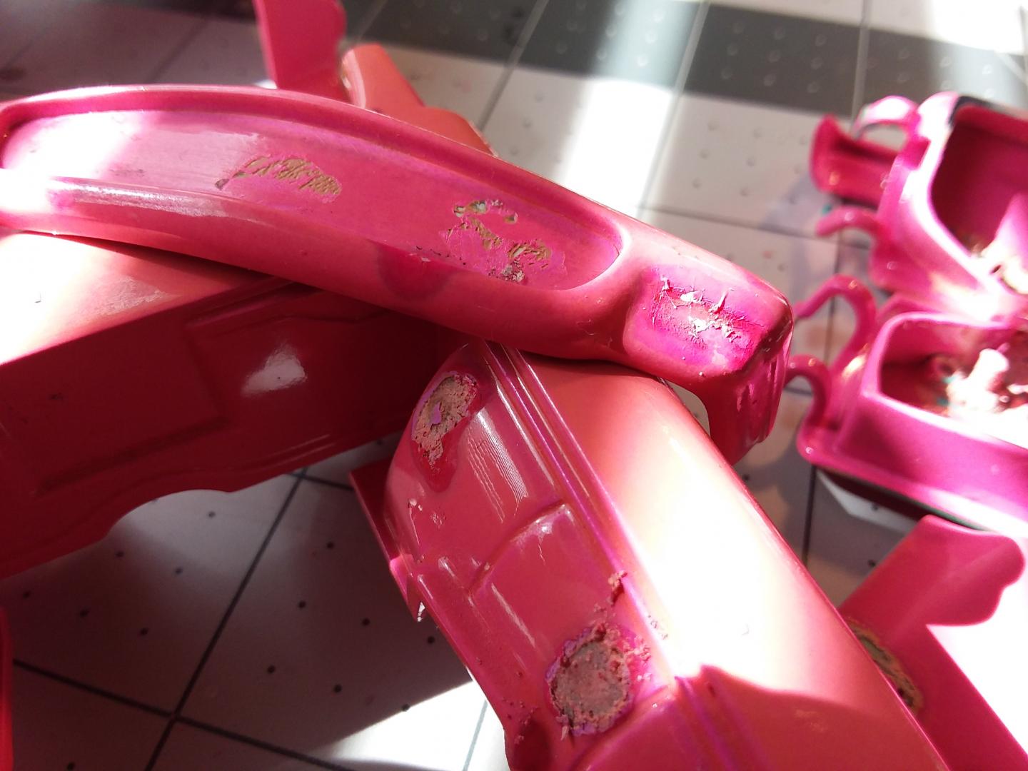

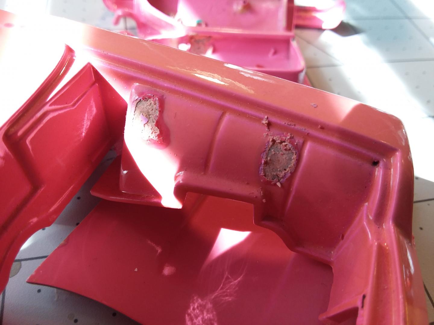

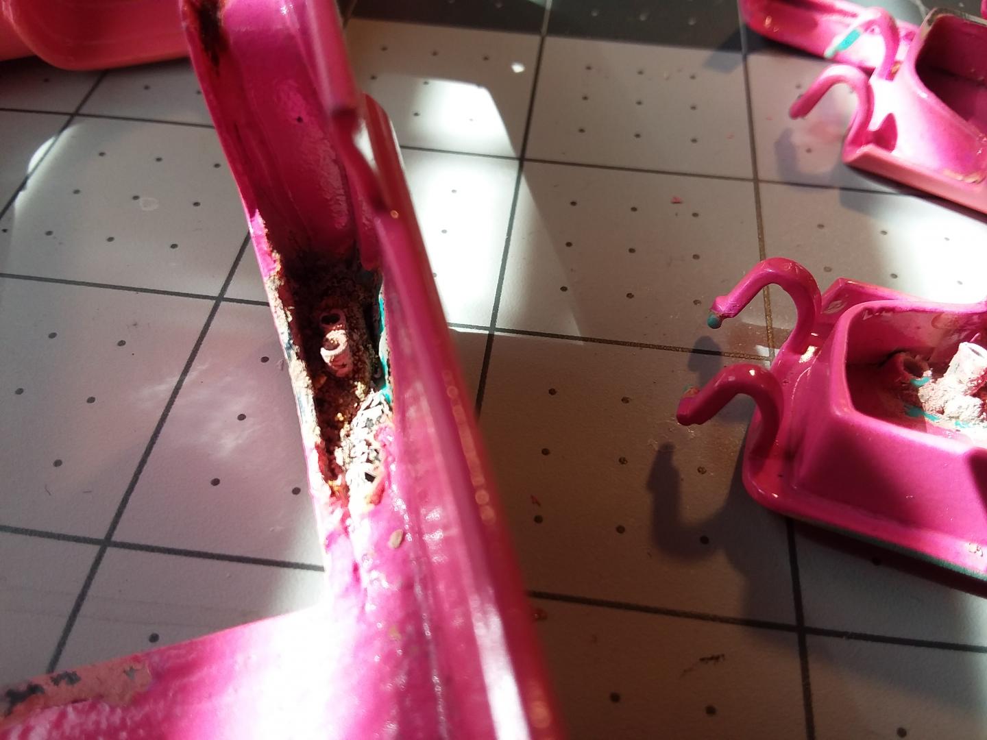

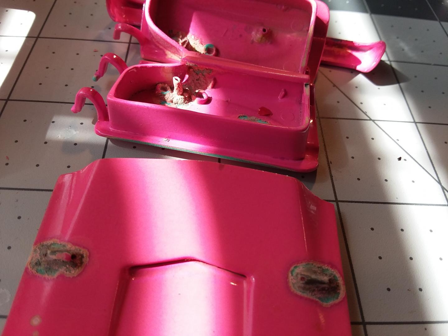

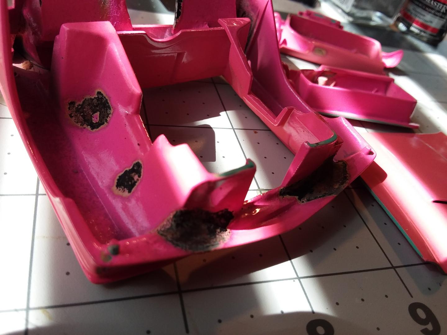

Pat Minarick Posted February 26, 2019 Posted February 26, 2019 (edited) I was looking for some pieces today and found this, this is the reason I will never use baking soda and superglue ever again. This is just a warning of what could happen , I know a lot of people use this , this was built in the early 80's so it's been getting worse over the years. It's just not worth taking the chance of using it anymore for me. Edited February 26, 2019 by Pat Minarick

Muncie Posted February 26, 2019 Posted February 26, 2019 Pat, is this plastic or diecast? It looks like it might be a chemical reaction with baking soda and the base material.

Pat Minarick Posted February 26, 2019 Author Posted February 26, 2019 18 minutes ago, Muncie said: Pat, is this plastic or diecast? It looks like it might be a chemical reaction with baking soda and the base material. It's plastic , Monogram 58 T-Bird.

peteski Posted February 27, 2019 Posted February 27, 2019 1 hour ago, 89AKurt said: Oh wow, thanks for showing this. You remember what brand glue? I've done this a lot, so will check out old projects. The glue is not the problem or cause of this - it is the baking soda. I've seen examples where the CA glue did not fully get soaked into the baking soda. When moisture (if you live in a humid climate) gets to that baking soda (through some pinholes in the glue), it will be absorbed by the baking soda (because it is water-soluble), and the whole mess will start oozing out. Bottom line is: using home-brewed solutions is not always good idea.
Pat Minarick Posted February 27, 2019 Author Posted February 27, 2019 28 minutes ago, peteski said: The glue is not the problem or cause of this - it is the baking soda. I've seen examples where the CA glue did not fully get soaked into the baking soda. When moisture (if you live in a humid climate) gets to that baking soda (through some pinholes in the glue), it will be absorbed by the baking soda (because it is water-soluble), and the whole mess will start oozing out. Bottom line is: using home-brewed solutions is not always good idea. You are definitely correct about the moisture being the problem. St. Louis weather changes from hour to hour.

Ace-Garageguy Posted February 27, 2019 Posted February 27, 2019 14 hours ago, peteski said: The glue is not the problem or cause of this - it is the baking soda. I've seen examples where the CA glue did not fully get soaked into the baking soda. When moisture (if you live in a humid climate) gets to that baking soda (through some pinholes in the glue), it will be absorbed by the baking soda (because it is water-soluble), and the whole mess will start oozing out. Bottom line is: using home-brewed solutions is not always good idea. Exactly. 51 minutes ago, Jantrix said: I did some baking soda in acrylic craft paints for rust and had some weird BLAH_BLAH_BLAH_BLAH grow out of it after a year or so. I use baby powder now. Baby powder is talc (hydrated magnesium silicate) and usually, cornstarch. Though not as hygroscopic as baking soda (which swells and turns to a solid block in the box as it absorbs moisture), and though talc is used as an industrial filler in things like tires and paper, and was the original filler added to polyester resin to make "bondo", I'd still respectfully suggest you use the real catalyzed polyester or epoxy fillers available, if you want your work to look good in 10 or 20 years.
gman Posted February 27, 2019 Posted February 27, 2019 (edited) This thread made me worry- I did a bunch of work on a 48 Ford Woody frame back in 2001 or so, filling the majority of the seams with baking soda and superglue mixture, with some of the easier access areas filled with Evercoat. This was an unfinished, stalled project that has been sitting in a drawer since the work was done. All of the sanded glue/baking soda seams were painted before being put away. Seeing as I live in an area that gets a lot of moisture with relatively high humidity, I pulled them out just now to see the carnage that has festered in the last 18 years: It looks like I got lucky- no funny reactions. Maybe the fact that they were sealed up with paint shortly after finish sanding saved the parts with baking soda and superglue. Edited February 27, 2019 by gman
Ace-Garageguy Posted February 27, 2019 Posted February 27, 2019 3 minutes ago, gman said: This thread made me worry- ...It looks like I got lucky- no funny reactions. Maybe the fact that they were sealed up with paint shortly after finish sanding saved the parts with baking soda and superglue. Yup. Bondo applied to real cars will absorb moisture and allow rust to form under it on the surface of the metal that's been repaired if it's left exposed and unsealed with primer and paint. Most likely, you got a good coat of paint that sealed the surface of your banking soda-superglue mix.
gman Posted February 27, 2019 Posted February 27, 2019 39 minutes ago, Ace-Garageguy said: Yup. Bondo applied to real cars will absorb moisture and allow rust to form under it on the surface of the metal that's been repaired if it's left exposed and unsealed with primer and paint. Most likely, you got a good coat of paint that sealed the surface of your banking soda-superglue mix. ...as will certain primers over bare metal. The reason I was worried is because I used a large amount of superglue/baking soda filler on that frame. I have been using superglue (Zap a Gap +) and baking soda as filler for small areas since the 80's without finding a science experiment forming on my model, but I usually spray primer and paint over finished areas fairly soon after finish sanding. I do the same over Evercoat 2 part filler, and used to do so over the old Squadron putties that I gave up on decades ago. I have a '67 Impala somewhere that had some sink marks filled with baking soda and superglue mixture that remains unpainted. I'll have to find it and have a look at how it looks today, once I figure out where my "business agent" hid the box.
Ace-Garageguy Posted February 28, 2019 Posted February 28, 2019 17 hours ago, gman said: ...as will certain primers over bare metal. The reason I was worried is because I used a large amount of superglue/baking soda filler on that frame.... Yup. About the only real-car primer that stops that and can be left exposed indefinitely is epoxy. Naturally, the best of the best was a Sherwin Williams concoction from the 1980s that's no longer made. Far as the baking soda / CA goes, the deciding factor, as with the deterioration of many man-made materials like some vinyls, cellulose-based acetate promos, rubber, and lycra, will be how high the average relative humidity was and for how long.

Tom Geiger Posted February 28, 2019 Posted February 28, 2019 Yes, baking soda is a no-no. Having a saline base, it absorbs moisture from the air. I used baking soda for rust early on, then I noticed a damp spot on the model during the summer. Now I will use fine sand for my rust particles. It's rock so it's inert.
Ace-Garageguy Posted February 28, 2019 Posted February 28, 2019 (edited) 2 hours ago, Tom Geiger said: Yes, baking soda is a no-no. Having a saline base, it absorbs moisture from the air. I used baking soda for rust early on, then I noticed a damp spot on the model during the summer. Now I will use fine sand for my rust particles. It's rock so it's inert. Though baking soda is "a salt" it is not "salt" to which the word "saline" refers. High school chemistry. Edited February 28, 2019 by Ace-Garageguy
