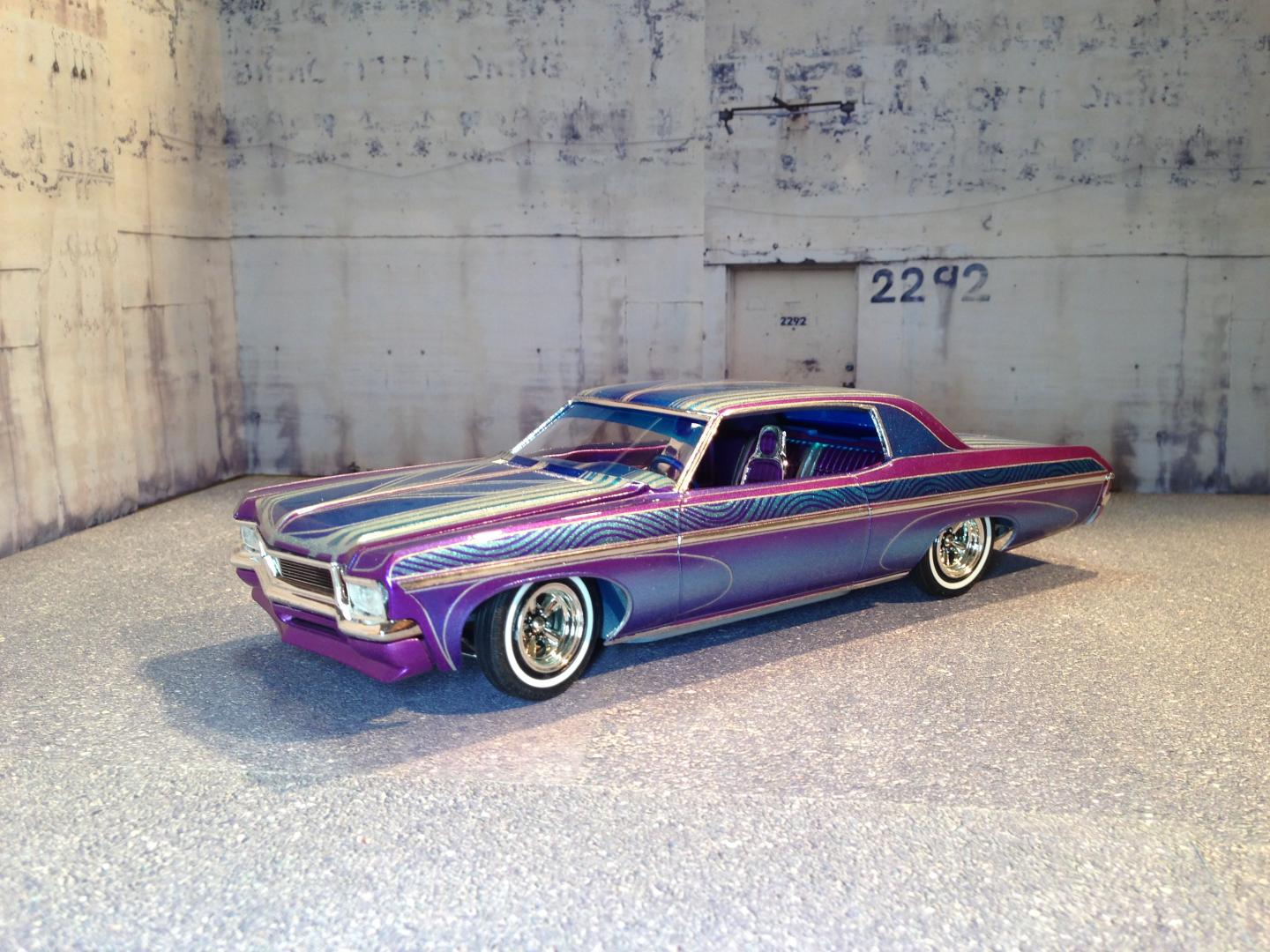

geetee66 Posted March 2, 2019 Author Posted March 2, 2019 Thanks for your interest, guys. I've done a couple before and I'm managing to make them slightly more complex, each time. I recently did this 70 Impala. I'm hoping to improve on this. 3 hours ago, TarheelRick said: OK you have my interest. I am going to presume it is going to be multi-shades of red. Hope you show details of the masking/painting process. 2 hours ago, Modlbldr said: I've been wanting to do some.lowriders for the same.reasons. The paint jobs are amazing and I want to improve my painting skills too. I tried one a year ago on a 65 Impala and it didn't turn out well for me but I am not deterred. I have a 41 Chevy pickup that is my ultimate goal. I'll be watching your process so lots of progress pictures, please. Later- 1 hour ago, Rusty92 said: Lowriders are some of the most beautiful cars around in my opinion. The level of detail is just off the charts. I look forward to seeing more. You picked a great car to do. 1
1972coronet Posted March 2, 2019 Posted March 2, 2019 Quite looking forward to watching this baby come together , as I love what you did with that '70 Impala . ( I hope you're not married to the Daytons . At the risk of doing your crust in ; how about a set of period-correct wheels ? ) Keep up the great work !
R.D.F. Posted March 2, 2019 Posted March 2, 2019 1 hour ago, geetee66 said: Thanks for your interest, guys. I've done a couple before and I'm managing to make them slightly more complex, each time. I recently did this 70 Impala. I'm hoping to improve on this. All I can say is WOW.
Rusty92 Posted March 2, 2019 Posted March 2, 2019 Holy cow. That is very nice. I would be proud of that.

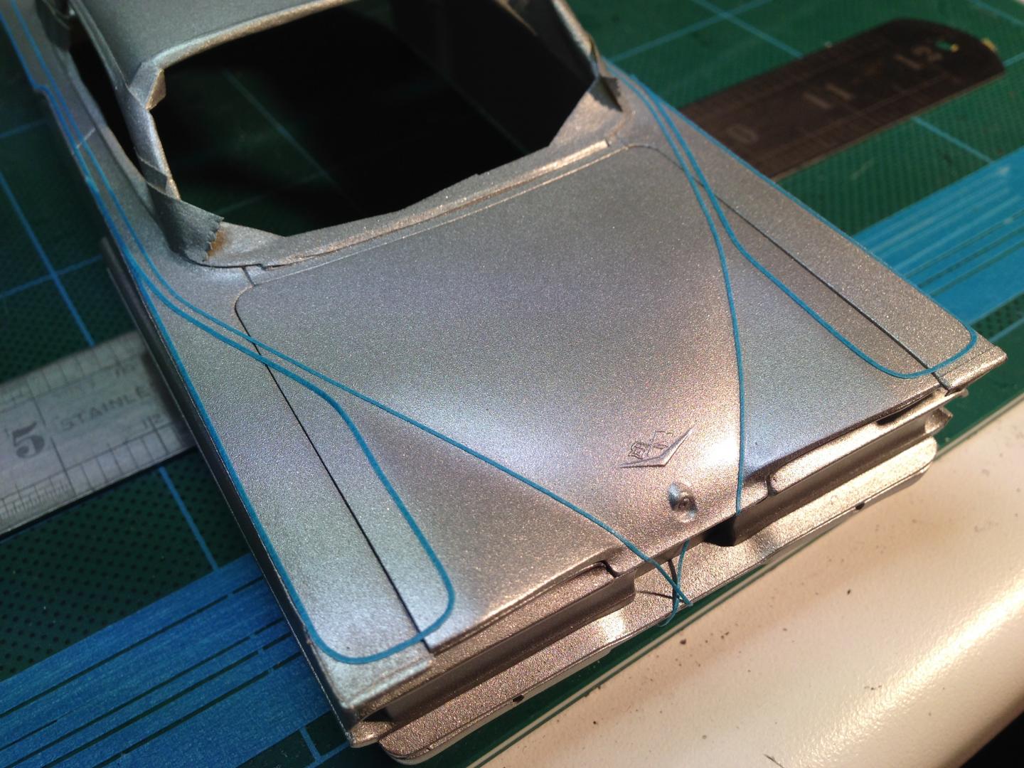

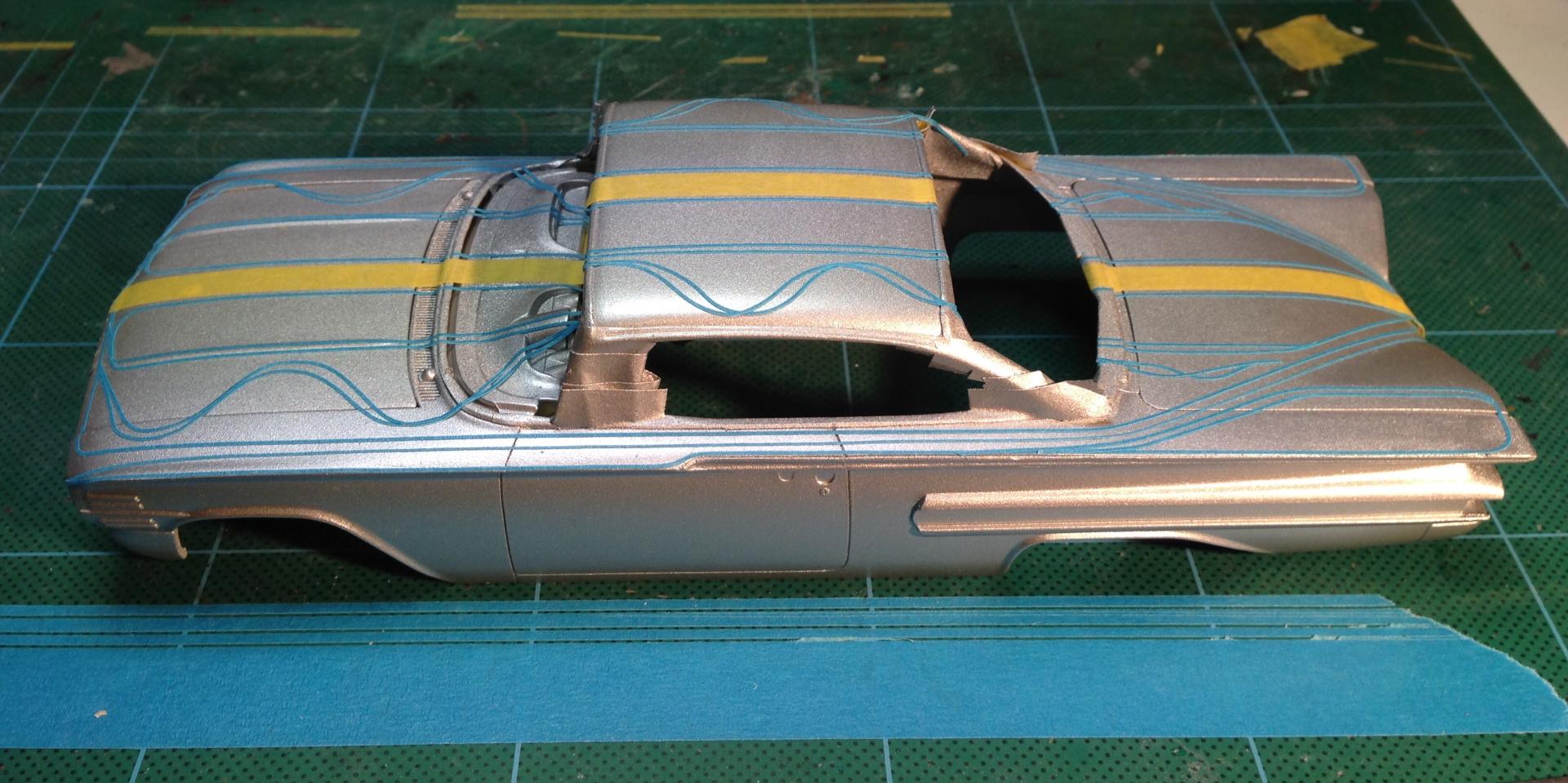

geetee66 Posted March 3, 2019 Author Posted March 3, 2019 Laid down some tape for the silver pinstripes. I'm having a think about how to proceed. I've been using 3M blue tape for the first time. It sticks well and allows for repositioning. Seems to be thinner and a bit stronger than Tamiya tape.

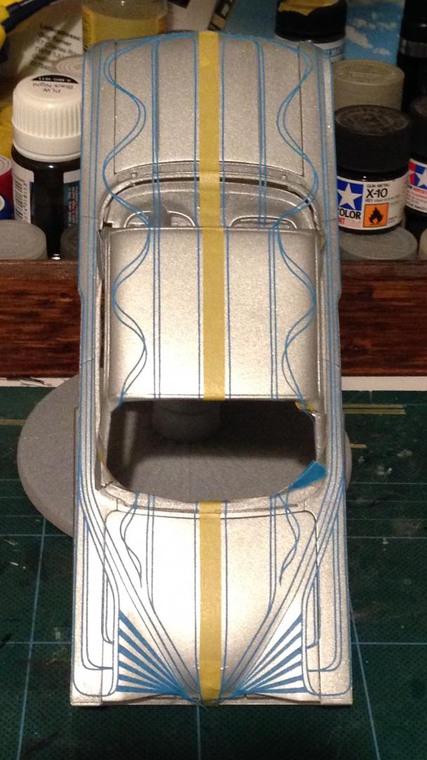

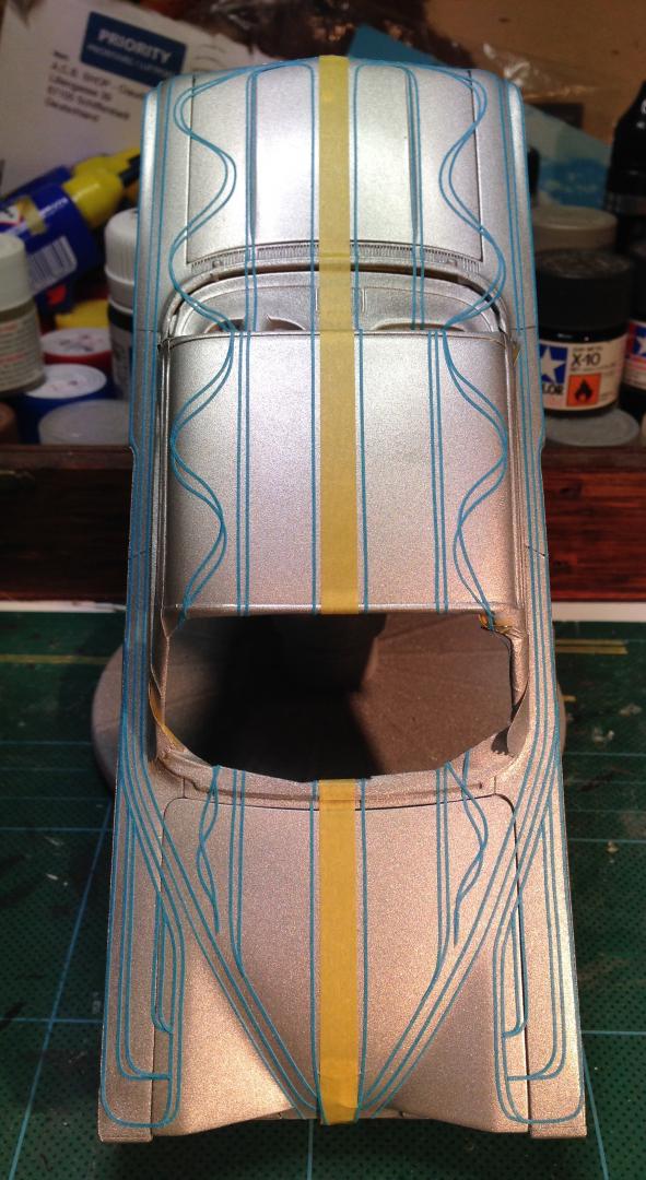

geetee66 Posted March 3, 2019 Author Posted March 3, 2019 Got more tape done. Hoping to lay down the background colour tomorrow night. then more tape!

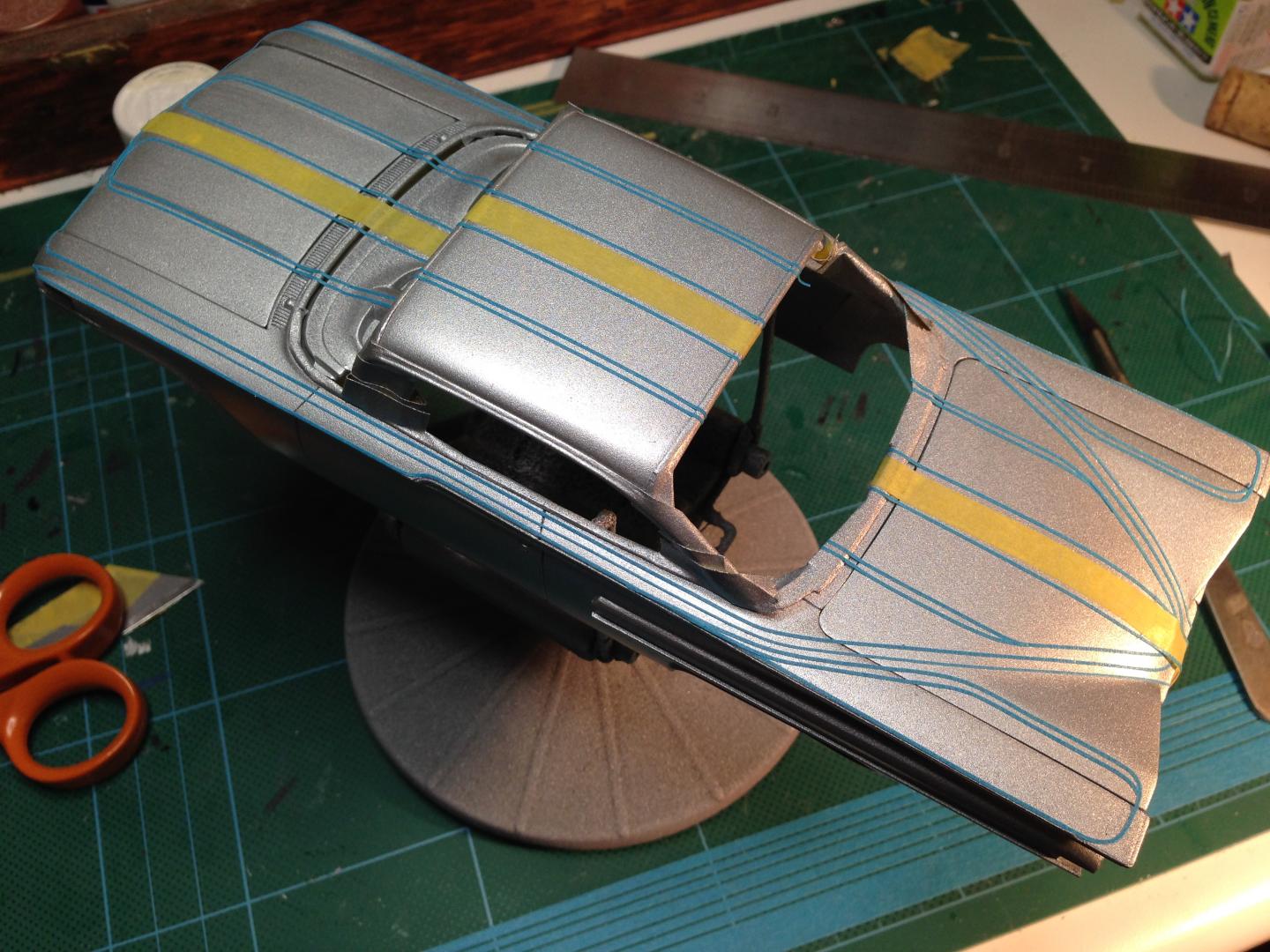

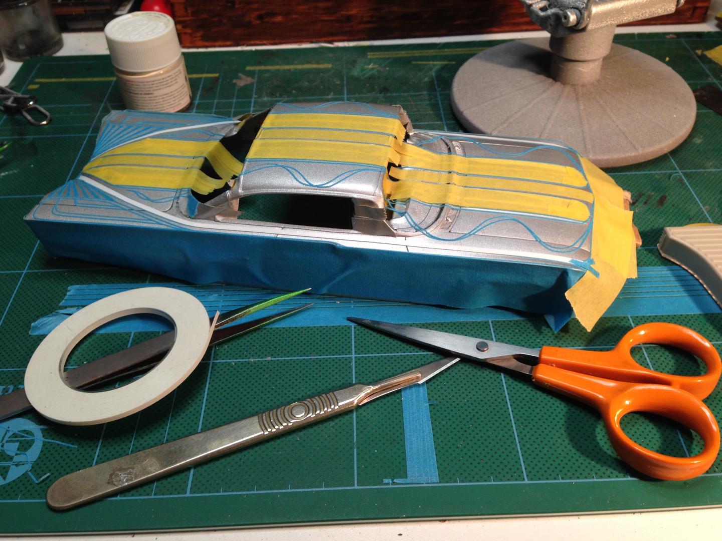

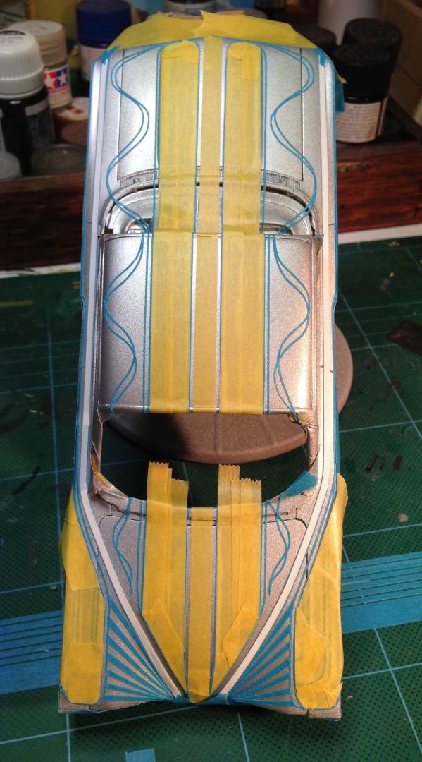

geetee66 Posted March 4, 2019 Author Posted March 4, 2019 3 hours ago, espo said: I enjoy watching you layout the tape patterns. Thanks! It takes a bit of thought. I sit and stare at it for ages before I put tape on. Here's a bit more. gotta decide which areas to mask to keep a silver base for red candy.

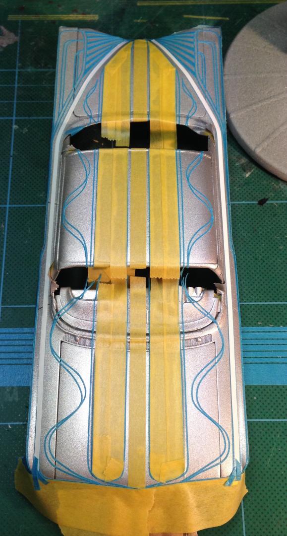

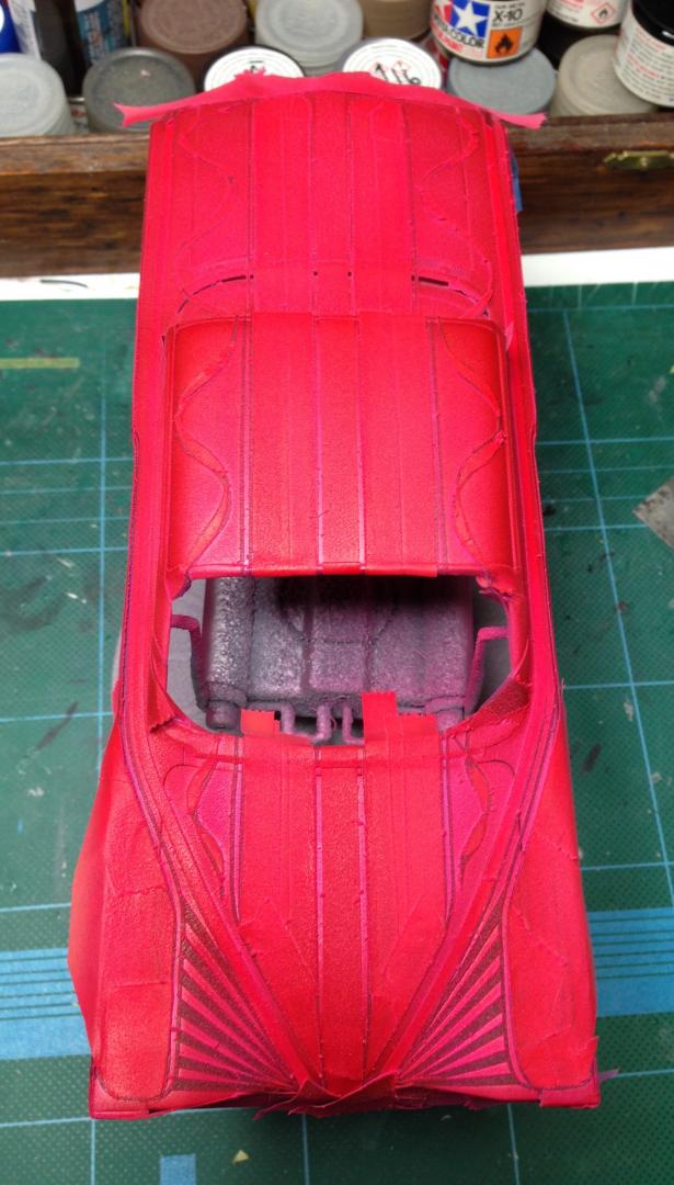

geetee66 Posted March 5, 2019 Author Posted March 5, 2019 Then shot some red nail polish through my airbrush. It came out a bit powdery in places, but it'll sand smooth. 1
