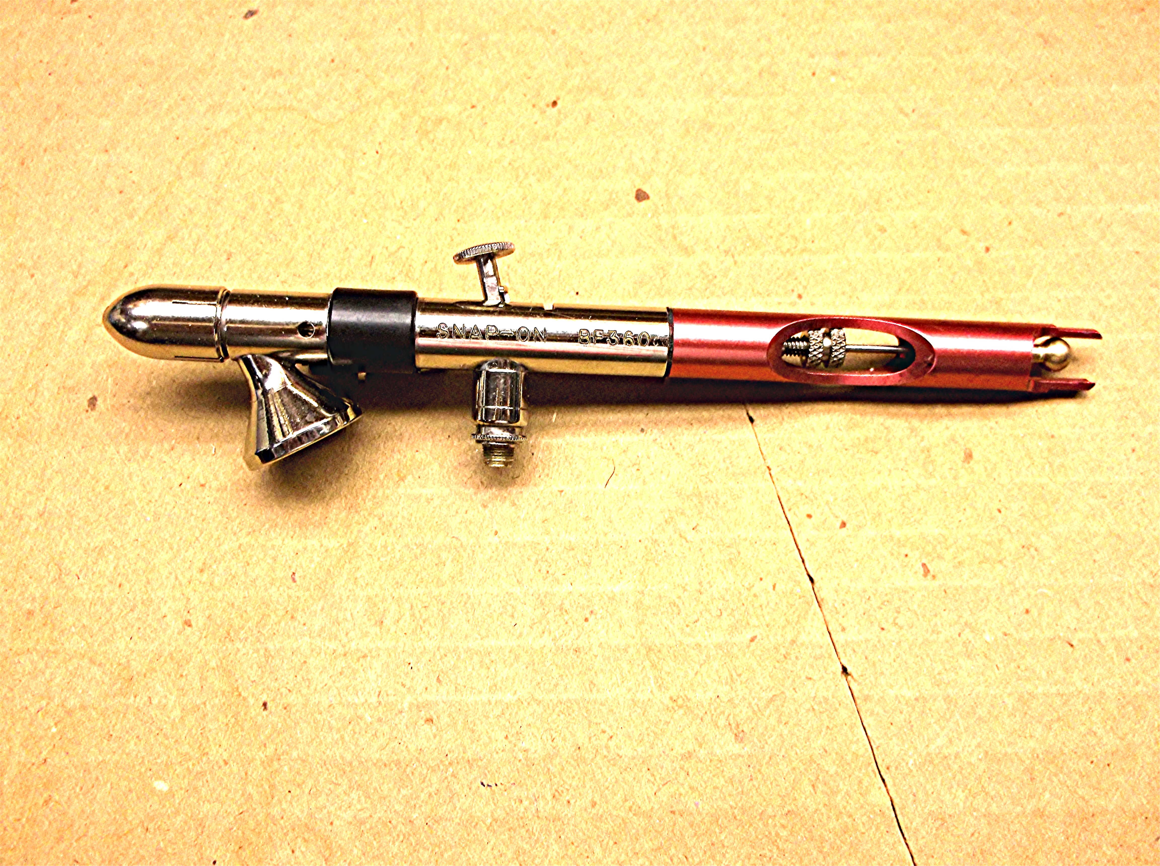

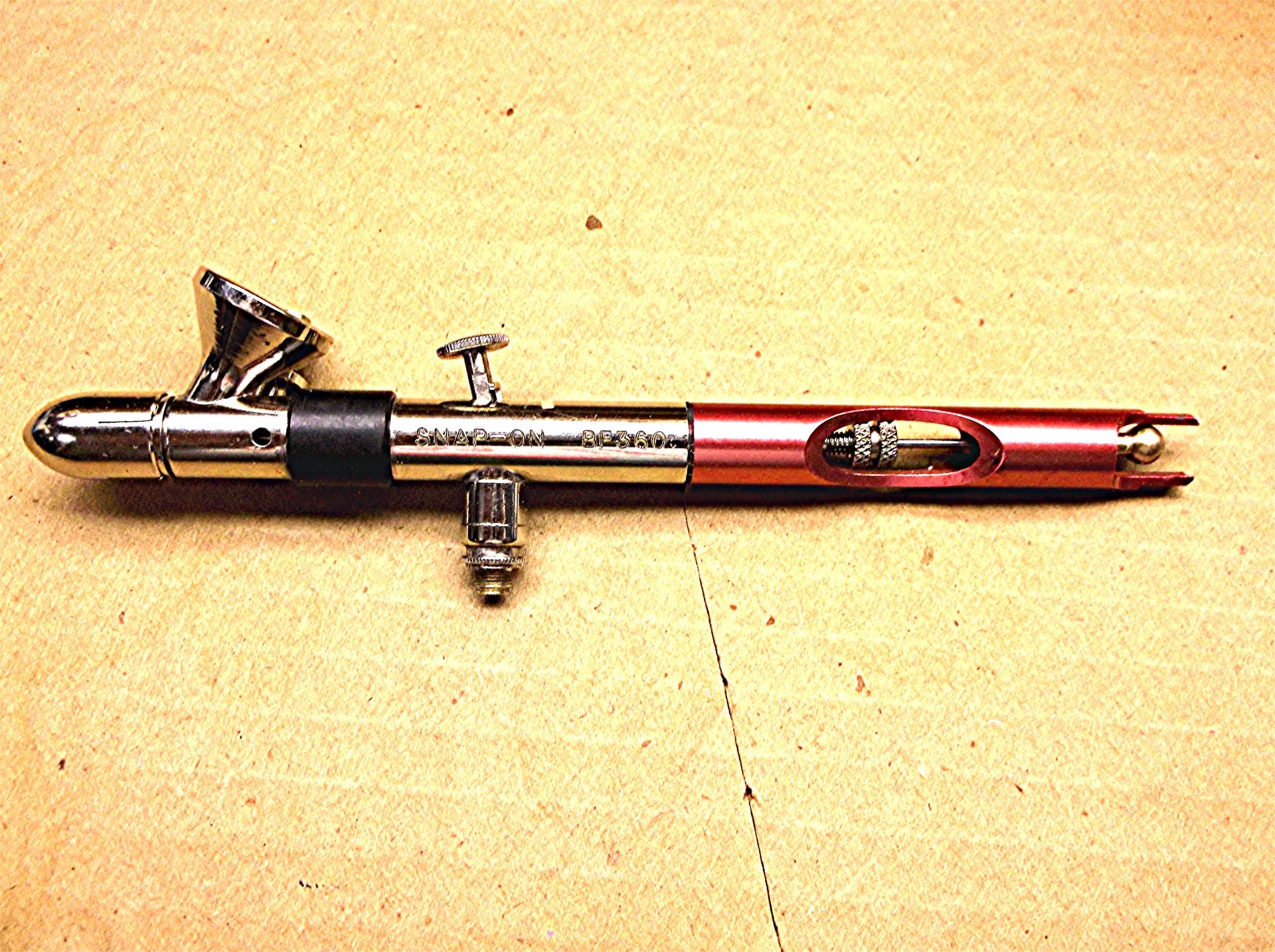

DPNM Posted March 14, 2019 Author Posted March 14, 2019 (edited) Here is one with a slight twist. It is a Snap-on (Badger) 360. It is both siphon feed and gravity feed. You rotate the head piece (twist it see what I did there?) for either siphon or gravity feed. It is described by Badger as being an all in one in that it will spray a fine line and also do a wide pattern. The one I purchased used needs a new tip. I plan to order some Badger parts with new tips as part of my order. 'Til then I have not been able to really test it yet. I read "Don's Airbrush Tips" on this model. He and another 360 owner both made larger "bowls" for the gravity feed. It is rather small. I am looking for a piece of stainless in the correct size but I've also thought that the glass from an e-cigarette may work. I will be experimenting. Don's review: https://sites.google.com/site/donsairbrushtips/badger-360 Thank you for sharing your trigger style 935k3. Edited March 14, 2019 by DPNM
