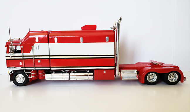

Mike77 Posted March 18, 2019 Posted March 18, 2019 Because of the separate roof piece I would've never attempted this with the Revell version. This one was made using the AMT Papa kit(s)...

CRUSADER2 Posted March 18, 2019 Author Posted March 18, 2019 Thanks guy's for your ideas, this site is a great source of information and help. Phil the L/h dash still might come in use full as all my builds are a mixture of American and Australian models supposedly running from Britain onto the continent, in theory they would spend more time driving on the right so a left hand drive would be more practical. Mike that's a great looking rig and proof that the AMT kit is a definite contender. Haken it seems like the Revell kit might be the better option of the two, the fact that the roof is separate is not a problem as I would have to cut this off any way to reduce the cab down to a standard length sleeper to fit the Australian version of the aerodyne roof, also the fact that it has a Cummins NTC 475 is another bonus as although all my trucks are on the edge of plausible for Europe I am trying to keep them in the realms of possible by assuming the transport company would try to standardise on engines/gearbox etc. Thanks again KJ and everybody for your help.

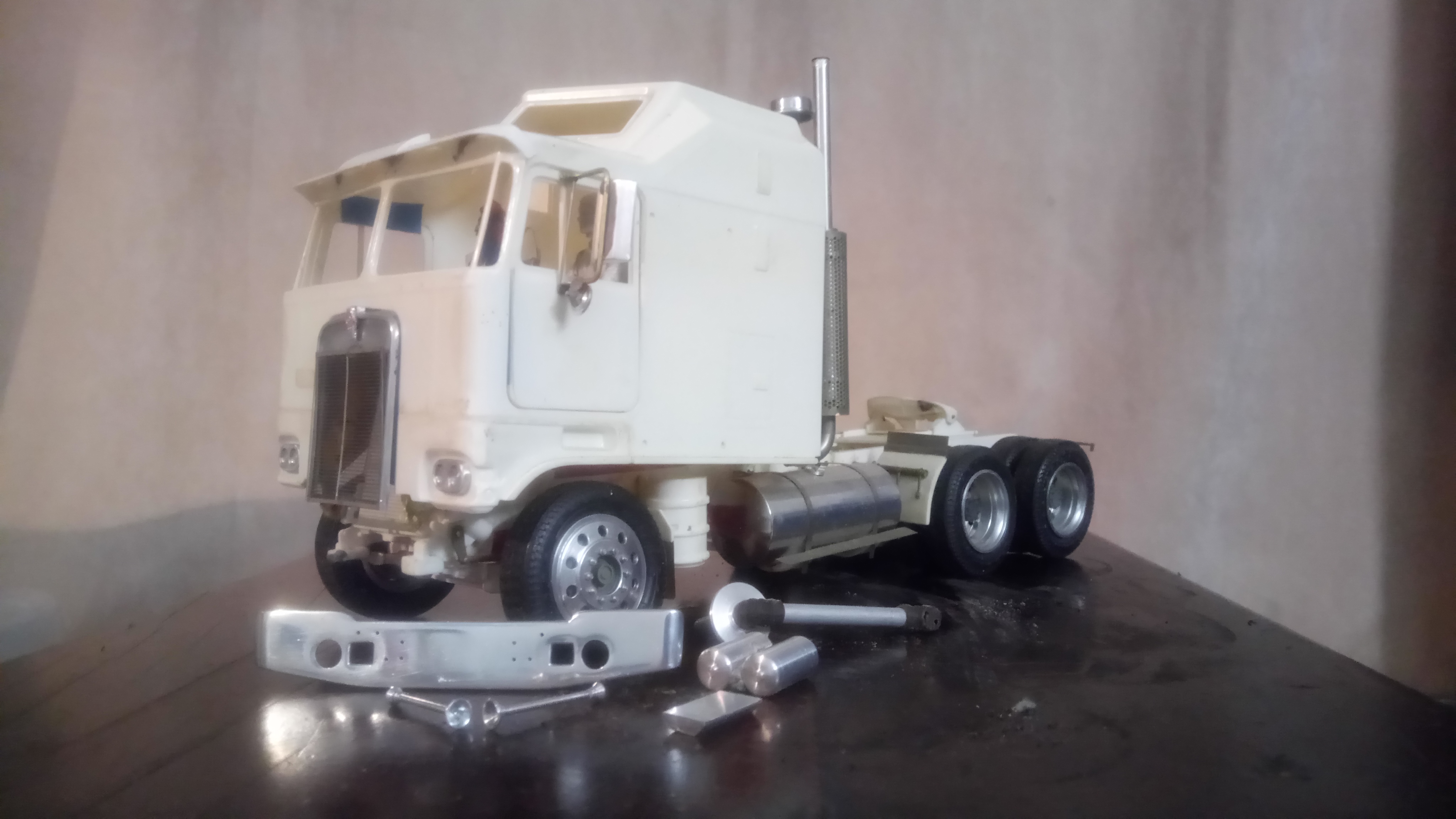

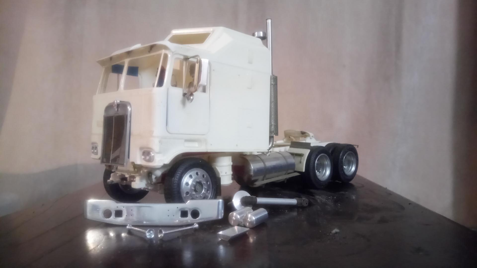

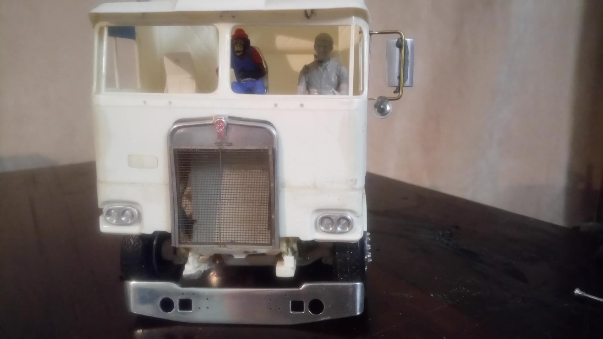

Yahshu Posted March 19, 2019 Posted March 19, 2019 (edited) This is being built with the the AMT kit. A very good friend of mine milled the grill surround & headlight housings (I still got some work to do on them) & the back of the bumper, he also machined the blind spot mirrors & fuel tank caps . The bumper & mirrors, I done by hand, got to make another bumper but Bear from the 1/32 BJ kit as a trade is worth it, scales out well. I machined the horns, fuel tanks, air cleaner parts & the twin tanks that go on the battery box. The grill is a CTM piece, the KW grill emblem was cut from a Double Take grill, not to happy with the foil & paint job I done so it will get redone when I finish sanding & polishing the grill surround. The rims are Micro Nitro with Ben Wicker hubs. 5 years building & counting. On 18/03/2019 at 8:24 PM, Mike77 said: This is awesome. Edited March 19, 2019 by Yahshu

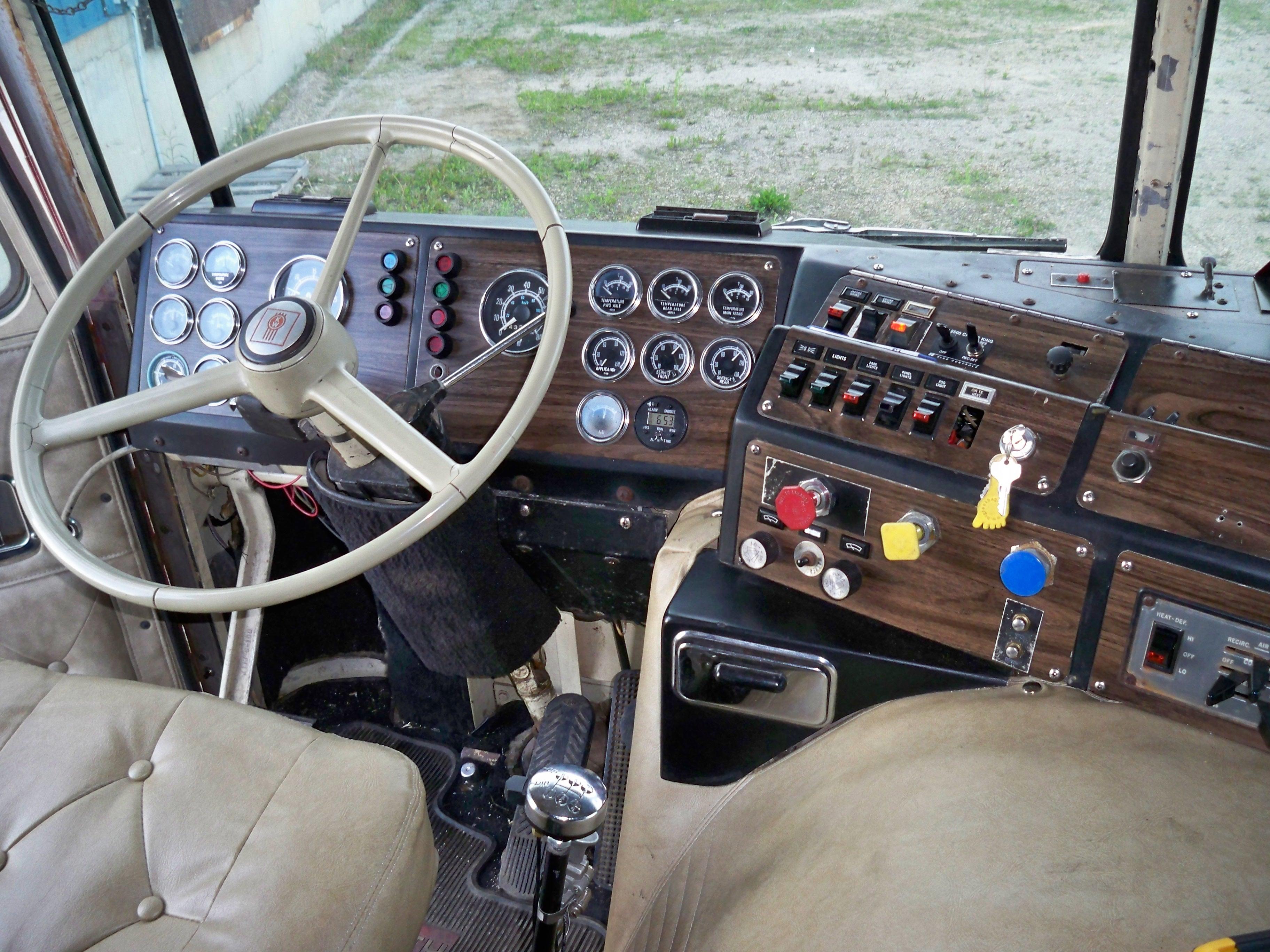

Diecast_dude45 Posted November 6, 2020 Posted November 6, 2020 Hey guys! Is there any of you, who knows what's on the AMT Kenworth K100 Aerodyne's steering wheel? Is there a KW logo or not?
Oldcarfan27 Posted November 7, 2020 Posted November 7, 2020 21 hours ago, Diecast_dude45 said: Hey guys! Is there any of you, who knows what's on the AMT Kenworth K100 Aerodyne's steering wheel? Is there a KW logo or not? From Paul Sagehorns original BJ truck
Force Posted November 7, 2020 Posted November 7, 2020 No there is no KW logo on there on the AMT kits.
