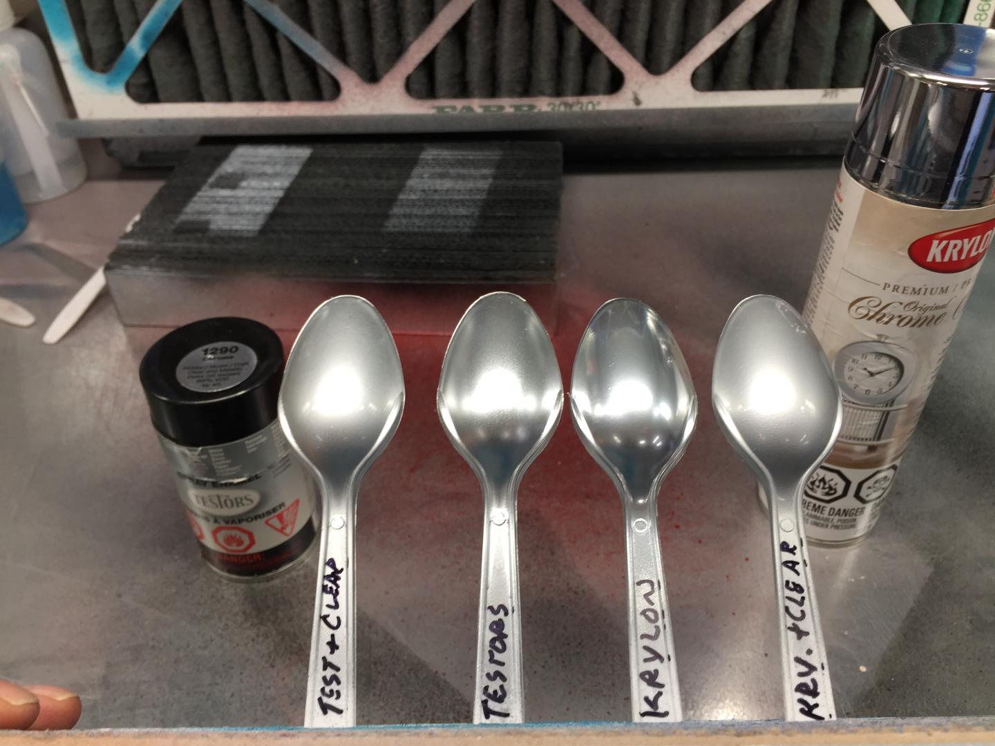

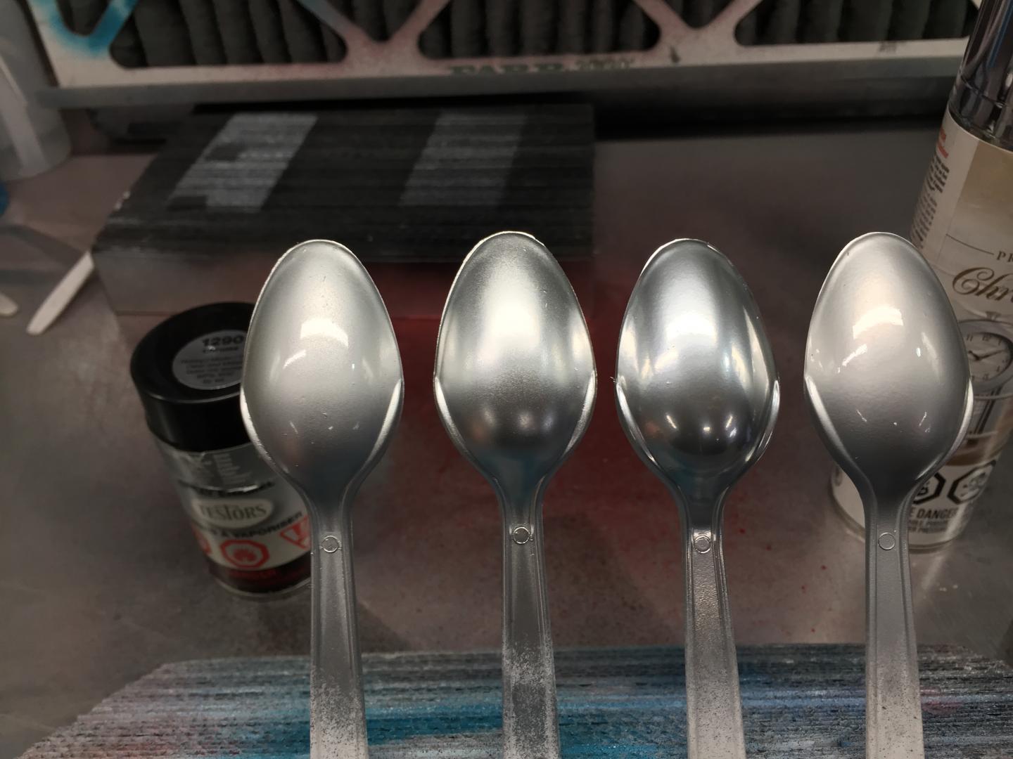

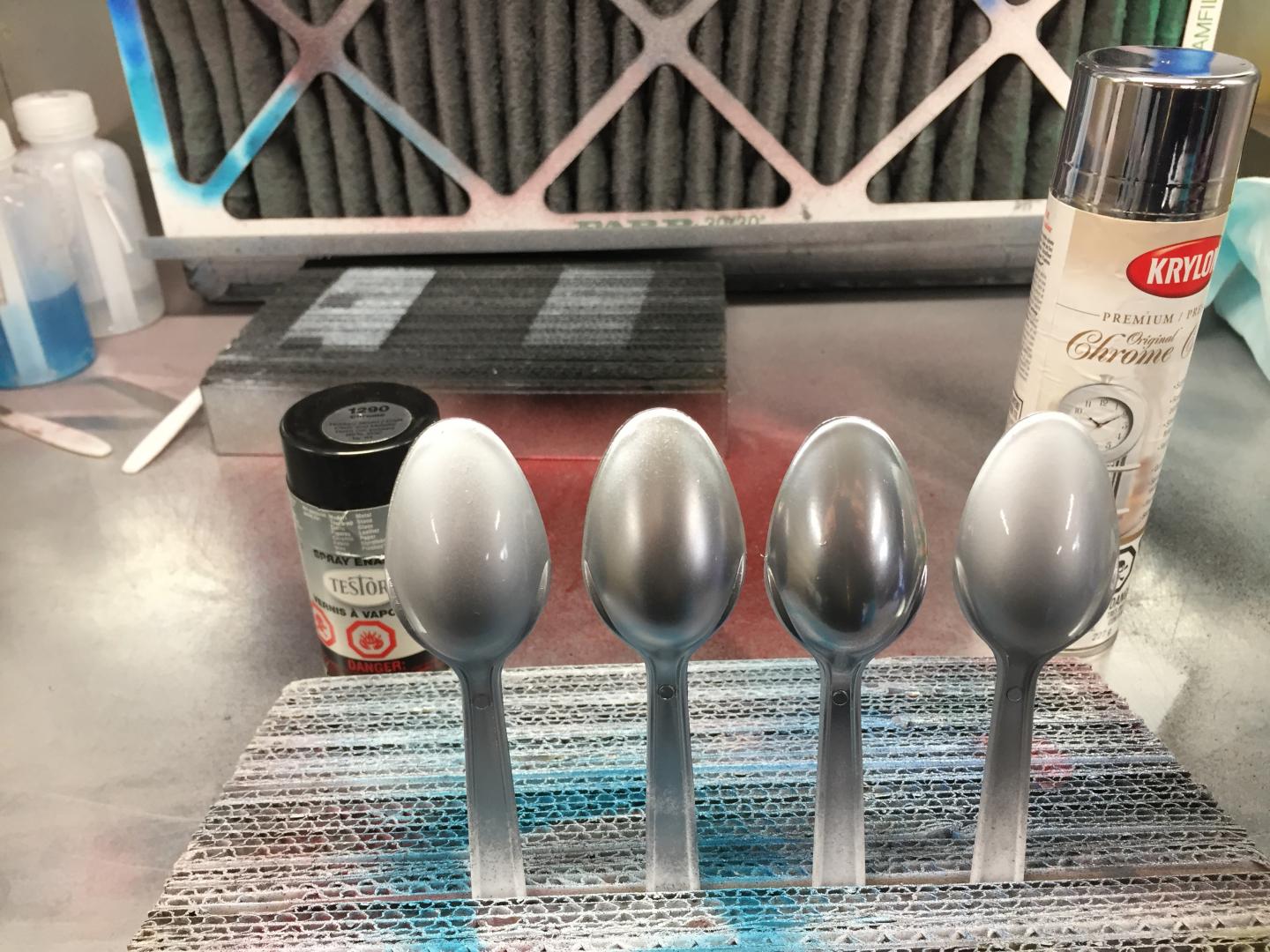

NOBLNG Posted March 21, 2019 Posted March 21, 2019 (edited) I just bought a can of this at Michaels with a coupon to see what it looks like. The two spoons on the left are Testors 1290 chrome. The two on the right are Krylon chrome. I recently bought can of Testors extreme wet look clear lacquer, so I tried it on the two outside spoons, but it dulled them both down quite a bit! The best looking one is the Krylon I think. Edited March 21, 2019 by NOBLNG

BigTallDad Posted March 23, 2019 Posted March 23, 2019 On 3/21/2019 at 2:33 PM, NOBLNG said: I just bought a can of this at Michaels with a coupon to see what it looks like. The two spoons on the left are Testors 1290 chrome. The two on the right are Krylon chrome. I recently bought can of Testors extreme wet look clear lacquer, so I tried it on the two outside spoons, but it dulled them both down quite a bit! The best looking one is the Krylon I think. The cap on the Krylon can is bright and shiny...can't say the same for the spoon (false advertising?).
gman Posted March 24, 2019 Posted March 24, 2019 4 hours ago, BigTallDad said: The cap on the Krylon can is bright and shiny...can't say the same for the spoon (false advertising?). The Krylon cap appears to be vacuum metalized (like they do for chrome model parts). False advertising? You could say that...my younger self was sucked in by that on a number of "chrome" paints over the years, from Duplicolor, Testors and other brands, purchased to chase the elusive "chrome in a can" solution. I would say that Krylon paint has a place in modelling, but maybe not for the same surfaces you would use products like Alclad, Spaz Stix or Molotow on if the goal is to replicate scale chrome plating rather than a polished natural metal surface.
