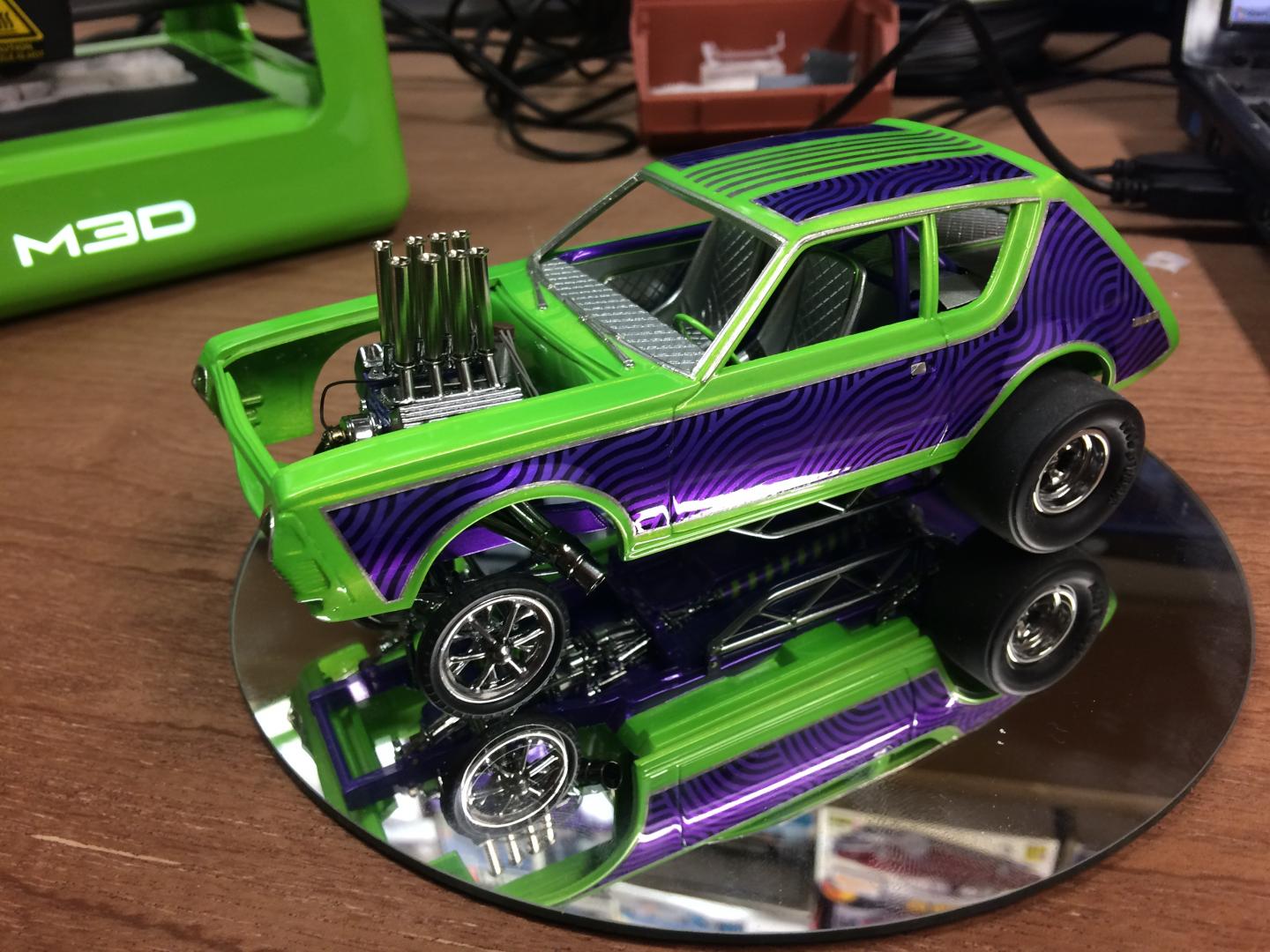

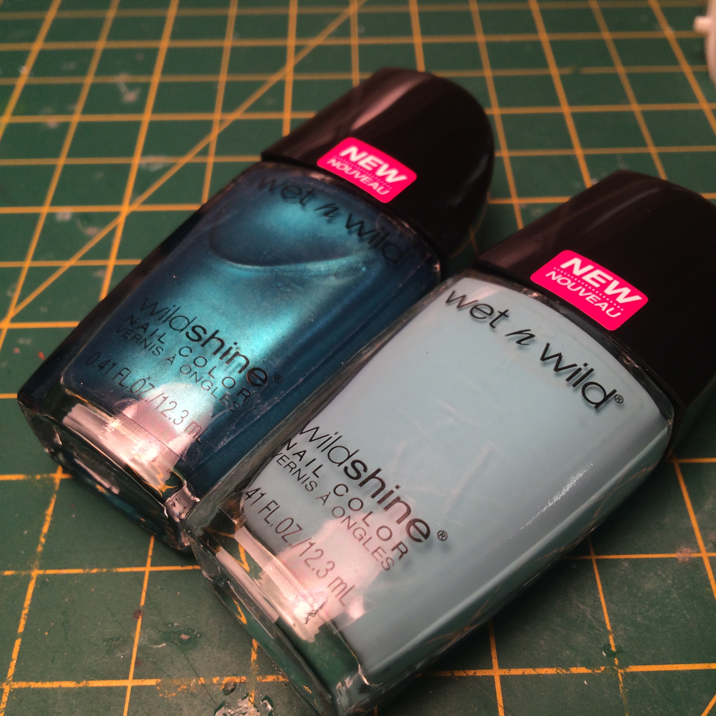

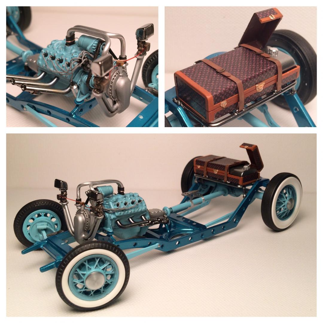

Impalow Posted March 22, 2019 Posted March 22, 2019 Nail polish is fantastic in my opinion... but you do need to put it over a primer as others have mentioned... Tamiya white primer is my personal choice. I also use automotive urethane clear overtop of it, and it works just fine... you can also just polish it since its usually just lacquer. Here are some examples: Wet-n-wild disturbia Wet-n-wild Lime light and various purples. and then this i used the wildshine colors..

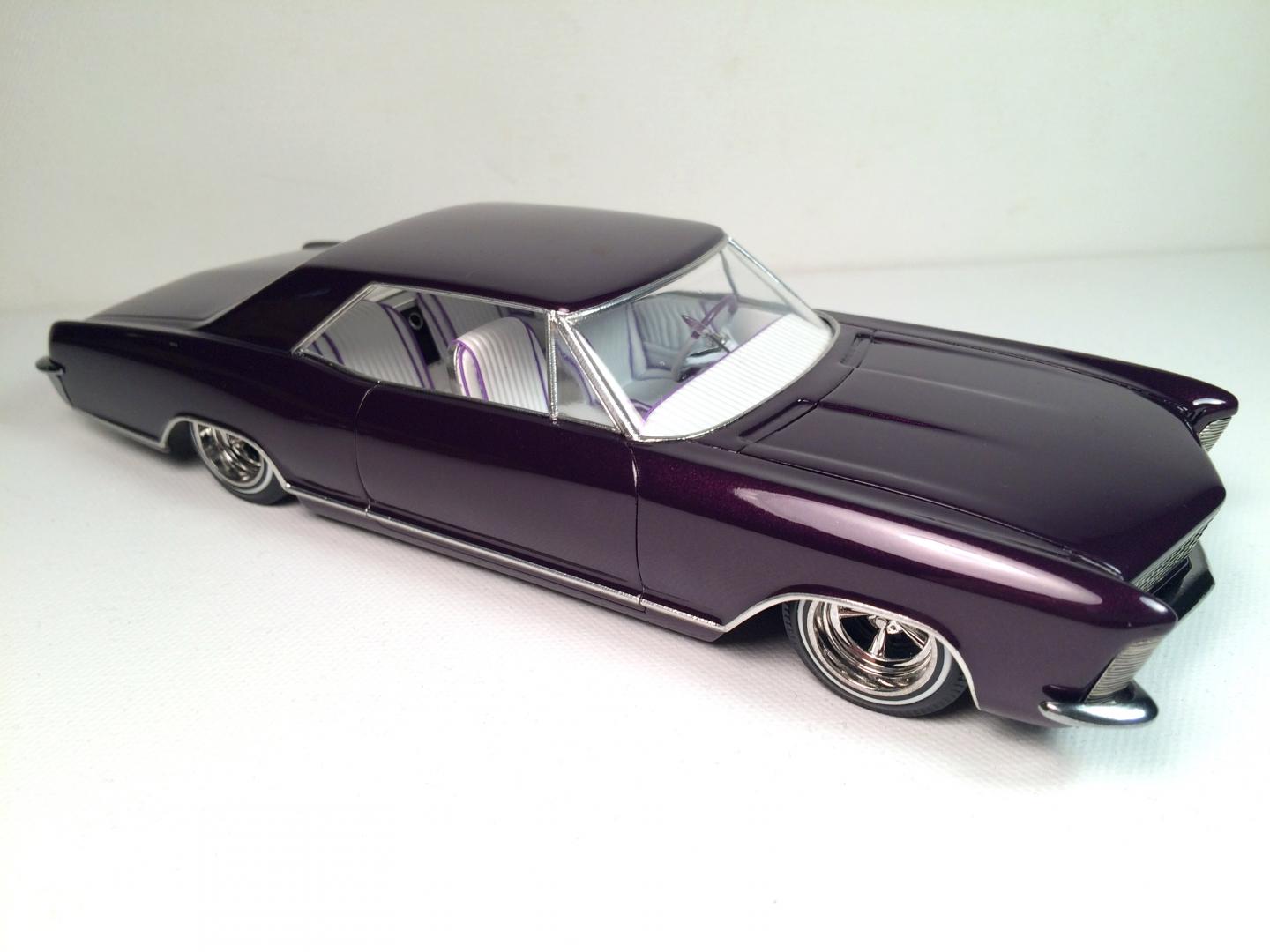

peteski Posted March 26, 2019 Posted March 26, 2019 (edited) Yes you can use it for painting model cars, and yes I do. There are dozens of really nice colors available (and while some cost over $10/bottle, there are lots of cheap ones too - look in dollar stores). These are similar to 1:1 automotive lacquers - you need to use the same methods you would use for painting your model with 1:1 automotive lacquers. You need a primer/barrier coat over bare styrene. Here is my last build where I uses a nail polish. Nail polish is very viscous and needs to be thinned for airbrushing. I used PPG medium temperature reducer (thinner). I don't have the ratio (I thin it until I think it is usable), but it was probably around 50/50 ratio. I used Tamiya fine white primer for the undercoat (decanted and airbrushed). Then I applied a Testors Wet Look clear. No sanding/polishing/waxing was done to this model. As far as the number of coats and thinning ratios go, I don't really keep track (and I've built this model few years ago). I should make notes of my panting procedures, but I always forget to. Plus, that would further slow down my already-slow builds. Edited March 26, 2019 by peteski
Khils Posted March 26, 2019 Posted March 26, 2019 15 minutes ago, peteski said: I used Tamiya fine white primer for the undercoat. I am paying close attention to this thread.....priming procedure? Was that decanted & air brushed also???? # of coats?
peteski Posted March 26, 2019 Posted March 26, 2019 8 minutes ago, Khils said: I am paying close attention to this thread.....priming procedure? Was that decanted & air brushed also???? # of coats? I update my earlier post with some of the info you asked for. Sorry, my documentation skills are poor.

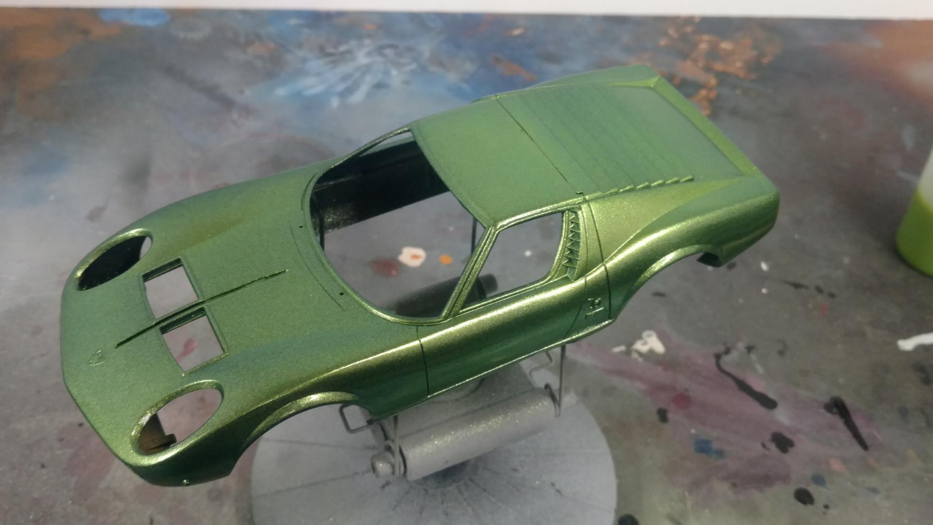

rsxse240 Posted April 7, 2019 Posted April 7, 2019 This is Sinful Colors nail polish over Testors Model Master flat black (as primer/base). I thinned it about 1 part paint to 1 and ¼ medium temperature lacquer thinner from the auto paint store. I found Kleen Strip (or typical hardware store brand) is very "hot" and dries too quickly and gives the paint no time to flow out, leaving a very rough texture.
Dave G. Posted April 8, 2019 Posted April 8, 2019 (edited) On 4/7/2019 at 2:55 PM, rsxse240 said: This is Sinful Colors nail polish over Testors Model Master flat black (as primer/base). I thinned it about 1 part paint to 1 and ¼ medium temperature lacquer thinner from the auto paint store. I found Kleen Strip (or typical hardware store brand) is very "hot" and dries too quickly and gives the paint no time to flow out, leaving a very rough texture. With hardware store Kleen Strip if it's going on dry, thus rough, there are some things you can do. 1 Reduce your working air pressure till the nail polish goes on wetter. Too much air pressure dries it before it hits the surface. 2 move the airbrush in closer to the model surface ( same reason as above, the distance can cause drying too). 3 Mix the thinner 50/50 with xylene then thin as usual with that blend ( depending on the weather I sometimes use straight xylene or a blend rich in xylene). 4 Increase the fluid flow . Model Master enamel isn't a good idea as a base under lacquer products. You will find out why in due time. Edited April 8, 2019 by Dave G.
peteski Posted April 9, 2019 Posted April 9, 2019 Blending some VM&P Naphtha with the thinner will also slow down its evaporation.
rsxse240 Posted April 10, 2019 Posted April 10, 2019 On 4/8/2019 at 5:51 PM, Dave G. said: With hardware store Kleen Strip if it's going on dry, thus rough, there are some things you can do. 1 Reduce your working air pressure till the nail polish goes on wetter. Too much air pressure dries it before it hits the surface. 2 move the airbrush in closer to the model surface ( same reason as above, the distance can cause drying too). 3 Mix the thinner 50/50 with xylene then thin as usual with that blend ( depending on the weather I sometimes use straight xylene or a blend rich in xylene). 4 Increase the fluid flow . Model Master enamel isn't a good idea as a base under lacquer products. You will find out why in due time. I haven't had a problem with sinful colors yet. And though they won't tell what they're using as a base, it thins with Testors reducer, and even mixes with their paint, so I presume it is enamel. Also, since it is so cheap, I would guess the maker isn't using lacquer as a base. I use lacquer thinner as it expedites the drying/curing process and it is readily available at reasonable prices.
