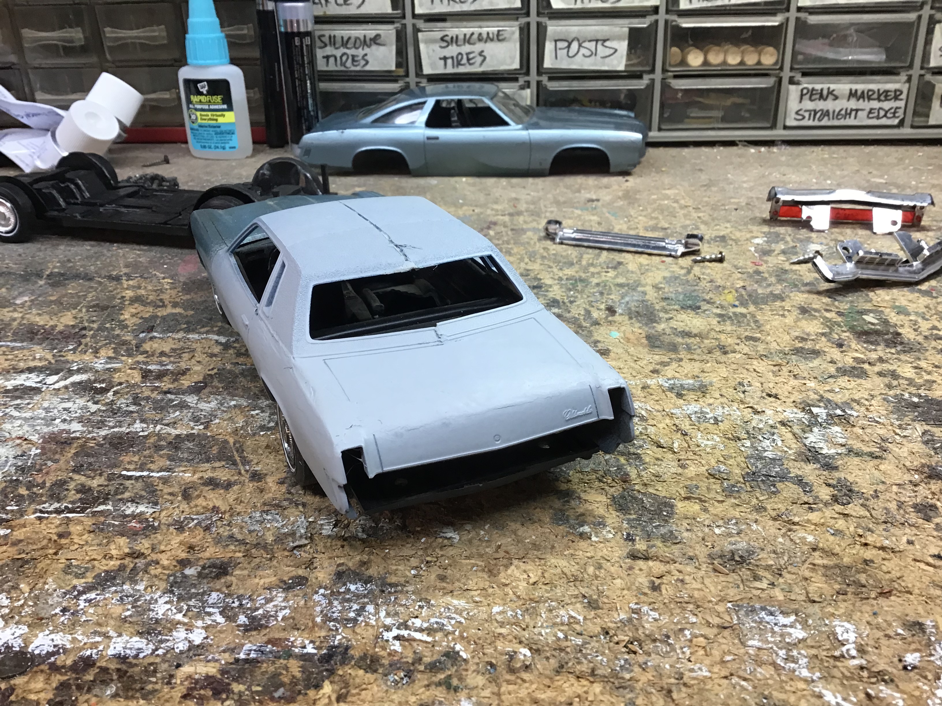

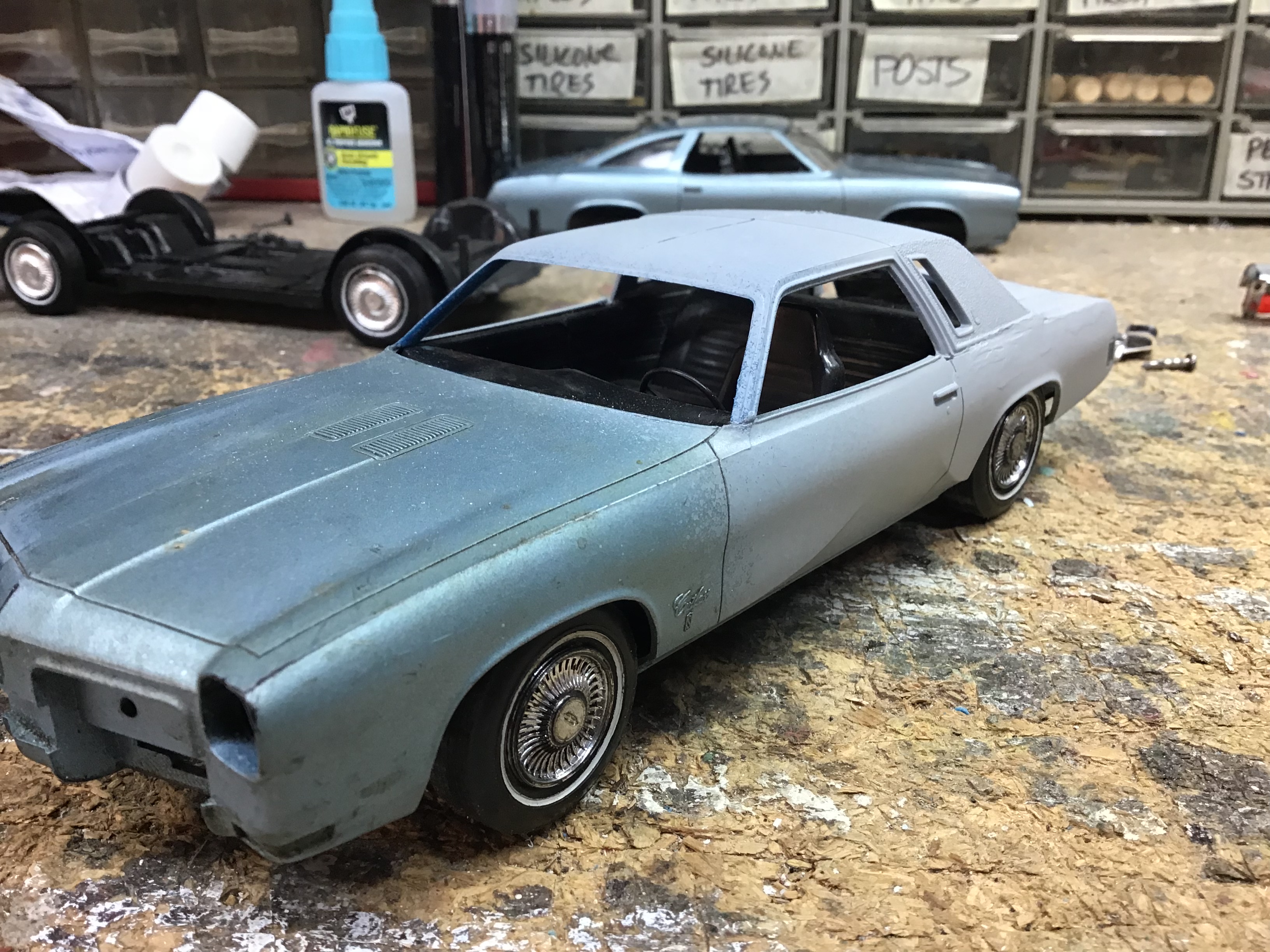

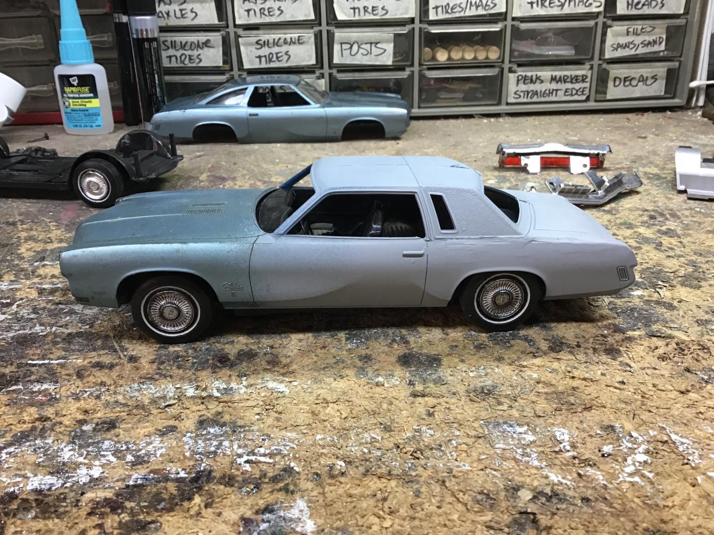

fordf-100 Posted March 21, 2019 Posted March 21, 2019 I am looking for some input on a project I recently started. I took a Revell 77 Monte Carlo roof and put it on a Jo-Han 73 Cutlass promo that was in very bad shape. This was mostly for practice but I don’t think it looks to bad! I wanted to see what you guys thought about proportions and general overall shape and look. I probably will remove the half vinyl roof and go with a full vinyl top as all the pics I have seen were full tops. Let me know what you guys think. Thanks!
espo Posted March 22, 2019 Posted March 22, 2019 With a little finish work I think this would look fine as is. On the Vinyl Roof question, it all depends on what you want it to look like. A full Vinyl Roof was the most common style at the time these were new. The Quarter Roof was part of the Landau trim option, and also many dealers added this style roof for added profit and if that was in style in their area. Just build it the way you want it.
fordf-100 Posted March 22, 2019 Author Posted March 22, 2019 Thanks! It didnt look to bad to me, all the ones that I looked at had full roofs so i thought I would go that way. I will look and see if I find any half roofs that were part of the landau trim, it would be a lot easier than doing a complete roof! I am trying this to learn some new stuff, everyone here on the forum does fantastic conversions so I tried this for some practice, I need to work on my finishing and think more about mu cut lines.
MrObsessive Posted March 22, 2019 Posted March 22, 2019 EXCELLENT start Steve! We sure could use some GM 1973-77 A-bodies in the full glue kit lineup! One thing I'd like to point out if you may.........while the A-Body Monte and the Cutlass were built on pretty much the same platform, the rooflines are similar but have some differences. The Monte particularly in the rear part of the roof is a bit more upright and has a bit smaller 'opera' window. Here's a '76-'77 Cutlass Supreme.......... The back part of the roof has a bit more of a 'faster' angle than the Monte. You're actually doing a long time wanted project I've had rolling around in my mind for years now! I have about five or six of those Johan Olds.......I wanted to take the back part of the Monte roof after some mods and graft it on to the forward section of the Olds roof right at the B pillar. I'd like to do what was my Driver's Ed car in high school. A '77 Cutlass Supreme which was sort of a copper color with wheels like I have pictured. Keep up the good work as you just don't see these cars at all on the roads anymore.
Oldcarfan27 Posted March 22, 2019 Posted March 22, 2019 Off to a good start, looks good - especially for a "practice body" I also started a Cutlass Supreme using the same parts, except mine is from a 75. I got the roof to fit, but I didn't like the boxiness of the Monte Carlo roof, so I'm in the process of reworking it to my satisfaction. Problem with the Cutlass Supreme (75 at least) is there is a difference in the nose from that and the regular Cutlass. And a few trim differences. 74 ? 75 ☝ 75 sport coupe? See how the nose differs from the kit? I don't know if the 73 is the same or not. I hope not, cause that would save you a lot of modifications. I wish I had a 73, I really like the front and rear bumpers on those. The Johan 73s are hard to find. Good luck with your conversion.
fordf-100 Posted March 22, 2019 Author Posted March 22, 2019 Thanks guys! I never noticed the roof difference until you pointed it out, I always assumed they were the same. I might look into changing the angle a bit, any suggestions on what would be the easiest?
Oldcarfan27 Posted March 22, 2019 Posted March 22, 2019 I would leave it as it is, you're so far along. But, if it bothers you enough, I took a slight vertical wedge out of the rear, top near the back window and leaned the back window area in. I also added a wedge of plastic into the B pillar to add some angle to it. Since you want to change the vinyl top anyway, you can make these mods while you're sanding off the roof and retrim it after all the bodywork is finished. Don't forget to fix the shape of the quarter windows, they're supposed to trapezoidal - not mail slots. Here's a side profile to use for reference. Personally, I think Revell got the roof on the Monte Carlo all wrong - too boxy. But, it's the ONLY collonade landau roof we have, so you gotta make do with what you got.
MrObsessive Posted March 22, 2019 Posted March 22, 2019 16 minutes ago, fordf-100 said: I might look into changing the angle a bit, any suggestions on what would be the easiest? If it were me doing this, I'd make some kind of pie cut in the rear part of the roof and lay the rear glass (and part of the C pillar) forward a bit towards the front of the car. The shape of the tulip panel is about the same with that familiar Bill Mitchell "W" shape it has, so you won't need too many mods there.
MrObsessive Posted March 22, 2019 Posted March 22, 2019 1 minute ago, Oldcarfan27 said: I would leave it as it is, you're so far along. But, if it bothers you enough, I took a slight vertical wedge out of the rear, top near the back window and leaned the back window area in. I also added a wedge of plastic into the B pillar to add some angle to it. Since you want to change the vinyl top anyway, you can make these mods while you're sanding off the roof and retrim it after all the bodywork is finished. Don't forget to fix the shape of the quarter windows, they're supposed to trapezoidal - not mail slots. Here's a side profile to use for reference. Personally, I think Revell got the roof on the Monte Carlo all wrong - too boxy. But, it's the ONLY collonade landau roof we have, so you gotta make do with what you got. Ha! Great minds think alike as we posted at the same time! Yeah, Revell's cowl I always thought was a bit too high also for a Monte.....Johan got that shape closer to correct (as they usually do with body shapes). Actually, when I first saw the Revell Monte, other versions of those Colonnade coupes came to mind with that roof. Of course, the '76-'77 Cutlass...1976-'77 Buick Regal, 1973-'77 Pontiac Grand Prix. It's amazing that NONE of the kit manufacturers have ever touched any of those cars save for Johan with that Olds. Johan only did the 'fastback' style of the roof though and never any of the formal coupes.
Oldcarfan27 Posted March 22, 2019 Posted March 22, 2019 I saw that too, Bill. And we had the same advice, just mine's more "wordy" I also have a long time on/off project converting a Cutlass into a 73 Buick Century Luxus, a car my parents had when I was growing up and always wanted a model of one. But since that's never going to happen, I decided to make one myself. I'll have to post it someday, but I didn't want to hijack Phil's thread right now.
fordf-100 Posted March 22, 2019 Author Posted March 22, 2019 Good tips guys, thanks! Patrick please post the pics you’re not hijacking the thread, would love to see them. I grew up with these body styles! While my brother and I had many muscle cars, Mach 1’s, several GTO,s , 2+2,s and 57 Chevys my daily driver was a 76 Grand Prix SJ, that was a great car! Would love to see some of those in plastic!
